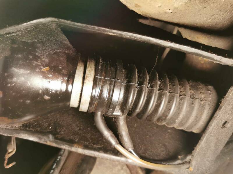

The fault was eventually traced to this little rubber coupler, that sits between the inner wing and the bonnet hinge.
Only the square section of it was visible, so it was quite a shock to see the state of the rest of it:
This has had my last spare 4-inch section of washer tube fitted in its place - can't believe I was going to chuck it out!

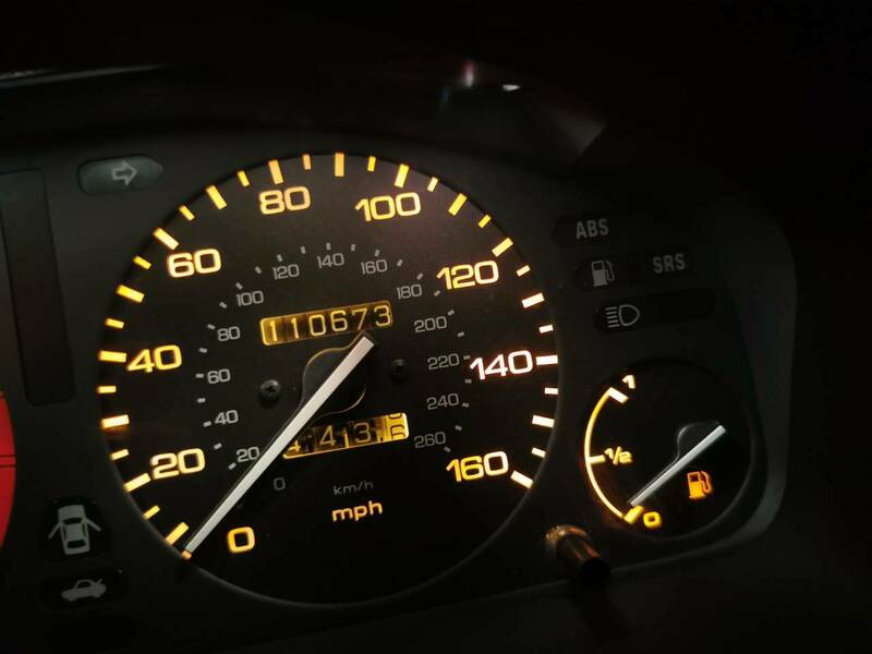

Over the course of the day, we clocked up 440+ miles with the car fully loaded with not a single issue or irritation.
More impressively, is it did the entire journey on a single tank, and the fuel light isn't on yet either!

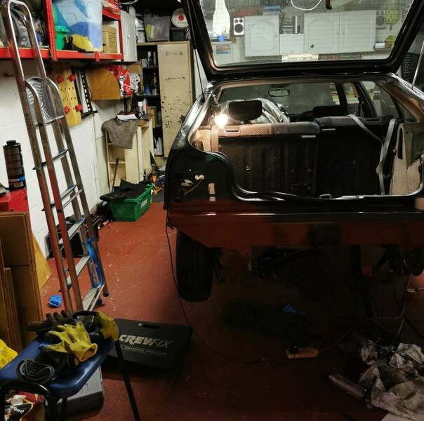

Busy evening yesterday.
Up on stands.
Gathered all the necessary equipment

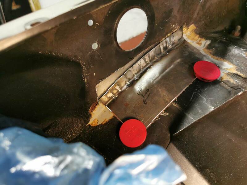

And welded in the rail/bracket I made way back in June. Not pretty, but it's very solid.
I also welded the rail in on the underside - the new rail slotted into the old one nicely.

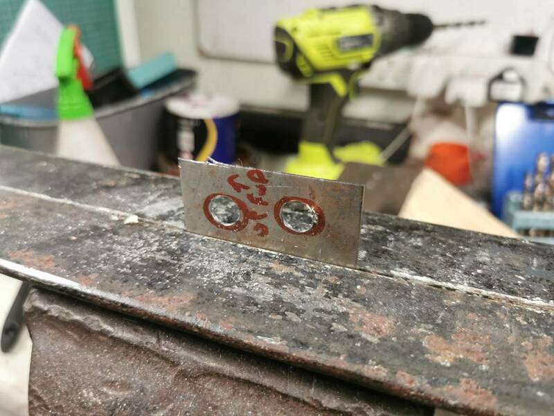

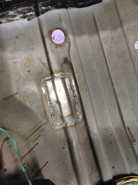

Then it was time to measure and drill out the plug weld holes, and clamp the panel in for welding.
Then a quick spray of weld through primer on the contact areas before getting ready to weld it in again.
Again, not pretty, but I'm not working with the thickest or cleanest metal.

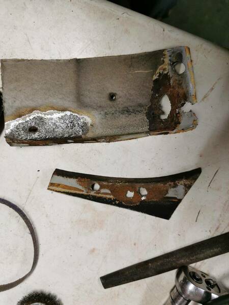

First things first, I removed the wheel arch stiffener bracket - this had rotted away at one end and was barely attached at the other. Chevronics sell them for £24, but typically, have been out of stock for ages. Luckily, there's a couple of pictures online to help me fully recreate this item.

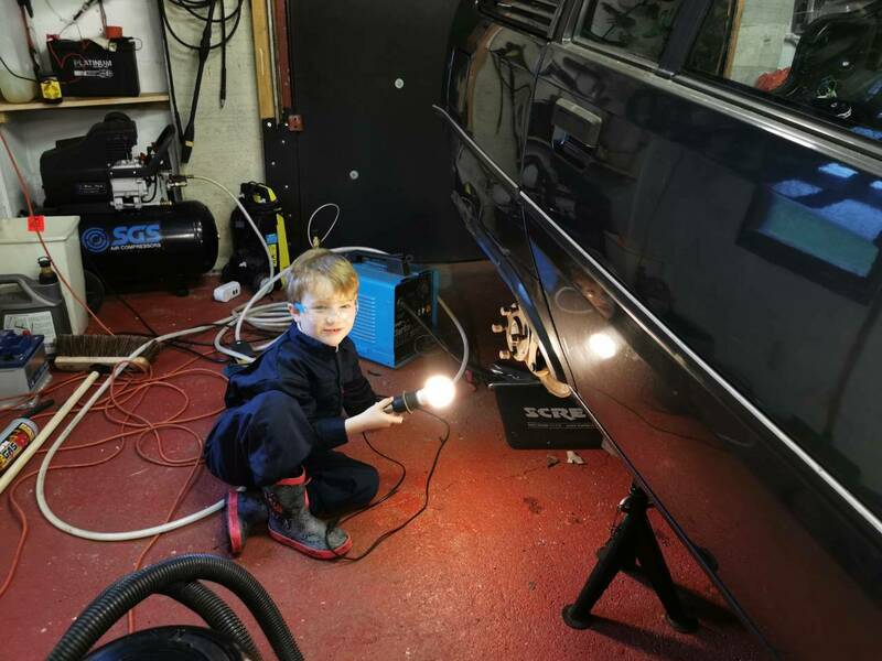

The boy was roped into helping gain access to the inner arch from inside the car - this annoyingly resulted in the interior c pillar trim snapping a large section, which I will have to either repair or replace.

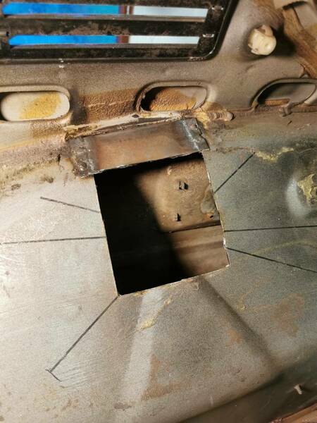

There's a spot welded bracket that fell off a while back, it mounts the fuel tank capsule. I'm chopping a sizeable section of the arch out, so drew several straight lines to allow me to 'zone in' when the new metal is in and re-weld it in roughly the right place next time.
With the lad hiding the light underneath to keep an eye on things:
I started making the cuts.
Not many photos occurred after this one as I was winging it as usual, but here's a photo of the repair patch.
The patch is partially welded in now as MrsH had come home and it was time to get the kids ready for bed, but it follows the rest of the standards of my welding this far - ugly as sin, but solid.

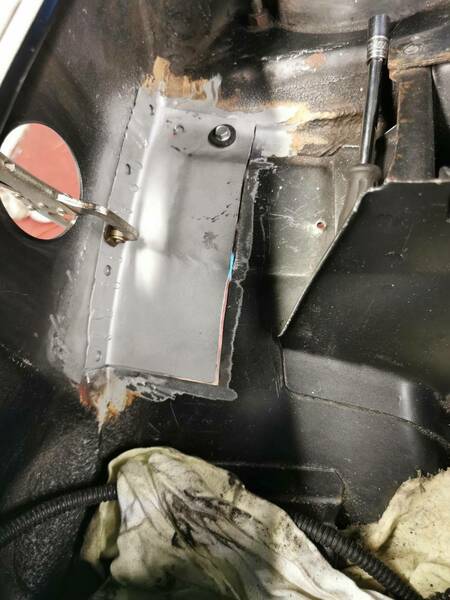

Bit more work done today. Welded the smal patch panel on the inside of the inner arch. Chopped out another grotty bit of the inner arch, and re-thought the repair.  Also chopped off the bent portion of the previous repair section as it was now surplus to requirements.

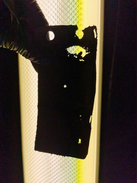

Once on the bench, it was clearly thin in several parts, so the right call to cut the whole section out.

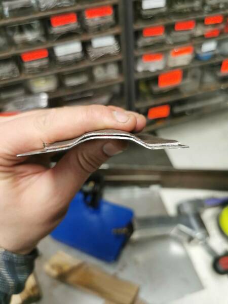

Never tried before, but a bit of twatting about with hammers allowed me to match the profile of the 'hump' at the bottom.
Eventually, the edges were joggled and everything looks to match up nicely.

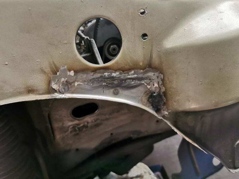

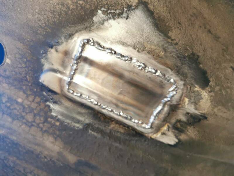

Anyway, fun stuff aside, the patch got welded in. Lack of access was once again proving to be a hindrance, thanks to the wheel hub receding into the wheelwell, and the rear arch 'spat' reducing access even further. However, it survived being smacked about with a hammer, and seam sealer will have it looking pretty.
image.thumb.jpeg.1291ef761af15fa1e03fe61a80a720a0.jpeg image.thumb.jpeg.dbe1369f30783ebd5a219b55d2f55c11.jpeg
Feeling a bit deflated with how bloody awful the last few repairs had gone, it was time to move lower down, onto the sill end. The 50mm metal bung was split with corrosion so that will need replacement. The metalwork was then cut back to solid metal.

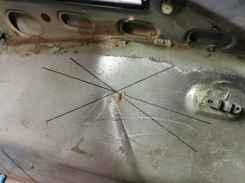

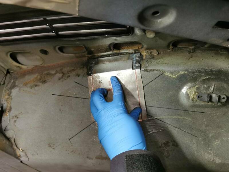

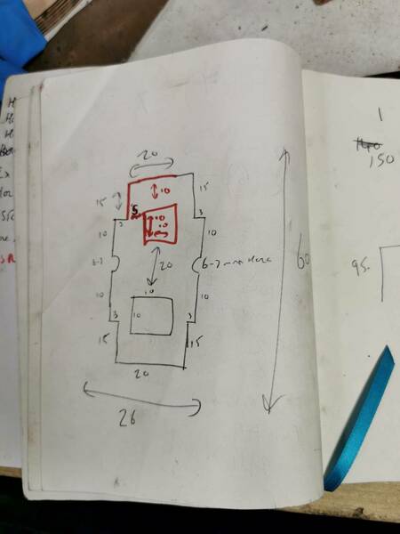

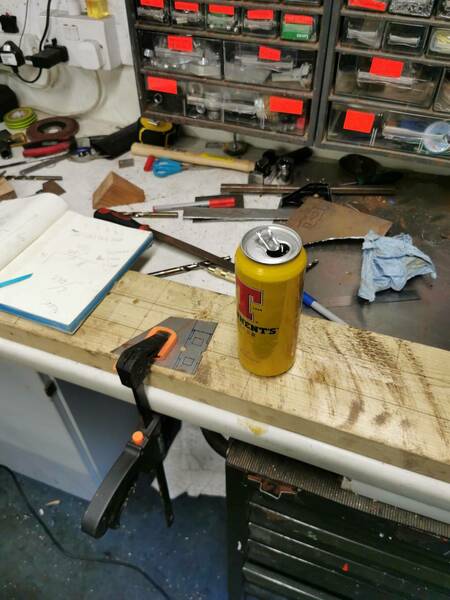

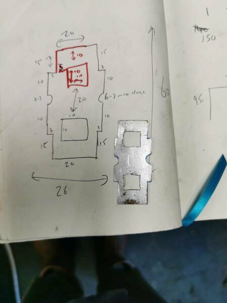

In the meantime, I made a rough template of the repair patch, added 20mm around the edge for the lip and dropped it with a mate who offered to show me the correct way to bend a 90 degree lip into a curve.
This process involved getting some wooden 'formers' made up, which would take a bit of time in between jobs, so it was onto the next job.

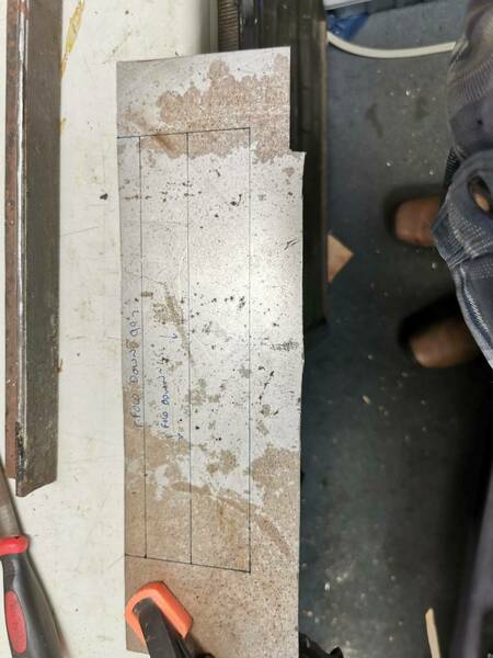

Remember this bracket?
Good news! It was listed very cheaply on Chevronics!
Bad news - they were out of stock. Guess I'd better have a go at making my own then.
Using the image from the website, the other bracket and a bit of guesswork, and I had a rough outline. With the donor structure flattened, you can see there wasn't much left to go on!

Eventually, once I'd worked out the correct sequence of folds to ensure they could all be achieved, and using an impact socket as a former to give some strength to the corners, a bracket was made!
image.thumb.jpeg.e2f04c184b66fe4041f62fb82b2a1cc7.jpeg image.thumb.jpeg.141c9990afc65c818c15169ae6eb52e8.jpeg
With the pigeon fed extra helpings and squeezed hard enough, the bracket was eventually welded into the correct position.

Annoyingly, the actual bracket had gone missing from the workbench which was not ideal, but luckily I had penned the outline of what remained on a scrap bit of metal when I took it off:
Using that as a template, I took a fresh set of measurements off and sketched a fresh template:
Which I then carefully drew back onto a clean bit of metal.
That'll do for today - I'll cut it out, mark the position on the inner arch and weld it in tomorrow, and that'll bring the welding repairs to the OSR arch to a close.

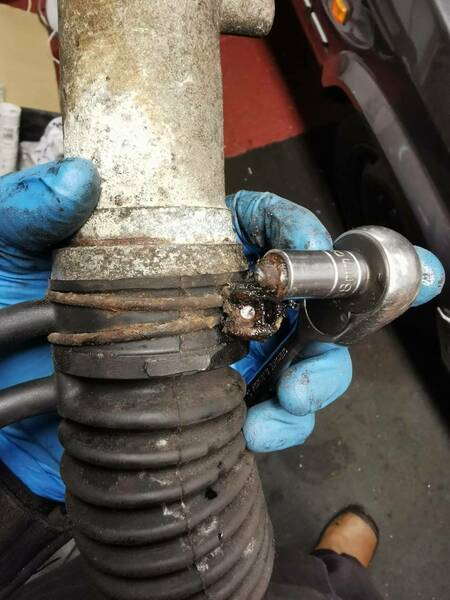

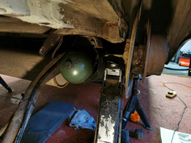

Instead, I opened the LHM depressurisation screw, jacked up the OSR arm and worked on the OSR unit replacement.
Aaand immediately shitcanned it as the supply pipeline union was heavily rounded off. Without a replacement supply pipe, there is no way in hell that I'm chopping into pipework.
Oddly, I'm not sure where the leak is - it's not flowing out of the boot and there's a pool of LHM at the bottom of the 'cup' the unit sits in. Could possibly be an LHM sphere seal that's gone bad.
With that work on hiatus, I went with an LHM pump change - the old one was functional, but the pulley had some distortion and the wobble was hilarious.

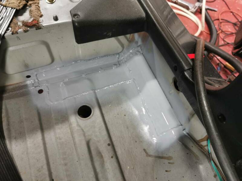

With no further welding repairs required at the rear end, it was time to start seam sealing.
Initially, I went with Tetrosyl rubberised seam sealer in a mastic gun, then Tetrosyl brushable seam sealer.
This was a total disaster as despite giving them at least 24 hours between applications, it cracked in several places when I checked on it a couple of days later. Reading a few forums etc kept pointing to using a PU adhesive as a seam sealer and recommended Pureaflex40, which was less than £8 a tube from Toolstation.

Now that's clamped and secured (it did stay out when I removed the clamp!), it was time to give the affected areas a couple of coats of red oxide primer.
Stone chip hopefully going on tonight.

Honestly, that Tetrosyl is worth firing straight into the bin if you've not kept the receipt. Absolute garbage stuff. Got a brand new tube with the receipt here that I'll be taking back and swapping for more stone chip :lol:
First coat of stone chip is on.
I'll get another can today and put another one down. Did a coat of stone chip on the interior welding repairs too.

Yep, the boot retaining clip isn't there. No idea when that left, but the rust marks show it did have one fitted.
The leak itself I believe to be caused by the sphere not being fitted tightly enough - just tapping the sphere removal tool onto the sphere with the mallet was enough for it to start unscrewing freely. I'm going to clean up the seal and mating faces and re-fit.
The clip is a bit more of a fiddly affair - because I can't remove the unit itself (that pipeline union is NOT budging) I have to disconnect the suspension unit rod from the suspension arm, disconnect the vent and return pipes, and slide it up and over the boot to fit.
I /did/ have a clip on the donor unit which would have worked perfectly. Except, well...
Arses.
I've got a clip on order so hopefully it'll arrive some point next week and I can focus on rebuilding the rear end over the weekend 😁

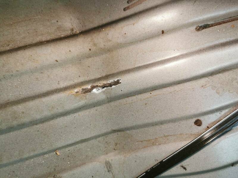

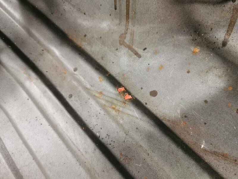

Proved to be the right call, upon disturbing the steel supply and return fuel lines that run the length  of the floorpan, they crumbled and split in half.
Some grot on the rear of the floorpan was observed, so the seats came out, the rear carpet was removed, and my day got ruined.
The bit in the middle was the bit I was expecting to rectify - the gaping hole in the corner was a fun surprise.
The pipelines seen through the floor are the high pressure hydraulic suspension supply lines. Understandably, I was reluctant to break into this system and risk inducing leaks from disturbed pipeline unions.
I decided to mark their positions on the pipeline clips prior to unclipping them.
With a roll of tape cable tied to the pipelines to gently weigh/pull them down, I gained enough clearance to safely cut out the affected rusty areas.

There is very clear evidence to suggest that someone before us had been driving this around on the lowest setting and hit something on the underside at speed - both rear floorpans are distorted at the very rear bottom - the drivers side rear also has some grot, but nowhere near as far-reaching and brittle as this end. There's also a weird dent and slight split in the middle of the floorpan that should be easy enough to weld back together.
So, time to tin-bash. Three patches needed this time.
IMG_20240131_200046.thumb.jpg.e489469ea017e7f20552ac241250dc13.jpg  IMG_20240131_203720.thumb.jpg.c78682c2f070c608c8d03799014d7342.jpg
Aaaaaand once again, I caught my bastarding stomach in the tin-snips. Ouch.
Once all three patches were offered up to check for fit:
The welder was fired up.
image.thumb.jpeg.0f7a10d9bf2564ef32d31b6830a7225d.jpeg image.thumb.jpeg.25b2fd0030226124ce21389b7bb6219d.jpeg

Got the last repair panel welded on (the vertical section) and welded it to the new section of floorpan:
Dressed back the random split in the floorpan - this was later welded up but I forgot to get photos:
And then given a thick coat of etch primer - the underside got a coat of red oxide primer and has also now been seam sealed.

Ran my hands around the underseal on the floorpan and heard some crispy noises under a bubble of underseal. Cut away the detached underseal and found some rather thin metal, underneath - looked absolutely fine from up top, but the screwdriver doesn't discriminate!
And obviously the rear of the floorpan was due replacement (you can see the thin but under the bubble slightly forward of this):
Luckily, beyond the first 40-ish mm it just appears to be surface grot so it should be fine with a wire brush and a reprotect.
So, angle grinder came out, and the grotty bits chopped out:

Should be in the garage making the repair patches tonight, with the plan to get them welded in on Friday. We shall see.
  • Like 12
It's been a bit of a tin-bashing day this evening. Did some more seam sealing too.
Think I've got the hang of making these humps in the metalwork now.
Just got to trim the third one down to size tomorrow.
Three patches, ready to go in. Just need to prep the metalwork.

Eventually, both repair sections of the floorpan went in without any real fuss. A 10mm hole was drilled into the vertical section - this was a mounting bolt hole for the fuel tank. It was 12mm on the original, and would get drilled out to the correct size when the fuel tank is hung in, to ensure it's drilled in the correct place.
With that done, the welds were ground down a tad, the bare metalwork was etch-primed up top, red primed underneath, and a coat of Polyflex was applied on the seams.
IMG_20240211_120507.thumb.jpg.759478d3dbe69a9f6cb7d979305d617e.jpgIMG_20240211_120514.thumb.jpg.425f7eb663651daaa51650c9bf31a6a7.jpg
Whilst that dried, I jumped onto the patch in the middle of the floorpan.
IMG_20240211_131351.thumb.jpg.f188205aacab3f8a454ac0a373ad496f.jpgIMG_20240211_122404.thumb.jpg.78779b9121686bbc9c4828241a940078.jpgIMG_20240211_131411.thumb.jpg.088bc51fe28edae281af231be9f163d5.jpg
This then got the same treatment as the other patch repairs - coat of primer, and some Polyflex.

Whilst that dried, it was time to crack on with the gauge install.
There were two power feeds required - one for the LED backlighting bulb, and one for the gauge itself. I decided to utilise a switched supply from the fusebox - the rear window motors circuit was a perfect fit for this, as I have keep-fit windows in the rear. A piggy-back fuse (popular with dash-cam installs) was used to get a powered fly lead from a switched supply.
Whilst it was routed behind the dashboard, I added an extra line and fed it into the stereo, as it has only ever had a permanent live and so never turned off with the key. Does now though, so that's a nice easy win :)
Finally, I got the last of the power supply rigged up, demonstrated by the backlight here:
The LED is quite intensely bright - I've already added a couple of layers of masking tape to the LED to dim and yellow it a bit, but I'll need to revisit that at some point, as I imagine it'll be quite distracting at night.

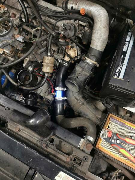

So, onto the engine bay then. I decided to order an in-line sensor mount that fits in the middle of the top radiator hose.
It was properly nerve-wracking to chop the hose in half, particularly because I got the measurement wrong at the first instance! Thankfully, a quick re-think and a second chop saved the day.
I forgot to get more photos of this, but I then fed in the wires from the gauge to the temperature sensor in the engine bay, trying to keep it running with existing looms, utilising an earth lead that was found under the battery tray. With it all wired up, the kettle was boiled and the sensor was plopped into a mug of hot water (it was cold in the garage and the mug had cooled considerably in my transit from the kitchen to garage!):
image.thumb.jpeg.127f8ebc696aaa5f96ef5e3e6a1d6302.jpegimage.thumb.jpeg.feb1cc96bd2dfaf3afb08d2202c5b8bc.jpeg
Now deemed to be working, the sensor was fitted into the pipe adapter, and I called it a night.

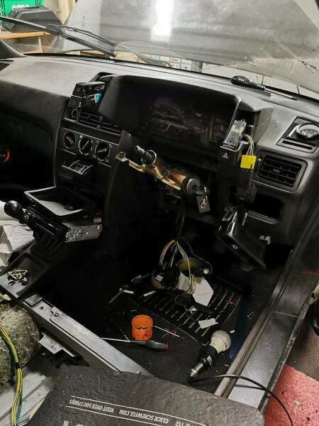

Still, I noticed during some lighting tests etc, that the parking brake warning light failed to operate. Switch was checked for correct operation (working) and the plug was checked for voltage - no voltage, which led to the bulb itself being a prime target.
Luckily, I already wanted to take off the steering wheel and surrounding trim to re-fit it more securely to stop the creaking and rattling.

With that back in, it was time to crack on with the rebuild of the rear end. Starting with the fuel filler pipe:
And the exhaust, rear lights and rear bumper. The rear lights were tested for correct operation and found to be fine, although the brake light switch wasn't working very occasionally - this has been cleaned up and I'll keep an eye on it, testing it again closer to the time.

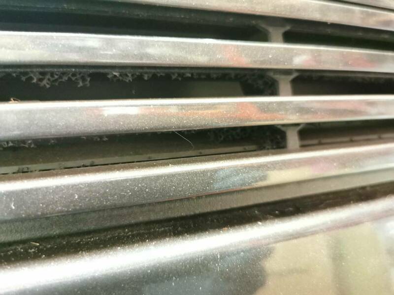

Starting with these rear vents. The sponge-like material was over 30 years old and was suffering terribly.
IMG_20240217_142921.thumb.jpg.83e5f86593f23a10a4e8110412fdc90f.jpgIMG_20240217_143248.thumb.jpg.15b628f6ce8a77c37c1775d606e7966f.jpg
Luckily, fish tank bio-foam is an inexpensive alternative. Typically forgot to get a photo, but you get the idea.

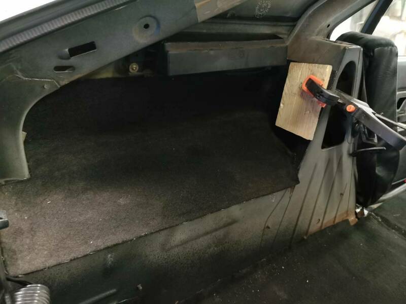

The boot floor carpet was fitted, and side carpet panels re-secured, followed by the side plastic trims. The previously split c-pillar plastic trims were repaired with some repair tape from the rear, and the repair is pretty hard to spot. Handily, the snap occurred between two fasteners, which helped matters.
IMG_20240217_163737.thumb.jpg.2d51ccfd410b2debbb81c014807178bf.jpgIMG_20240217_161301.thumb.jpg.a35b69e1318f681d40acd2f348c685b9.jpg

Annoyingly, there is a bracket at the front that I use to lift the car a bit before I can get a jack up in the proper place. This bit me on the arse rather spectacularly, as the spot welds in an adjacent area let go, and the bracket folded in half. That'll need some remedial work.
First thig I did was check the rear of the engine. Didn't like what I saw, those are coolant crystals, so the head gasket has probably deteriorated to the point where it requires replacement.

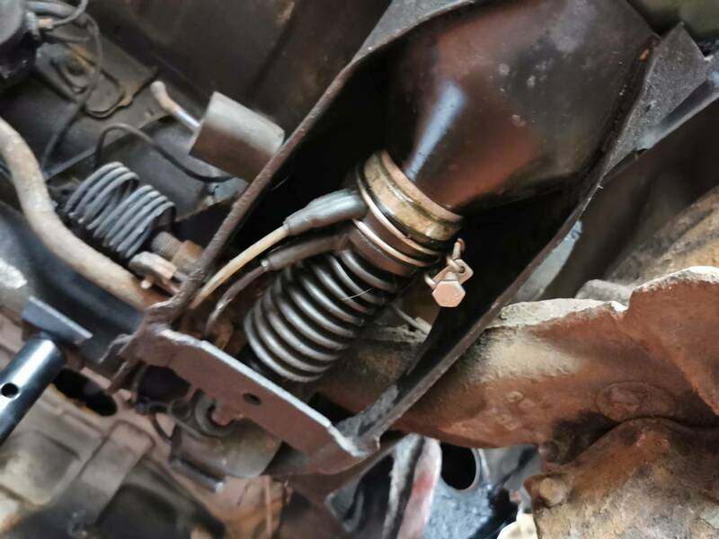

The OSF area seemed like a good place to start, so the LHM sphere was removed, the VIN plate rivets drilled out, and the LHM tank removed. This was due a fresh change of LHM so it make sense to clean the tank out properly.
IMG_20240220_125617.thumb.jpg.3d04cc3d3f6aa5753954e66dfed9c7dd.jpgIMG_20240220_130421.thumb.jpg.24bf2cd36da3b0a98899a3c62597cd26.jpg
First repair up - an almost insignificant panel covering a cavity.
Chopped.
Measured:
Welded:
Primed:
Annoyed with myself afterwards because I chose to do a straight edge instead of curving it - doesn't make a real difference in the grand scheme of things though.
Next bit was chopping out a rotten section of arch and adjoining vertical section - you can see the tiny holes peppering through the metalwork!
IMG_20240221_181825.thumb.jpg.62cdffcf7c4f5acda47a39d0511b3530.jpgIMG_20240221_181931.thumb.jpg.892160f02baff90df195816e8e2f6e19.jpg
image.thumb.jpeg.6cbec0b90a22c99db05a7500cc478097.jpegimage.thumb.jpeg.a4feea9e19c09a51b50af8efad1aabd5.jpeg
To do a curved panel with a lip was a bit of a challenge, but I think I've cracked it:
This was then bent into shape and the lines re-welded.
The vertical section had a curved lip and I wanted to see if it could be recreated with my limited tooling.
IMG_20240221_214013.thumb.jpg.72b2edd0886b37bcc7bb2aa0ae63909a.jpgIMG_20240221_214739.thumb.jpg.e1e03705043b95bced3086e67c140bae.jpg
Turns out it could!
Quick test fit to make sure it all goes together okay:
And I'll look to weld that in tomorrow.

With that done, it was time to weld the two new patches in.
First one went well, so it was time to line up the big one. Decided to use a self-tapper through the plug weld hole for a bit of assistance.
I got about a third of the way through and naturally, I ran out of gas 🤦‍♂️ luckily, the local hardware shop is open on a Sunday and I bought two bottles for peace of mind. Definitely at the point where buying a big bottle would have made more sense, but oh well.
With the new gas plumbed in, the rest of the patch was done. Forgot to get a photo of before the grinding though.
I'm a little unsure about where I would stand MOT wise with this repair - it's been plug welded in the original spot weld positions, but the MOT manual says it needs to be a continuous weld if it's a patch. Can anyone give some advice for that?
After that, I replaced a crumbling tiny bracket on the inner wing edge.
And I repaired the damaged bracket that I jacked on and bent - it transpired it had pulled a couple of spot welds, so I ratchet strapped it to the opposite bracket, straightened it back out with a lump hammer, cleaned up the metal and re-welded the spot welds. It's a lot better than it was.
Thankfully, this brings an end to the welding repairs required in the OSF arch - not much left to go now!
