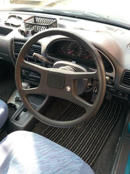

To PAS..or Not to PAS.. a very good question!
The stock wheel on my SuziQ (no PAS) was fuc##ing $hite 😱
The MiNi wheel I bought to replace it is BIGGER and very *cool...
Steering is a proper haul, at slow/kerb turnout !!
