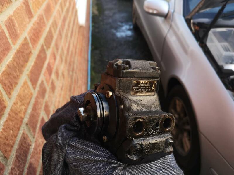

So my last post was me lamenting the incontinence of the HP fuel pump.
So this afternoon I set to it armed only with a Halfords 170 kit and a few flat screwdrivers.

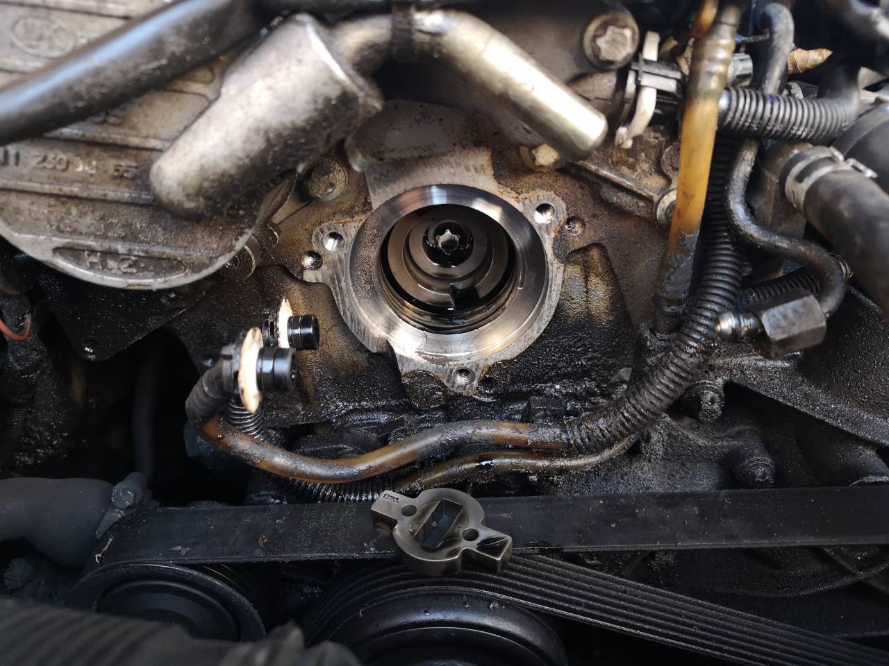

Thankfully the pump was extracted without breaking any of the pipes, and just before it began pissing it down.
Leaving a hole like this...

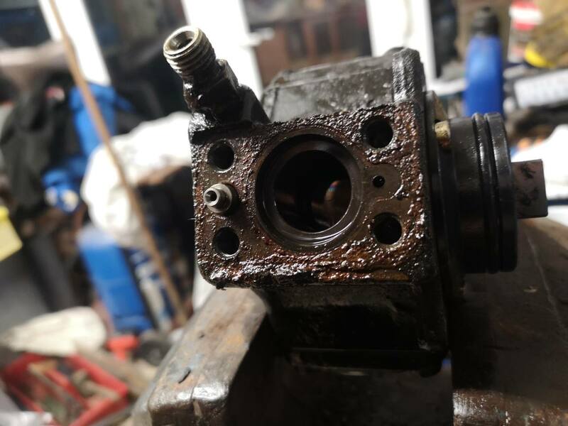

And a grufty handful of Bosch pump...

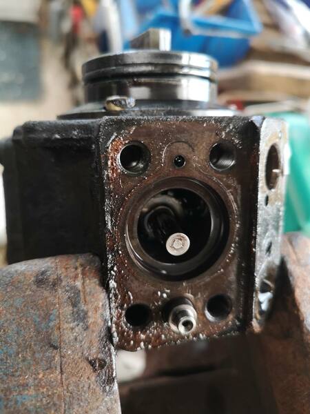

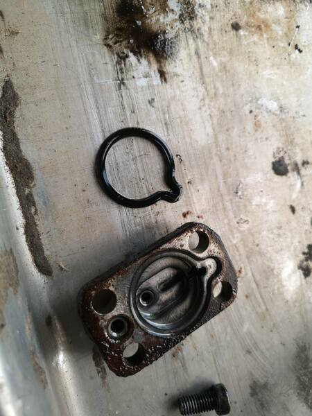

I bought a pump rebuild kit from http://www.x8r.co.uk/ and followed their video during the rebuild.
Under the first cylinder head, it looked properly rough, you know sometimes your doing things and wonder if your car will ever run again? Yeah.
IMG_20210106_152226.thumb.jpg.bc8043f6a891854314828b50d4c20e0b.jpgIMG_20210106_152229.thumb.jpg.7fcb8224a4a57220ac22f73340036d0b.jpg
I used the Dave21478 method to clean up the heads and a scraper and wet and dry on the body to tidy it all up.
Properly. Fucking. Rough.
Not too many pictures as by this point I'm covered in diesel and just want the job over with.

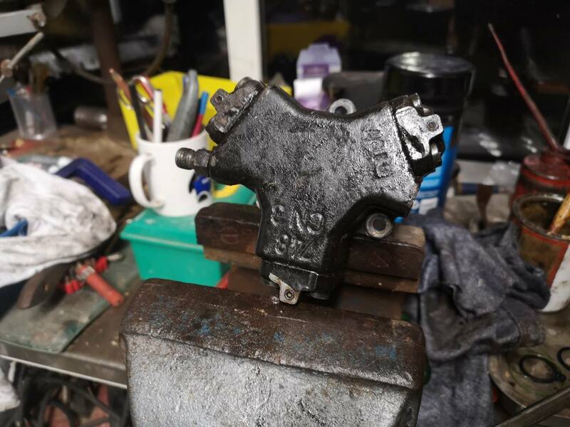

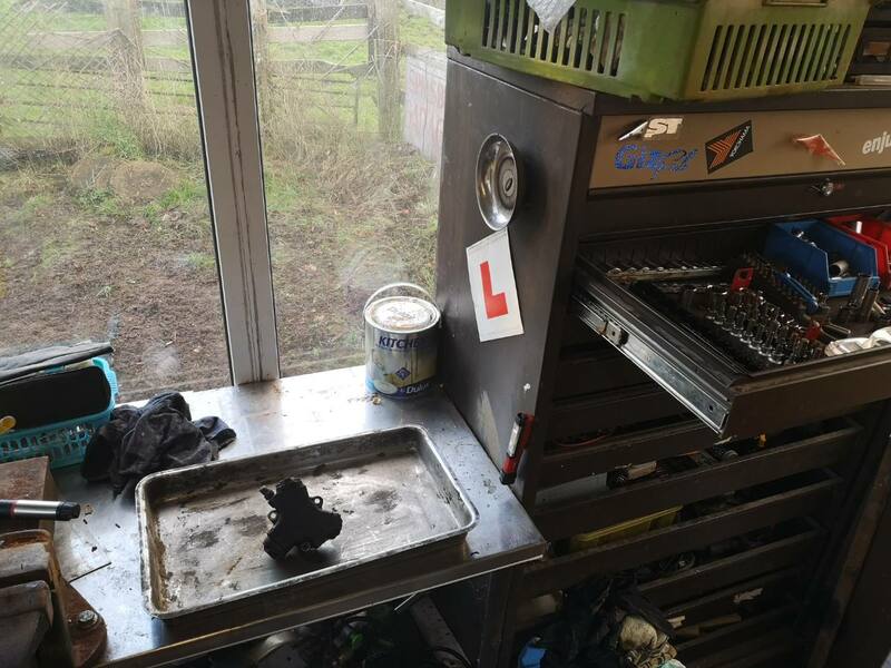

At locking up time, the bench looked like this;
The pump is back in one piece, and I just hope that I have got it all together properly.

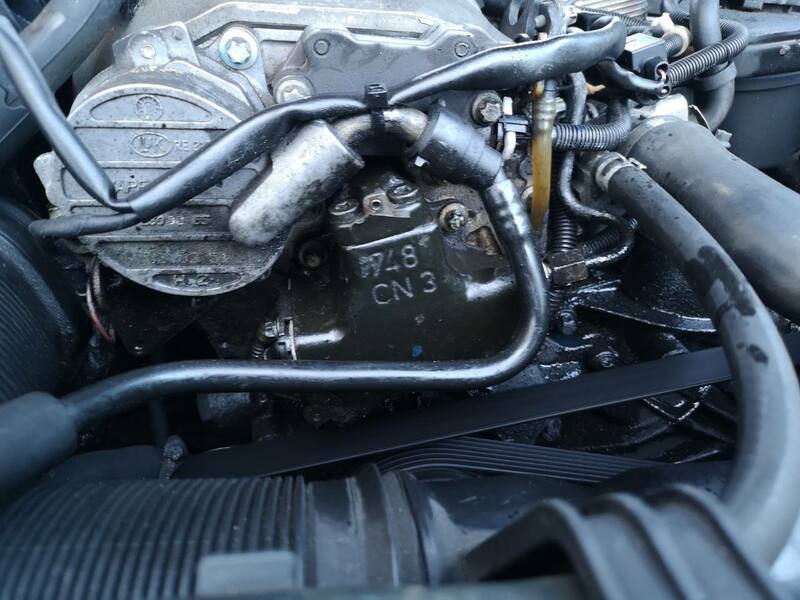

Well, in the freezing temperatures of a Lincolnshire morning, I did attempt to re-introduce the pump to the engine.
It's quite fiddly to realign the drive plate in the cam, but eventually I managed it.
I had to utilise a bojing strap for the plastic lines as the original clips broke. This just keeps them away from the aux drive belt (which probably needs immediate replacement due to having a wd40 like substance on it 🤔
I also replaced this little expensive bastard breather £7 for a lump of plastic.

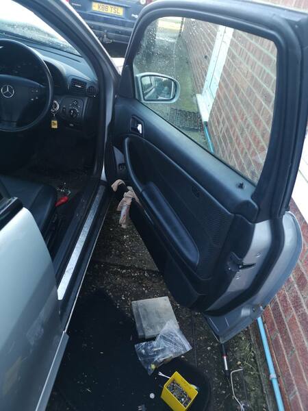

Whilst outside and freezing my conkers off, I've reattached the door card, replaced the window switches and stuck the speaker grille back on.
I also fixed the loose kick trim. 16100189006147654963553025191227.thumb.jpg.55b7e9270faa39f14fb65dd743c8c072.jpg

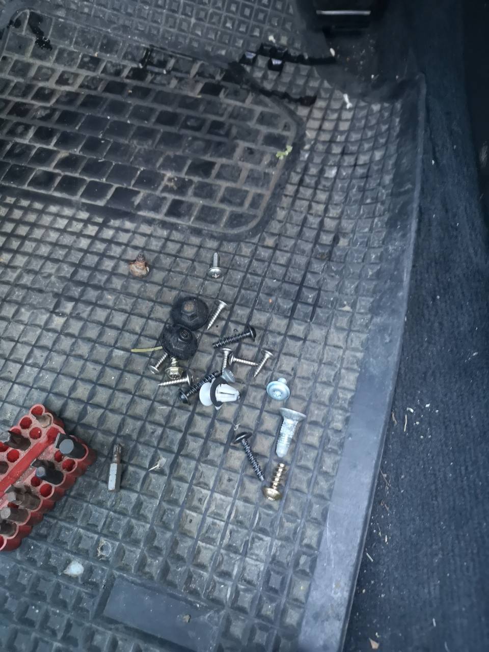

There's still a decent pile of random screws though...

I have put them in the ashtray, so everytime I go round a corner I can pretend I am at the sea side.
Balls, I forgot to post you those that I found in the car too didn't I?
