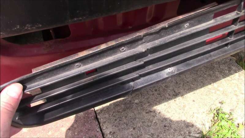

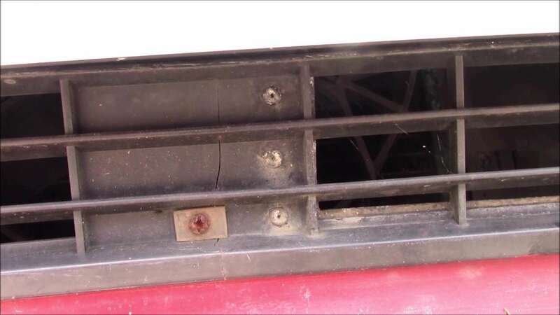

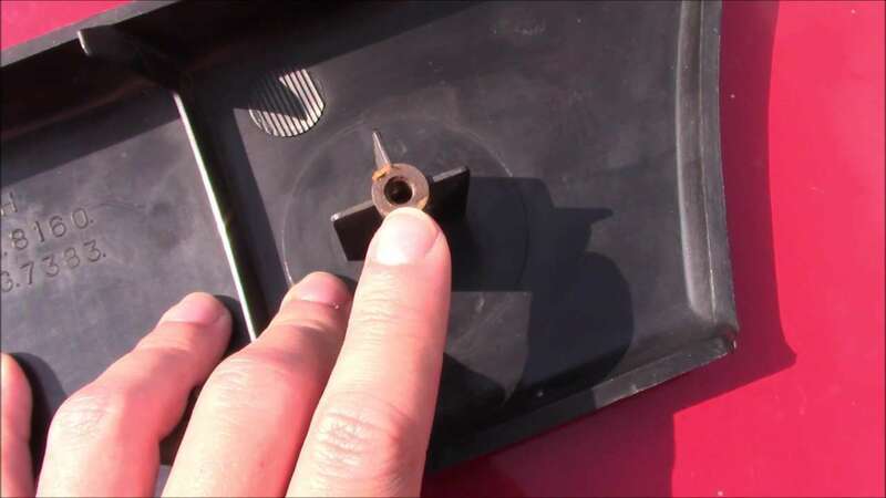

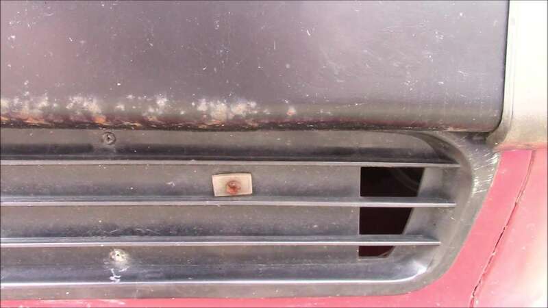

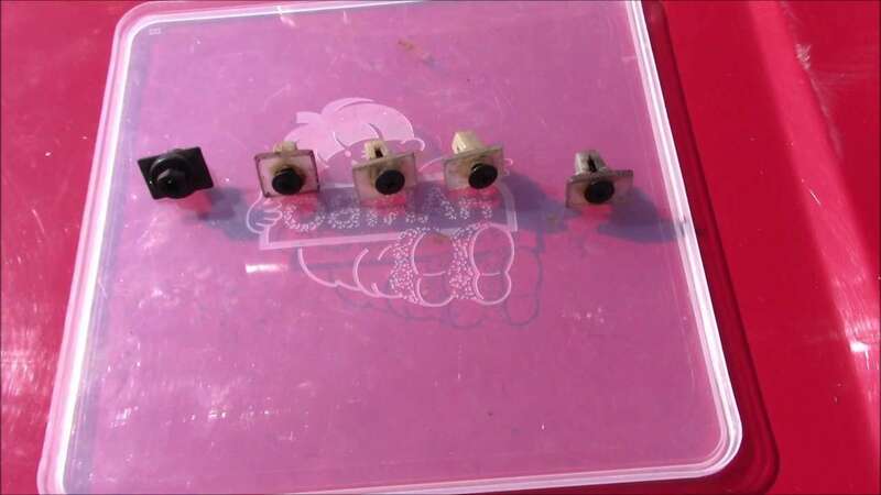

The old lower front grille on the Maestro is bust and repaired and needs replacing.  The fixings holding it on aren't original.
The repair works, so I can't fault the creator of it on that front, I can just do better.  First up is removing the four fixings that hold it in place, one at each end of the grille and two in the middle.
The passenger side one proved more challenging because the head had turned to rust.  The stack of improvised parts was curious too.
I'm not entirely sure what the wrinkle paint coated aluminium was off originally that was used to repair the old grille, perhaps some old electrical device?  They'd gone to a lot of trouble with shaping and cutting out holes for air flow, pretty commendable stuff really, just like that front wing.  Just seems a bit strange this much effort was undertaken rather than just buying a replacement.
Apparently, the original fixings are plastic with a push pin that spreads the legs on the back of the fixing to hold it all in place.  I didn't have anything like that so I reused the plastic squares from the old fixings, some grommet things scavenged from the inside of Princess doors, and some suitable screws.  These worked pretty well.
For a belt and braces approach I also used a couple of cable ties on the outer corners until I can get proper fixings to hold this in place, I didn't entirely trust the ancient plastic of the grommets I'd used and thought it sensible.  You can't tell I fixed anything, so this is definitely something I could have left alone.

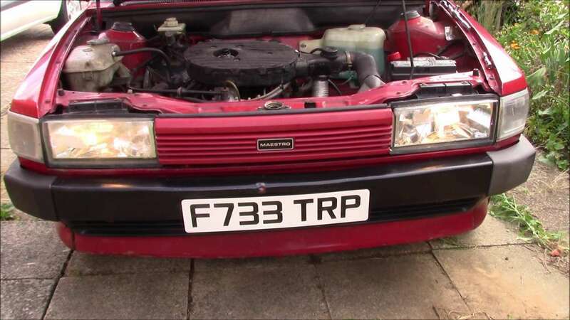

First bath of the year (for the Maestro, not me, we don't even have a bath) complete with wax, re-lettering of the tyres and even some tyre bullshit.  Found a suitable backdrop too.
I have been blessed with some time to get some write ups done so here we go, let's see how far we get.

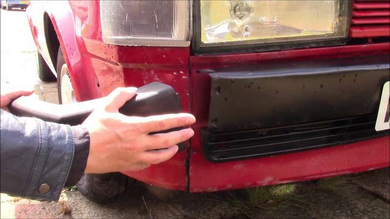

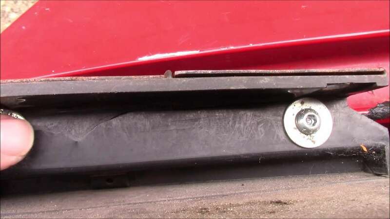

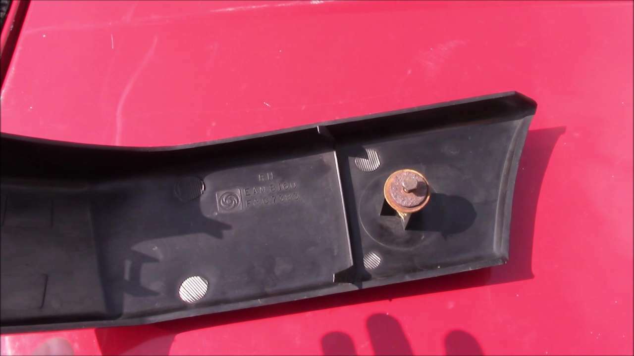

A common Maestro problem is that the captive nuts inside the bumper corners become un-captive after a while and fall out, then the bumper corners sag or worse, fall off.  To solve this, the first owner of this car had put a bolt right through all four corners and it wasn't what I wanted.  Got hold of some reasonable condition replacements and set to putting those on.  Here you can see the 10mm bolt and where it goes into the captive nut on the back of a bumper corner.
145445570_28-BumperCornerandHeadlights-1.thumb.jpg.3cfe01c786a57b665c648391083b0e8b.jpg
792486048_28-BumperCornerandHeadlights-2.thumb.jpg.9addeebec3e7e2ab9bd713ccff1d67d1.jpg
Normally you reach up into the inner wing from underneath and slot your socket/spanner onto the bolt blind and undo it that way.  Because of the way mine had been done I had to employ a screwdriver on the outside for the bolt head too.  No need to remove the inner arch or wing for this job, happily.  To refit, line up the moulded-in stand off on the back of the wing with the hole, put the bolt in loose to hold it all in place, and then push it on to the metal part of the bumper.  As you tighten the bolt everything will line up and you won't have to fight getting the bumper corner onto the steel bumper section.

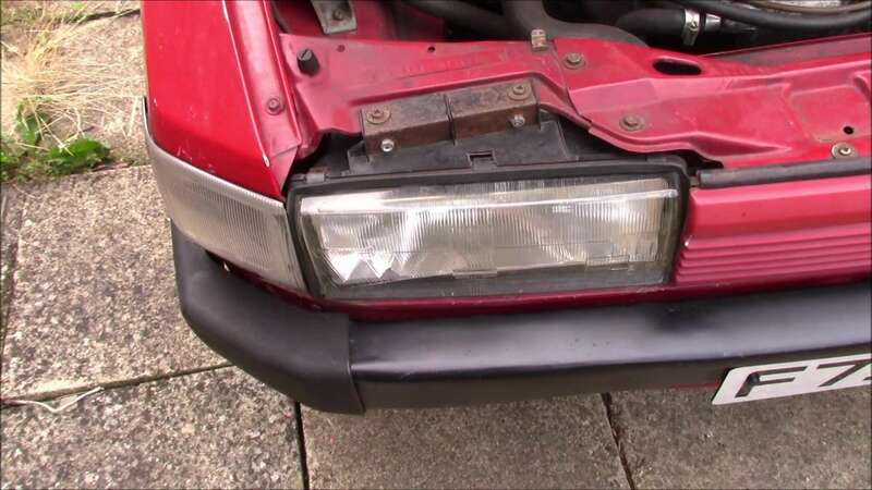

It's exactly the same procedure at the back.  Now lets move on to headlights.  I already knew my driver's side one was broken and had been repaired pretty extensively.  There isn't really any aftermarket offerings for Maestro headlights but there are still a lot of NOS and second hand ones floating about and they're not too expensive.  Picked up a non-matched pair, both with proper Unipart glass lenses, though I have some questions about where exactly the driver's side one was originally from since it had an odd issue.
259046851_28-BumperCornerandHeadlights-5.thumb.jpg.af55a15ba9d0b189b3031ce7b9df7a93.jpg
Long term viewers will know that this car has had a bump on the front drivers corner long in the past that's been repaired with an impressive dedication to not spending any money and a lot of effort which I can very much applaud.  Amongst the damage caused was the plastic of the driver's side headlight got smashed up, there's a substantial steel bracket bolted on to the remains and some further repairs I'll show you in a moment.

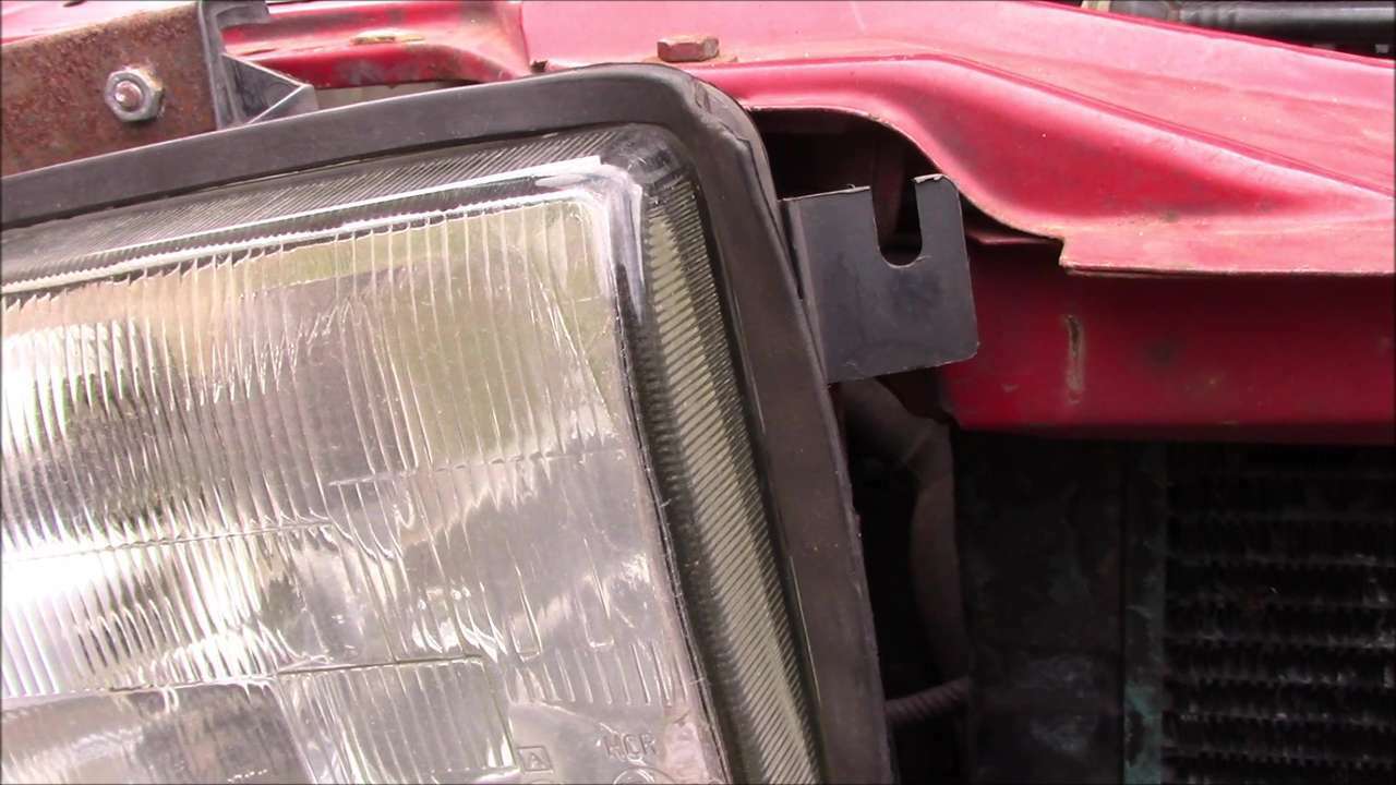

Weirdly, while there are these tabs on the headlights that look like they should locate on something, they don't locate on anything.  I did learn recently the same lights were used on the Leyland Roadrunner so perhaps they get made use of there.

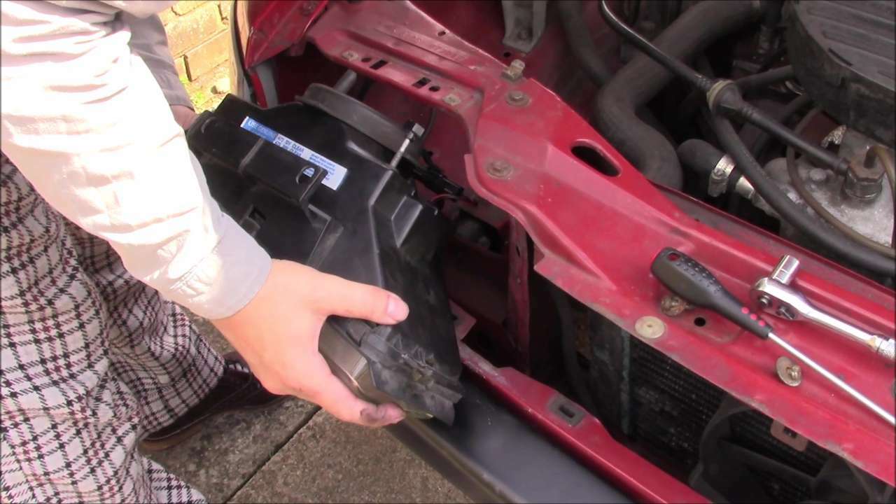

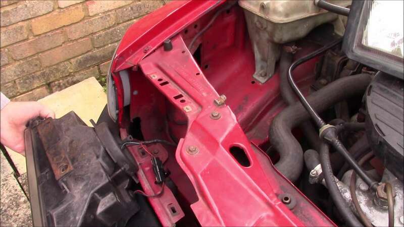

To remove the headlights it's just the two screws in the top that go into the slam panel. Once those are out you can wiggle the headlight out of its hole and unplug the sidelight and headlights.

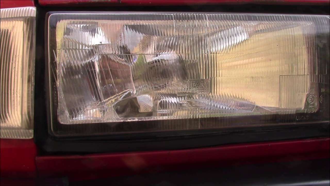

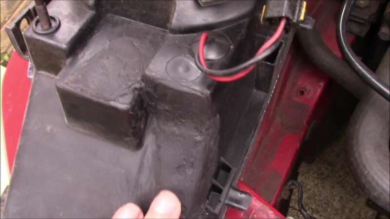

And now for a better look at the repair work on the drivers side headlight.  It's clearly been this way for a long time and I do admire the dedication to put that much effort into a repairing a part that's never really been difficult to acquire.
74492042_28-BumperCornerandHeadlights-11.thumb.jpg.0f57ec5e990697b447692fa82c1d7608.jpg
82672240_28-BumperCornerandHeadlights-12.thumb.jpg.90a5bd4f4059504ffd6c0873bee91de5.jpg

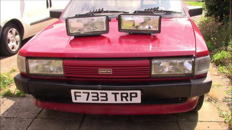

It was when I got the old and new headlights side by side that I realised I had a problem.  The passenger side, which has OEM hologram stickers on, is an exact match.  This side, which doesn't have those stickers, has no hole for the sidelight to go into at all.  The ring is stamped into the plastic, it's just not been cut out.
2104356499_28-BumperCornerandHeadlights-13.thumb.jpg.69ace49335e8a01d3213a6df2600861d.jpg

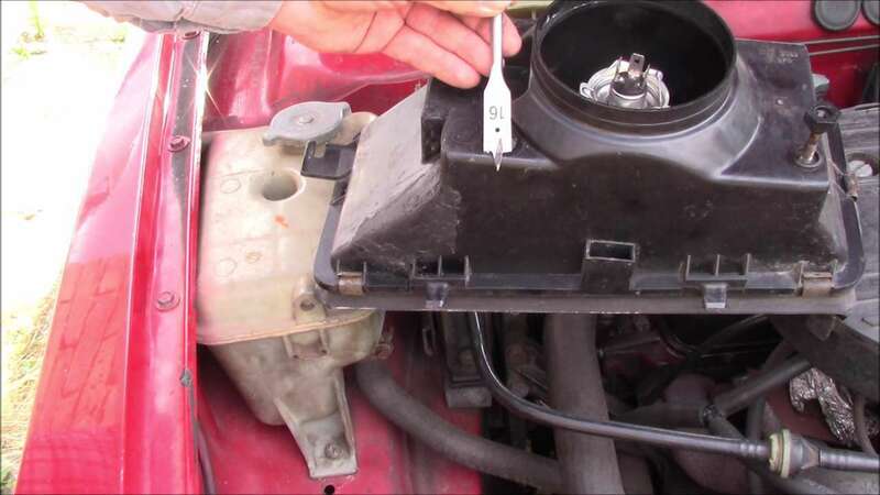

I found one of these types of cutting drill bit thingies in a size 16 did the job.  Never used one before.  It made a nice tidy job of cutting a hole just the right size in the plastic so I could plug the sidelights in properly.

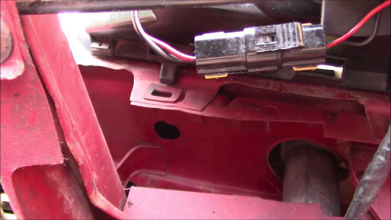

To refit the headlights, plug in the lights first and be sure to locate the little legs into the rubber grommets (which are normally black, these have been overpainted when the corner was repaired) on the valance.  Then wiggle it all into place and screw it down with the two screws that go into the slam panel.

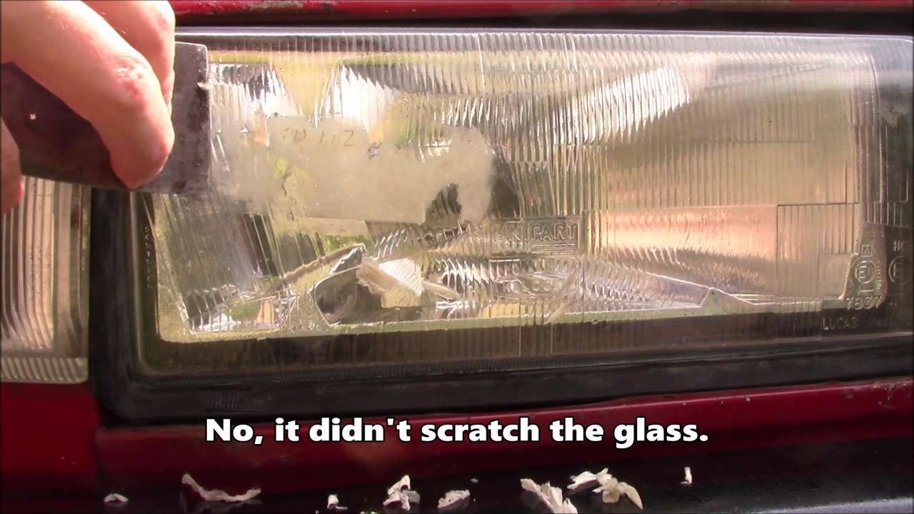

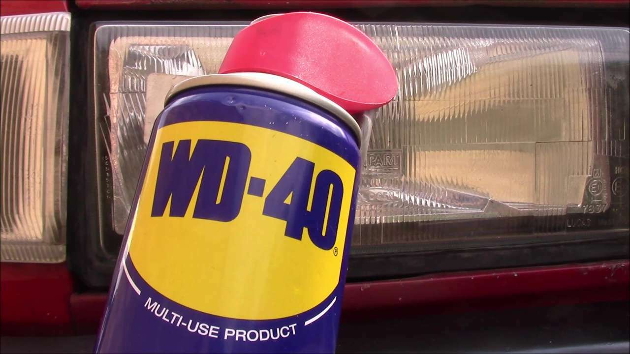

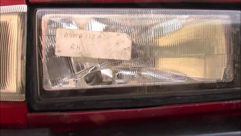

Almost finished.  As is usual, the headlights have stickers on from their time in stock.  These stickers are really old and really stuck on there, if they were on the plastic I would have left them.  Since they're on the glass lenses, I have to get them off.  Thankfully, this is easy to do.
1699611872_28-BumperCornerandHeadlights-18.thumb.jpg.38ba63df4239b6ec5393cdc4b3fef411.jpg
1597271477_28-BumperCornerandHeadlights-19.thumb.jpg.71eacf6b3f9a9c912ab11e2e90aa8e8d.jpg
Using a scraper (ideally a hard plastic one, I only had a small metal one to hand) and some WD40, squirt the sticker and surrounding surface quite liberally and allow the WD40 to soak in a bit.  Then get to work with the scraper.  You'll find it wants to scrape the paper off first and not really touch the adhesive until you've worked over it a bit.  Once the adhesive starts to come off, the whole thing cleans off very fast.  This is also a great way to get sticker remnants off glass and can sometimes even remove the ghosting you get afterwards.

Not only do I now have more broken bits eliminated, light output was much improved.  Sometimes the passenger one looks more 'crystal' than the drivers one, seems to be a viewing angle thing.  All in all, an easy pair of jobs that and ones that made the car just a bit nicer to live with.
