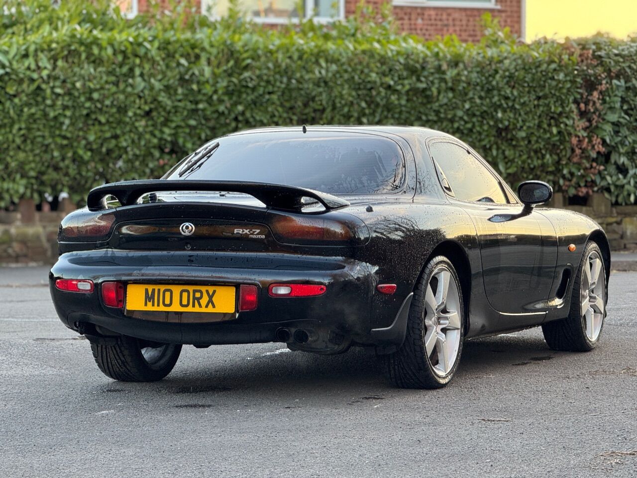

I really need to try something rotary one day.
From what I remember from a friend who had an RX8 obsession a few years ago, it's hot starts which tend to show up wear/compression issues on their engines at least rather than cold.
Jap stuff rarely really interests me for the most part, but I do rather like that.

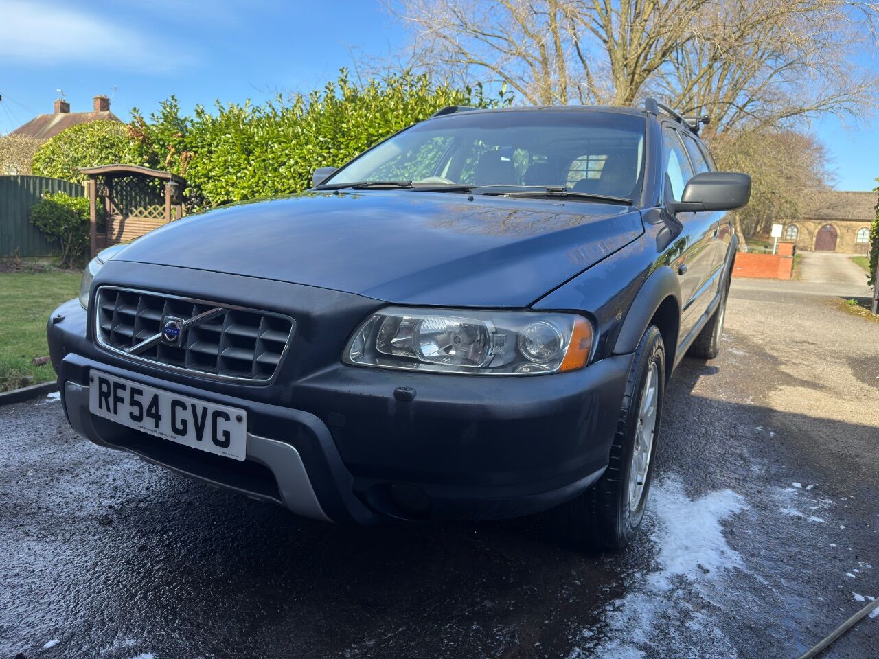

It looks very promising, my expectations for an £800 banger or £800 Volvo are already exceeded because it went over some familiar potholes and I barely noticed.

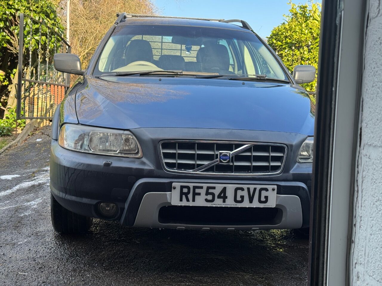

I do like the face on these. I've not really had much experience with them.
This end will be very useful.

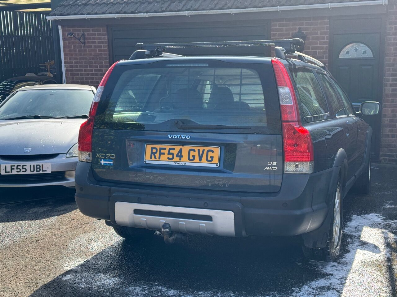

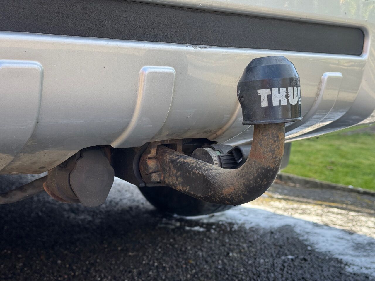

I like the Sweden sticker. I'm baffled by the three screws /through/ the plate holder though!
Really does look like a straight old bus, so mechanical maladies - if they appear - won't be wasted repairs.
Big face though. Need to move cars around the driveway.

I have tyre profile envy.  The 17" wheels and 45 profile tyres are the one thing I'd happily change about my V70.

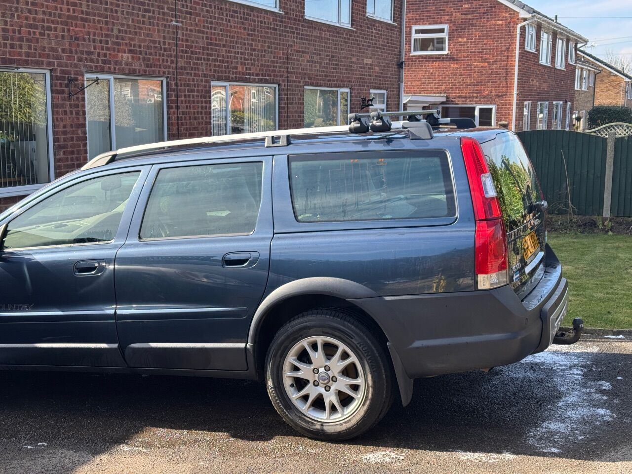

I think they made the first job the car had to do actually tolerable - V-drums to Hucknall. Blindfold someone and drive them down the A608 and A611 and you could probably convince them you'd taken them to 1980s Lebanon. In fact in much of Nottingham, where there used to be some shops...

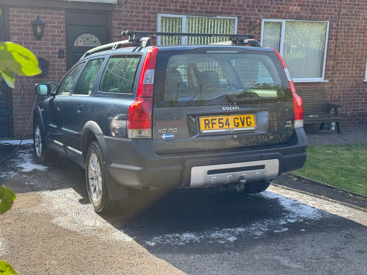

The actual tyres are less good, they're pretty scrubbed. So the car's copybook for the first 24 hours is:
Broken things - very, very few indeed. One piece of speaker trim, no lights on the radio buttons, a small tear on the driver's seat. It's held up amazingly well for 20 years and 233,000 miles. The wiper blades are aero but horrible so I'm binning them for Bosch ones, but that's normal behaviour for me.
The RTI pop-up navigation thing works but can't read the disc, so I can't visit 2008 England. Shame. However, the display pops up and drops down, and while the LCD is tired AF and has ghosts of menus past to haunt me, it's the perfect frame for a VolvoPi or whatever the kit is. Because yes, there is a custom board to interface a Raspberry Pi to a Volvo's LINbus or whatever it's called, and use the RTI display for Pi-hosted in car tech. As long as the car doesn't crap itself mechanically, that'll be happening.
Driving - a bit sluggish off the mark, and there's a fair amount of intake noise. I think it's missing some sound insulation on the driver's side or there's a pipe amiss, so I'll do some checking. Gears are smooth, it coasts and drops into neutral at lights so is VERY easy to drive in town, and no odd noises or flaring/shuddering. Sweet.

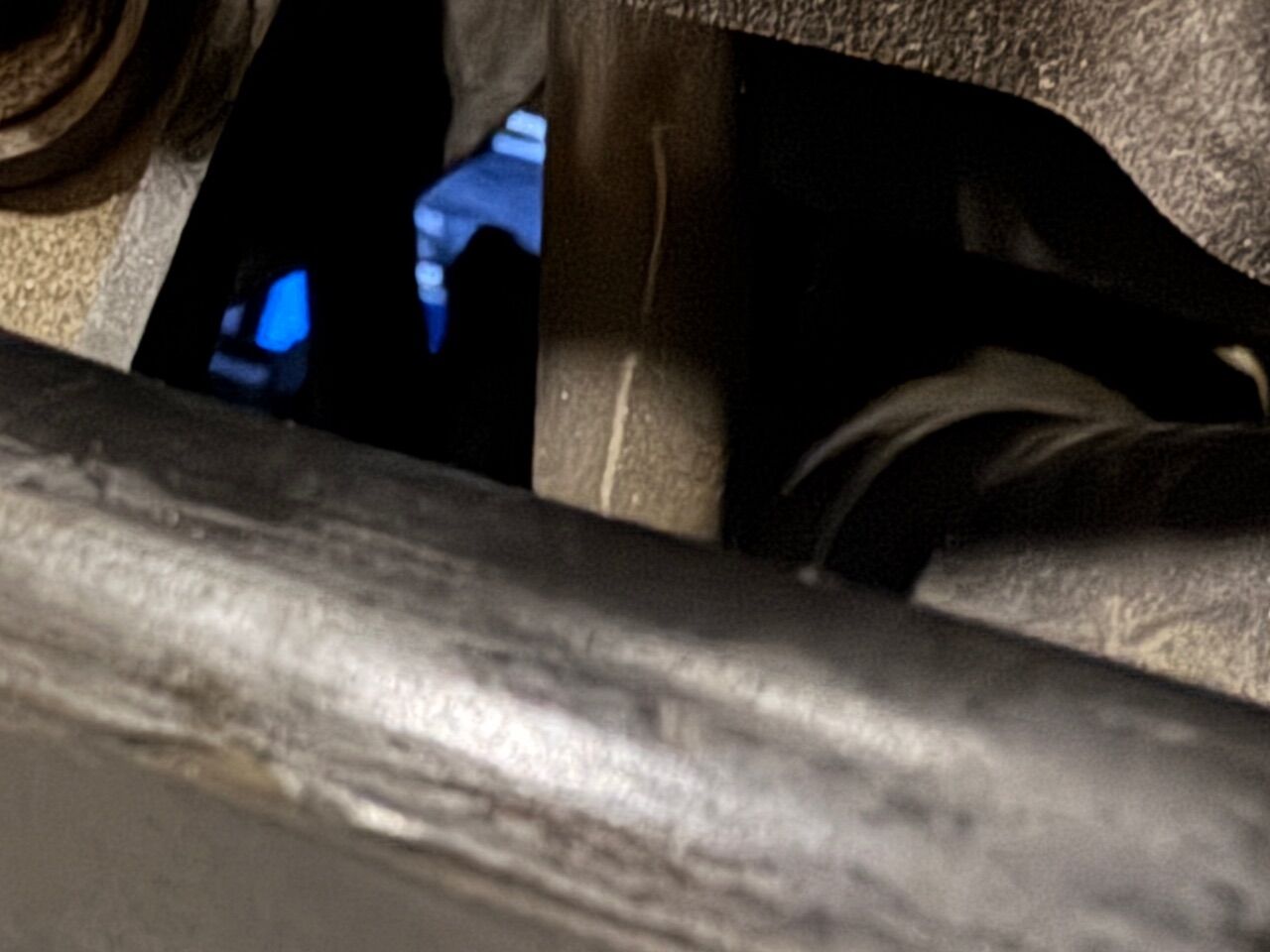

There's some wheelbearing or diff noise, and the steering is quite heavy – I'm not sure it should be THAT heavy at low speeds, but I also don't care. These are prone to rack leaks and big bills in that area, I believe. Also not sure the alignment is very good given the scrubbed tyres, maybe something needs a kick.

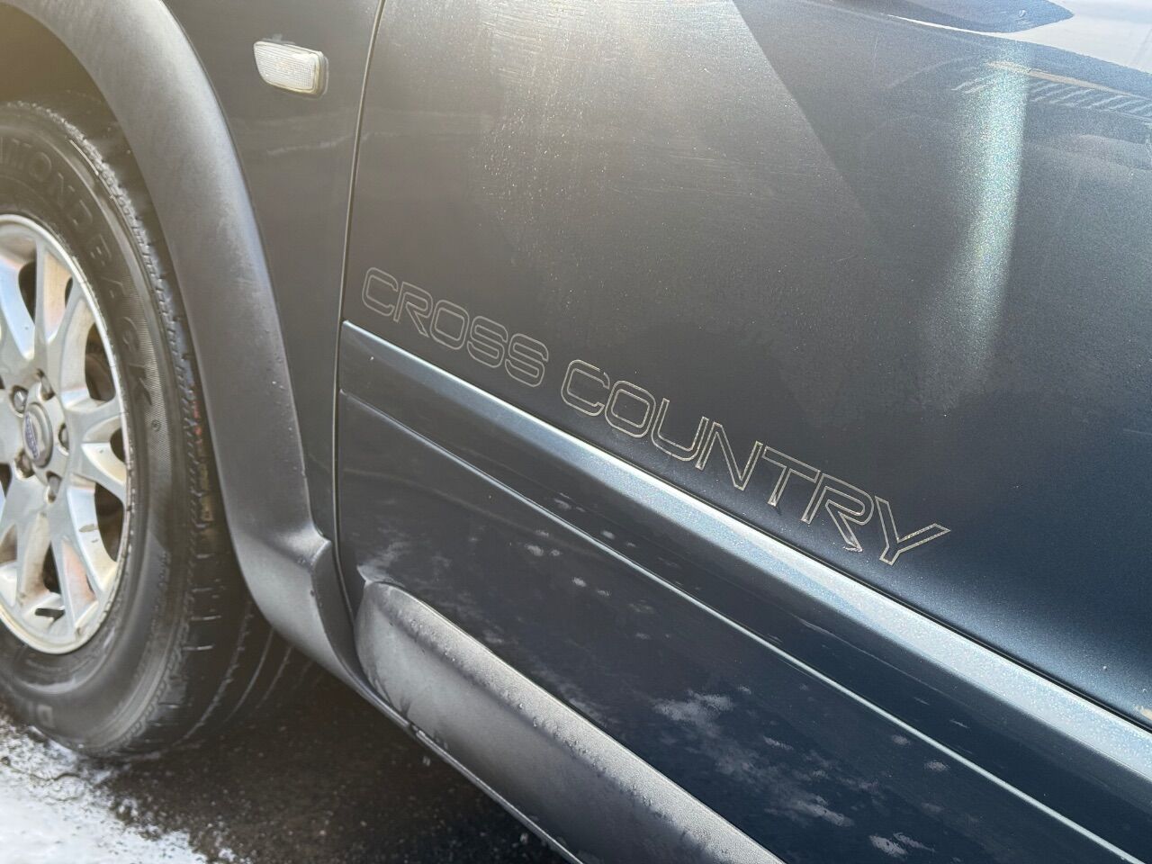

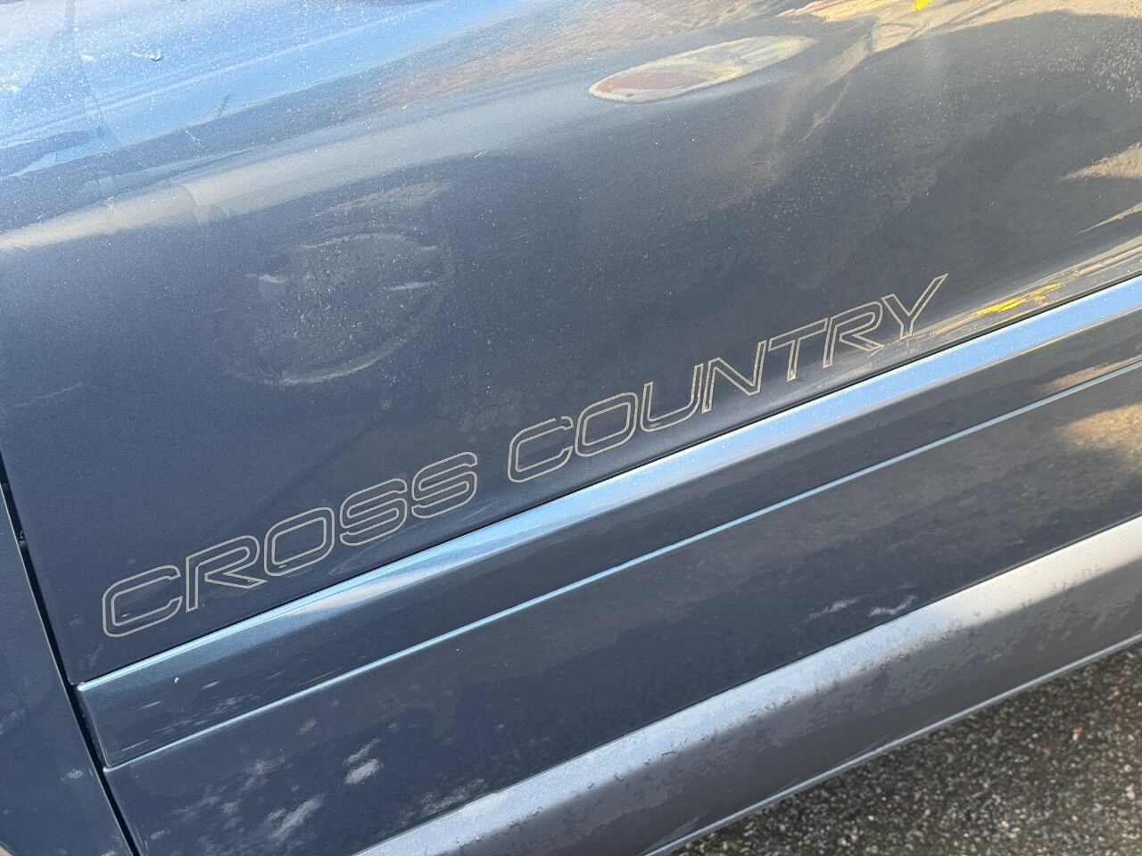

Body - I've washed it, with a sponge, and I can't see anything of concern. Can't even see any windscreen damage, which I may be missing due to not putting contacts in to check, but it's not bad.
The headlights might need something reconnecting, the really bad rippled road made them shake - but they're very good.

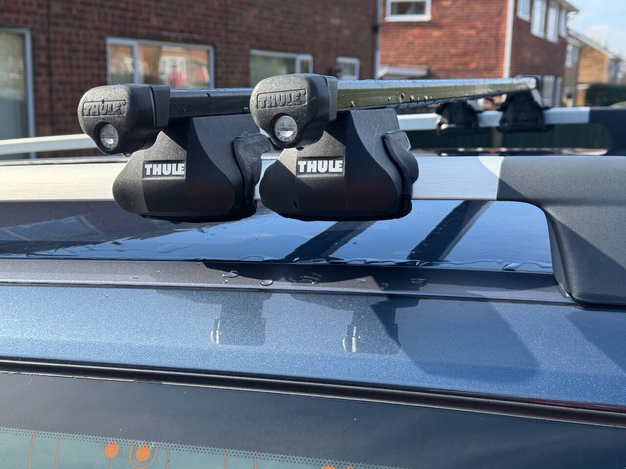

Lesson learned - don't put two roof bars right next to each other at the back of the car unless they're designed to work like a spoiler, like a Jeep Cherokee. These are not designed like that. My ears hate me.
For the money, it's a brilliant old Volvo. I suspect buying a £2500-5000 'nice' used one would merely accomplish needing the same sort of maintenance such as bearings or whatever, but on a car that was too expensive to walk away from. And even if I do need to poke about in the engine bay sometimes, it's very clean in there.
The steering will always be ponderous at low speeds or on windy roads. They are much better on fast roads.  The rack issue is well known and amplifies any slack in TREs. Scrubbed tyres are the norm. If it hasn't had them then the subframe inserts are worth doing as they do tighten the front up a touch and are an easy job.

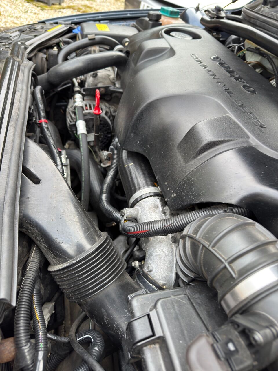

Here's how clean the engine bay is:

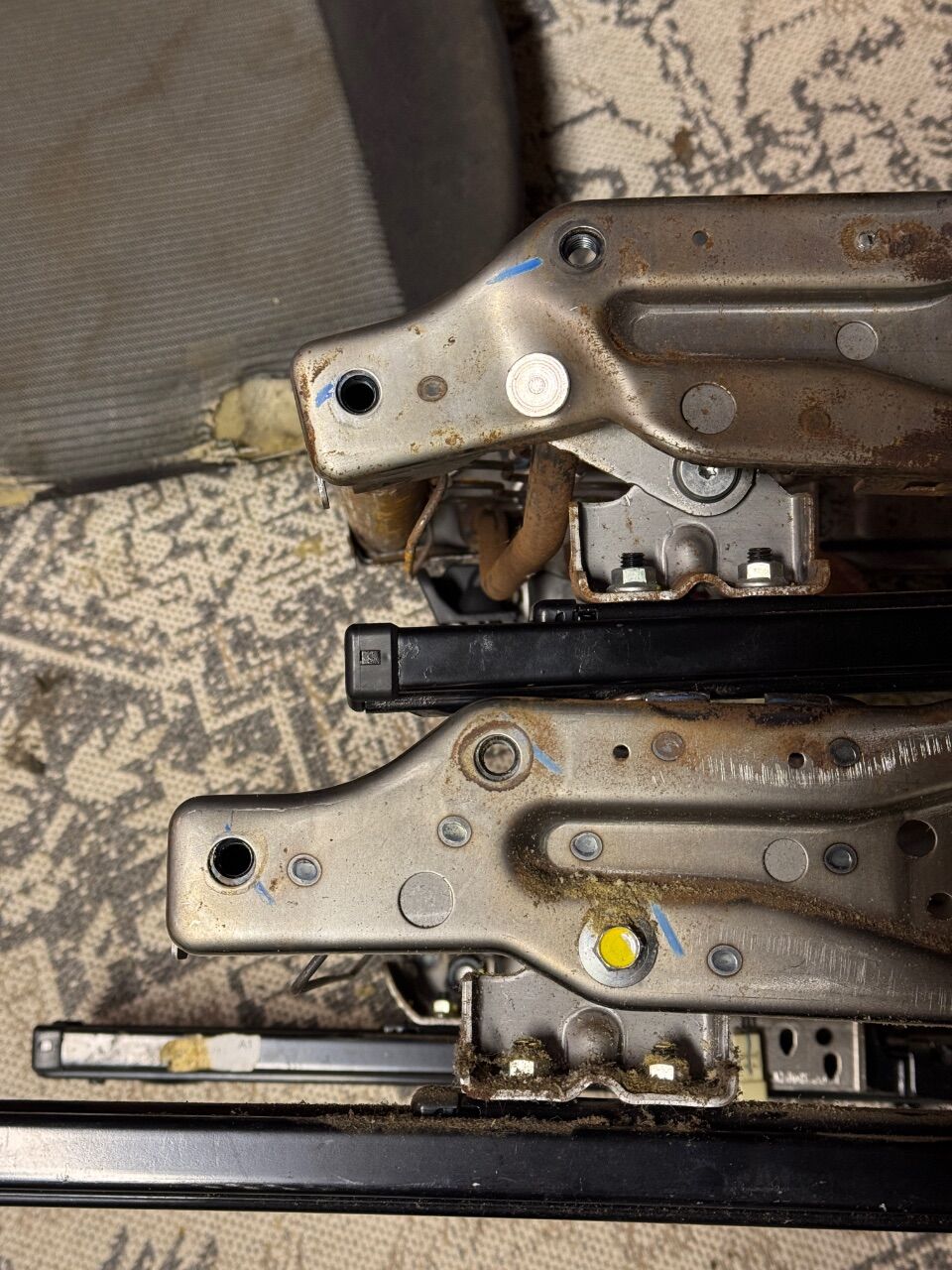

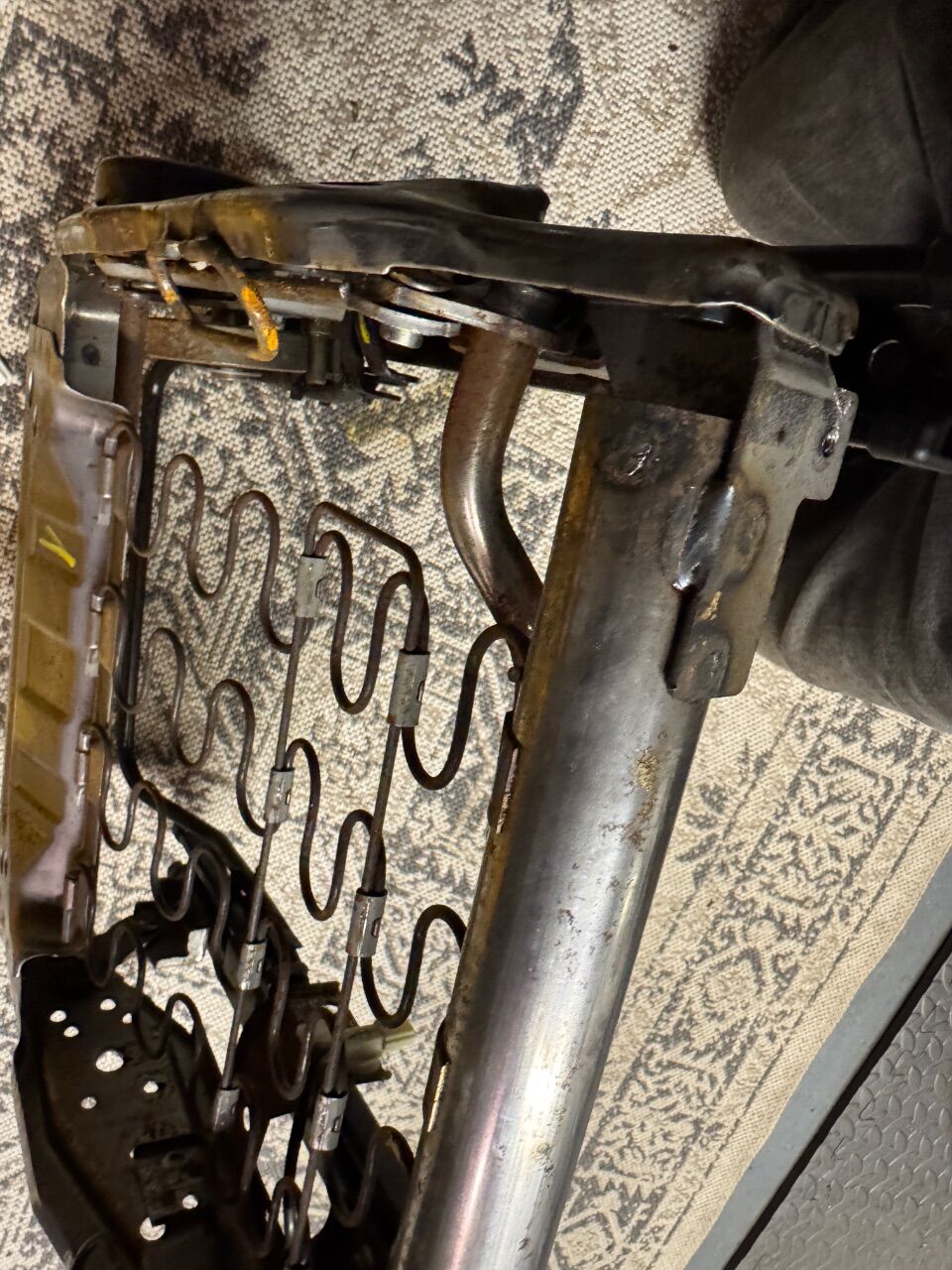

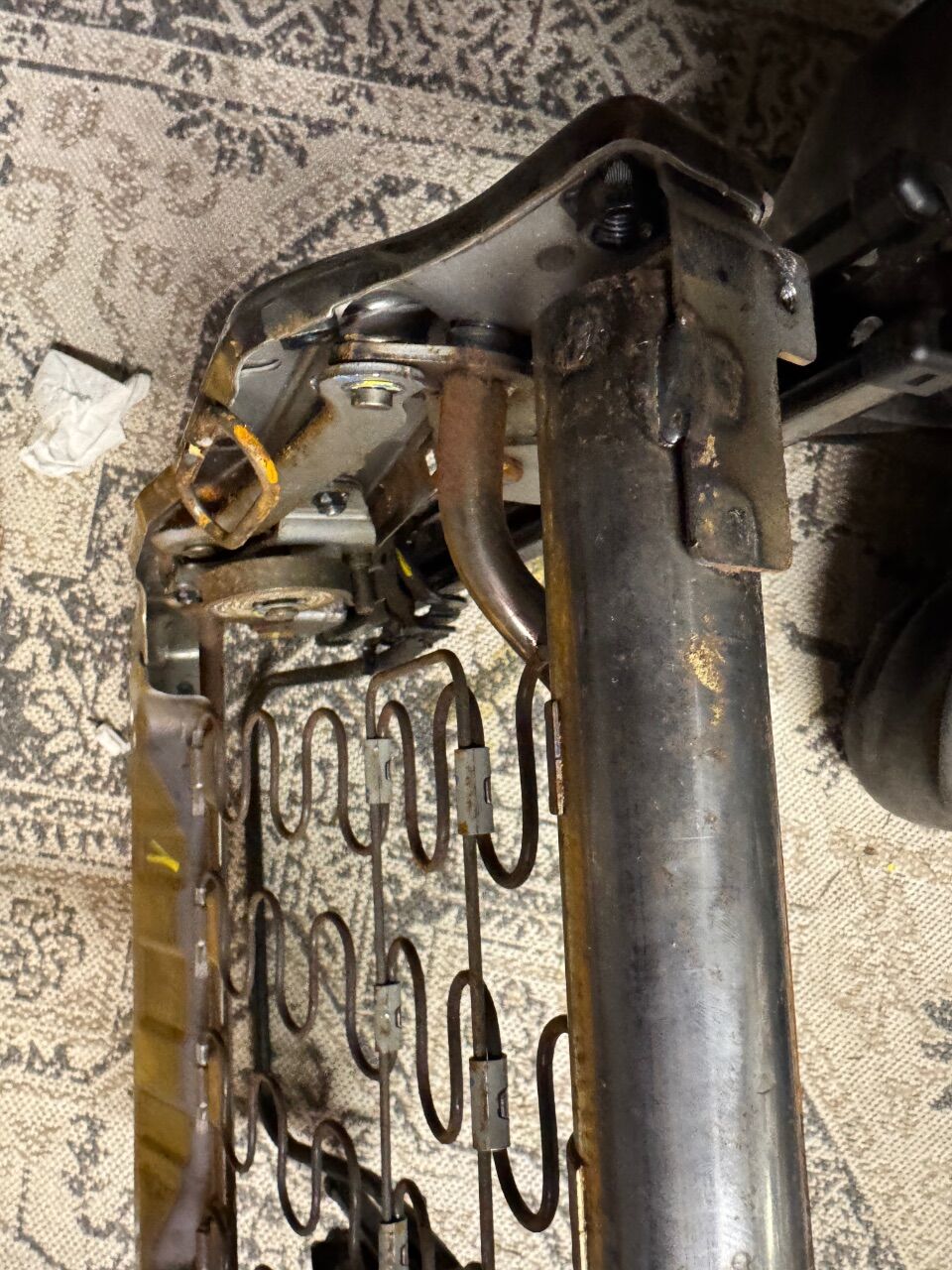

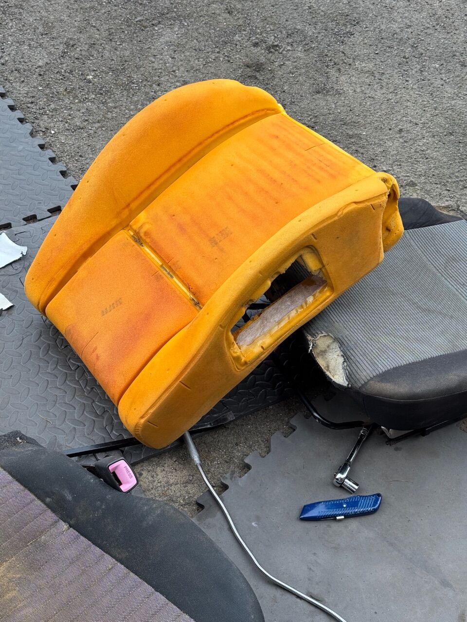

When you see a picture of a car breaking on eBay, ask the seller what the seats are like, they send a picture that looks like seats, you agree a price, then collect them and...
IMG_8651.jpeg.f2dc62f9609fe5d9882f76355cab6aaf.jpegIMG_8652.jpeg.f07af5733db59c53fb17b7a3917107a8.jpeg

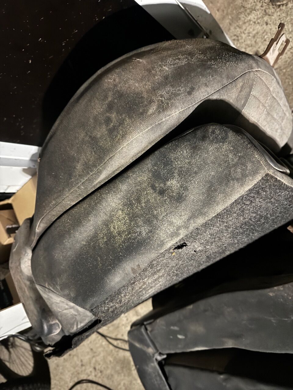

All the metalwork rusty, filthy fabric, and the driver's seat back was bent and bent so far back the headrest mount was also bent.
Having driven an hour to collect, paid two weeks before because eBay, I accepted a £50 refund in cash - thinking I need to swap the seat back and fabrics to make a good set.
But now I do it, I realise that fuck, if this seller thinks this is anything but scrap and worth taking money for...

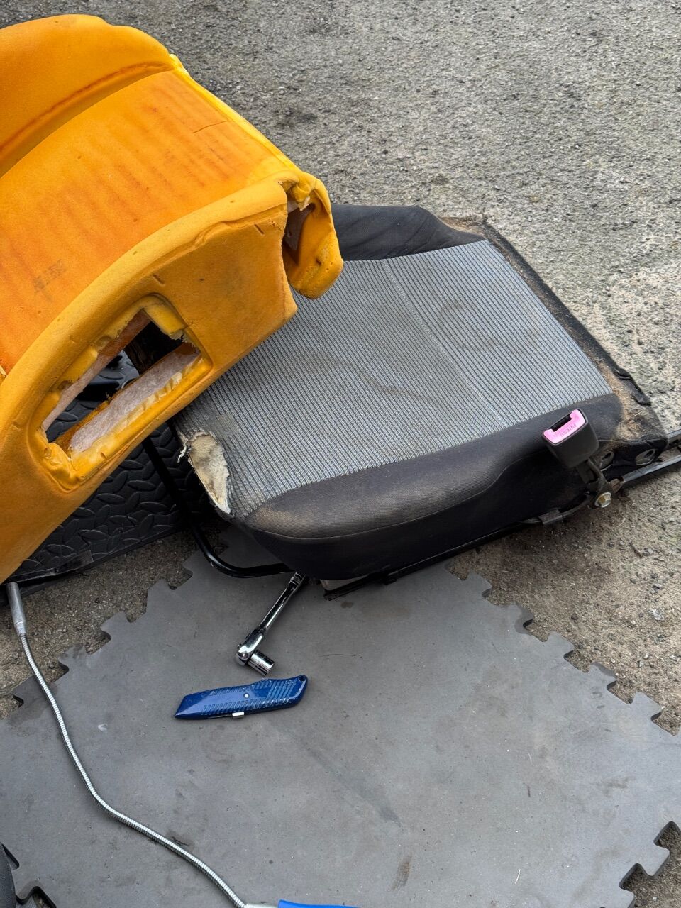

The old seat base wear.
Driver's seat, back removed
Cleaned seat back fabric.
The back seats
When the seat base cushion was removed, the seat base frame is also fucked.
Lower frame doesn't have height adjuster. I don't think I can swap the perimeter frame so it's all scrap 😕
How the hell does someone bend a seat that badly?!

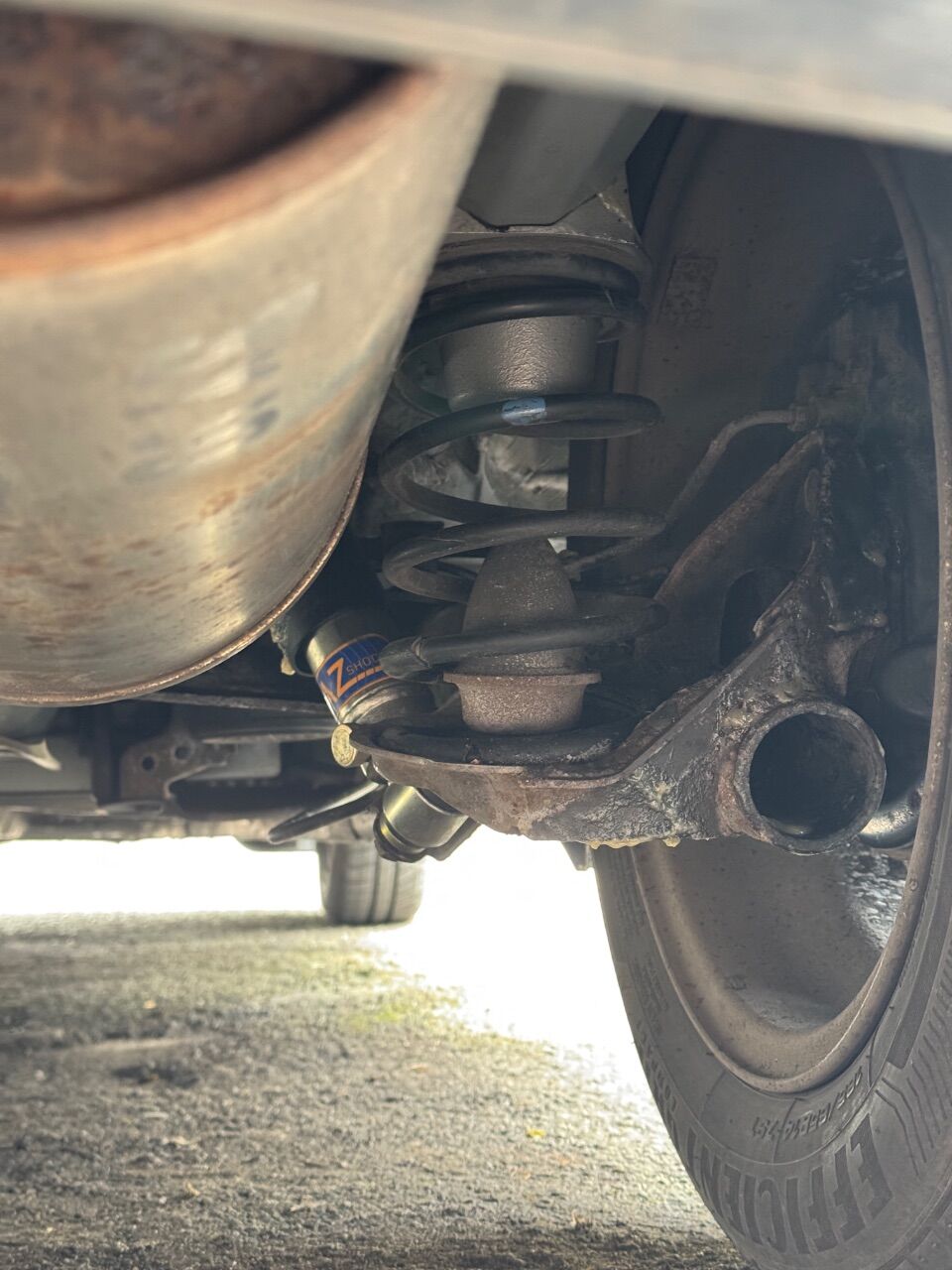

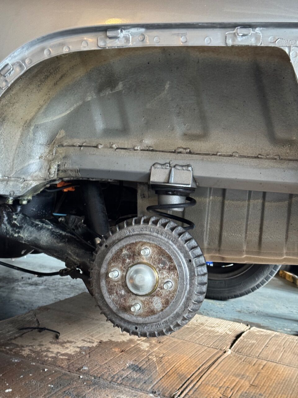

So I did some suspension work.
Not on the C3.
Why does it only have one nut to hold the strut? It feels like it's going to fall out of the car.

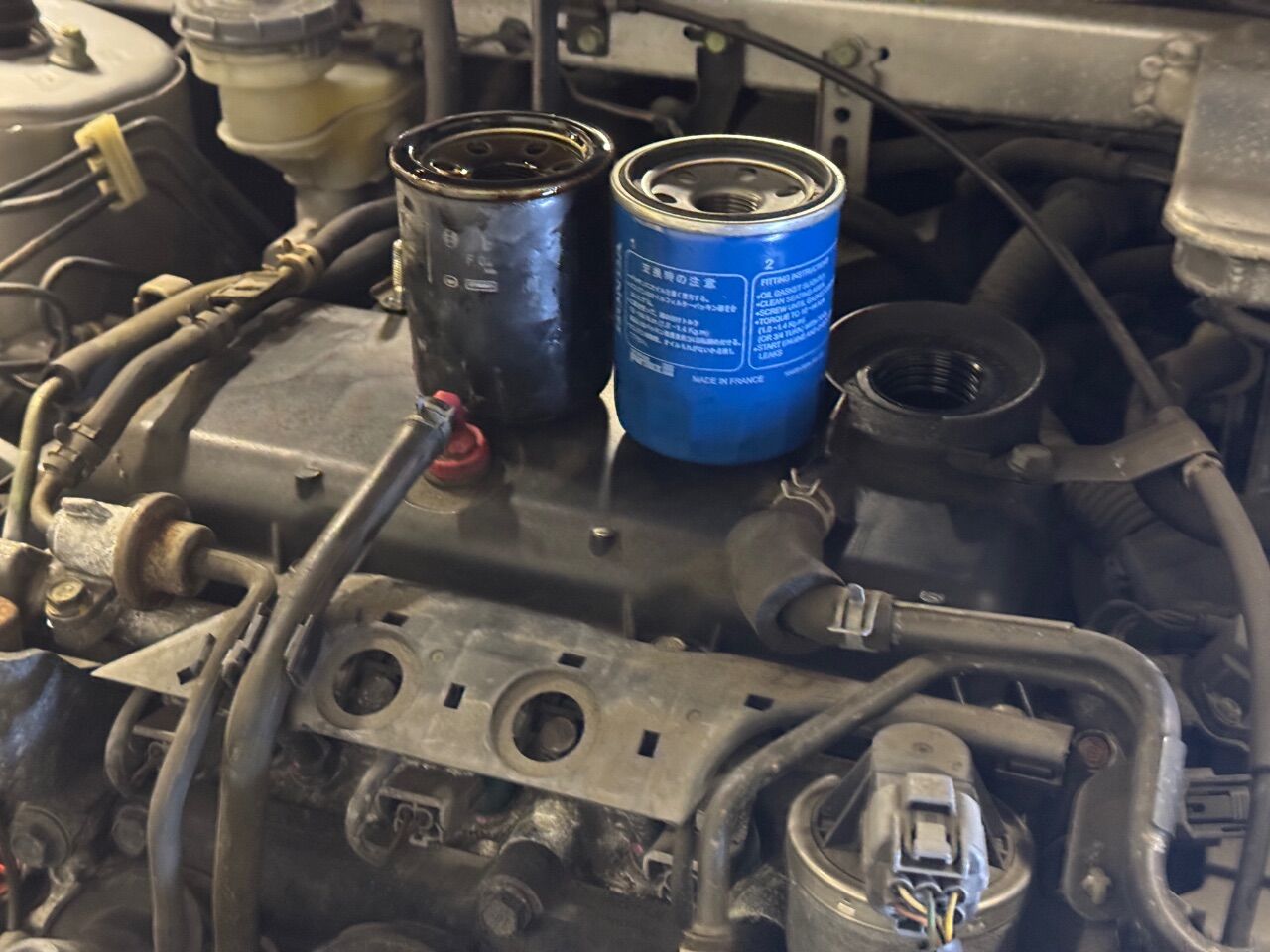

Well, after an oil change. You can do the filter from above without removing the undertray.
If you don't like having skin on your arms.
I am proud of the blue genuine filter.
Shame you can't see it.
Not much oil in these anyway.

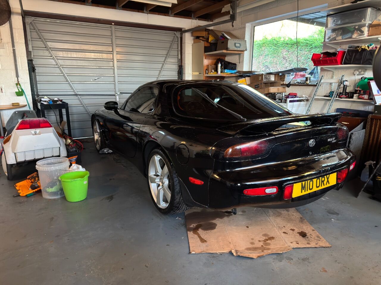

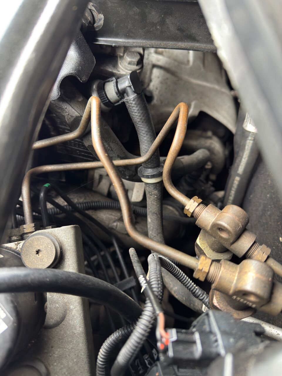

Side quest: RX-7.

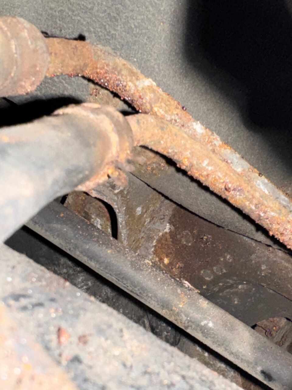

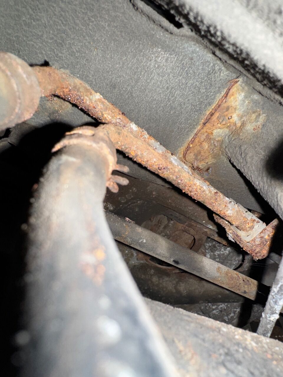

The fuel lines are grim.
Second hand set on eBay is £50. I think worth it, new is NLA.

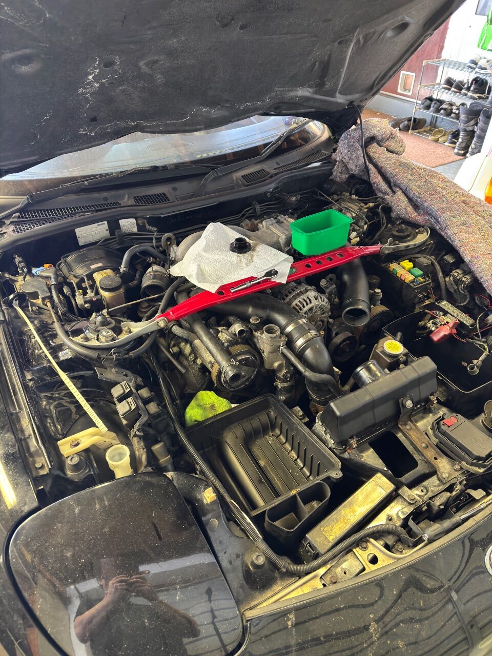

Why do I have two pressure caps instead of one pressure and one filler?
I have a new throttle cooling hose to fit. It's at the back of the engine. Procrastination is likely.

There are 19 clicks so I have set it "full stiff then back 9 clicks" which I think would be halfway.

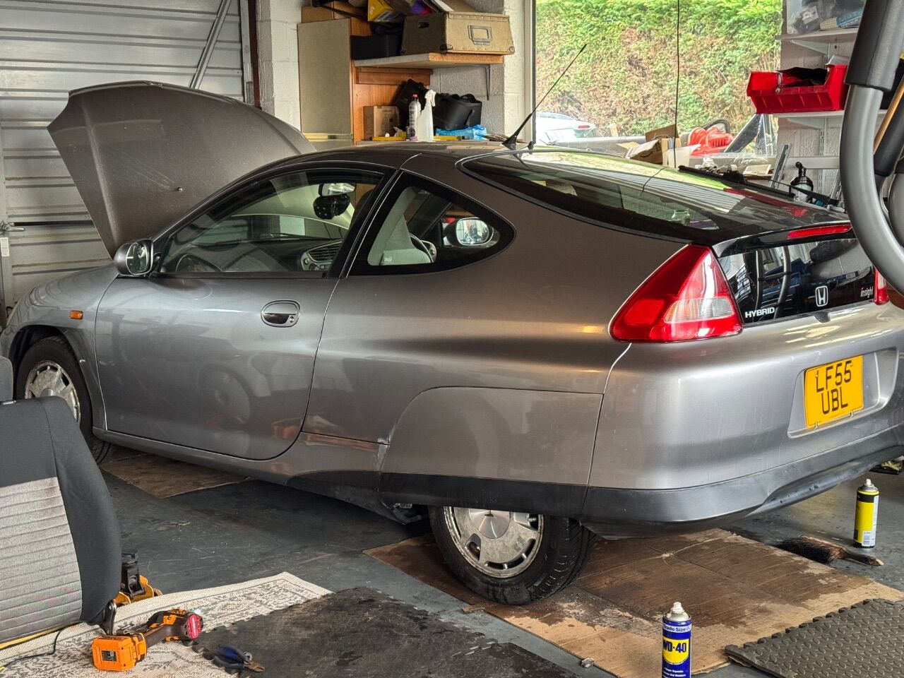

  • Bear changed the title to Bear's bangers: Insight gets GAZ'd for spring. Well, shocks. Bonus blue content.
Other side done, and a quick test drive. Wow.
Completely different, totally eradicated the hard crashy bumps and seems almost forgiving of pretty horrid bits of road/carpark.
Could dial it softer a click I think. But the handling also feels sharper.
I think front dampers need to happen - but it's not like they're being bolted to a rusty wreck...

Two-up it was still a bit harsh so I've clicked it two notches softer and it now feels even better.
I wonder how quickly GAZ make the special-order front struts for it, and how much. I reckon those, and making sure all the bushes are up to scratch, would be a big win in refinement.
In my experience with the Maestro (Spax rear, Leda front) "halfway" setting is still too stiff. I think they're on 3-4 clicks off minimum.
But may as well start the experiment halfway. They look easy enough to adjust.

I went softer by two more clicks and that seems better - I may try another click, but it seemed good.
They offered a choice of dampers for standard or lowered springs and I've got them for standard - I noticed an American Insight owner has GAZ and they have blue covers and bushes, so I feel shortchanged by the boring black ones, but i wonder if that's how they identify track vs road versions.

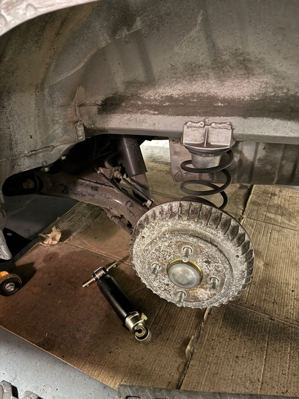

Today I need to figure out how to take the strut off the C3 (either way I need to get that broken coil off there) and then, depending on how the day goes, I think find out how much I'll get for scrap for the C3 and the Sedici. I've wasted far too much time and effort on that Fiat's manky seats and done nothing with the clutch, and I can't see myself fixing the clutch in five seconds even if I do finish the trim transplant and somehow bend the driver's seat base into a usable shape.

Let's deal with the driveway blocker
It will never grip a sparkplug again. But that's what magnets on sticks are for.
The droplink is not helping matters here - it's trapped inside the spring.
Just smashed my hand with a hammer and crowbar trying to get the strut the last bit out of the knuckle.

It was a puzzle worthy of the Crappedon Factor (a pigeon keeps sitting on this car and so... that is a risk).
But I managed it.
Persuading the strut out of rhe hub while the spring was tangled in everything was not fun, and eventually I had to sort of unwind it around the droplink and brake hose.
Then the sensible "allen key and spanner" did not want to undo the top mount so I pointed the impact gun at it and it was easy.
I've ordered a new spring, and if I don't have appropriate spring compressors I do have disc-type ones and some ratchet straps. I did have some proper ones but I bet they're somewhere in a shed near Grendon Lakes now.
