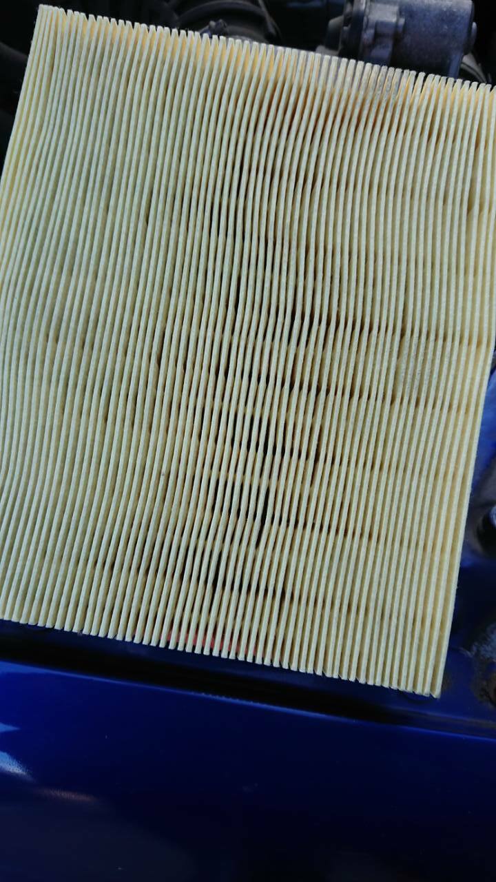

Had a fiddle done some light tittivating
Bonnet strut doesn't
Air filter is new

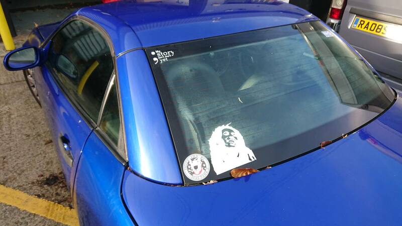

Lots of stickers were removed
And leaves dug out of all crevices and drains

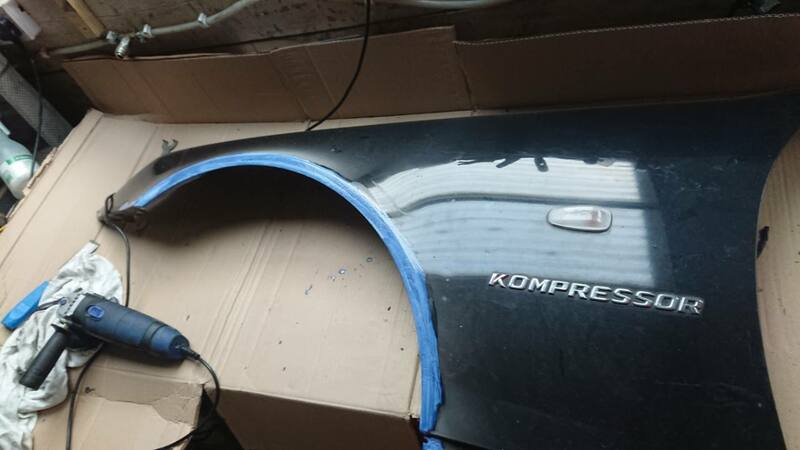

Started sorting out the tatty wings. Took off the better, drivers side one as it needs repair and derusting and as @NigeTsaid above, the front mount bracket was a sorry state
DSCPDC_0003_BURST20201128132139245_COVER.thumb.JPG.6e6de8ea1945724e15131f7064ec817f.JPG
As you probably won't be surprised to hear it fell off when I wobbled it.
It's far from a tail of woe though as everything else seems fine, even the stuff buried under wet mud. Pleased with that. And happily I'm now able to weld, so game on.
Cardboard template
Looks sensible
