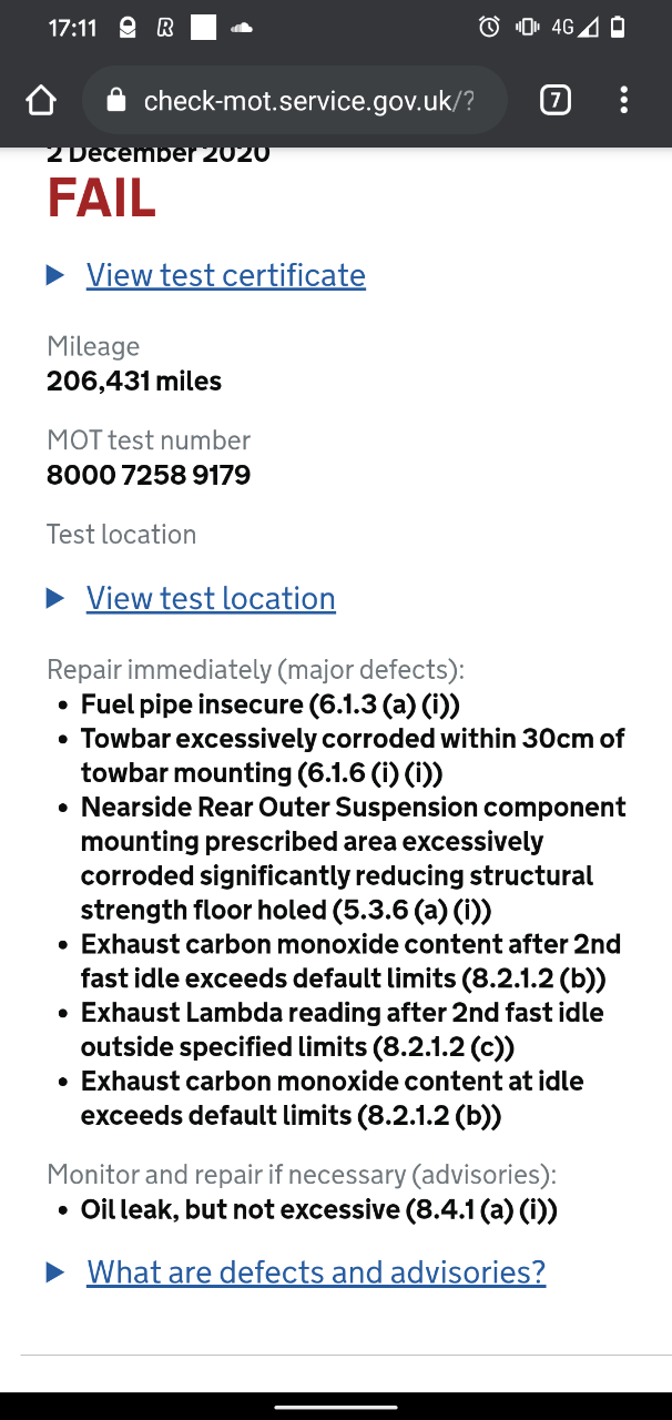

Not the end of the world. I think the ECU coolant temperature sensor is making it run rich but do you have any other ideas @Burnside?
Coolant temp switch isn't a bad shout, as you say. Not sure what else to suggest to be honest.
I was advised though that previously blanking the EGR valve off doesn't help with the emissions, but I'm sure it wasn't working correctly anyway. Otherwise maybe worth checking around the engine bay for any failed/ brittle pipework etc.
If you google up the C18NZ engine code, there might be some helpful information / advice from forums like the CavalierMK3 OC which is free to register too or MigWeb.
Edited by Burnside
error
Me and @juular had a look at the grot and it doesn't seem too bad but I'm worried that the rich running has destroyed the cat.
I am hoping that changing the ECU coolant sensor at a minimum and maybe the O2 sensor beyond that will get the emissions under control. Pretty hopeful the Cav will live on!

So long as it's not been misfiring the cat will *probably* be okay.  The O2 sensor would be more likely to have been taken out by it as they can get clogged.
It's unburned fuel causing them to overheat or oil contamination that really kills them.  Bit of slightly rich running won't likely have done any permanent harm unless you've been smoking like a knackered diesel for months.
You may find you need to get it blazing hot to clean some of the crud out though, so a good blast back to the testing station would probably be a good plan.  If there's a high speed road involved cruising in 4th rather than 5th for a while is a good bet.
...Just like clearing out a DPF these days!
As above a damn good thrashing before the mot may help, I had a car fail emissions, we removed the air filter and it passed! So could be worth checking the air filter isnt ancient
These early CAT cars with their single point injection were always difficult to get through their emissions test.
The CAT needs to be hot, really hot.  If the MoT tester hadn't already realised it was going to fail on rust, he might have tried to get it through by heating it up a bit.  I think a new CTS, Lambda sensor and a proper Italian tune up, would give you a fighting chance.

I did give it a good thrashing pre-MOT but it ended up sitting there for longer than expected, the tester couldn't suss out the immobiliser.
Looking at the corrosion, it's just a small section at the towbar mount and a section of boot floor. I'm thinking a cut out and replace job would take me an afternoon. The car doesn't look too bad apart from that.
Driving behind it for a bit, it does smell a bit rich.
@Lacquer Peel I think you need to book an MOT further away and rag it up the M9!
Good luck!
Yep, the Lada was like this.  Horrible red numbers everywhere until we held it at 3500rpm for about five minutes - then almost instantly all the numbers dropped to near zero (except lambda obviously) and turned green.
The tendency for earlier cat cars to have the cat quite a long way from the engine really doesn't help in this regard either.

I'd definitely do as others have already suggested above and give it a decent drive/ thrash before putting it on the emissions tester. As the places I took it too, always ment a quick dash up the A38 just before it was tested so cat / engine was Red Hot.
Maybe worth cleaning out the injectors or running redex etc through the injection/ carb unit and giving it some beans.
After doing some thinking, at the last Mot it had with me. I had a new lamba sensor and front downpipe fitted as the pipe was blowing and in turn affected the emissions reading.
An thinking back some more, the Cavalier had some previous trouble getting through the Mot on emissions about 4/5 years ago. Which was after sitting for about 6 months due to having to wait until I could afford the welding it needed. So I had a brand new TYPE 2 spec cat fitted which wasn't a cheapo jobbie which sorted it. Also worth checking out the manifold in case of a blow/ leak too, as seam to remember that was also the other problem it had, along with the cat at the time.
