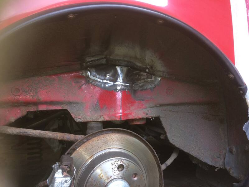

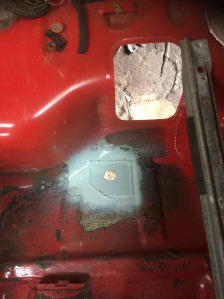

I knew it needed welding on the rear chassis section in the wheel arches and the rear shock mounts too. This was always going to be a sod to repair, and a job I was dreading. I stripped the interior, fuel tank and axle in readiness for what lay ahead.
And again, got prodding
FFS
Decided to just cut the whole sodding section out and make another one. Thought it would be easier than spending my Spring under the wheel arch patching.
Had to also replace the inner tub behind it too!!! Makes you wonder how rusty other 900’s are under the carpets….
Can't argue with “Nearside Rear Suspension component mounting prescribed area excessively corroded significantly reducing structural strength inner arch / chassis area corroded and holed (5.3.6 (a) (i))” 🤣

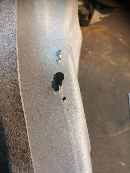

Got the axle blasted and POR-15’ed whilst it was removed

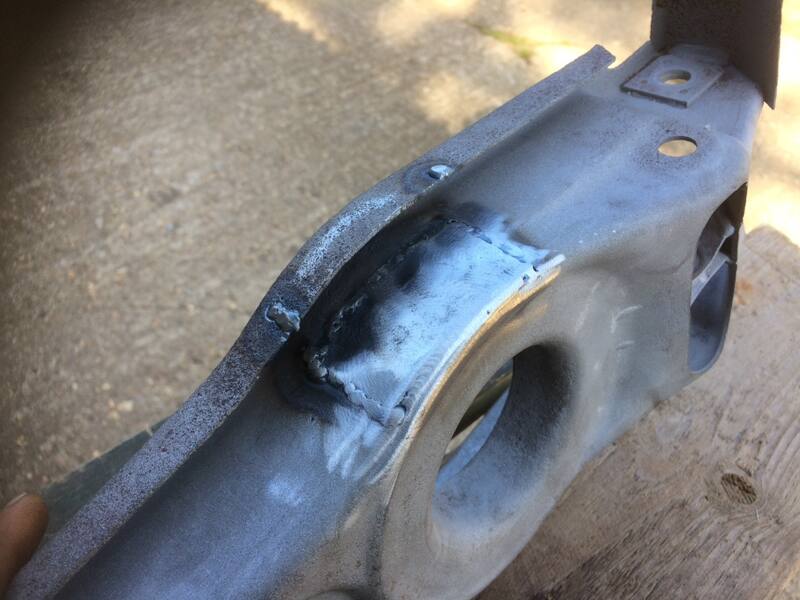

Spot of rust needed sorting on one arm before paint

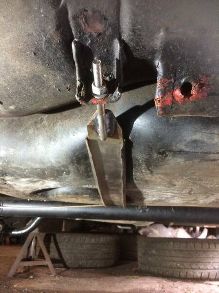

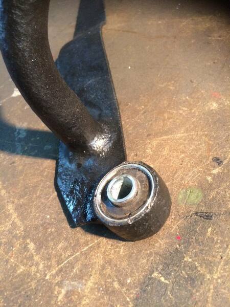

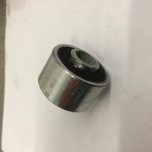

Made these bushes for the rear ARB, and also made some stainless tank straps (if anyone’s interested I can make more of either 😉)

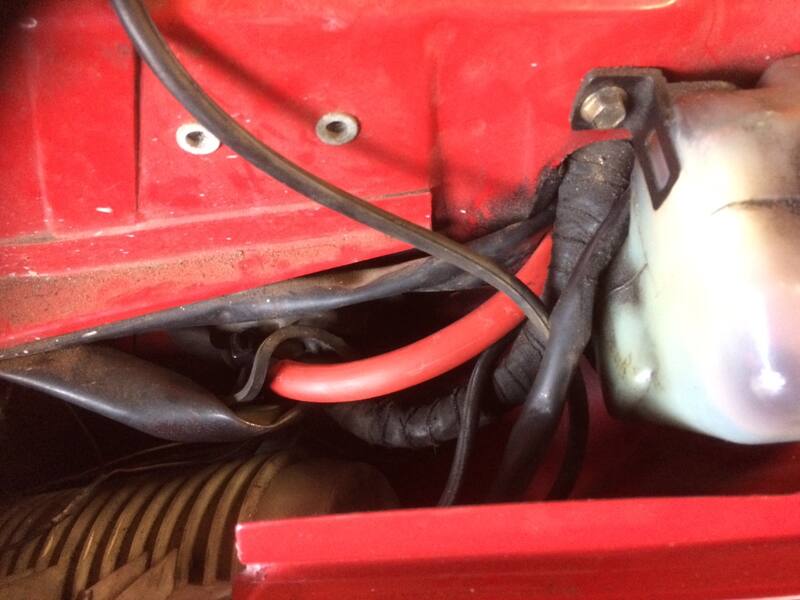

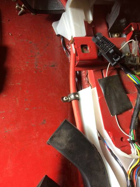

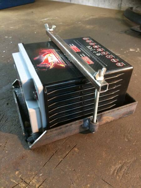

Relocated the battery to the boot. The stock location is about the only part of these car’s otherwise fantastic design that I dislike. It gets hot near the turbo and I want to make or buy a 3” elbow in the near future too. Made a nifty battery tray for a small glass mat battery which could go under the boot floor hatch beside the spare wheel.
(soon discovered the CCA wasn’t cutting the mustard so sent it back and hacked the tray up to fit a conventional lead acid one)
Although not shown, the main cable has a fusable link and master kill switch fitted.
