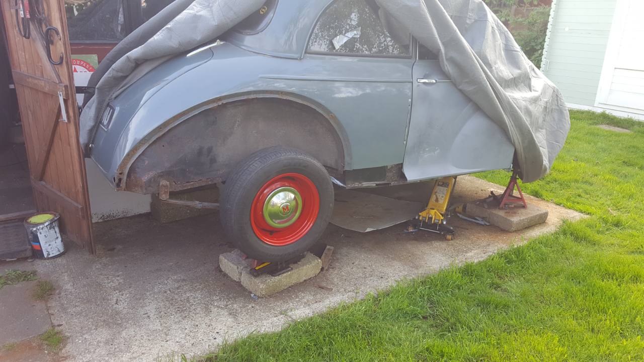

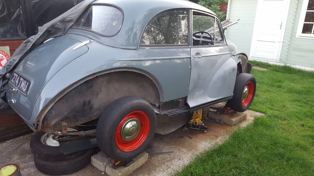

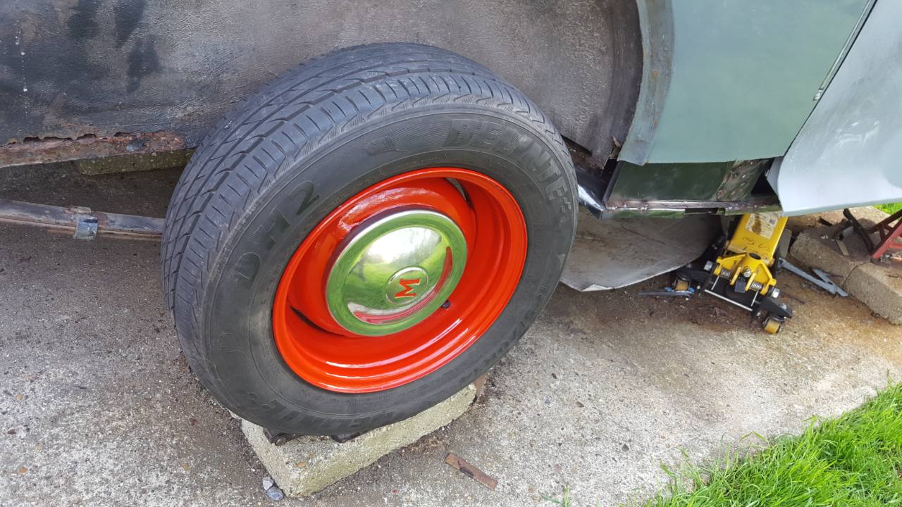

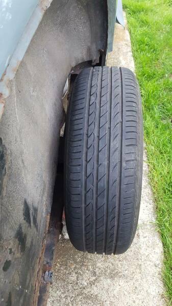

Joey spud Posted May 28, 2021 Author Posted May 28, 2021 I popped a 185/70 x14 tyre and a stubby valve on the Frankenstein wheel today and was pleasantly suprised that it only needed 10 grams on the back of it to balance it up. This is exactly the look i was aiming for. JeeExEll, catsinthewelder, Rusty_Rocket and 13 others 16

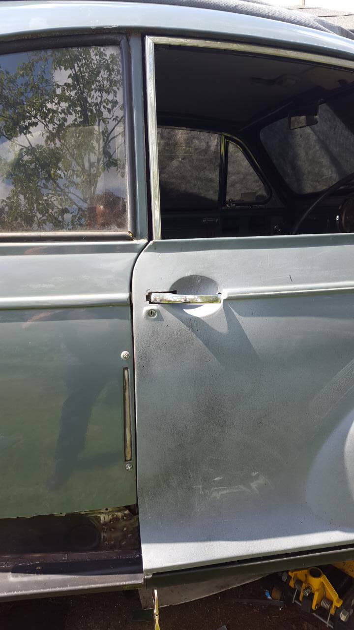

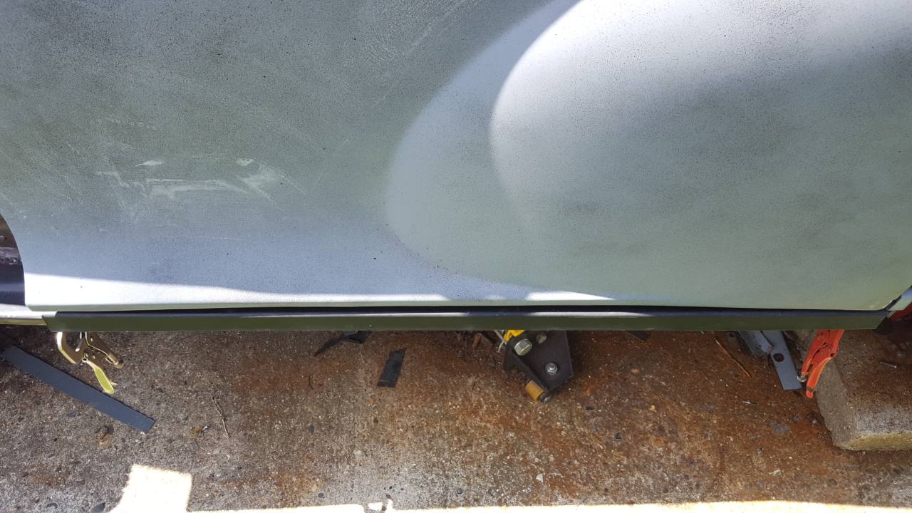

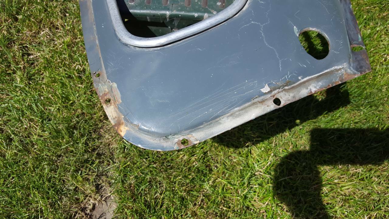

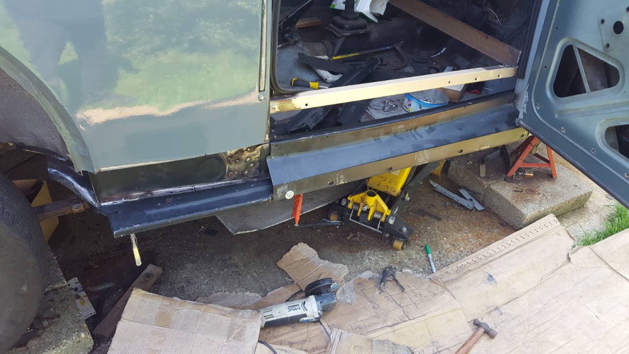

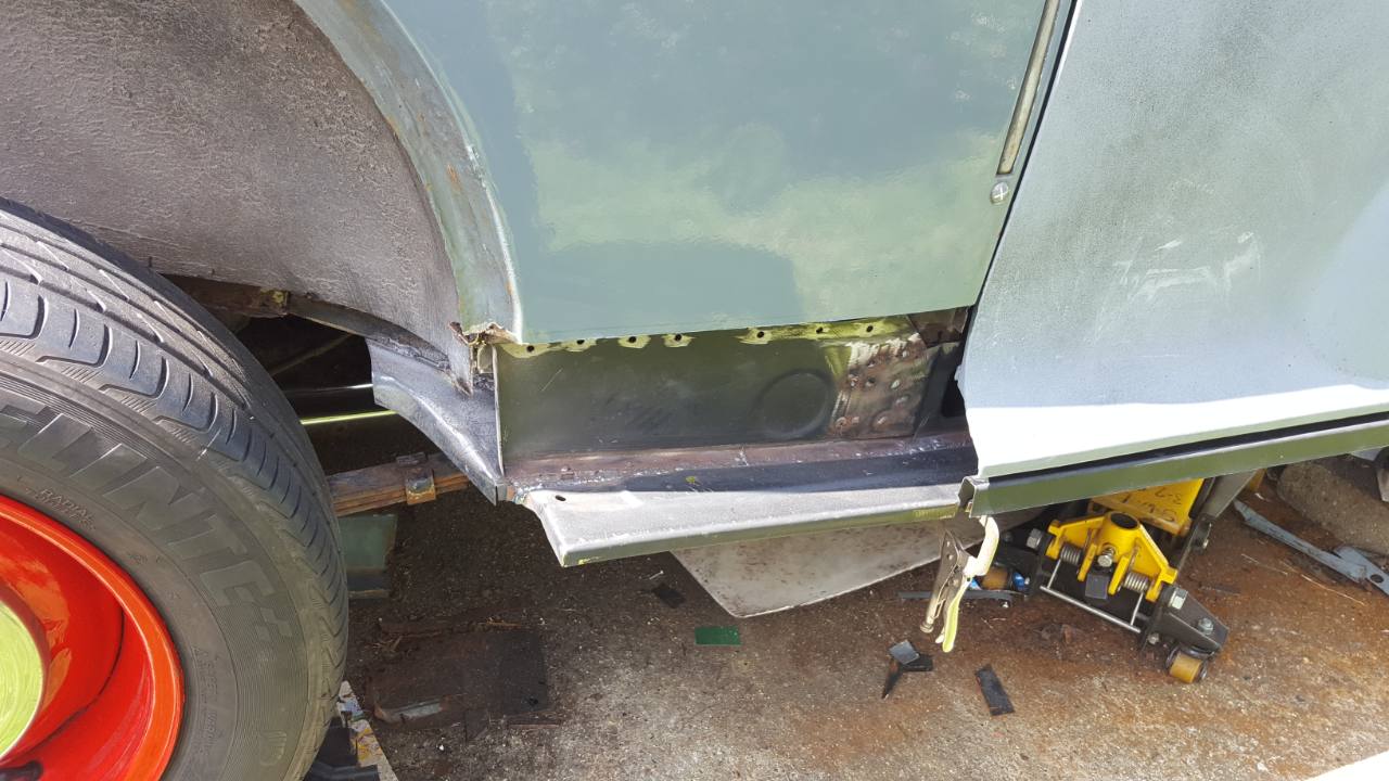

rusty998 Posted May 28, 2021 Posted May 28, 2021 On 5/9/2021 at 8:47 AM, Joey spud said: While i had a couple of hours i did a bit more reassembly of the drivers door. Luckily Boris came with a full set of new window rubbers including the quarter light ones. These with the aid of a bit of liquid soap fitted very nicely. I fitted the frame to the door and everything still opens and shuts ok but the frame is quite close to the top edge of the B post,maybe i can tweak it better when the car is back on its wheels. One thing that i have noticed is the door skin repair panel i slaved over fitting is a bit pants in the squareness department. Its rear edge wasn't folded square when it was formed and now the door is on the car it is quite obvious as the lower rear edge of the repair panel starts to taper away from the B post by about 8mm at its bottom corner so that'll have to be rectified at a later date too. I would try a shim or two on the lower hinge to open up the gap at the top of the b post slightly, it should also line the top of the door skin up with the rear quarter panel line just under the window, this may through the centre body line out though but I'm sure it can be improved on, the reverse rims Look really good by the way Joey spud 1

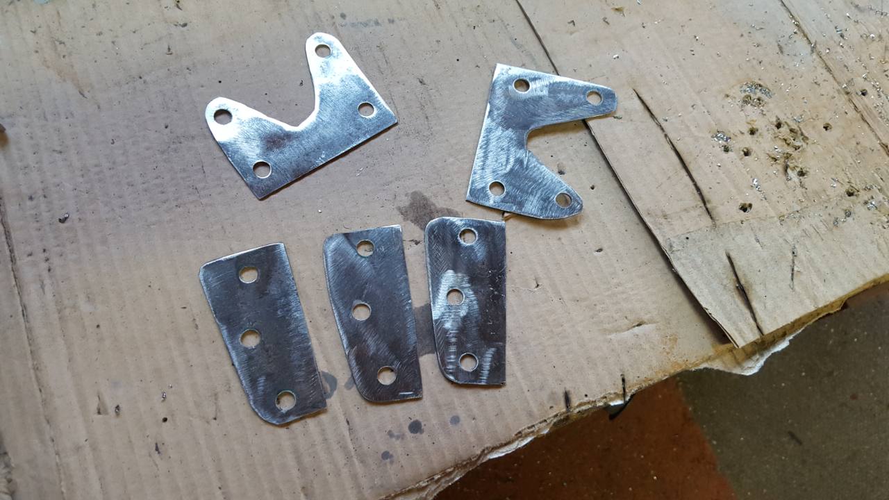

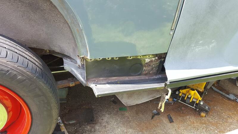

Joey spud Posted May 29, 2021 Author Posted May 29, 2021 I think you are right about adding another spacer to the bottom hinge. I did make some hinge shims out of 1.2mm zintec but only fitted one on each hinge,i may well make up some thiner lower hinge shims at some point once it's back on its wheels and i have fitted the front wing see what the gap is like there too. Also i think when i replaced the bottom six inches of the door skin i have accidently introduced a bit of a twist into the door as well. rusty998 and Banger Kenny 2
Joey spud Posted June 12, 2021 Author Posted June 12, 2021 I was iddly thumbing through Lindsay Porter's Morris Minor restoration book that Christine of this parish gifted me (he hasn't been on here for months is he ok does anyone know?) and it showed a dodge to improve door alignment. Basically you place a socket over a hinge fixing bolt and try to close the door against it a few times. This action changes the shape of the doors frame which is especially useful if you bottom hinge had previously been seized for many years. I think that's as good as i am going to get with this door. I have done a bit more welding and added more new metal (a sort of sill to door closing panel this time). So far the all the panels i have purchased came from Andy Eggleton and have been concidering their cost fine but this one didn't fit within a mile although some of that may be down to me not triple checking alignment before welding it all together but with a bit of trimming and reshaping i got it on in the end. Now that this panel was fitted i could trial fit the door step and the outter most trim panel that should fit snuggly below the door. It fits inline with either end of the door well but really exposes just how badly i cocked up the fitting of the door skin repair panel as the door curves in about a quarter of an inch at its centre. But to be fair i think once it's painted and sitting back on the floor it will be fine,i was never looking to create anything like a perfect car as there's loads of them out there already. danthecapriman, junkyarddog, Tickman and 2 others 5

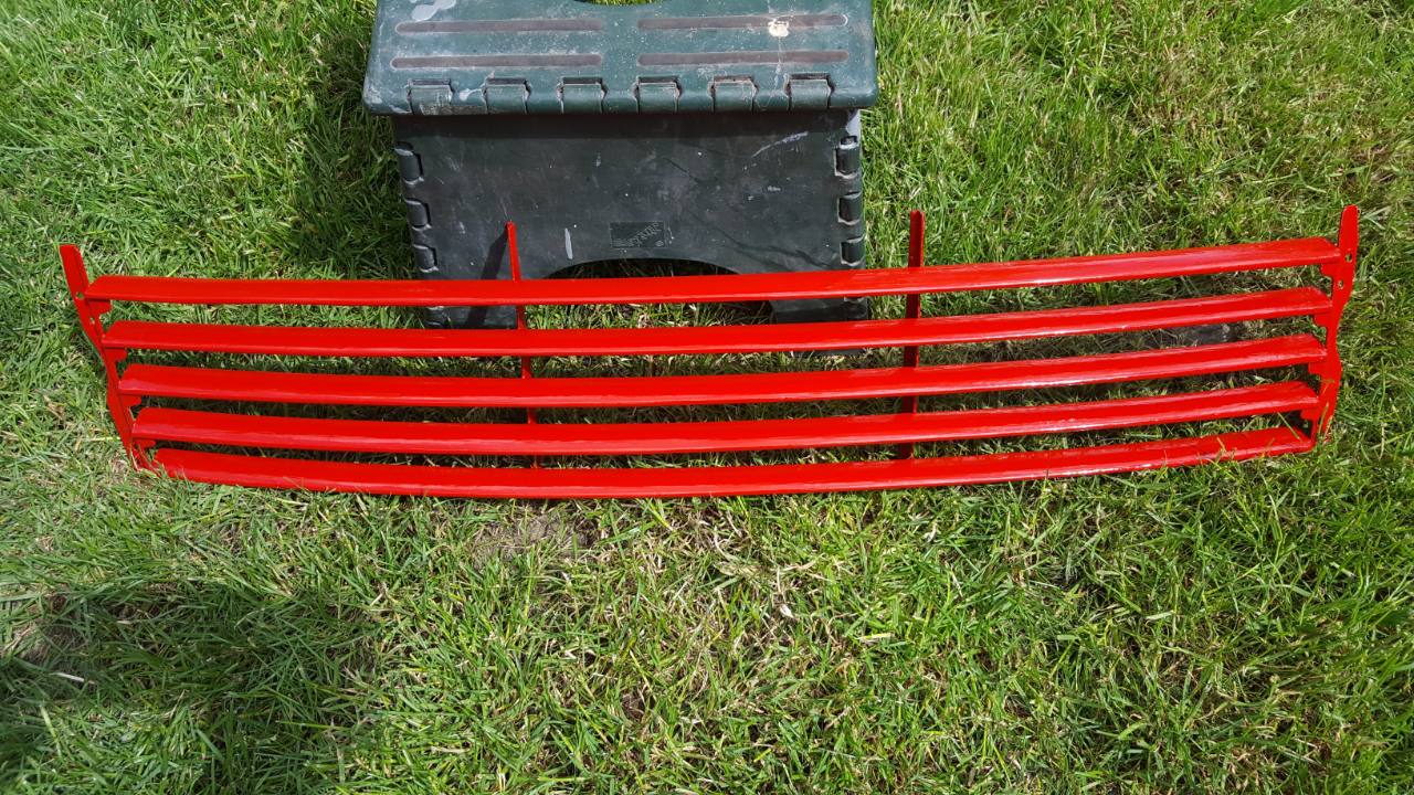

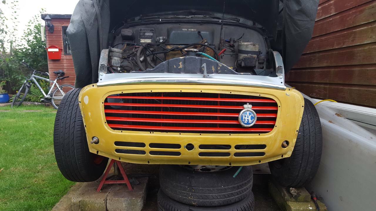

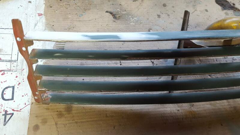

Joey spud Posted June 12, 2021 Author Posted June 12, 2021 So what do you do when your latest cool car seems to be going nowhere fast and your mojo starts to drop ? You fit another fat red wheel and dream of 'parping' around the village getting disapproving looks from bystanders. I took the front panel back off the other day. I am 99% certain i am going bumperless at the front and i really like how scruffy the paint finish is,it has reacted in places,gone a bit cloudy and there's some iffy filler work too. But around the edges it is too far gone to ignore so i am going to wire brush it back to clean metal and treat it and brush paint it with enamel paint. The grill slats have needed straightening and a touch of filler before getting two coats of my favourite ever red paint. I can't recommend this stuff highly enough,two coats applied an hour apart and then leave it somewhere warm and most of the brush marks disappear. Tickman, Low Horatio gearbox, Asimo and 7 others 10

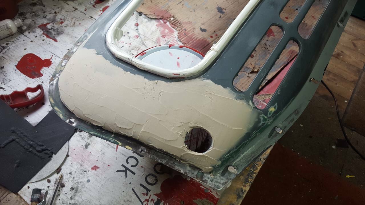

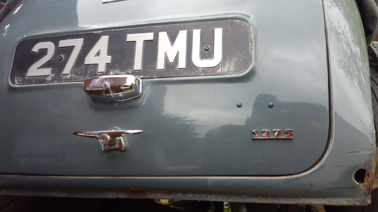

Joey spud Posted July 10, 2021 Author Posted July 10, 2021 Work on Boris has slowed to a crawl lately as other stuff has got in the way but i aquired this 1275 badge (mini Cooper?) and thought it would look ok on the boot but not sure now it's on there. The front panel that i didn't want to improve paint wise is really a bit too scruffy around the edges. So i got the filler out and tidied up the previous 60 years worth of dents and scuffs. Looking ahead to painting Boris i want to keep as much of the original finish as i can and just try to blend in my repairs. With this in mind i have had a litre of Clarendon grey cellulose paint mixed up which is well premature as i am only 30% thru the welding but while its Summer and warm i can have a go at painting all four wings and the drivers door. I have spray gun for applying primer but don't possess a top coat spray gun and i only own a 50 litre / 2hp compressor so i have looking at low volume/low pressure (LVLP) guns to suit my amature ability and lowly compressor output but haven't made my mind up yet. Anyone have any thoughts on the pros and cons of low pressure v high pressure equipment ?? tooSavvy, LightBulbFun, catsinthewelder and 3 others 5 1

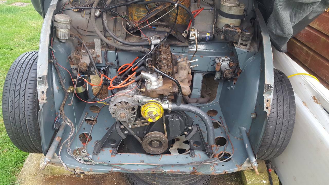

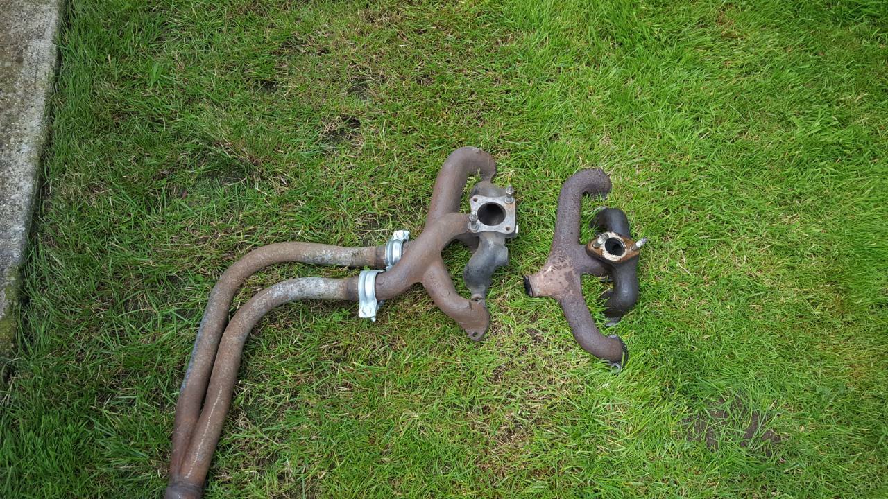

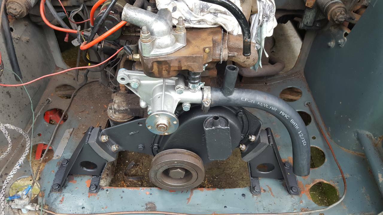

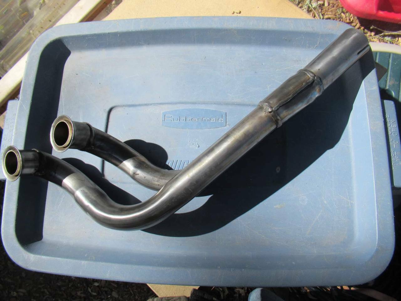

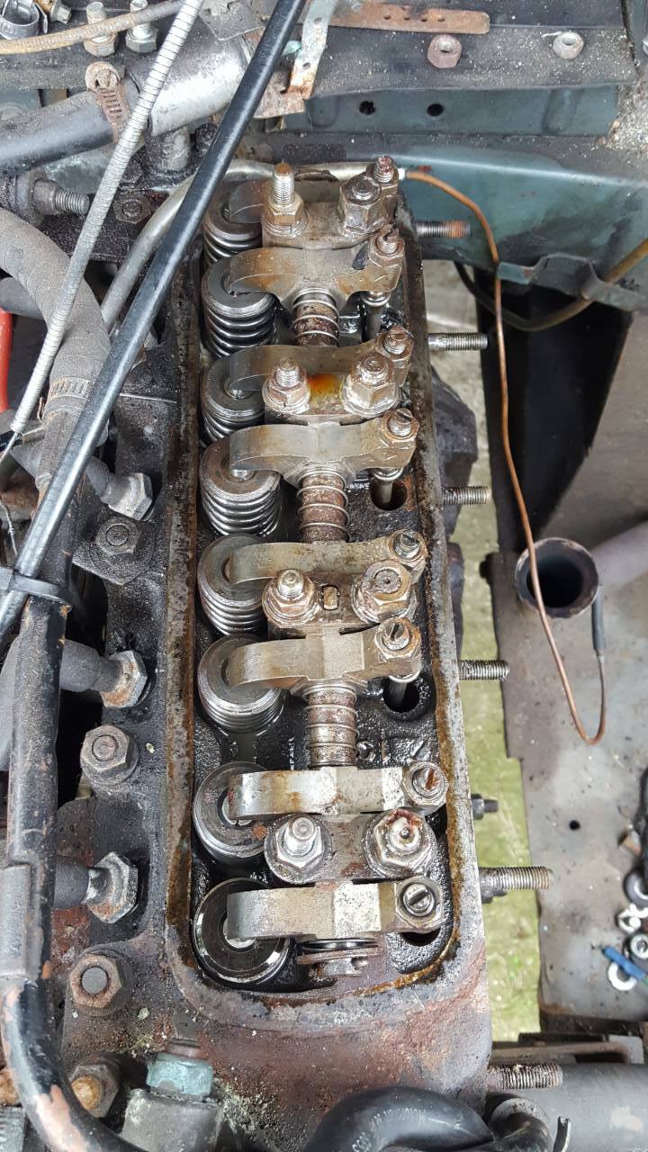

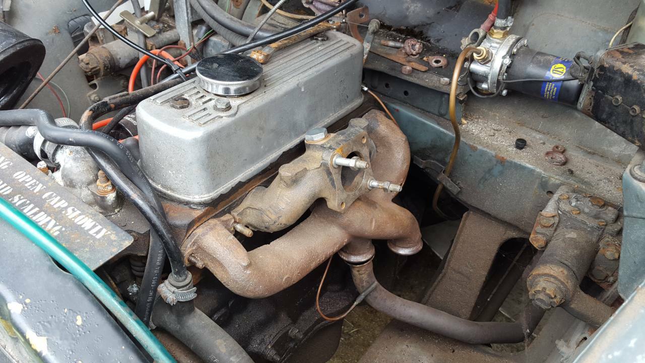

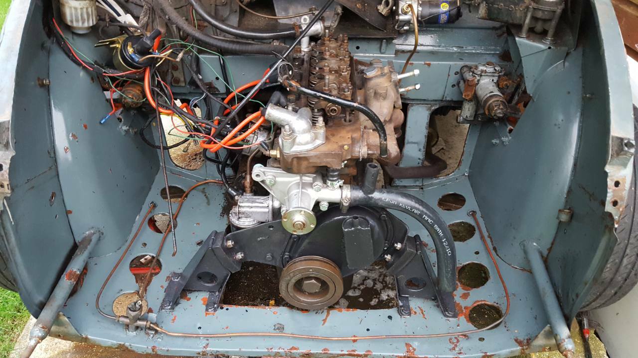

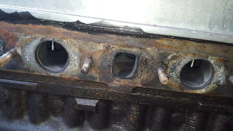

Joey spud Posted July 16, 2021 Author Posted July 16, 2021 Although Boris has a 1275 engine he is still running his original baby carb and pea shooter exhaust. The plan is to fit this bigger and better flowing Marina/Ital manifold. I know the engine is an Ivor Serle reconditioned unit and looking down the inlet ports the machined profile doesn't look like any A series i can remember. It also has the later one piece rockers fitted too. Annoyingly lack of use and condensation has left a some rusty spots on things. I am going to email Ivor Serle with the engine number and see if they can tell what the spec the engine has. The Marina/Ital manifold fits fine but its matching twin down pipe needs to be radically altered to swing around 90 degrees to pass through the hole in the chassis leg like the Minor one does. It needs to end up looking like this one. I have noticed that on some of the 1275cc engines the breather canister is mounted on the timing chain cover and so fouls the Minors fan. The recognised mod/bodge seems to be to slice it length ways,throw half of it away and weld it back up again. The chassis legs and front box section are all in good order except for this bit. I'm not sure whats happened here its like a tear/cut but it'll be easy to make it good again. Coprolalia, danthecapriman, GrumpiusMaximus and 6 others 9

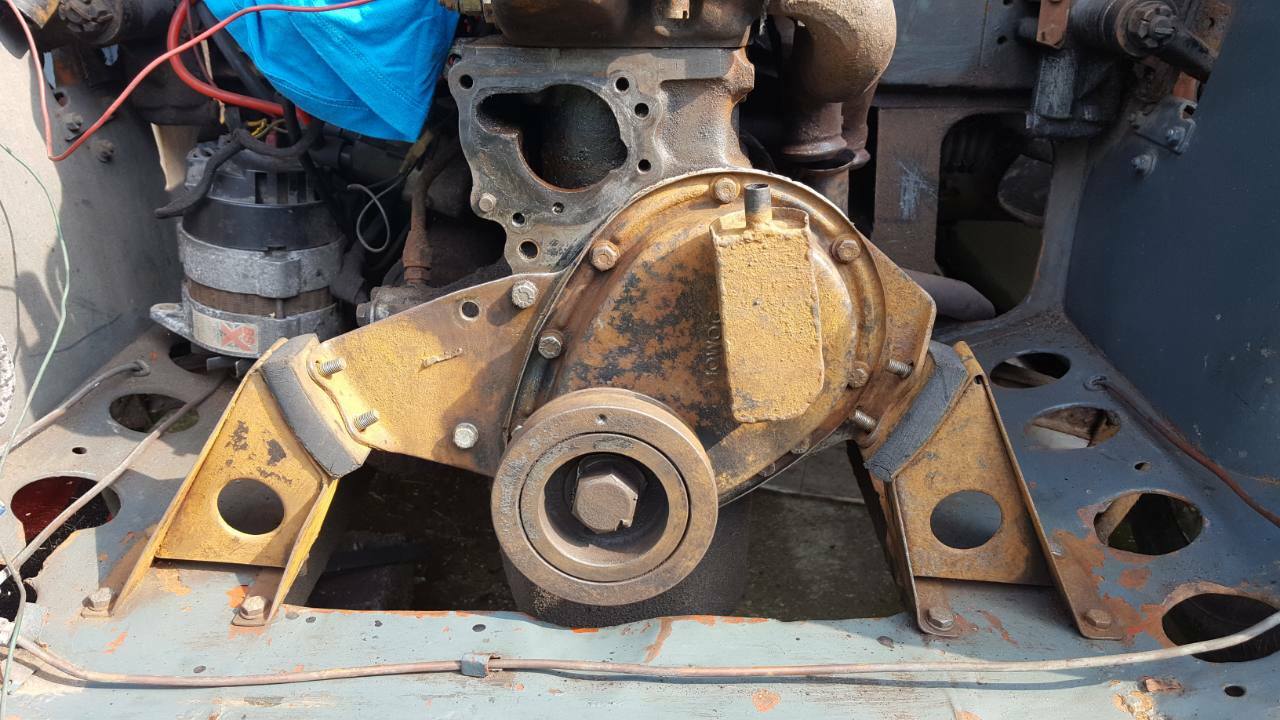

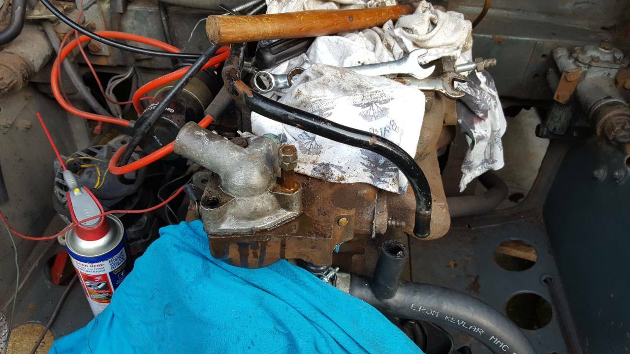

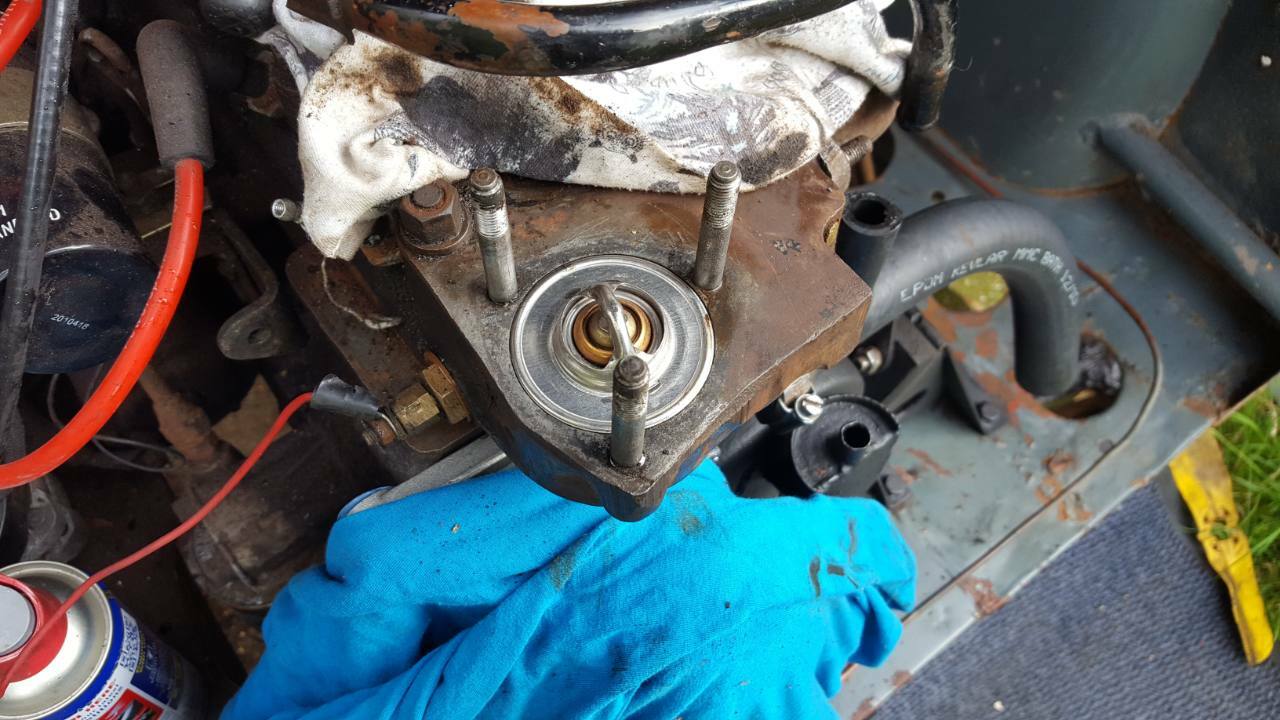

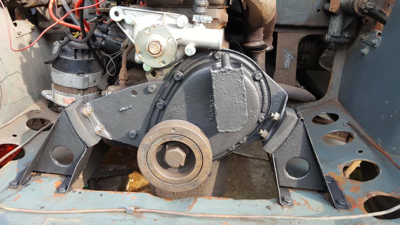

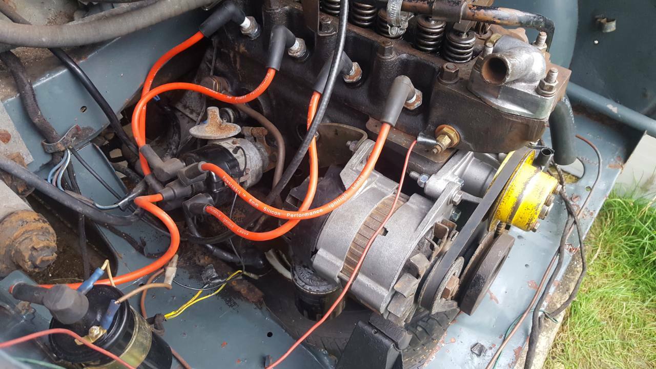

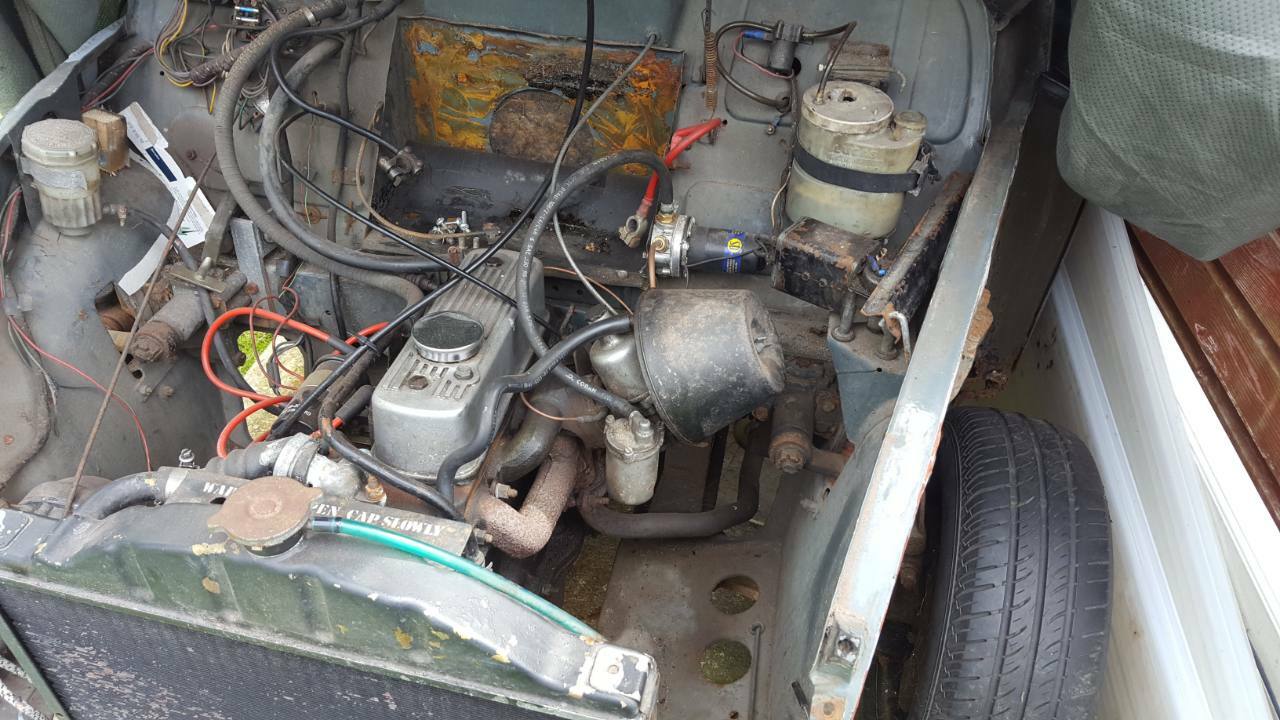

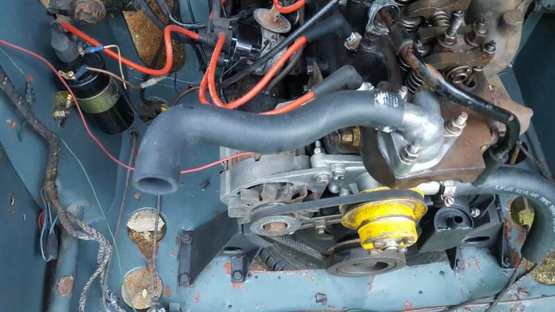

Joey spud Posted July 24, 2021 Author Posted July 24, 2021 Boris not only has rusty bodywork but also a scabby front plate,timing cover and engine mounting posts too so earlier i wire brushed it all back and applied a couple of coats of zinc rich black paint. He also arrived with a new water pump and various hoses in the boot too so i bunged these on as well. New water pump fixings and a silicon by-pass hose,such decadence. I wanted to change the stat (again in the boot) and although the three fixing nuts came undone the housing was totally stuck solid on the studs. I managed to remove two of the studs just by locking two nuts together and winding them out but the third one needed the housing twisting back and forth to break the corrosion between the stud and the housing first before that too wound out. I call that a bit of a result,alas i haven't got a gasket yet so it has just been loosely assembled. The engine mounts are just starting to crack but are still good enough. I was going to change them as they are only £12 a pair but a chap on a Moggy group reckoned their rubber compound is rock hard and transmit bad vibes through the car. Final quick job was to wash off the worst of the oil and crud from the engine / engine bay. I recently bought five litres of No Nonsense HD degreaser for about a tenner from Screw fix and i used it neat and worked it in with a paint brush before rinsing it off again with a garden sprayer thing. Can't argue with that. I am looking at deleting the twin blade pulley driven fan (couple of extra horse power released maybe ?) and mounting a small electric one instead in front of the rad and behind the grill and with this in mind i saved the fan from our recently scrapped AX but a quick attempt to fit it tonight revealed it is too deep. Maybe it'll fit between the rad and the engine instead otherwise i'll see what's on fleabay. While not as good as using stale petrol this stuff ain't bad and is probably a bit more stupid dog friendly too. neil1971, LightBulbFun, Banger Kenny and 8 others 11

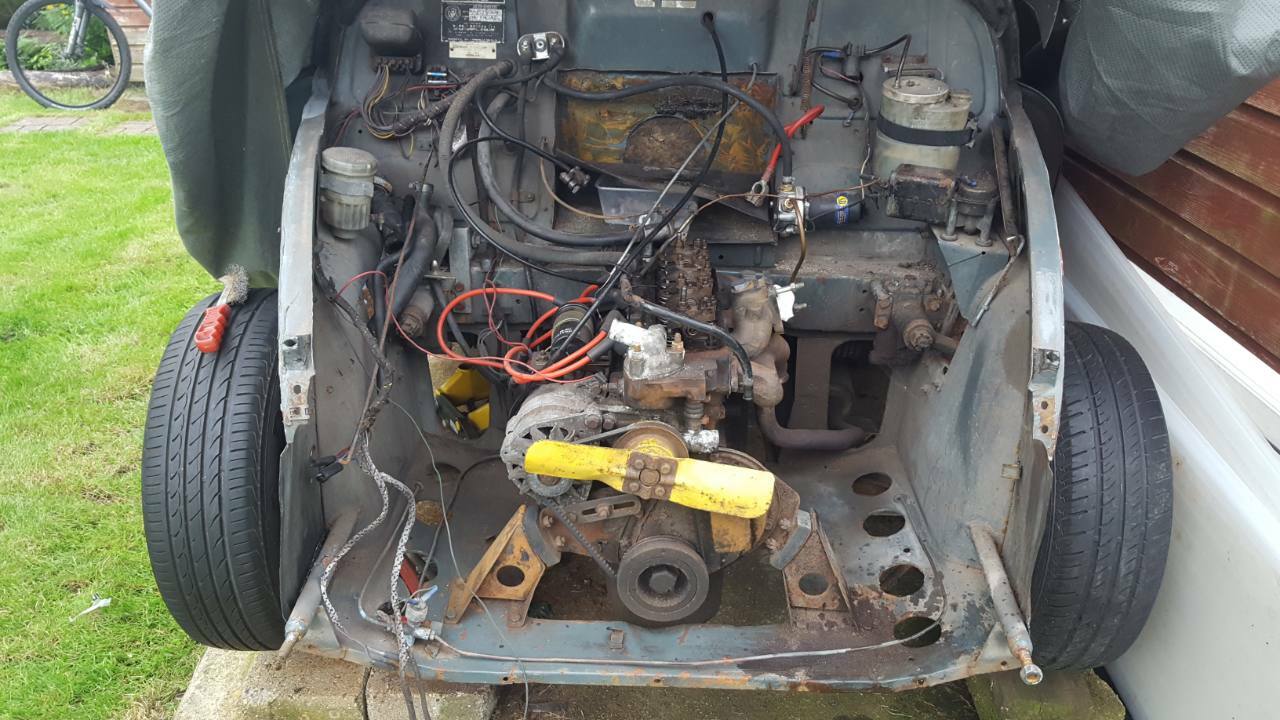

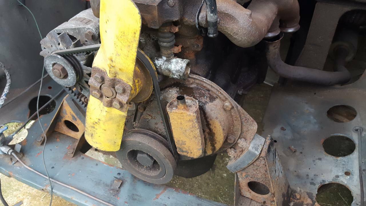

bunglebus Posted July 25, 2021 Posted July 25, 2021 Fans can be "push" or "pull". If the AX one was on the engine side of the rad originally that's how it should be mounted BeEP 1
Joey spud Posted July 25, 2021 Author Posted July 25, 2021 I did think about this but reasoned if i reversed the fans polarity would it not now blow instead of suck ?
Asimo Posted July 25, 2021 Posted July 25, 2021 Plastic Fan blades are usually an aerofoil section and work much more efficiently in one direction than the other even if the motor will run backwards when the wires are reversed. bunglebus, SiC and Joey spud 3
Remspoor Posted July 25, 2021 Posted July 25, 2021 Fan can be bench tested and use a bit of bog roll held in front to determine which way the fan works the most efficiently. What is the cannister type of thing on the timing chain cover? Why doe it look as if it has been cut and welded at home?

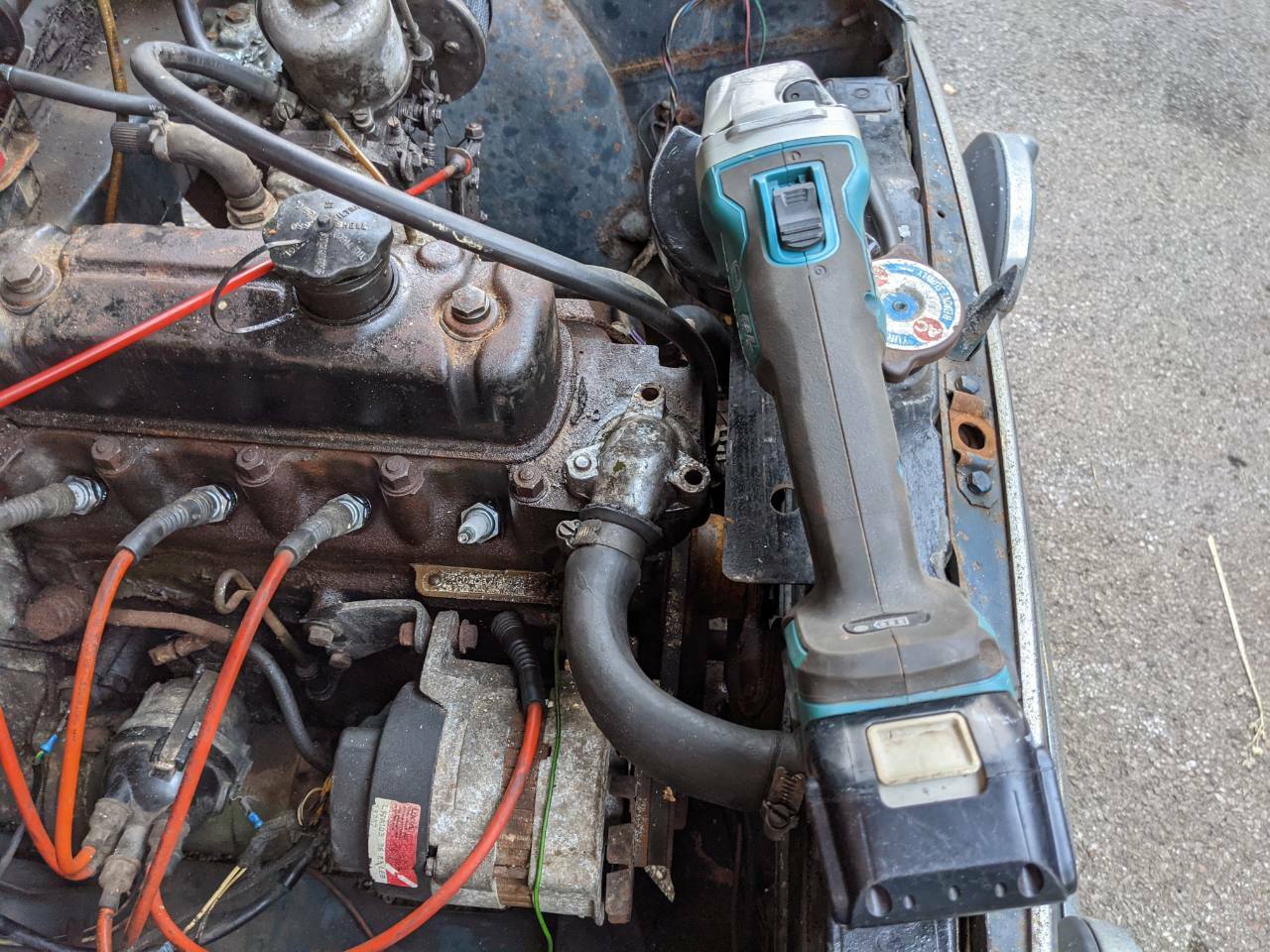

SiC Posted July 25, 2021 Posted July 25, 2021 13 minutes ago, Remspoor said: What is the cannister type of thing on the timing chain cover? Why doe it look as if it has been cut and welded at home? Presumably this: On 7/16/2021 at 11:46 AM, Joey spud said: I have noticed that on some of the 1275cc engines the breather canister is mounted on the timing chain cover and so fouls the Minors fan. The recognised mod/bodge seems to be to slice it length ways,throw half of it away and weld it back up again. Remspoor 1
Joey spud Posted July 25, 2021 Author Posted July 25, 2021 I tried the AX fan on a battery today. Conveniently it has an arrow printed on the blades hub to show its correct rotation and to be fair it seems to create a good blow output when you reverse the polarity compared to running its designed direction. All this is pointless though as it wont fit between the engine and rad either. I remounted the alternator too but i need to purchase the proper lucas plug as currently the wiring is just two baggy crimped on spade terminals. Actually i think a quick rewire of the alternator to battery circuit using thicker cable is required. And i moved the coil from the side of the engine over to the inner wing. There can't be anything worse than repeated heat cycles and vibration for an electrical component. I loosely fitted the radiator and front panel earlier and realised that my rads inlet and the engines stat housing don't line up too well. Previously they were connected with a shoddy bit of flexible hose. Looking at other Minors their rads only have a short stub for a longer hose to attach to. I know an excellent Radiator man so i will get him to alter mine. And i already have the correct hose. I am working down in Hailsham East Sussex tomorrow so plan to pop in to ESM the minor place and collect some bits including a rattle can of Clarendon grey to paint the front panel with. Although i think the current yellow primer and dog dick red combination has a certain charm all of its own. LightBulbFun, RayMK, CGSB and 11 others 14
SiC Posted July 25, 2021 Posted July 25, 2021 On mine, the pipe on the top of the radiator is chopped off (by hand) and has one of these fitted: https://www.morrisminorspares.com/cooling-system-heater-c52/radiator-cooling-heating-c53/radiator-top-hose-1275-only-reinforced-use-with-straight-top-pipe-radiator-p829664 I've ordered that exact hose to replace the one on mine.
SiC Posted July 25, 2021 Posted July 25, 2021 With the fan, the general consensus is that the Moggie radiator is massively overspecced. So you can get away with no fan in most conditions. The two bladed fan is small enough that it shouldn't cause much of any power loss either. I don't plan to go electric on mine tbh. Something else to draw a heavy current load from the alternator and probably decide to not work at the worst possible moment when I do really need it. Also the sound from the fan adds part of the characteristic classic British car sound to my ears.
SiC Posted July 25, 2021 Posted July 25, 2021 Grinder was in the way when I took these photos but there should be enough in shot to give an idea. I believe this is a standard mod for 1275 retrofits. Coprolalia and Banger Kenny 2
