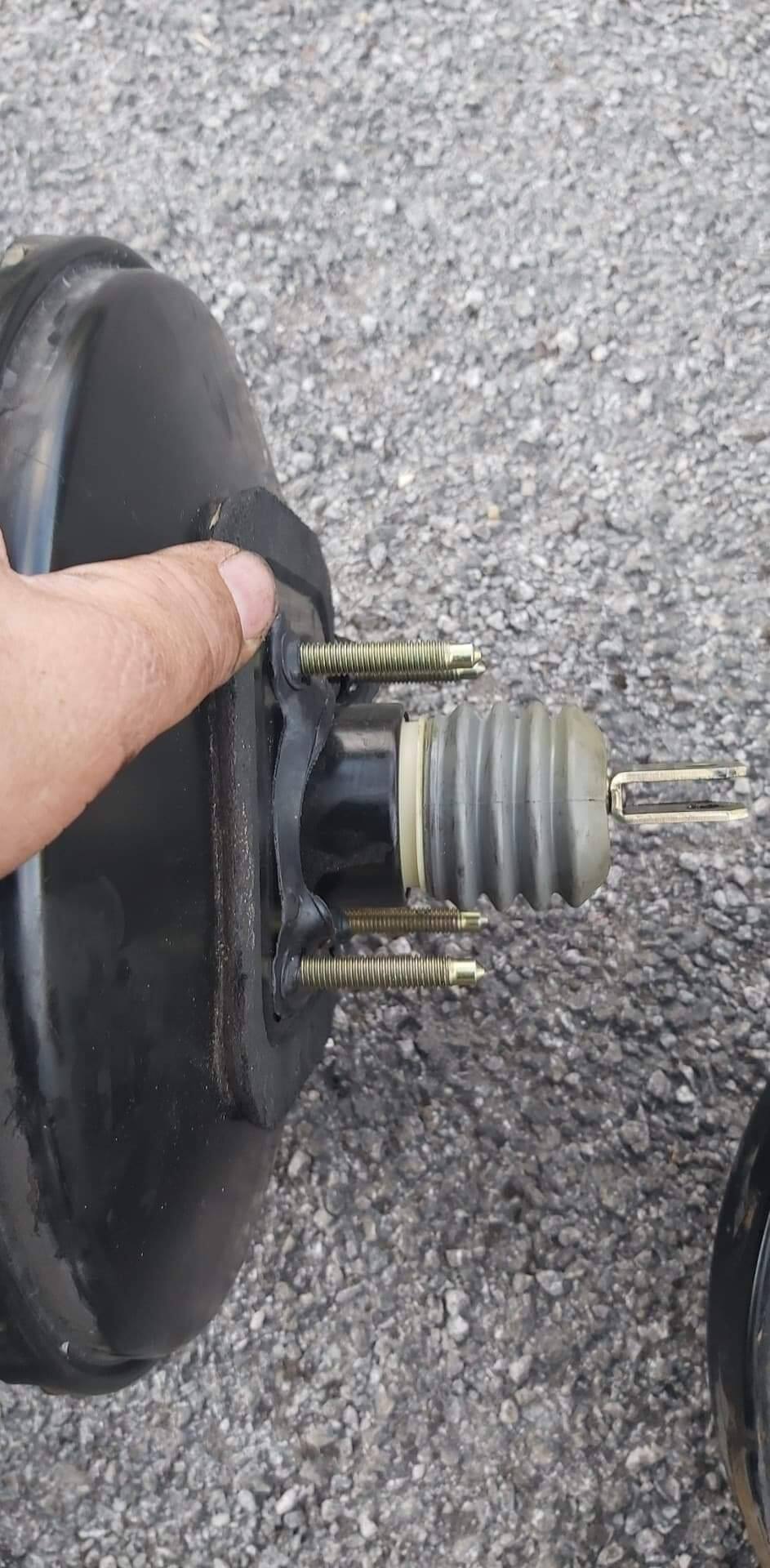

Onto the issues. first thing was to see what to do with the stalks. The coms unit was a dav brand,picasso was a delphi. Also the Peugeot has auto lights controlled by a button on indicator stalk and wipers control by an auto setting on the stalk which the picasso didnt have. No matter,fitted it to pug and lo and behold it functions fine and everything works even the auto functions which I thought was odd. Auto lights come on and can be overridden by the light switch but they cant be disabled because of the stalk having no function and the wipers work on auto by flicking it to what was intermittent on the picasso.  Now that sorted the issues began. First up was a sudden loss of pressure on the brake pedal. Turns out the master cylinder had leaked into the servo. New servos aren't available. I had a functioning servo and master cylinder on the driveway in a picasso. Will it fit? Let's find out.
The studs on the picasso were longer due to going inside the car where as the Peugeot mounted on a bracket under the bonnet. Spacers were made and it fitted up nicely. The picasso master cylinder had to be used because offset studs on the front of servo which in turn meant different locations of brake pipes to abs block so new pipes made and fitted and braking was resumed back to normal.

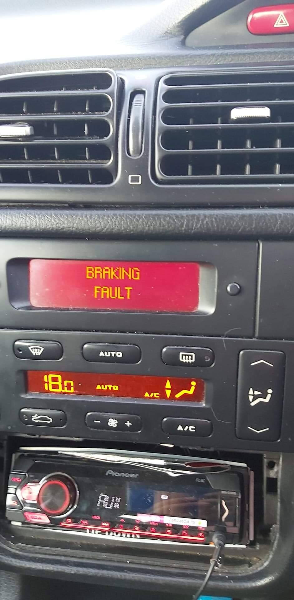

Next up was the rear caliper and abs issue. ( think it's a given from experience that all Peugeot and citroen like abs faults!)
received_582452032420709.thumb.jpeg.8e10dffaec88c750c10d7f3e1d2fa0f3.jpegreceived_286199686075110.thumb.jpeg.8c1cf0d99907cbcf121f649d0db4564d.jpegreceived_213939712921796.thumb.jpeg.83586aaab4822b03a001207a7a35c625.jpeg
big red stop light on dashboard also. Rear discs and pads changed and the offside caliper along with offside hub,bearing,abs ring and sensor. That issue was now rectified.

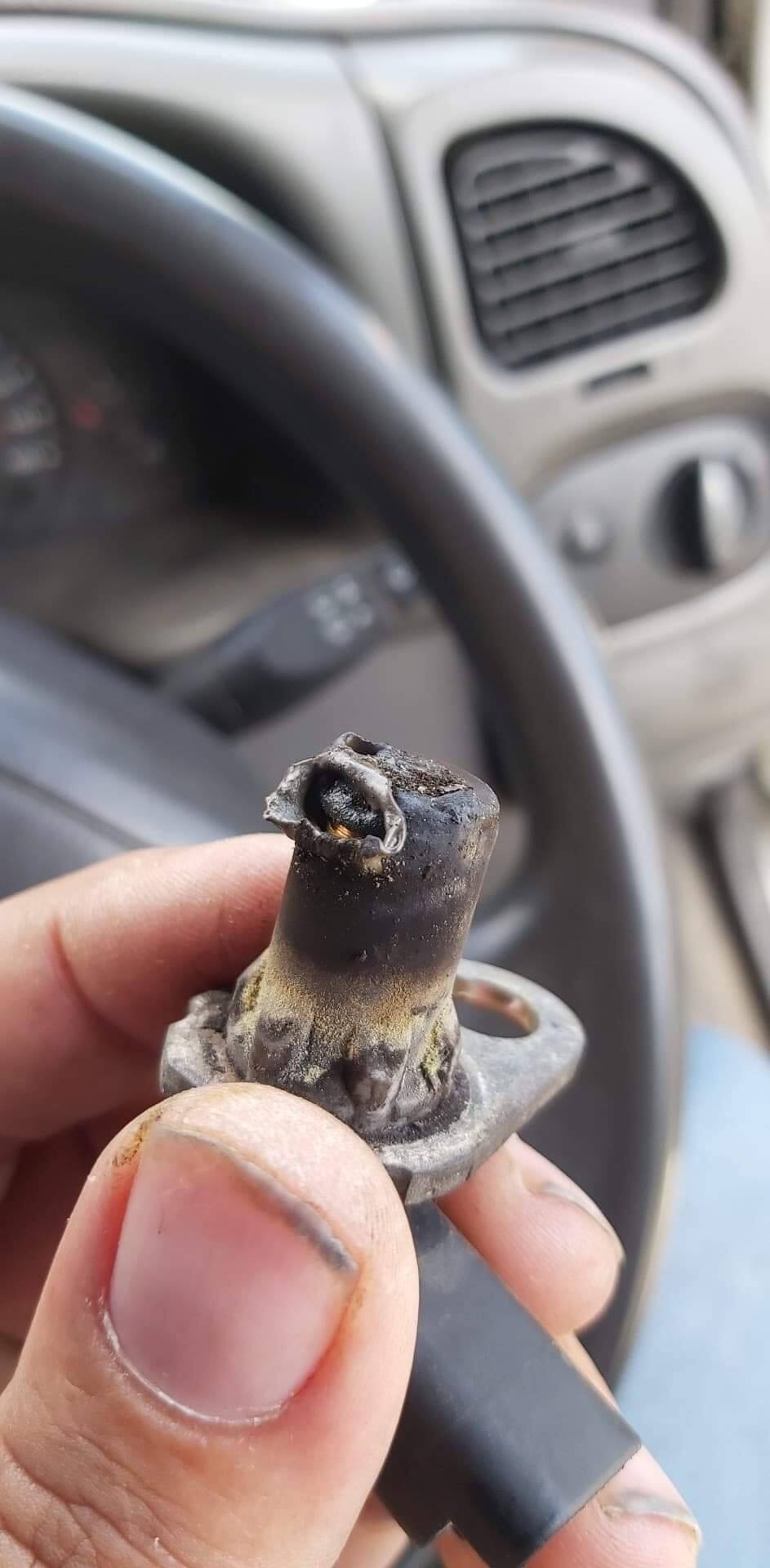

The car was still juddering at certain rpm. I swapped a few known good sensors off the picasso,fitted new engine mounts but yet it persisted. finally last week the clutch gave out in wragby. In returning home my friendly mechanic came to fit a new clutch to it. When it was stripped we found a few issues.
1) the crank seal had been weeping so possibly contaminated the clutch.
2) something odd with the crank sensor
how it was still running I dont know
3) the passenger side driveshaft came off In 2 pieces. Strangely it had no knocking or clanging,only a bit of drive shunt
received_1757688541051878.thumb.jpeg.f177939e8e6b2d3b2bd200d80446806c.jpegreceived_220111299308087.thumb.jpeg.fe1fcafb0a8ecd0a792e08e1bb9f822f.jpegreceived_867295743798405.thumb.jpeg.3b2e3ac3aa067c34c2d2defa6d063ab9.jpeg
new driveshaft,sensor and clutch fitted. Seems to drive a load better. Still confused on what's happened with the sensor but hey ho.
