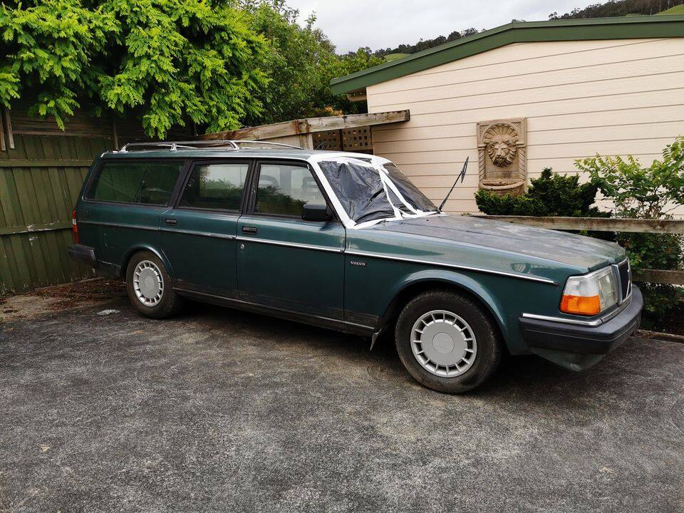

12/1988 build 240 GL wagon badermatic. it has a B230f, and 142,000 miles on it. owned by 3 pervious owners, the second the vice chairman of the volvo owners club australia. it has a fat history file and had its timing belt, tensionmer, waterpump all bushes and balljoints and a full fluid change in 2018. it was sold to owner 3 in may 18, and he used it daily to cart tools and surf boards. it started leaking water into the interior in oct 19, so he pulled the screen and found this:
91278649_10215989198267725_475301864322105344_o.thumb.jpg.f119e8ec2f3be2437862debc22ffe9cc.jpg
mmmmm lush.  by dec he needed cash, and i swooped at a lovely $500. it basically needed the rust repaired and a full going over. theres laquer peel on the bonnet and roof but im nto fussed.  oddly its painted Nissan night glow, as it was built in the clayton VIC nissan/volo/triumph/toyota factory as a CKD kit. the last month of CKD builds was 2/89 so its a late one.... it copped the good harness, lh 2.2 and a aw70 trans with the transd cooler etc. it has working a/c and everything apart from the headlights and wipers work properly...
me and the two eldest drove 4 hours one way and trailered it home. they love it.

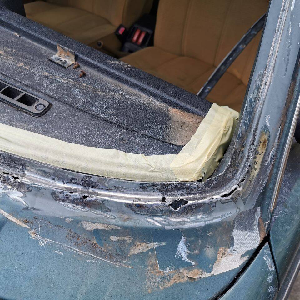

i got on with rust repairs. now im no body man, im a mechanic and have no patience. so i cut out the rust, migged in some replacem,ent cuts from a wcrapper and geround it back i then applied wob, and sanded badly the resultant mess.

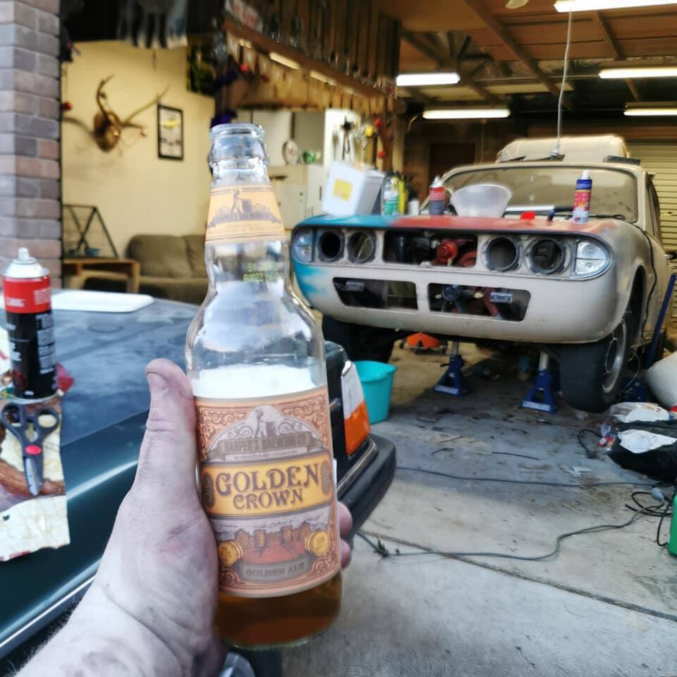

satisfied i then ignored the other project, and sank some nice beer.

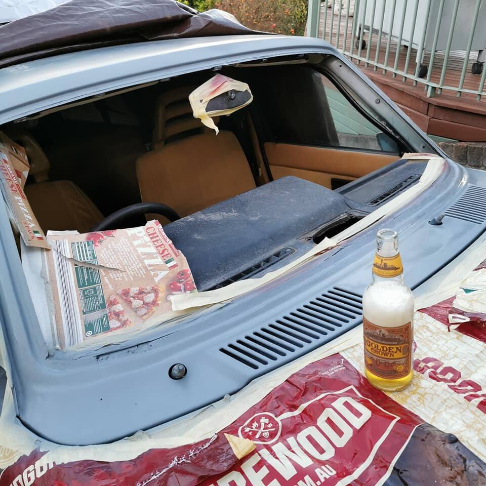

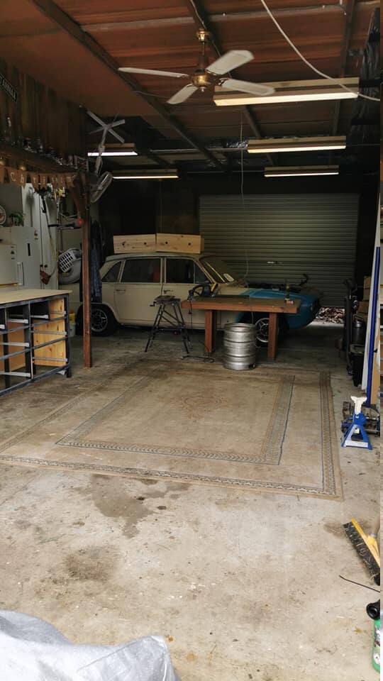

finally got my garage cleaned up and got the thin g inside, and layed on a coat of etch, then 5 coats of primer...

well thats fucky. did 2 light dust coats left it for a cuppa tea, did a coat, had a bikkie, did another and then ten minutes later this. had the space heater on, 24 deg. no breeze etc. panel wiped before paint and let sit for halfa to totally evaporate. not impressed.

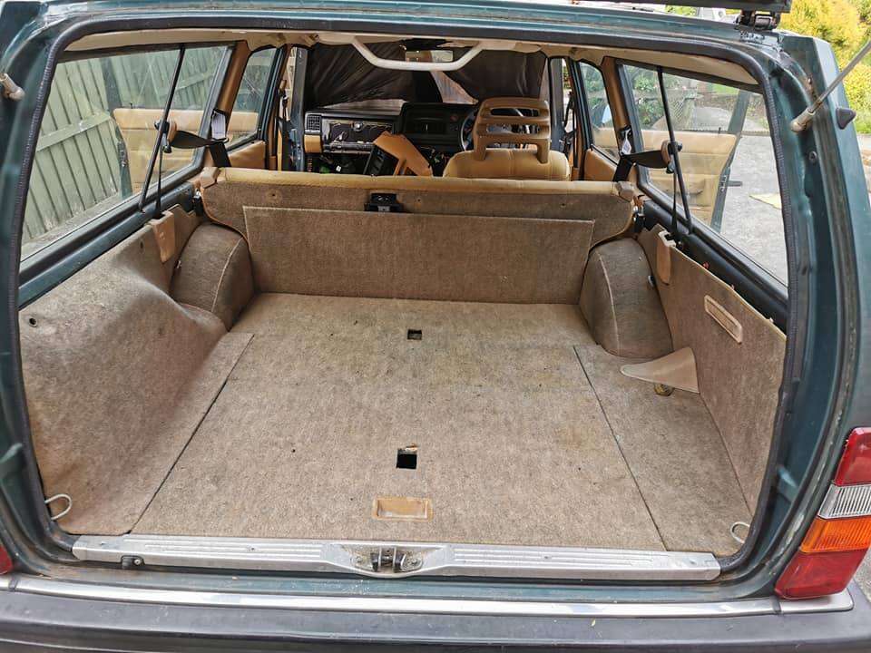

fitted new sound deadener - like dynamat, then some felt type stuff, finally washed the front carpet inn the washer and dried it then refitted. cleane dall plastics in the dishwasher, and reassembled. vax'd the seats etc. fitted my ebay special retro look head unit and realised the wipers now dont work at all.
then removed all the paint, filler and realised that the patch id made for the corner wasnt great. so redid it.  i used some a pillar sections i cut out of a wreck.
ill zap that in with the mig tomorrow. then to tackle a few small holes the wire wheel found.....

got the welder out. migged in the patch panels. blew up my welder as i did the last spot. got the wob out, and applied liberally.
fitted a radio and sorted some electrical stupidity. turns out the wiper stalk is fuckeyed.
by that point  the filler was dry so i broke out the makita orbital, and smashed out the sanding.
