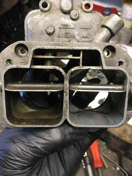

sutty2006 Posted May 6, 2021 Author Posted May 6, 2021 Well the floats don’t leak! Bonus. So I used the remaining petrol to clean years worth of crud off it. Can’t go any further until new power valve comes. Shite Ron, Barry Cade and Tickman 3

sutty2006 Posted May 8, 2021 Author Posted May 8, 2021 Power valve arrived today so I fitted it. I’ll finish the rebuild next week. Shite Ron, Jenson Velcro and mk2_craig 3
dozeydustman Posted May 11, 2021 Posted May 11, 2021 Stripping that carb shows more y thos than the y tho? Thread sutty2006 1
sutty2006 Posted May 11, 2021 Author Posted May 11, 2021 More carb work done today. Choke flaps cleaned and polished. left is how they both were, right Is cleaned. Very nice. and now it’s back on, not for long as I need 3x more manifold carb gaskets as the repair kit only came with one. Shite Ron, Low Horatio gearbox, Popsicle and 2 others 5
Low Horatio gearbox Posted May 11, 2021 Posted May 11, 2021 I saw a gorgeous dark red Manta A this afternoon on the A465 and it reminded me of this thread. Glad it's moving along nicely. And yeah duh, no one likes dirty flaps! sutty2006 1

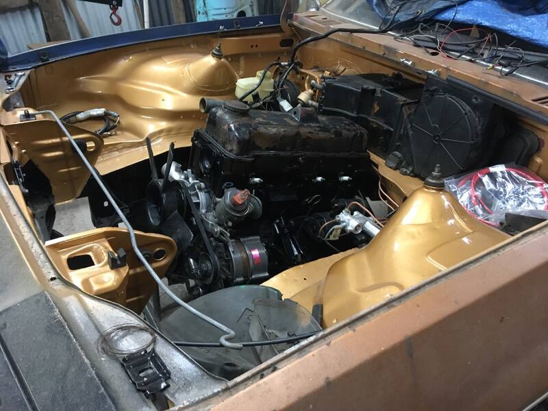

sutty2006 Posted May 13, 2021 Author Posted May 13, 2021 It’s been a monumental day today. I don’t know how long it’s been since this car had an engine in it. Minimum 13 years, maximum 31 years. Who knows. But after all this time it now has a 2.0 sat in the engine bay. My friend borrowed his dads car and trailer and we got the engine up to my unit tonight. And proceeded to get it chucked in. Not before putting the repainted sump in place with a new gasket kit. Tomorrow evening the wife will be taking me up to the unit so I can get the gearbox fitted. And I’ve no idea why my writing has a white background. then I used the discovery to winch it up onto the ramps to make it easier for me to get the gearbox in place. Amishtat, Low Horatio gearbox, dome and 26 others 29
junkyarddog Posted May 13, 2021 Posted May 13, 2021 Would it not have been a bit easier for you to bolt the gearbox on first? Then fit them as a unit,fitting a gearbox from underneath ain't a lot of fun.
sutty2006 Posted May 14, 2021 Author Posted May 14, 2021 9 hours ago, junkyarddog said: Would it not have been a bit easier for you to bolt the gearbox on first? Then fit them as a unit,fitting a gearbox from underneath ain't a lot of fun. Not in this case. The CIH engine has no lifting points at all. I have a balancer but there’s no way of suitably attaching it to the engine. I had one chain through the engine mounts then another chain bolted to the bell housing to give me a stable angle. The 4 speed is a light gearbox, I’ve taken 5 speeds in and out this way so I’m no stranger to lying on my back with the gearbox on my chest! puddlethumper, mk2_craig, Burnside and 7 others 10
Tadhg Tiogar Posted May 14, 2021 Posted May 14, 2021 7 hours ago, sutty2006 said: ....The CIH engine has no lifting points at all..... I wonder which genius designed that? sutty2006 1
sutty2006 Posted May 14, 2021 Author Posted May 14, 2021 It’s ridiculous isn’t it? The 1.8 ohc engine did. But never mind. It’s a heavy lump on its own so it’s best to lift them this way.
puddlethumper Posted May 14, 2021 Posted May 14, 2021 That engine bay looks a bit like the dogs danglies. Verry niiice. sutty2006 and Low Horatio gearbox 2
sutty2006 Posted May 14, 2021 Author Posted May 14, 2021 Slightly more done tonight. Gearbox fitted. Took the old remains of gear lever off and fitted a spare from inside the boot... there’s 2 in there....... engine now sitting how it’s supposed to. adw1977, Tickman, outlaw118 and 11 others 14
puddlethumper Posted May 14, 2021 Posted May 14, 2021 47 minutes ago, sutty2006 said: Slightly more done tonight. Gearbox fitted. Took the old remains of gear lever off and fitted a spare from inside the boot... there’s 2 in there....... engine now sitting how it’s supposed to. Blimey @sutty2006 I would eat my dinner off the first pic. Well, obviously I couldn't because it's the wrong way up and, erm, gravity and stuff but you know Matty 1
sutty2006 Posted May 15, 2021 Author Posted May 15, 2021 7 hours ago, puddlethumper said: Blimey @sutty2006 I would eat my dinner off the first pic. Well, obviously I couldn't because it's the wrong way up and, erm, gravity and stuff but you know Well, it’s not perfect. Not like some folks projects I’ve seen, like that Granada that was on here... boy that is clean! Lying under this last night I could see a few holes in the floor so I’ve got to get the mig stick out again. puddlethumper 1
Snake Charmer Posted May 15, 2021 Posted May 15, 2021 I scrapped a 2.0SR Berlinetta and removed the engine and gearbox by undoing the suspension and lifting the body off with two scaffold poles down the chassis rails, I walked it back over the engine like a wheel barrow. Easier to do with the front wheels off and the sump almost on the floor, lifting the valence high enough to clear the rocker cover was the hard part as I could have done with some help. Using the scaffold poles and with the rear dampers removed I managed to get the shell bouncing on the rear springs enough to leave the floor! Suspension out with the engine and gearbox was the only way I could install/remove the V8 but that was much easier as I had no valence on that car under the spoiler. I made a lifting bar back in the mid 80's for the CIH engines to use with an engine hoist, I forget what the chains went onto. I was given a good tip that works well with many RWD cars, lift the vehicles rear end up high so you don't have to push the gearbox down to get it in the tunnel. With a balancer it makes the job even easier. dome and sutty2006 2

sutty2006 Posted May 20, 2021 Author Posted May 20, 2021 Some more work has been done today. Unfortunately no pictures as I was too eager to get jobs done. propshaft on gearbox filled with oil inlet/exhaust manifold on genuine GM down pipe on dizzy cap, rotor arm, plugs and leads on heater blower lubricated and on Found my wiper linkage up in the loft area. Then found a wiper motor in the boot of the car in a box. Looks new old stock. Can’t believe I keep finding parts id forgotten I’d bought years ago! Even found a pair of brand new rear springs n shocks! Jenson Velcro, Low Horatio gearbox, Snake Charmer and 5 others 8

Snake Charmer Posted May 20, 2021 Posted May 20, 2021 2 hours ago, Skizzer said: So between this and Dome’s, great Manta threads are like buses...who knew? Oh dear, does that mean I have to start one with the V8 Coupe I'm my garden? @sutty2006 Did you fit the propshaft spring? Burnside and Skizzer 2
dome Posted May 20, 2021 Posted May 20, 2021 8 minutes ago, Snake Charmer said: Oh dear, does that mean I have to start one with the V8 Coupe I'm my garden? @sutty2006 Did you fit the propshaft spring? Yes, yes it does! Funny, I never noticed a propshaft spring when taking mine apart.
