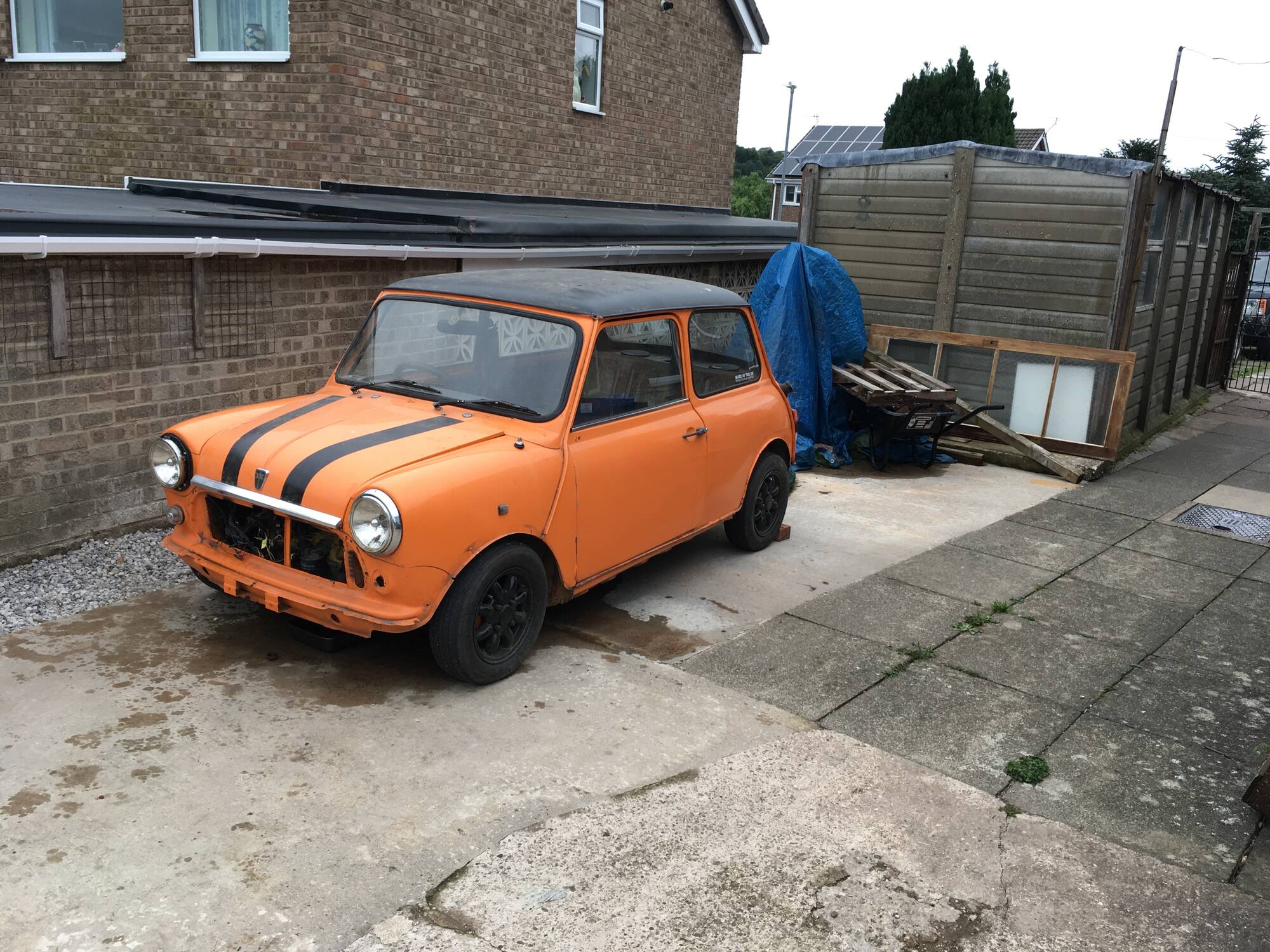

Mrs Suttys crusty orange Mini project, no longer crusty or orange.

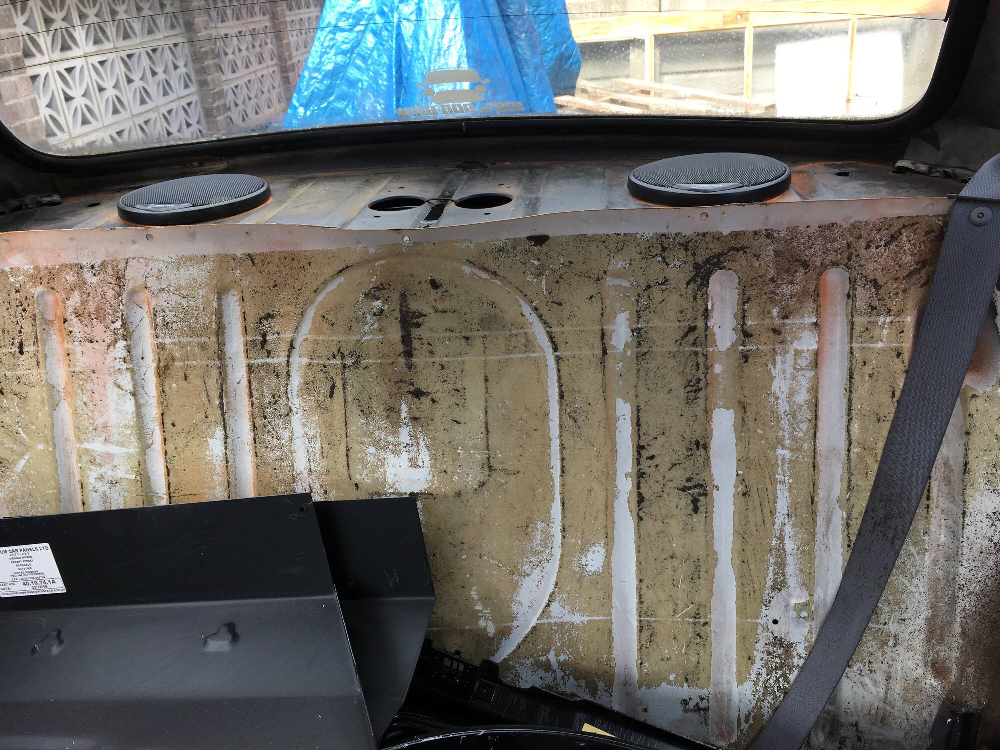

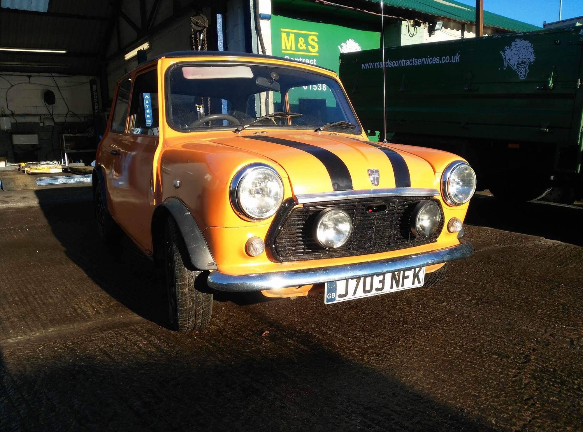

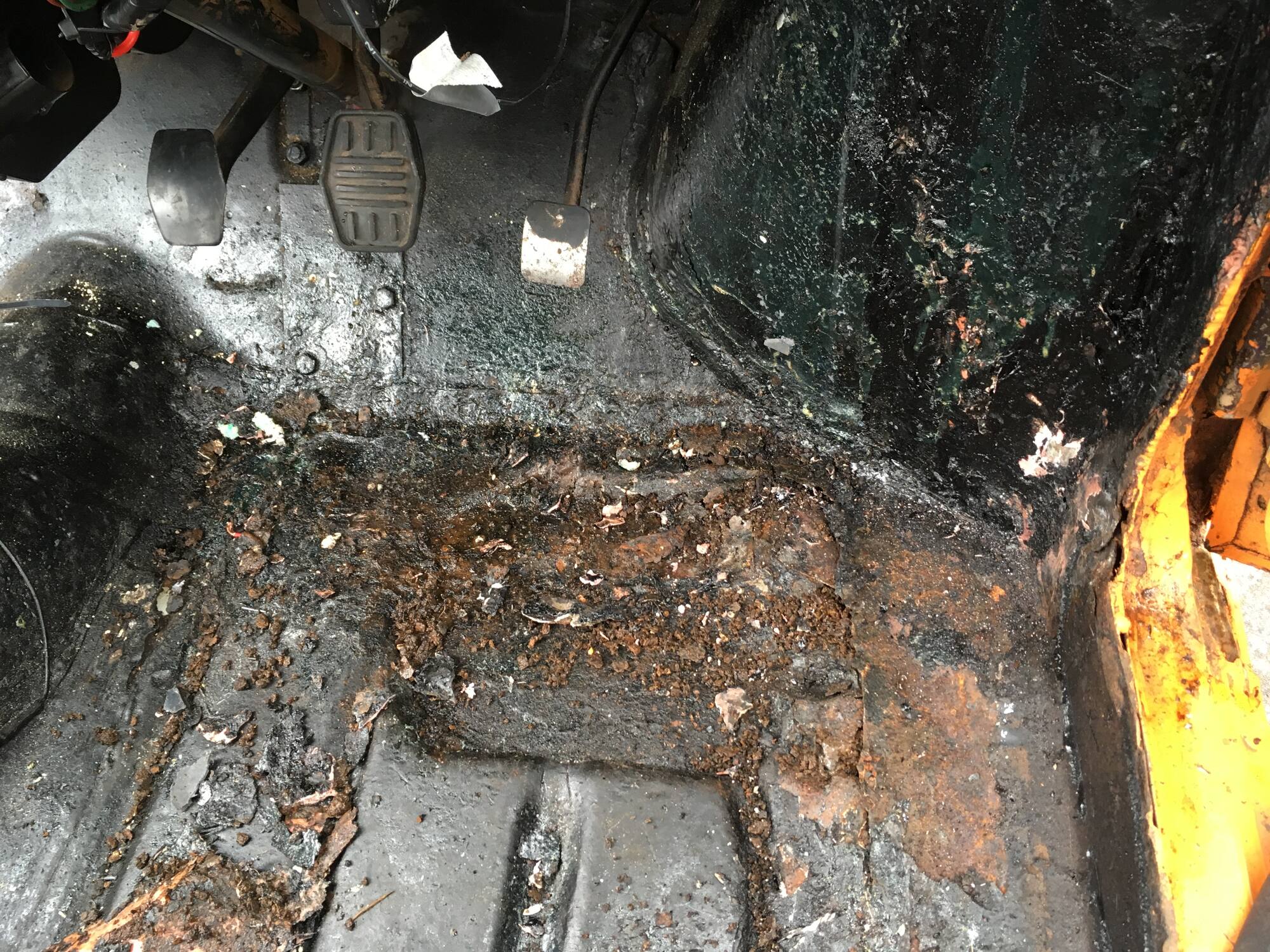

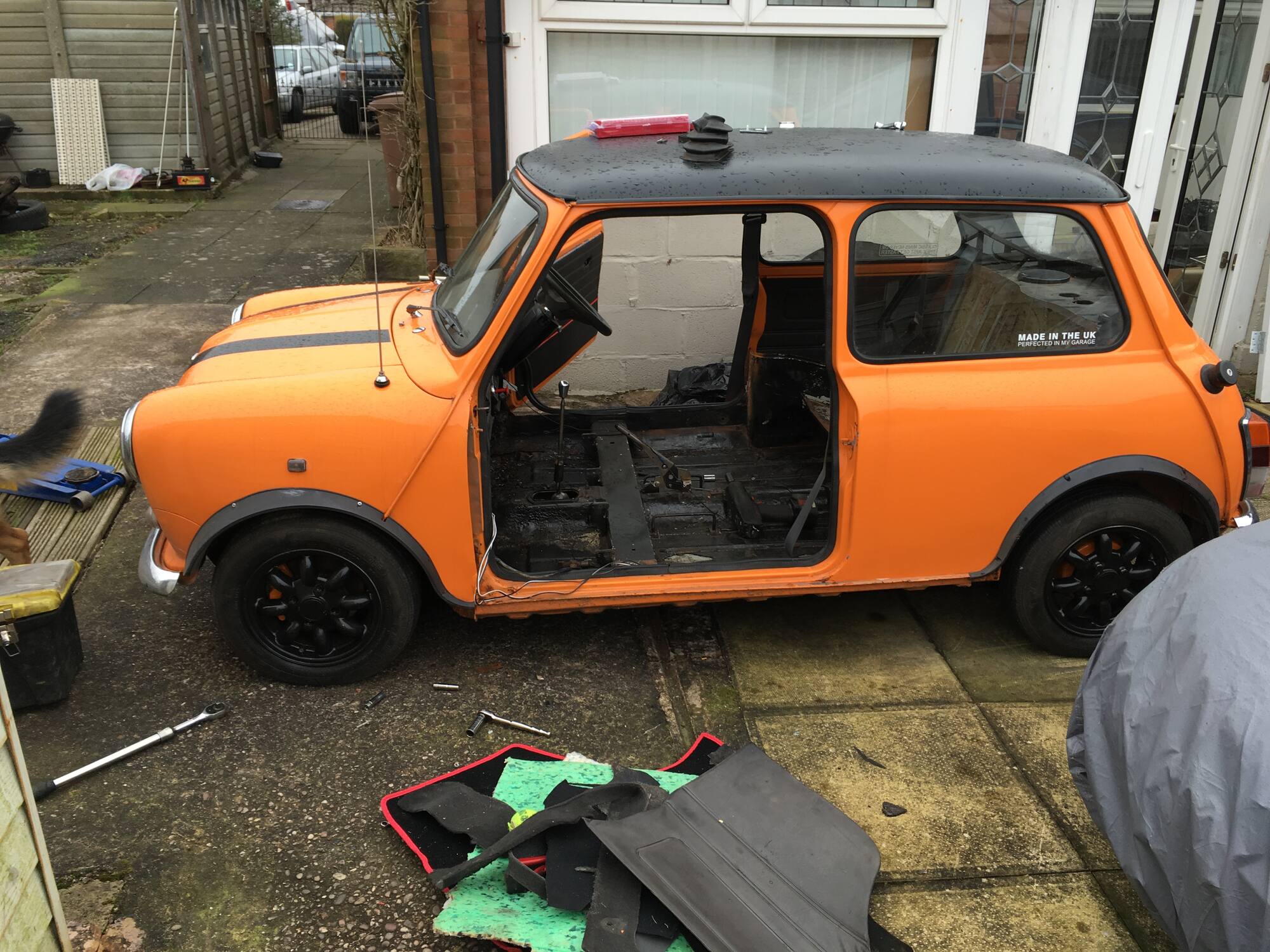

Yeah this kinda happened a few years ago. It’s a 998 on a 1991 plate. It’s hideous. We bought it for £630 and it ran and drove but the MOT had expired It’s been badly repaired in the past with mastic Glue and shitty bits of metal. Both A pillars are shot inside and out. The floors are like a sieve and the rest of it is crusty in places. Previous owner spent £££ on shiney chrome bits but neglected to repair thing properly. For example it had twin spotlights in the middle, both scotch locked into the offside headlight. Very poor. It’ll need doors, they’re buggered. Took the brake servo off which was full of fluid.... so the list of parts is going to increase daily. Luckily 99% of parts are available for these. I took it up to my unit about 2 years ago to store it until we had time. Today we collected it and brought it home. Plan is to remove the engine/box combo and then the shell will go up to FIL where they can repair it together. While the engine stays at home to be rebuilt. Watch this space. I already hate it.

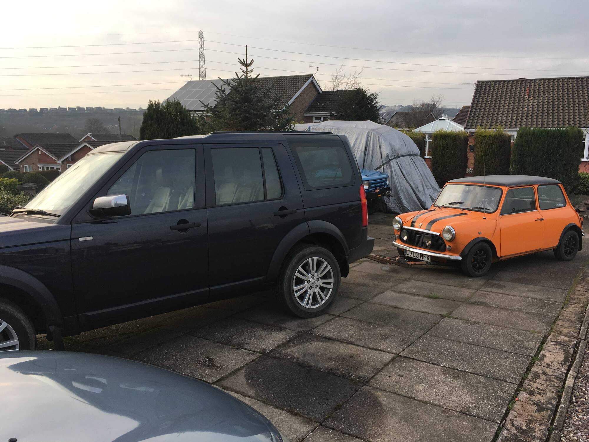

A few pictures of nearly 5 years ago when we bought it. A framing it with the landrover is Interesting. Can’t see it in the mirrors
I do love a good mini! As far as projects, this one does appear much more solid and complete than most. 1991 is often agreed to be one of the best years as well, since you get ‘modern’* features like rear seatbelts, disc brakes and an engine that’s happy on unleaded fuel, without loosing any of the mechanical simplicity of a Carb’d engine. I’ll definitely be following this with interest. What are your plans for it?
I love them, but they rot and leak like a bastard,but I probably don't need to tell you that!
The great thing about Minis is you can buy absolutely bloody everything - and pretty cheap. Total parts cost for getting mine on the road was probably £300 excluding new tyres. Not bad for something off the road for twenty years.
You'll be grand - keep us posted!
It’s on a single SU carb and old fashioned points distribution. I know sweet FA about minis. Thought someone was pulling my pisser when they said the gearbox is in the sump! Plan is to restore it and give it a better colour. I’d love to know what its original colour was.

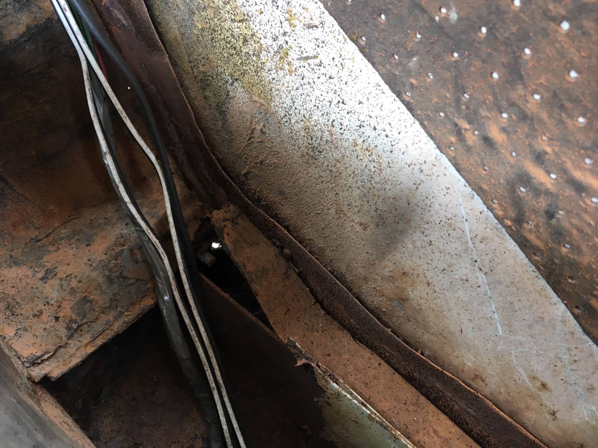

oooo more rust.
Common grot spot, the heel board rots from that corner forward. The usual first sign is bubbling where the rear quarter starts to curve for the arch. By then they need a fair bit of work. Being a bare shell it’s dead easy. Just use the rear subframe and carefully measure the mounting locations. I am sure we all remember seeing minis crabbing down the road from dodgy heel board repairs. The storage bins add to the structure as well but some people cut them out.

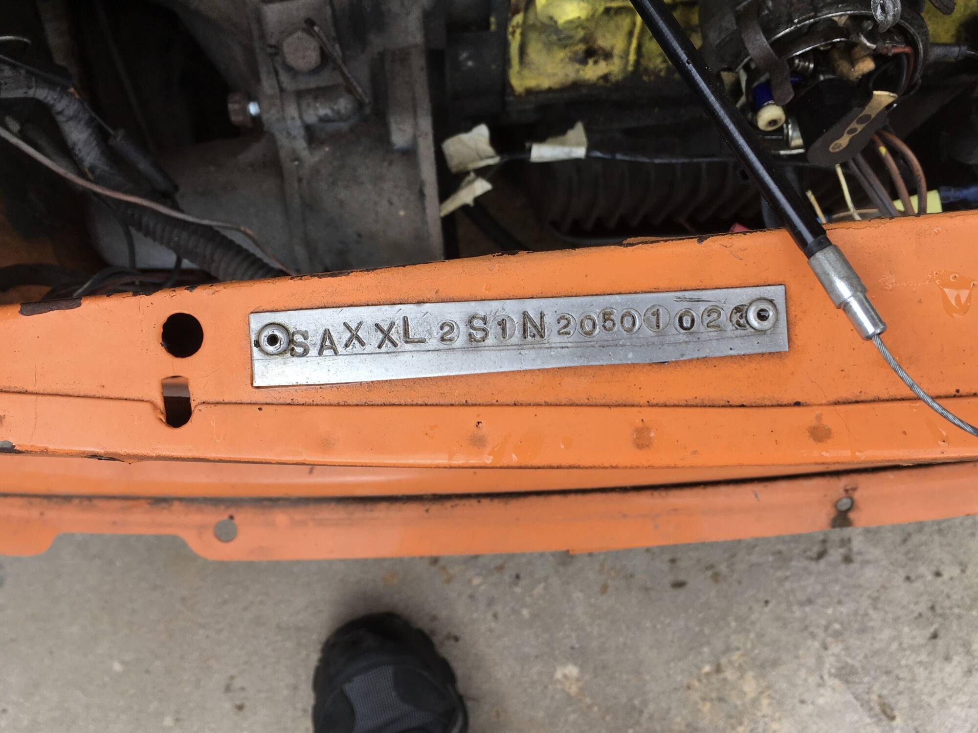

Tell me. Does this look dodgy?
and should there be a chassis number elsewhere?
  • Haha 5
Should have one of these somewhere:
They do get lost though, but that is complete mess. You can buy replacements.
So its possibly lost its original. Or, its been rung like a soggy wet tea towel. Im guessing it only has the one chassis plate on the front panel.
So many have had a ‘new’ shell I really wouldn’t worry even if that is the case. There is no way of knowing for sure. The plate is either on the inner wing or where yours is now. Later ones were also stamped on the scuttle but yours pre dates that.
