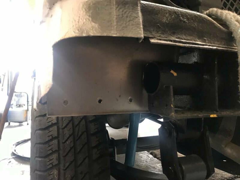

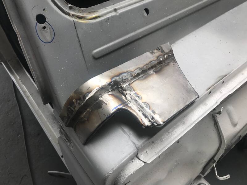

I made a new corner bit,
I made both sides, left side used no body filler, right side is stronger though.

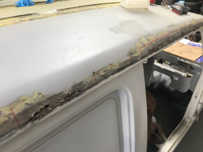

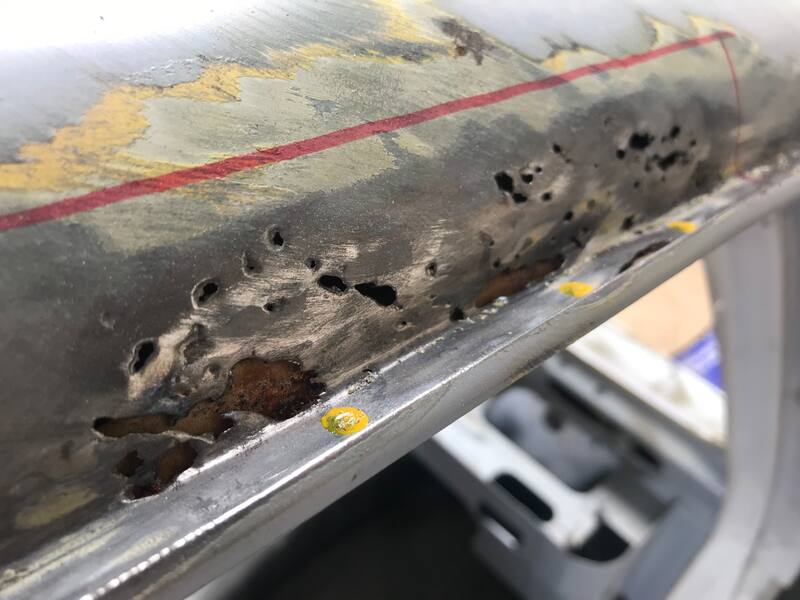

I found some rust in the roof. I’m not saying "this is the last of the rust sorted on this thing" anymore.
I think this will be easy to do maybe, it's just bent metal and I'll joggle the edges in so welding will be simple.

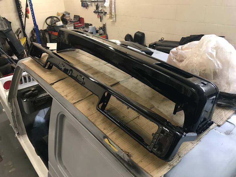

The fella next door also cleaned up and sprayed my bumpers - i put a load of Raptor on the insides. I’ll keep these at home, I’ll only ruin them somehow.

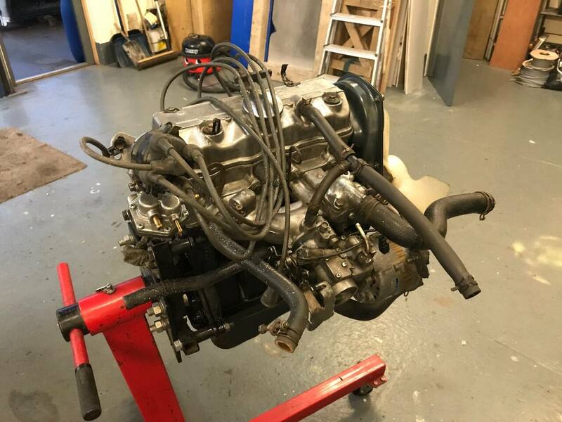

I rebuilt the engine on this (pistons, rings, valve, stem seals, gaskets etc), I got everything clean and shiny, haven’t done the carb yet as it works fine and I don’t want to take it apart. STILL waiting (three weeks) for new water pump to come! I can’t do anything til then.

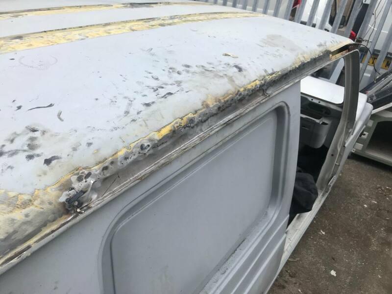

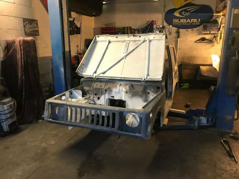

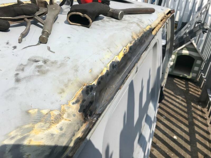

I made a start on that roof which was a mess, I was a bit worried about this as it’ll probably warp or something with the heat but I reckoned on just cutting out lung strips as it would at least be the same shape along the whole length.

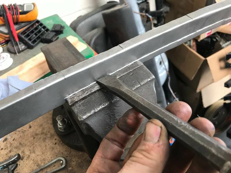

I wanted a joggler but how hard can it be to make a ridge for ace welding?
This worked better than I expected
Rain stopped my weldering so I’ll finish off next week, or this week, depending on my motivation to burn my hands.

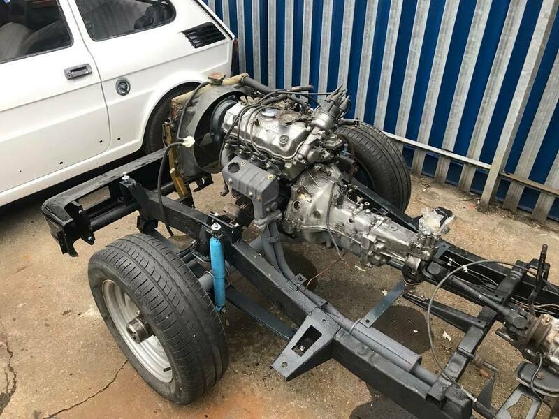

I’ve fully built the engine up, everything’s timed up and ready to go on the chassis
I got every single bolt nut and bracket zinc plated -professionally- on the car, there’s about 8kg of metal in a big box, and took a month to get back, wasn’t expecting it to be this shiny. Worth every penny and the wait IMO. :) I can’t remember where most of these go unfortunately :(

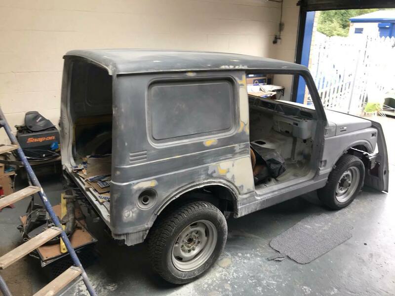

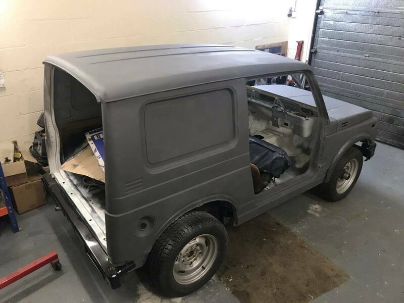

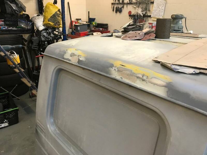

I spent the weekend weldrogificating the roof and did a good job I reckon wit only a skim of filler, also managed to pull out the crunch on the front roof corner with a crowbar. I think Suzuki decided against using tin foil for the body on these and went a bit thicker, you have to be careful with the angle grinder cleaning up the welds as the welder will blow holes in it. My poor welder had its work cut out over the past year.

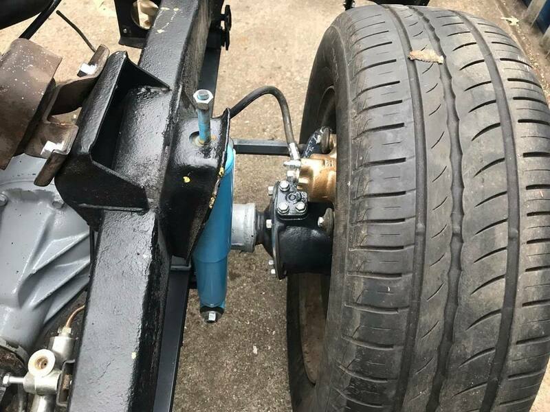

I got the powder coating stuff back - they only gave me half the leaf springs back, as they had mislaid them. Half an hour of searching, and they were in with a set of gates and were a different colour (black) to the rest of the springs (anthracite). 🤷‍♂️

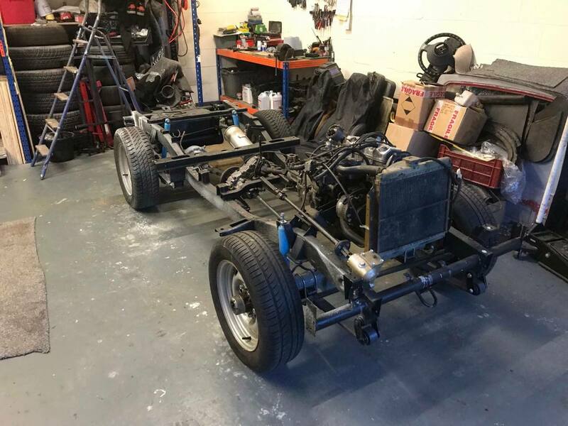

Could finally get chassis back together again and get it rolling, and get space back in my garage.

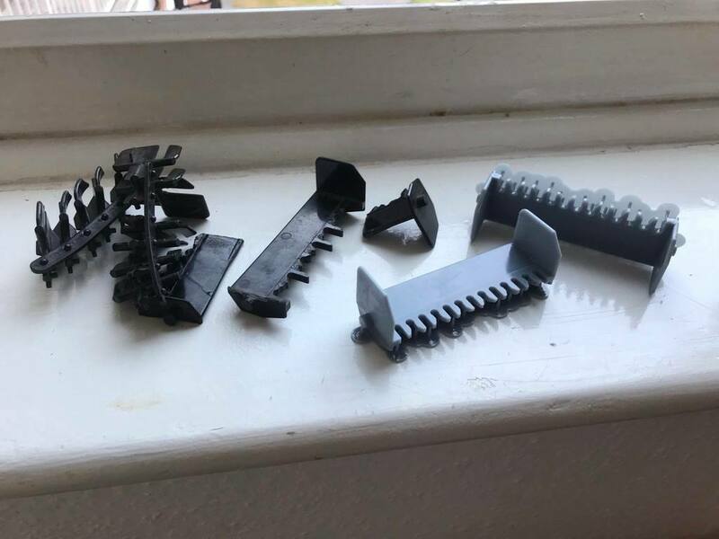

Some hero made these on 'thingiverse', and they're really a good fit - apart from being grey, but I think I'll redo them in black.

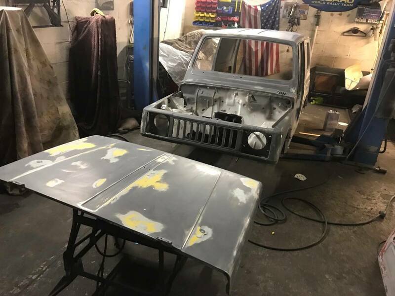

I spent ages flatting this back so there weren't any imperfections.
I got round to buying 2.5 litres of Porsche Crayon Grey, never knew paint was so expensive, and I had to buy more of it.
Off comes the body again
It went up on the ramp:
Everything got covered in fancy filler primer which hides a many imperfections as my Suzuki body is like the surface of the moon :(
After a bit of flatting and cleaning up, managed to get the first, second and third coat of M9A on. Did everything, including the interior and underside. Used 2.5 litres on the whole thing, and still have to do the doors, odd metal panels and the final coat.

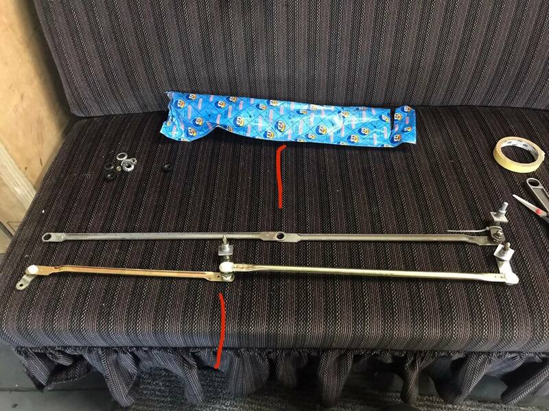

The fire had melted the wiper linkage plastics, and attempting to take them off the mouldy SJ resulted in the plastic cracking, so I ordered a new set from India.
Alas, they wouldn’t fit because changed the position of the etc etc you know the story by now.
Here's some post fire damage photos - apart from a couple of melted plugs, the wiring loom was completely undamaged. Weird. I think it was the wire to the stereo.
Spent most of the day on it, those heater bowden cables are an absolute swine and either work or don't, in my case the latter. I set them all on the settings I wanted and there's no chance of moving them by the levers as the cables are probably not routed correctly.
I cut and rewelded the wiper linkages (made one shorter, the other one longer) and they appear to work OK, but have ordered new wiper arms from India (£5 free p&p and it gets here in less than a week - ridiculous). The quality isn't always the best, but the linkages were pretty good, and I've not really had problems the multiple times I've bought from there in the past.

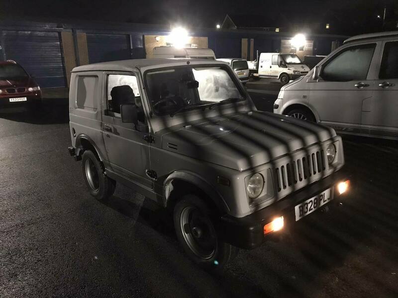

I MOT’d this a couple of months ago, it failed on a completely seized rear brake cylinder and plate lights.
it’s been nice to drive really, new suspension has made such a difference!
