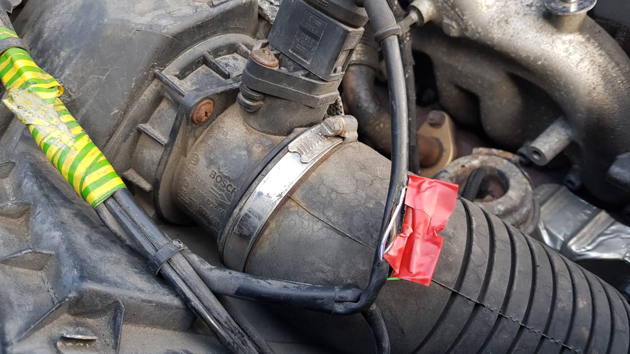

Cord Fourteener Posted March 13, 2021 Author Posted March 13, 2021 Progress is being made. A friend came round with a proper diagnostics computer and plugged it in. Although before that he told me I was going mad because it drives perfectly well. I told him there's definitely a problem, it's not like it was. So he plugged it in and sure enough the Maf was producing an open circuit to ground code, and an underboost code as well as others (the airbag has not been reset from whenever it got crashed). So we found a break in the wire to the maf plug. That may be our problem. I'll connect it up later see if it fixes the immediate issue. He also told me the turbo seals are probably leaking and I need to clean the inter cooler and all the intake and boost hosing and make sure it's all sealed. But that's due another day. First fix the wire, then get on to serving the oil and all the filters. Datsuncog, privatewire, Coprolalia and 7 others 10
rickvw72 Posted March 13, 2021 Posted March 13, 2021 There’s your issue! well found. These always have oil in the intake system when they’ve done some miles. I’d leave the turbo til it blows. My PD golf always had an oily intake. I had it from 145k to 196k, and it saw full boost most days, never was an issue. Cord Fourteener 1
Cord Fourteener Posted March 13, 2021 Author Posted March 13, 2021 28 minutes ago, Tickman said: Well found! It was one of those moments, he was just saying to me it sounds like there's an earth leak, have you checked the wiring? Mine eyes were drawn to some dodge electrical tape, the above mess lay beneath. mk2_craig and Tickman 2
Cord Fourteener Posted March 13, 2021 Author Posted March 13, 2021 30 minutes ago, rickvw72 said: There’s your issue! well found. These always have oil in the intake system when they’ve done some miles. I’d leave the turbo til it blows. My PD golf always had an oily intake. I had it from 145k to 196k, and it saw full boost most days, never was an issue. Ok that's good to know,I won't rush! The boost hose connectors are all loose, but I guess I'll see if it feels like it's lacking in time.
rickvw72 Posted March 13, 2021 Posted March 13, 2021 The common mod is to put new seals in the boost pipe joints, push in joints and secure with a self tapper. Ths clip mounts wear over time, and they open up under boost slightly. Cord Fourteener 1
Cord Fourteener Posted March 13, 2021 Author Posted March 13, 2021 Ok, temporary fix in place. Now to see if I got booost. Or not. Coprolalia, GrumpiusMaximus, Tepper and 3 others 6
Cord Fourteener Posted March 13, 2021 Author Posted March 13, 2021 F#$k me I got booost. Goes like a scalded terrier again. Ok there's a few leaks and it needs a service which it will get very soon. And there is a coolant temperature code, open circuit to battery or something. But the temperature guage works and the car goes... Phew, anyway. I thought it was going to be a never-ending chase of sticky intake, turbo and controllers, but no. It cost me a couple of beers for my friend and a cup of tea. dave j, Sunny Jim, GrumpiusMaximus and 17 others 20
