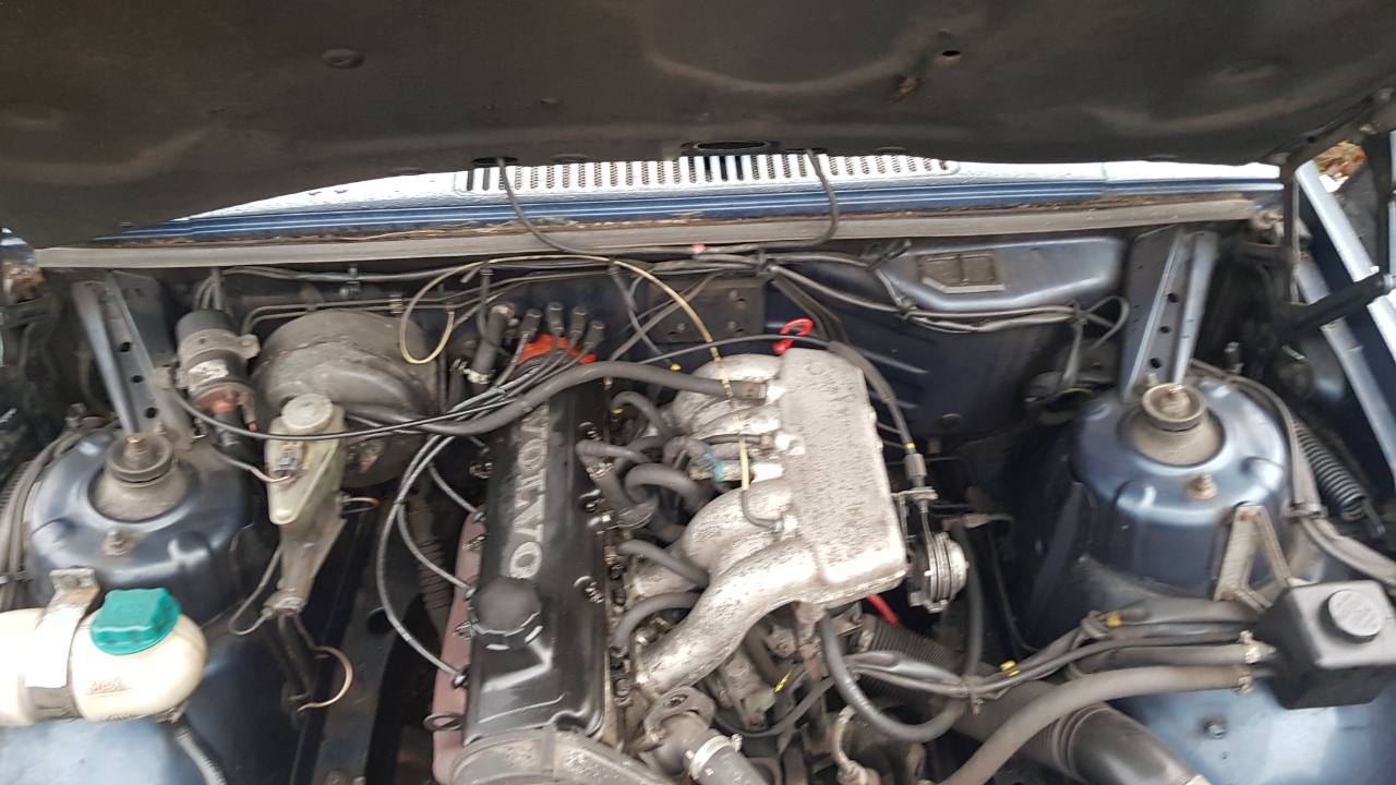

Cord Fourteener Posted January 3, 2021 Author Posted January 3, 2021 Right, engine shots. There's daylight and ground visible either side of it! Old cars... Fumbler, scdan4, Vantman and 10 others 13

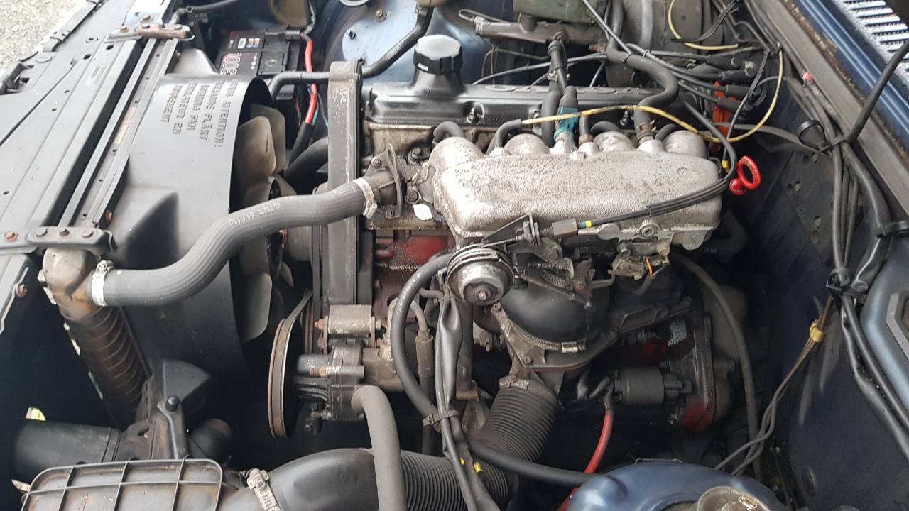

danthecapriman Posted January 3, 2021 Posted January 3, 2021 Nice! Quite an early face lift 700, with a B200E engine by the looks of it. Nice and easy to work on and pretty bulletproof mechanically. Give your flame trap a clean and a new filter element as I bet it’s dirty. If they plug up it over pressurises the crankcase and starts causing leaks etc. Shep Shepherd and The Mighty Quinn 2
Cord Fourteener Posted January 3, 2021 Author Posted January 3, 2021 55 minutes ago, danthecapriman said: Nice! Quite an early face lift 700, with a B200E engine by the looks of it. Nice and easy to work on and pretty bulletproof mechanically. Give your flame trap a clean and a new filter element as I bet it’s dirty. If they plug up it over pressurises the crankcase and starts causing leaks etc. I think it's the B200E, it's the 2.0 red block by common parlance. And it's the my90 face 'update' so it's got some nice features like extra galvanisation and slightly tidier styling of the front and rear. You'll have to explain the mechanical thingamy... What and where is the flame trap? By filter element do you mean air filter? There's a slight oil leak on the mot and underneath when I park, I think it's the rocker cover gasket? you can see a shiny area around the gasket anyway. Mechanically it seems fine, I'm told it's fine. I know it's had hgf and front brake seizure c/w boiling brake fluid, and the relevant repairs along with enthusiastic servicing in recent history. Power steering seems a bit lumpy but everything in the engine bay seems to work well. I'm very glad of advice and as this is a keeper I'm keen to do what's necessary, even by myself even though I've discovered in not mechanically inclined... I can do jazz, folk and mediaeval music and theorise about engineering but actually doing mechanicing doesn't go as well as I like it to 😅 Macscrooge, danthecapriman and scdan4 3
danthecapriman Posted January 3, 2021 Posted January 3, 2021 The flame trap is a little breather element in-line with the engines crankcase breather system, it basically stops lumps of oily crud and liquid oil residue etc from getting drawn into the engine as it recycles its own dirty oily air. It’s located directly beneath the inlet manifold on the B2xxE engines, it’s hard to see and a bit of a pig to get to sometimes but does often need doing. There’s a few rubber hoses coming out/into it and it’s a little black plastic case that separates into two halves with a breather filter element inside. A new element costs pence from volvo specialists and I think you can get them on eBay too. I covered it on my thread about mine. A little Over half way down the page. If it blocks it stops the excess pressure inside the engines crankcase venting, the over pressurising starts oil leaks and can even damage gaskets. On one of my previous cars it actually used to cause the oil dipstick to pop out of its tube when you revved the engine! Low Horatio gearbox and Cord Fourteener 1 1
Cord Fourteener Posted January 3, 2021 Author Posted January 3, 2021 5 minutes ago, danthecapriman said: The flame trap is a little breather element in-line with the engines crankcase breather system, it basically stops lumps of oily crud and liquid oil residue etc from getting drawn into the engine as it recycles its own dirty oily air. It’s located directly beneath the inlet manifold on the B2xxE engines, it’s hard to see and a bit of a pig to get to sometimes but does often need doing. There’s a few rubber hoses coming out/into it and it’s a little black plastic case that separates into two halves with a breather filter element inside. A new element costs pence from volvo specialists and I think you can get them on eBay too. I covered it on my thread about mine. A little Over half way down the page. If it blocks it stops the excess pressure inside the engines crankcase venting, the over pressurising starts oil leaks and can even damage gaskets. On one of my previous cars it actually used to cause the oil dipstick to pop out of its tube when you revved the engine! Great stuff, good to know. I'll get rummaging when I can! I'll have read your thread a few times by then though 👍 danthecapriman and juular 2
danthecapriman Posted January 3, 2021 Posted January 3, 2021 Here’s the filter element: https://www.partsforvolvosonline.com/product_info.php?cPath=105_919_922&products_id=5277&osCsid=8565022f8d45f9d49b4a1ea3ee82f252

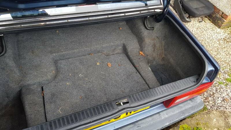

MondeoBlues Posted January 4, 2021 Posted January 4, 2021 The damp in the boot may be because I accidentally poured in a bit of snow off the bootlid when I cleared it out last week. Sorry. I did have a look at the oil leak last time I took it for a service, and me and my tame mechanic deduced that it's either the rocker cover gasket, the oil filler cap seal, or possibly from an o ring around the distributor. Not big jobs but a bit fiddly. Cord Fourteener 1
Cord Fourteener Posted January 4, 2021 Author Posted January 4, 2021 3 hours ago, MondeoBlues said: The damp in the boot may be because I accidentally poured in a bit of snow off the bootlid when I cleared it out last week. Sorry. I did have a look at the oil leak last time I took it for a service, and me and my tame mechanic deduced that it's either the rocker cover gasket, the oil filler cap seal, or possibly from an o ring around the distributor. Not big jobs but a bit fiddly. It looks like spillage, I'll get it dry and see anyway. I did look under the carpet and it's brand new under there. Most of my cars have had 'slight oil leak', my BMW was doing oil like teenagers do vaping so it's really not much to me. I might get it sorted one day. Room for gentle and gradual improvement 🙂 I managed to spray carpet glue up into the holes in the headlining (there are more today than yesterday thanks to children!) And it's now very torn but at least stuck to the roof. One day I'll get a whole new headlining in there, but these are all little things. Car works. Loving it 👍 MondeoBlues, Shep Shepherd and danthecapriman 3

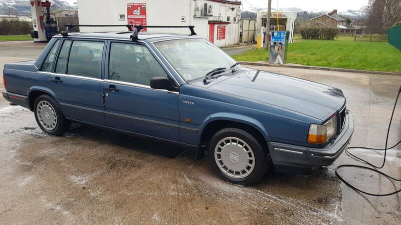

Cord Fourteener Posted January 5, 2021 Author Posted January 5, 2021 Ok my first pez shot (I have put fuel in before now with fuel cans just because I had then there with fuel in) and a wash after all the gritty icy sludge recently. I have verified the fact that the boot doesn't leak, but water pours in if you open it when there's surface water on it! RobT, MondeoBlues, Vantman and 9 others 12

juular Posted January 6, 2021 Posted January 6, 2021 On 1/5/2021 at 9:52 AM, Tim_E said: I have verified the fact that the boot doesn't leak, but water pours in if you open it when there's surface water on it! What a handsome looking thing. I recently went through the same water-in-boot-wtf head scratching process with my 240. Always a wet bit right in the middle where there's nothing that could possibly leak in that manner. Until I opened it with snow on it.. I wonder if there's a bit of trim missing from our cars as that unthoughtfulness seems distinctly un-volvo like. From the company that gives you headlamp washers and a light under the bonnet to work with! Cord Fourteener 1
Amishtat Posted January 6, 2021 Posted January 6, 2021 There's a channel along the bottom of the rear screen which needed clearing out of sludgy shit when I got mine. Haven't got the car in front of me so can't remember exactly but I seem to remember that it helped when I opened the boot with rainwater on it. Connects with the drain channels either side of the bootlid opening, I just used a bit of coat hanger wire. juular and Cord Fourteener 1 1
