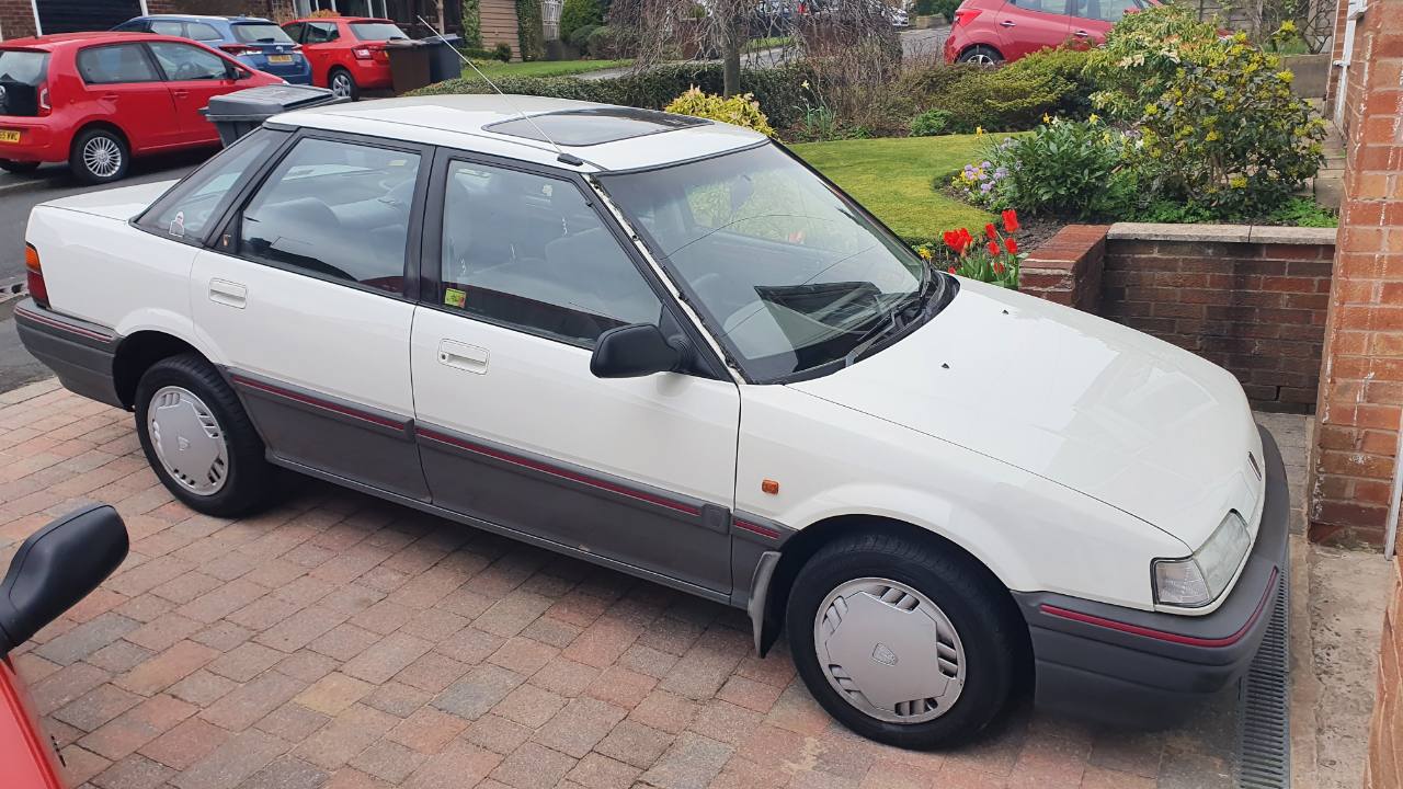

Lovely 400! Didn't you have one pretty much the same before though?
Yes, and it was a rather good one at that.
For a loooong time I've been annoyed at myself for selling that one, I even asked to buy it back but was refused.
When this came up in the same spec, and crucially, in equally good condition but with more history to back it up (the old one had zero) I knew I had to have it as the chances of finding another short indicator Diamond White automatic saloon were close to zero - R8s are getting rare now and prices are rising fast. My mum is also a big fan of R8s and has been quietly hoping I'd get another too.
It's a wonderful car, and a definite keeper.

So, today.
Uneventful train journey took me to Birmingham International, where I'm met with a rather shiny 416. The seller, rather efficiently, had arrived 40 minutes early and opened all the windows for Covid safety. Top man. Business was done, I was shown all the bits that are included and a couple of niggles, then I'm on the way.
The M6 is awful at any given time - mercifully Birmingham International is on the M42 which feeds directly into the M1, so getting home was easy, and I got to take one of my preferred routes home when collecting a car - up the M1 to J30, into the centre of Sheffield through the townships, then over the Snake Pass. It's a great route as it has a little bit of everything to help you get a feel for a car - town/city driving, motorway, 50mph A-roads, twisties etc.
Well the 416 was flawless, and with half a tank of fuel included, it got home without a fillup.
The drive home and a look around has yielded a small to-do list:
-throttle cable is slack (TADTS)
-valve clearances (TADTS)
-clock needs a new bulb (TADTS)
-hockey stick needs revarnishing (TADTS)
-shifter cable stiff going into P, will need replacing (common)
-brakes need bleeding, the pedal was stiff at first and the brakes are rather on/off
-straighten up the bumper mounting bars
-better routing for DAB aerial
-refit lower dash trim
A bit of the dash trim is also badly damaged, I'll have to sort a replacement out for that.
Mechanically it's spot on (and it has the giffer hallmark of several oil stickers on the underside of the bonnet), starts first crank every time (this is a sign you've got a good D16), it's on four good name brand tyres, handles confidently, and cruises effortlessly and surprisingly silent. The throttle response is a bit naff but cleaning the throttle body and setting the throttle cable correctly (it's so slack the pedal is on the bulkhead before the kickdown actuates) should sort that. If not then some ignition components might be needed.
It's a wonderful car and should be a joy to work on. It's definitely a keeper.
