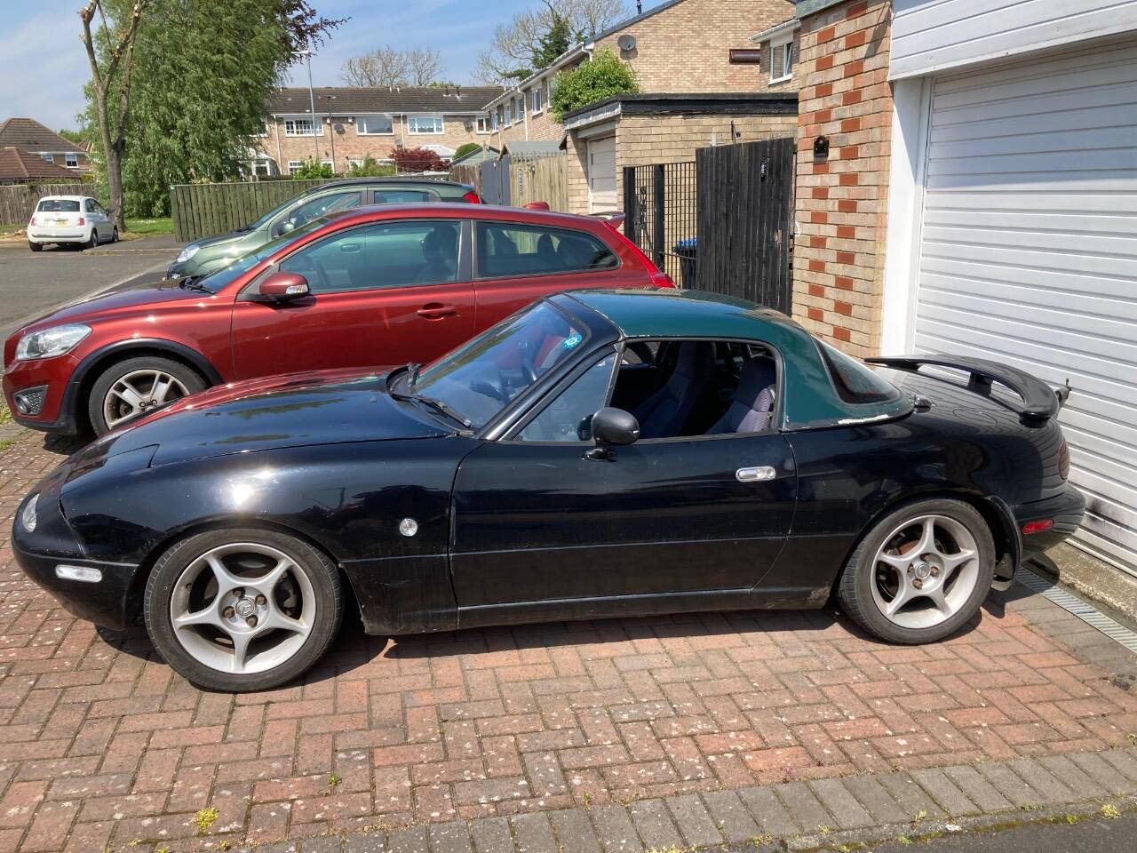

bought a hardtop !
it was cheap and very local - i’ll give it a rattle can tart up then it can live in the spare room until winter :)

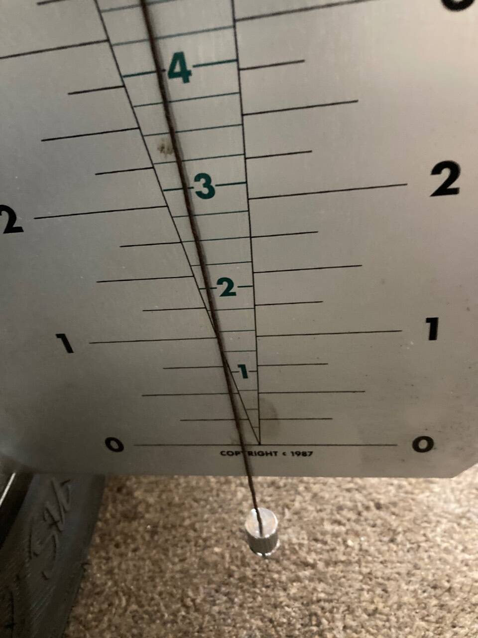

me and @DVee8 went to a car meet last week, i took the exo and he took the comfy option of a lift in his sons bmw.

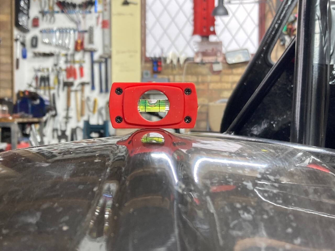

he commented that when following the exo, it looked like the right rear wheel had excessive camber
which, looking at this pic, does appear to be true
time to check the measurements - here’s what it should be
left side
right side
pretty much where they should be.

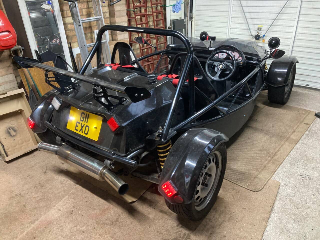

but hang on a minute, what about those mudguards ?
left
right
yep, that would be our problem
all i need to do is bend the supports which would be an easy fix if i hadn’t glued them on with PU adhesive :(
hey ho, at least it’s nothing serious

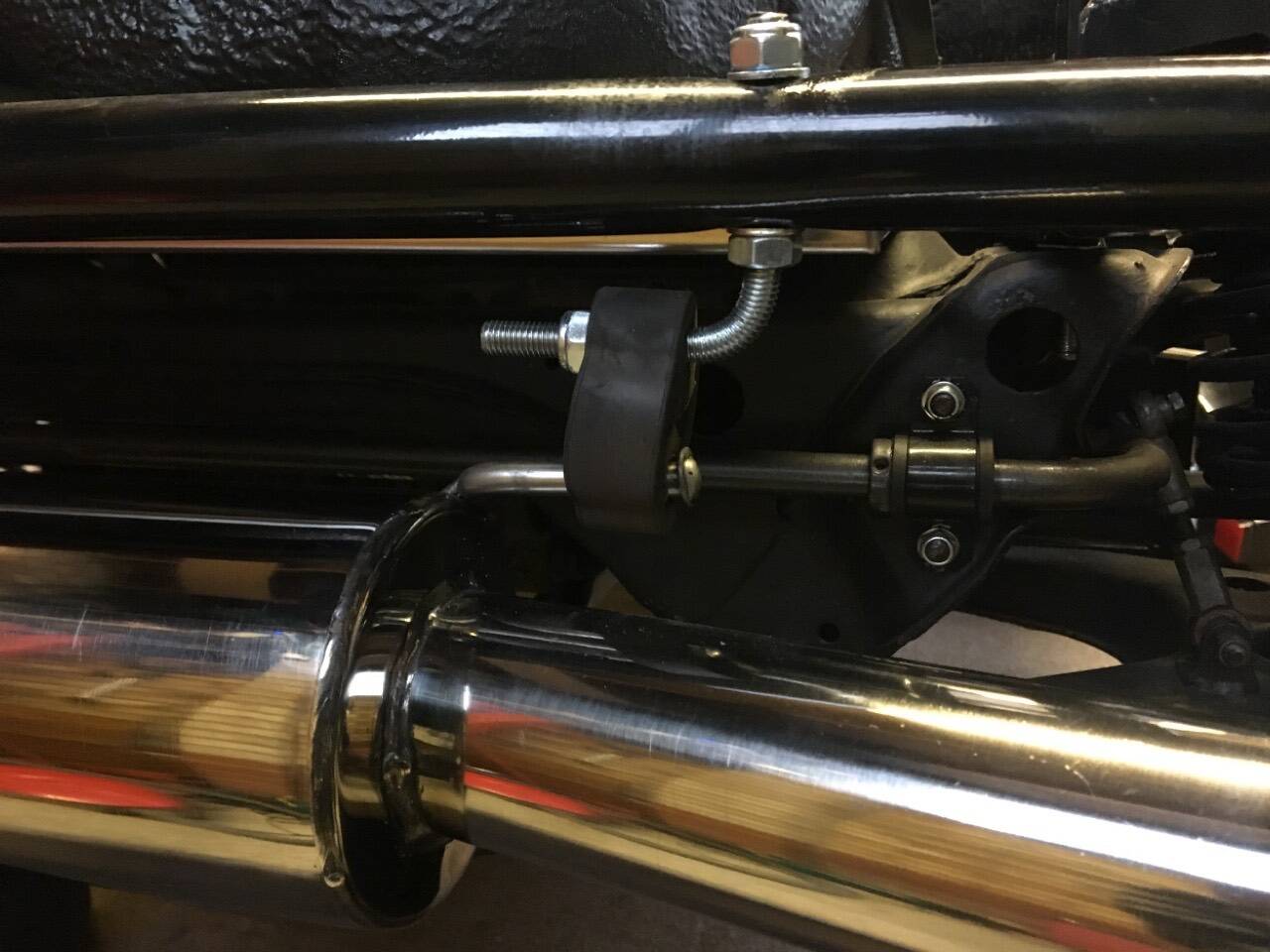

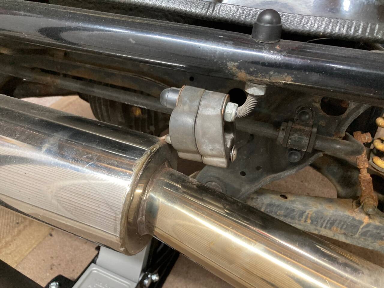

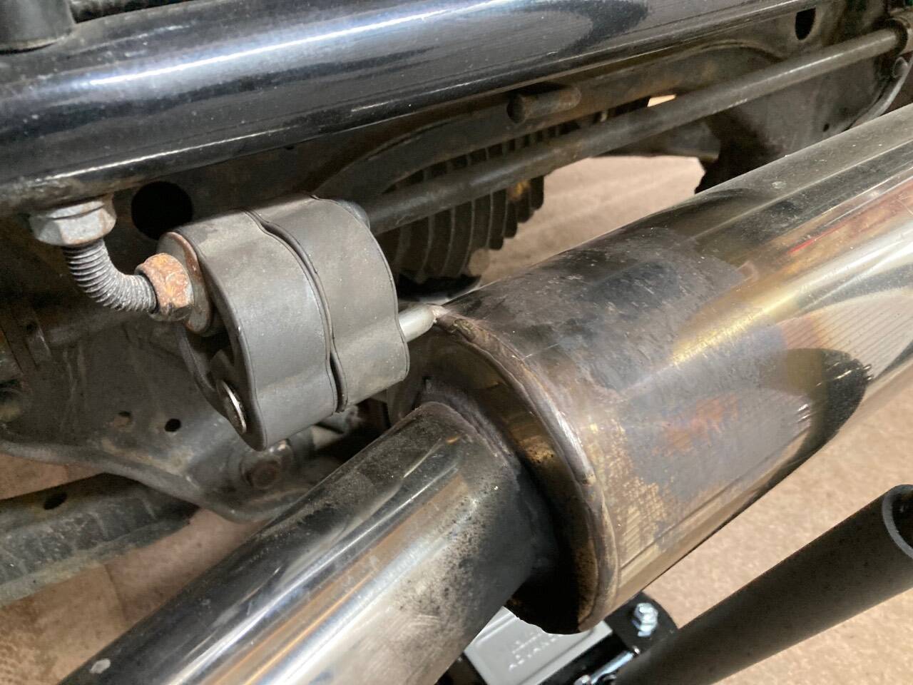

he also commented that the exhaust was a bit* wobbly
it’s supported by two rubber hangers thus :
which are fine for up and down but too flexible side to side
another easy “fix”

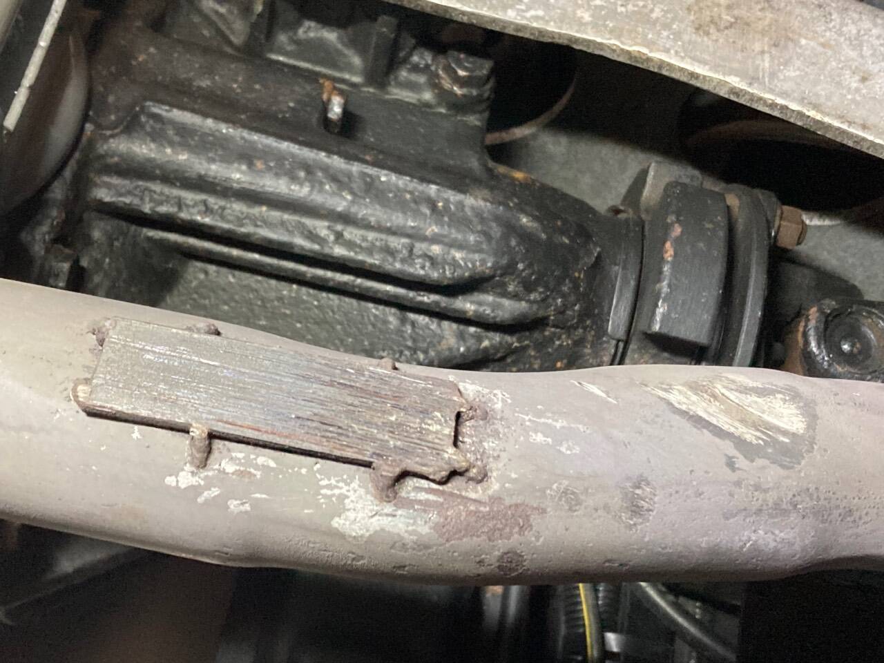

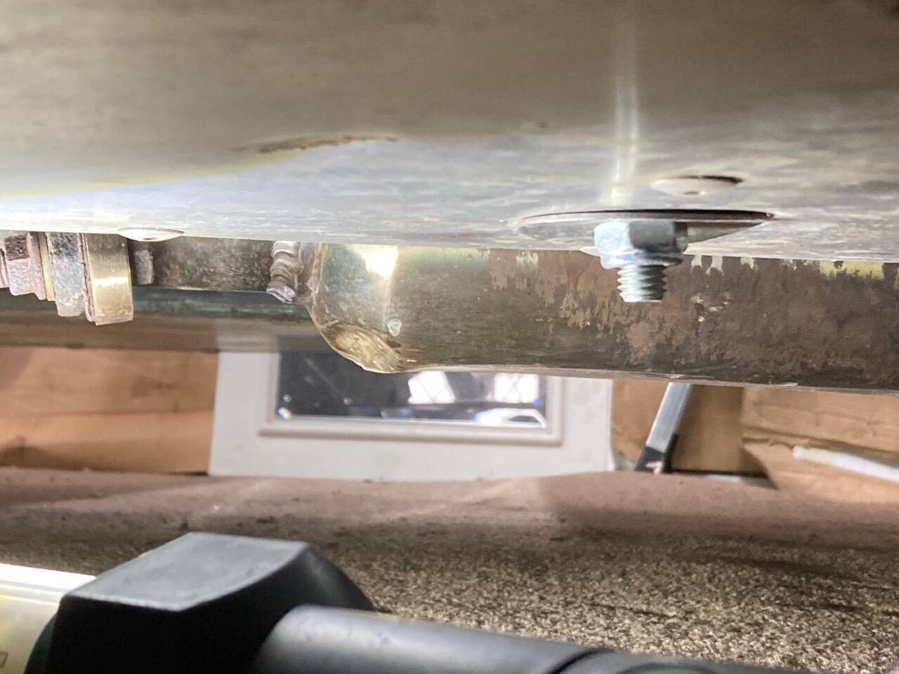

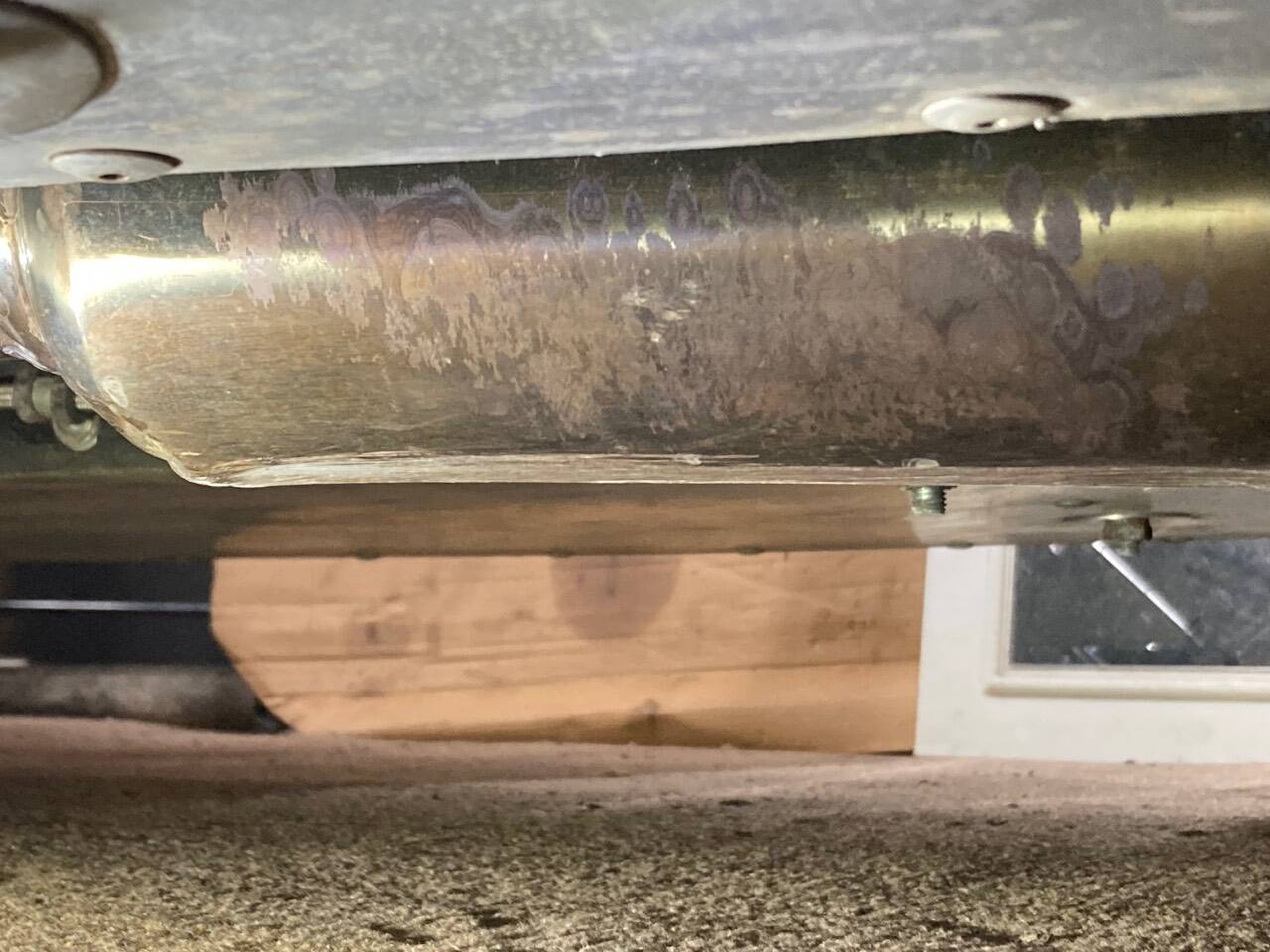

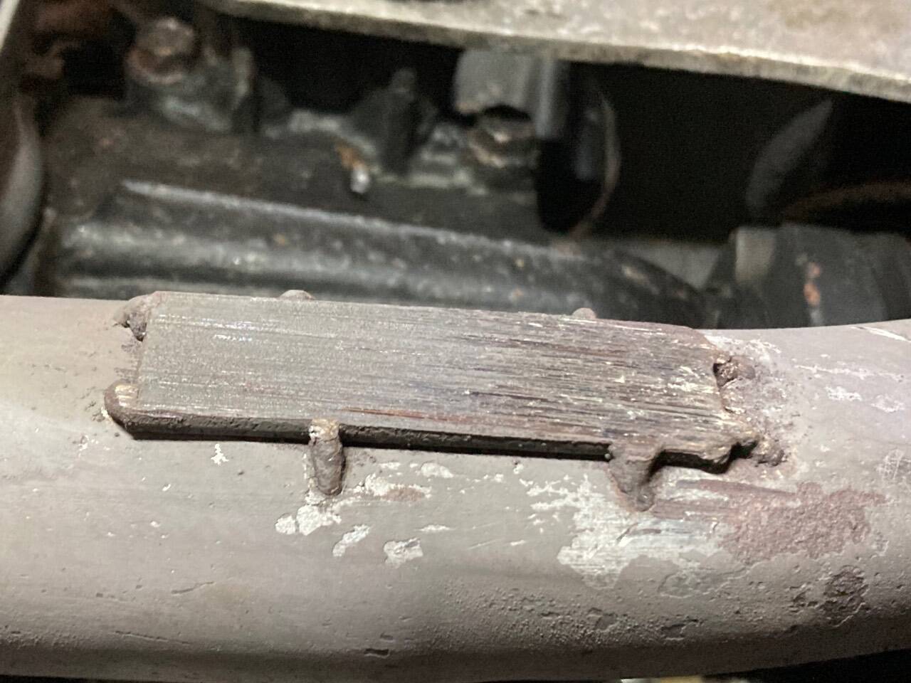

while it was up in the air, i checked if my sacrificial plate was working
yep, seems to be doing the job :)

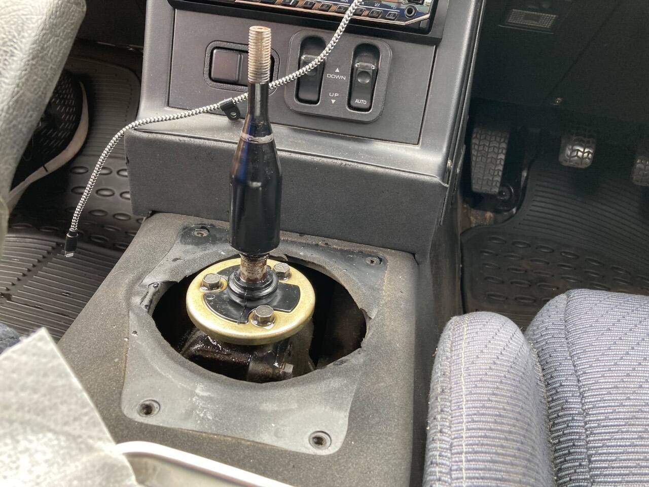

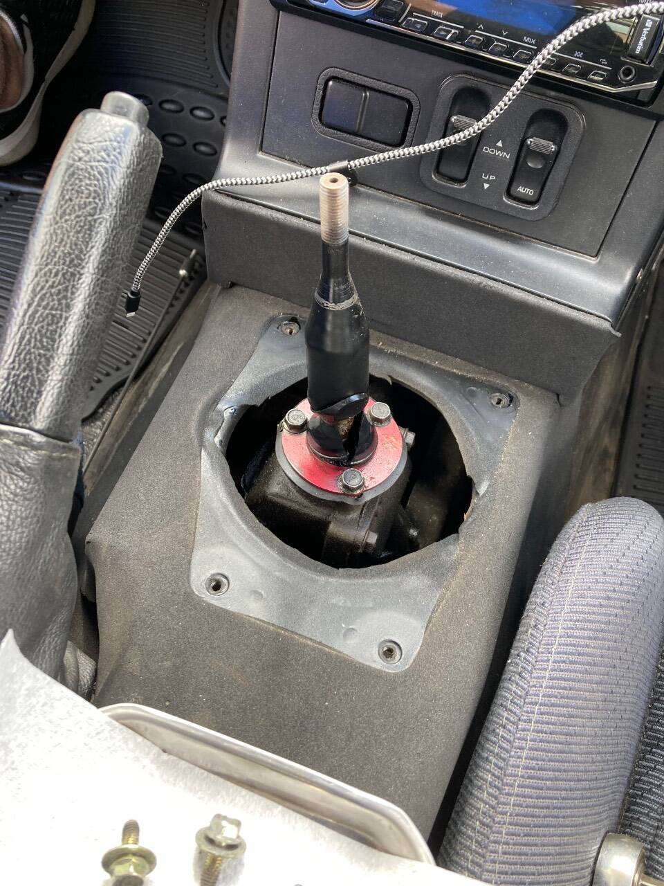

the mx5 hasn’t been seeing much use recently so i took it for a run out. maybe because i’ve been driving the volvo (auto) quite a bit recently, the gear change didn’t feel as good as it should.
removing the upper cover revealed
yep, the rubber boot that keeps the turret oil in has split quite badly
i topped up the oil and fitted a replacement
fitted a new upper cover

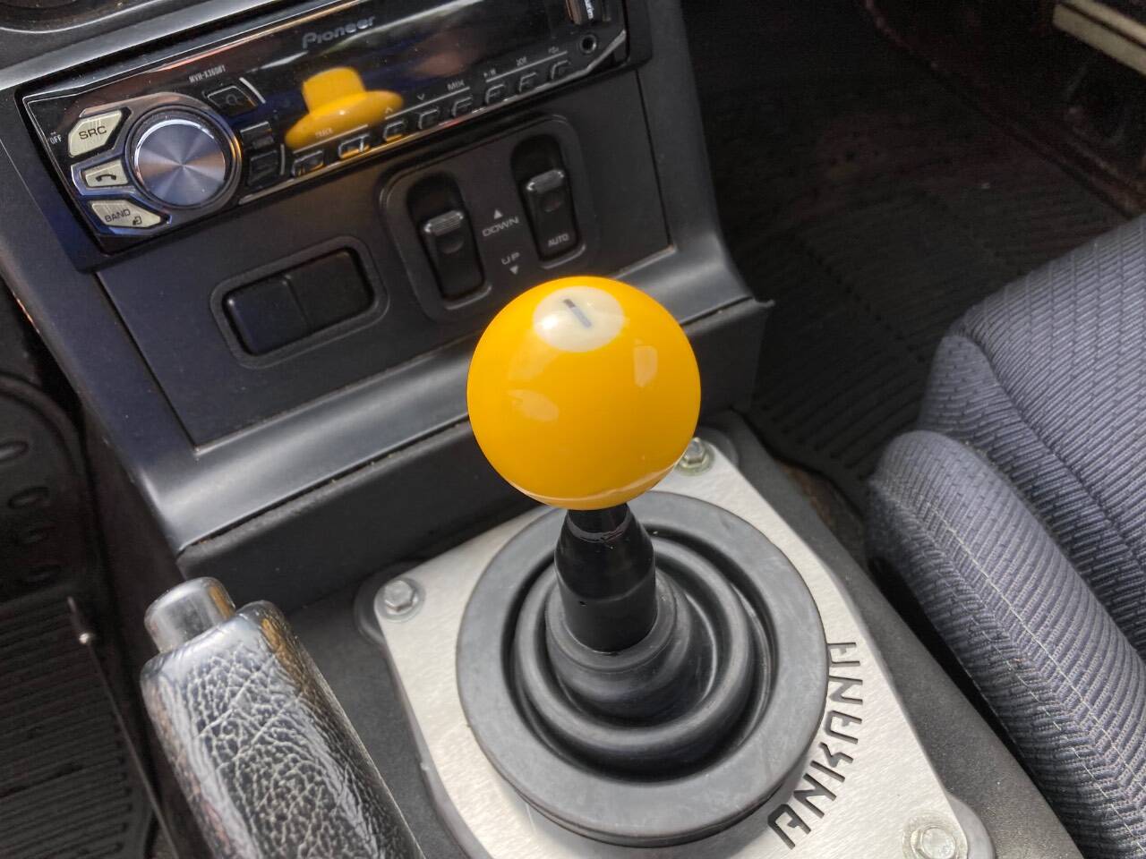

then remembered something i’d bought ages ago intended for the exo
looks pretty neat :) @jakebullet
a quick test drive and the gear change is back to how it should be - ready for next weeks trackday down at teeside

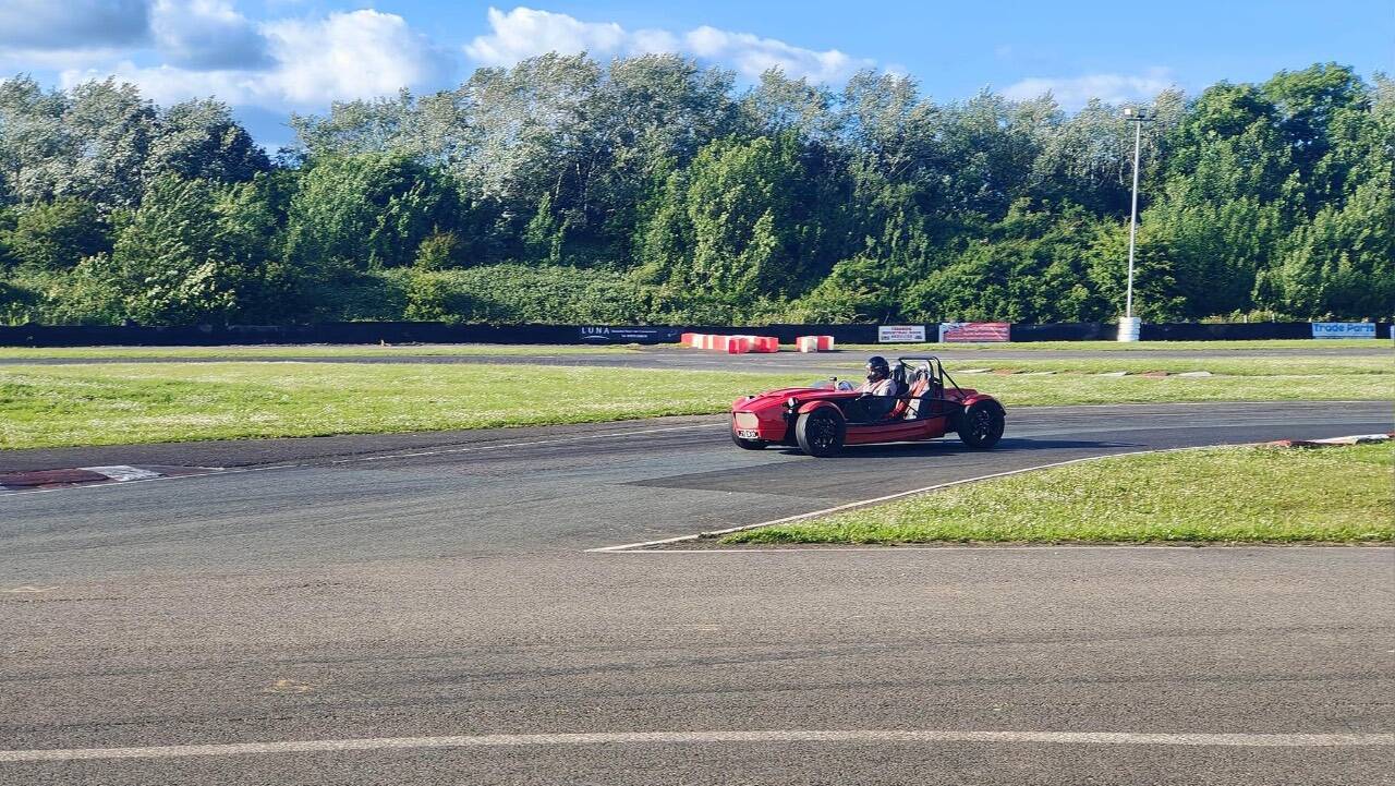

Exo made her track debut this evening
but who’s that in the driving seat ?
bloody @DVee8 that’s who ! :)

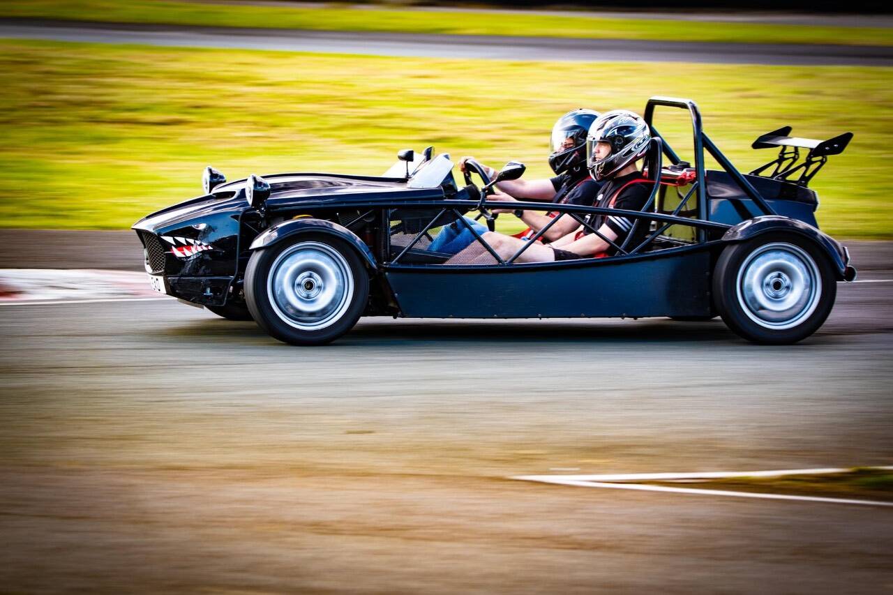

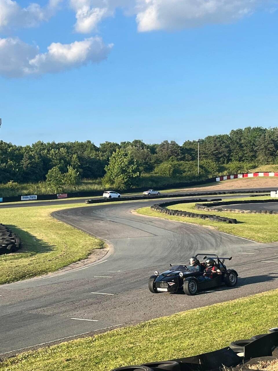

we had booked both the exo and the mx5 for the track evening down at teesside autodrome, and a whole lot of fun it turned out to be !
youngest son Adam only passed his test last year so hadn’t been on track yet - i volunteered to take him out in the mx5 and give him some pointers so @DVee8 and older son Ben got first dibs in the Exo
and we did some hooning ! those poor little cars took a sound thrashing and kept coming back for more

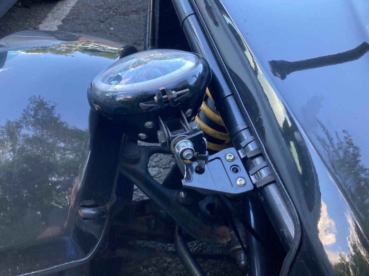

the Exo had been experiencing a bit of a wobbly headlight that wobbled its last when i got behind the wheel :(
no matter, i just moved it along the bracket into the next available hole and called it job done :)
i’d been out in the exo quite a bit, so fancied a go in the mazda, turns out we’d left the brakes somewhere near the hairpin - not in a dangerous way but it was a sign to let things cool down a little.
so i’d had a go on the mazda and the exo, dvee8 had had a go on the mazda and the exo, Ben had had a go on the mazda and the exo so it seemed only fair that Adam had a go too.
he did a great job driving the mx5, listened to the advice and was obviously learning quickly.
so i let him loose on the exo
and he bloody loved it :)
an excellent day out !

towards the end of the evening, i managed a few laps in the Exo flying solo and started pushing it a bit more, hellfire, it’s a shitload of fun !
which is ridiculous considering i knocked it up in my garage from a poor old mazda that was destined for scrap.
what a car :)

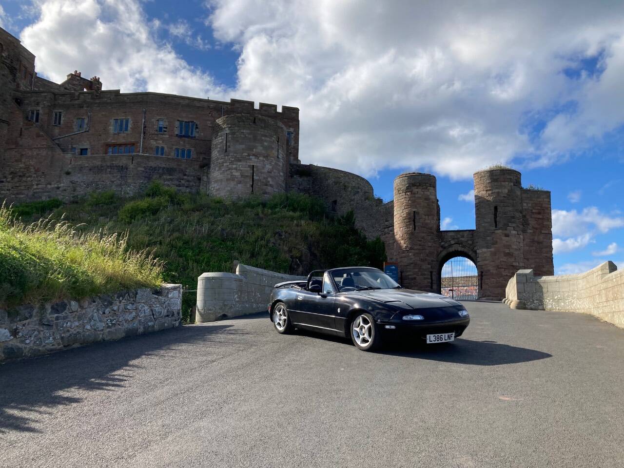

i had a day off work and fancied a drive so took the mazda for a run up the coast to Bamburgh
i found a suitable parking spot
and went for a walk along the beach
discovering that the castle was closed but the gates weren’t, i had no choice but to come back for pics
some passing tourists saw what i was doing and stopped to take pics of the car too :)

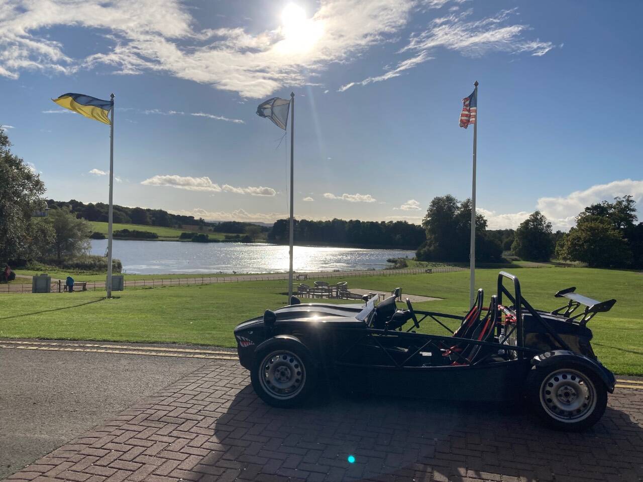

me and @DVee8 went to the car barn meet a couple of weeks back, the exo was in good company
all sorts of interesting motors there
on the way back i popped into Beamish Hall for a photo

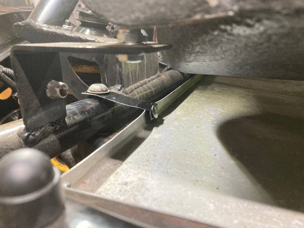

exo had developed an annoying rattle, possibly as a result of last months track day shenanigans
whilst scoffing a sausage roll outside greggs, i idly looked around the back of the car and noticed the fuel tank drip tray was a little looser than when i fitted it
yep, that’ll be yer problem
i remade it in steel instead of aluminium
and all is now secure :)
