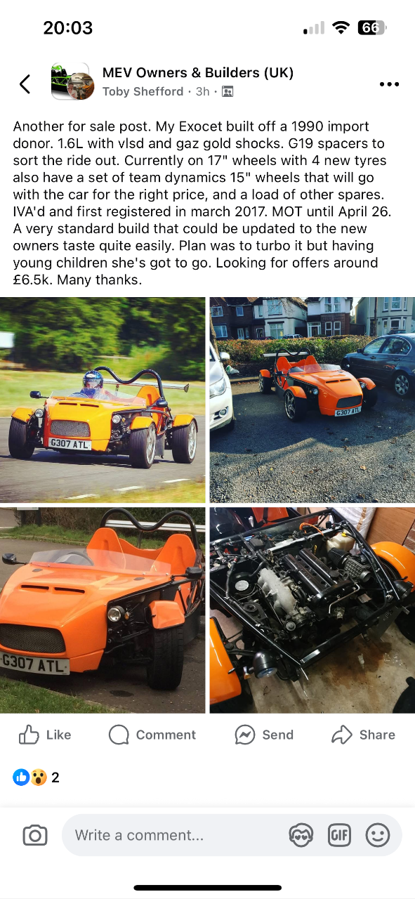

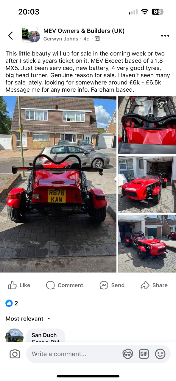

here’s another few off the exo fb group if anyone is interested (curiously all around the same price)

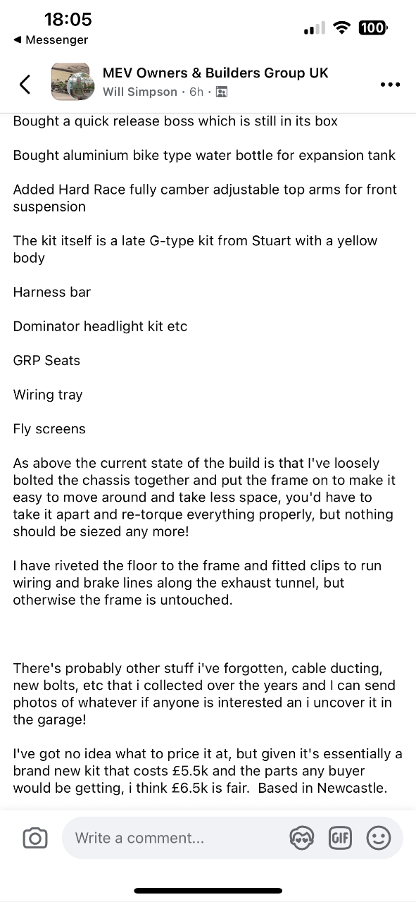

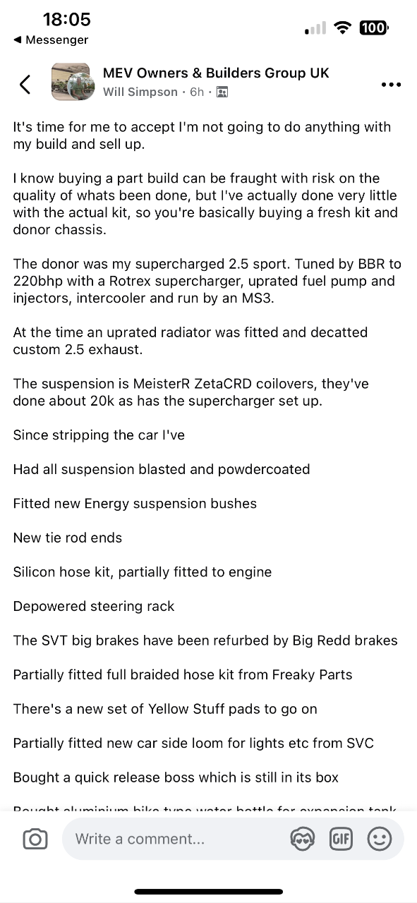

or take on a part built project ? @NorthernMonkey
supercharged 2.5 litre engine - this will be one terrifying piece of kit !

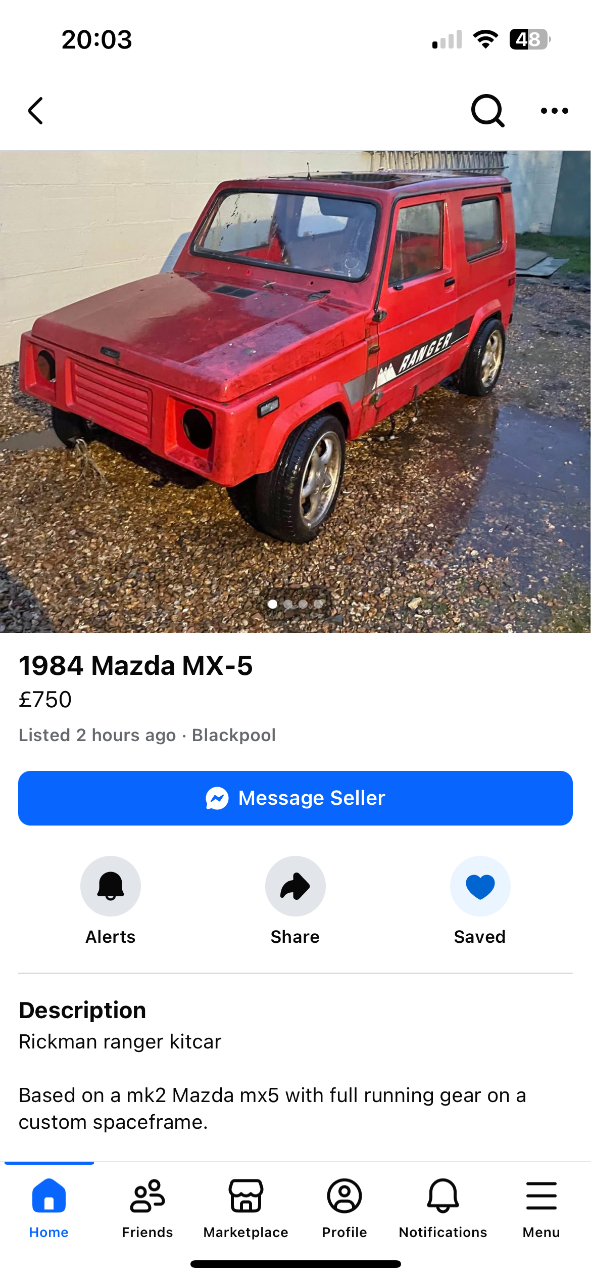

is that a kit car?

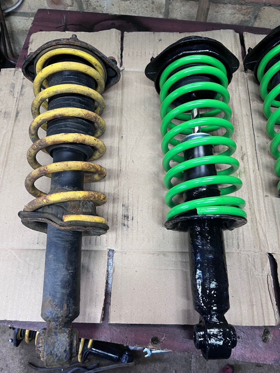

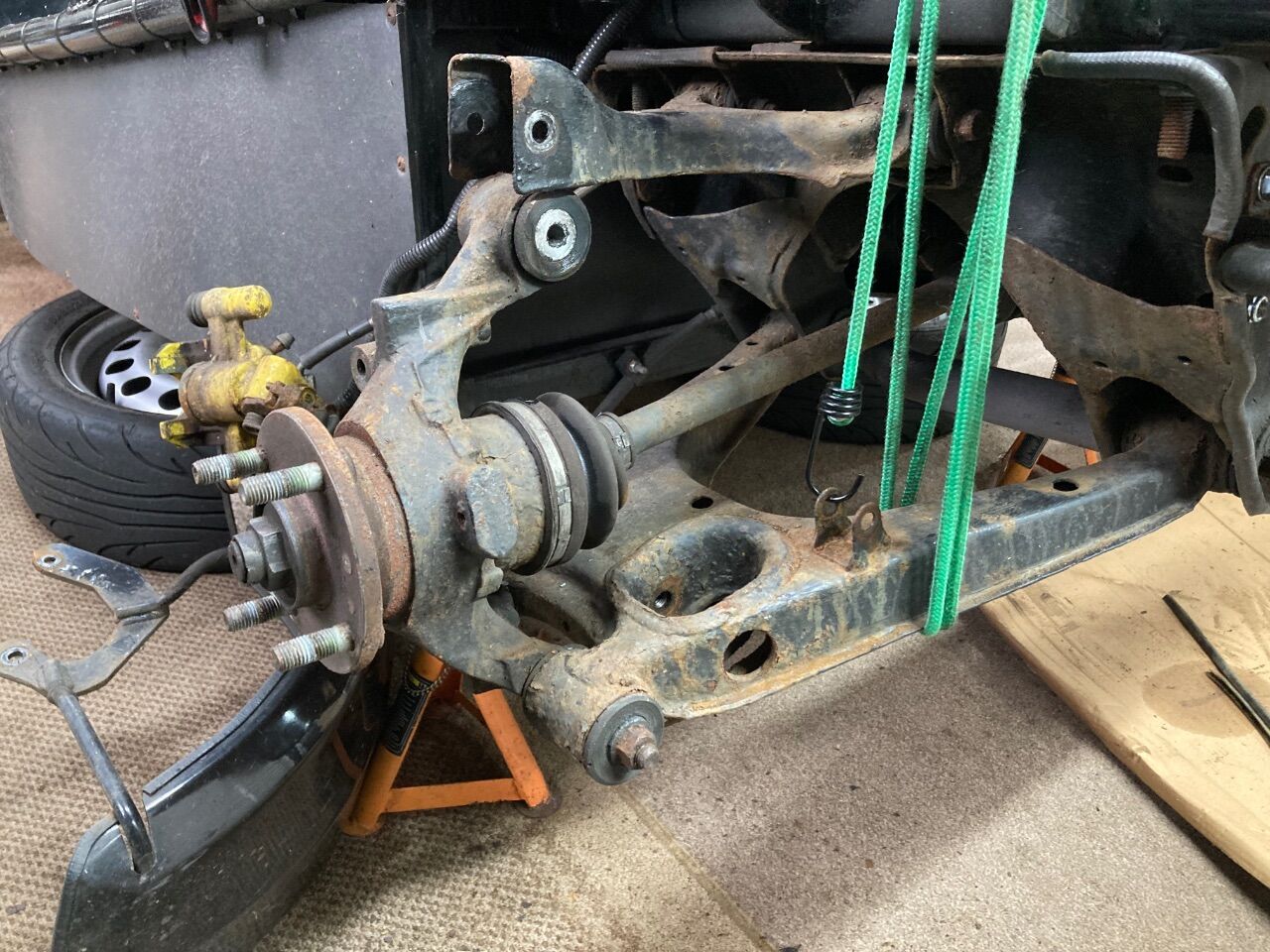

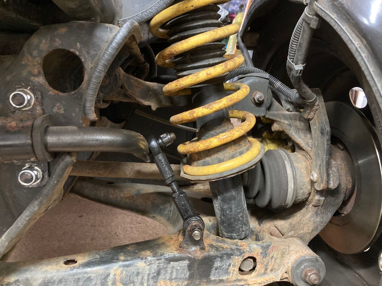

having run it over winter the first year, the suspension was looking a little rough
time for a tidy up

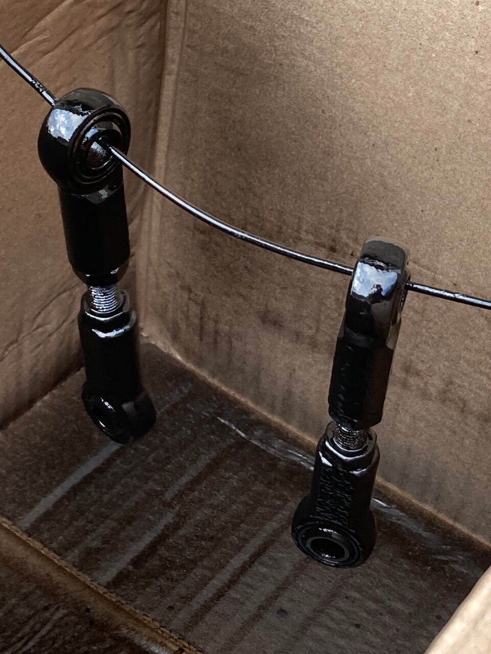

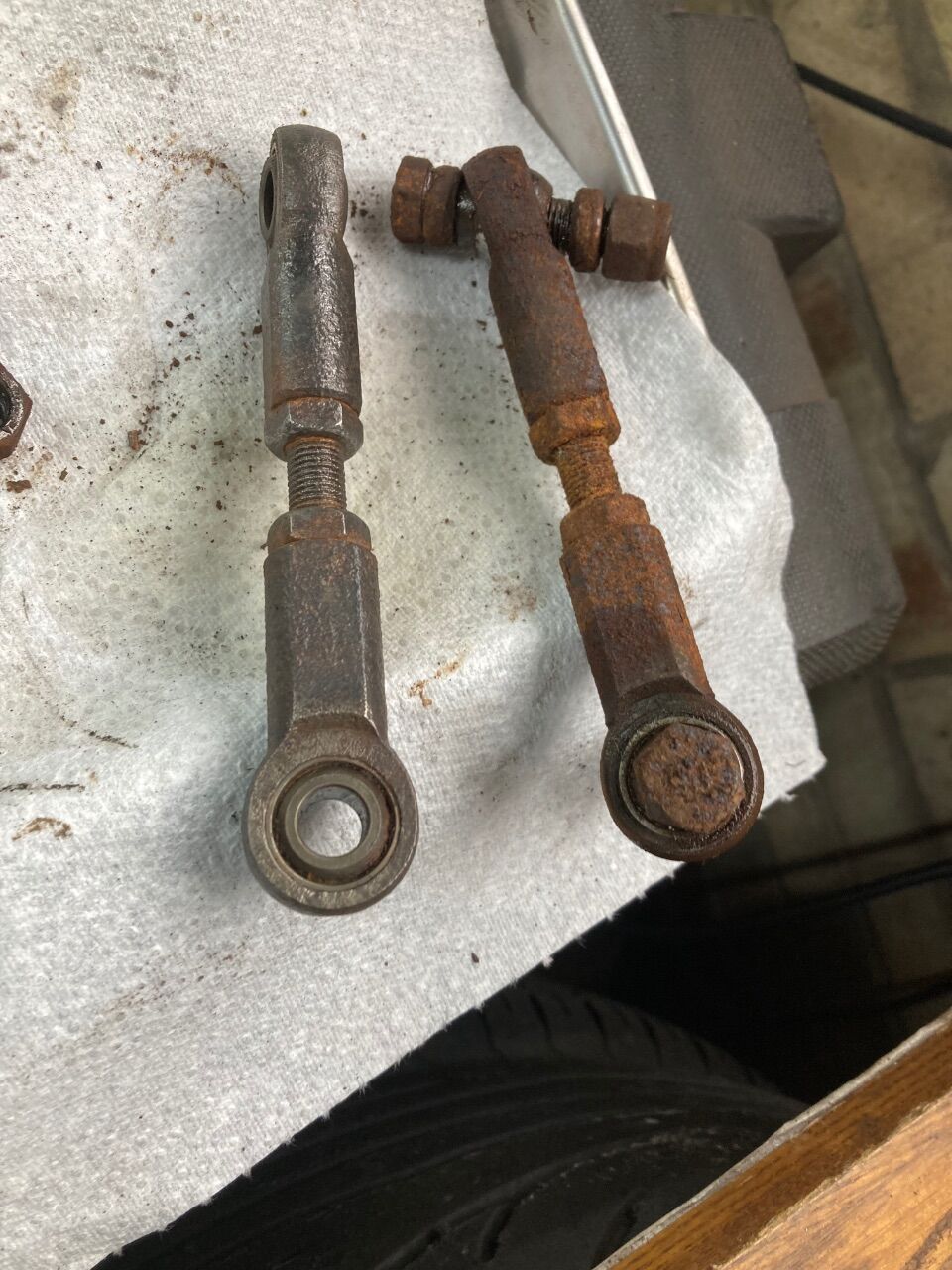

 droplinks  too
then winter came round and i didn’t have time to do the other side :(

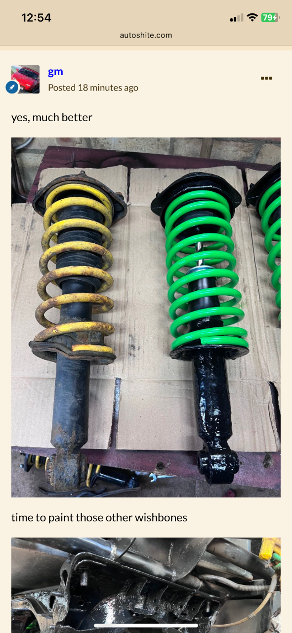

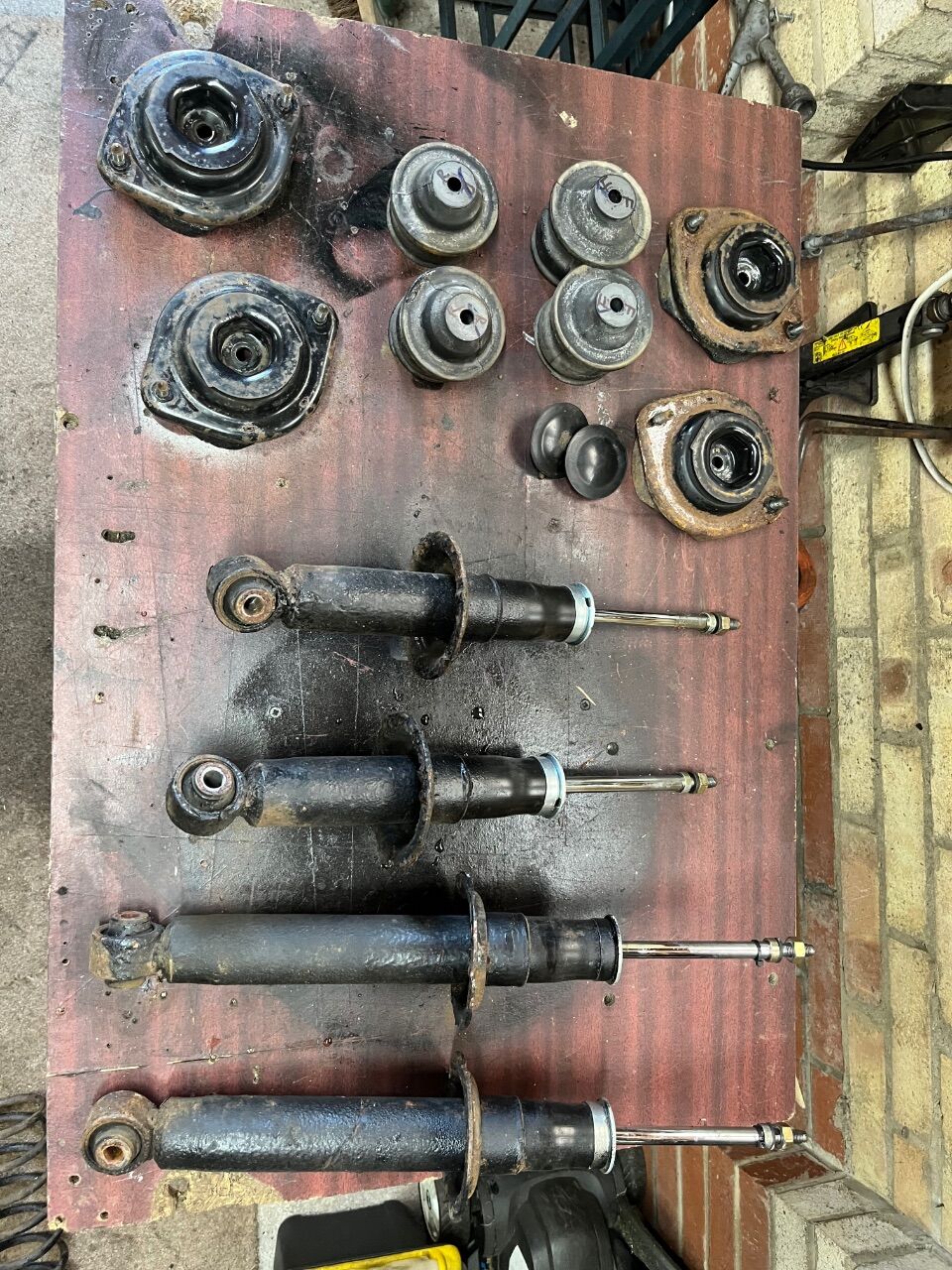

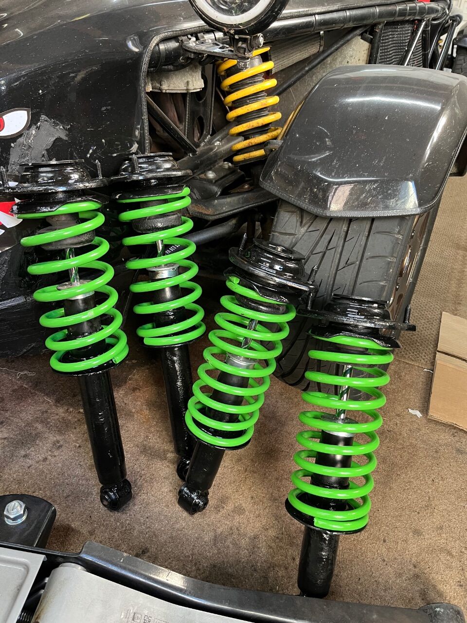

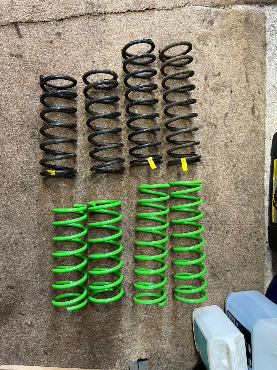

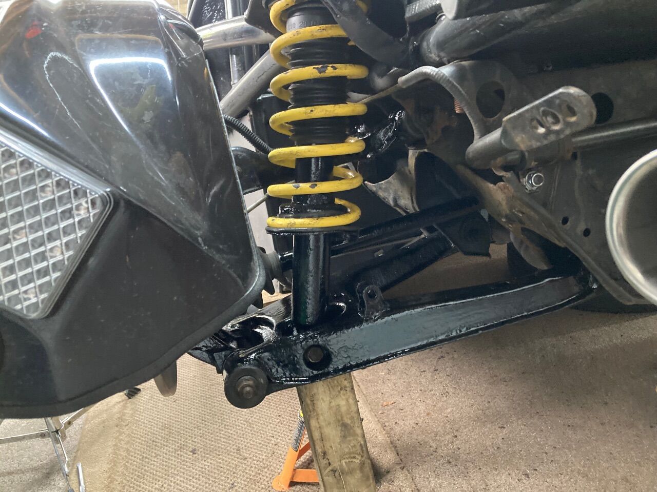

the mk2 suspension with those yellow springs was also letting the side down so when a set of low mileage mk1 shocks appeared locally, i snapped them up
(the lad selling them had just bought a 1995 mk1 mx5 with 27,000 miles on it - it was beautiful)

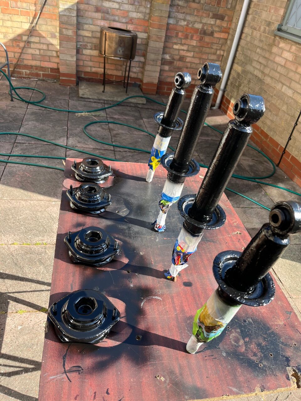

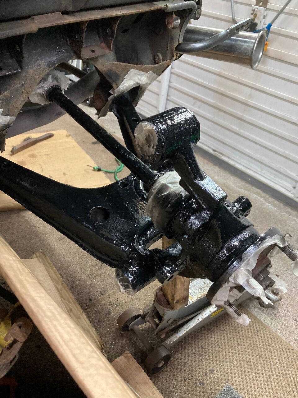

still looking a bit scruffy, i pulled them apart for a lick of paint
i found a set of springs in the loft (bought years ago from a fellow exo builder who had them stripped and coated before changing his mind)
and got them all put back together again
yes, much better

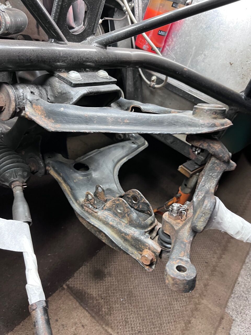

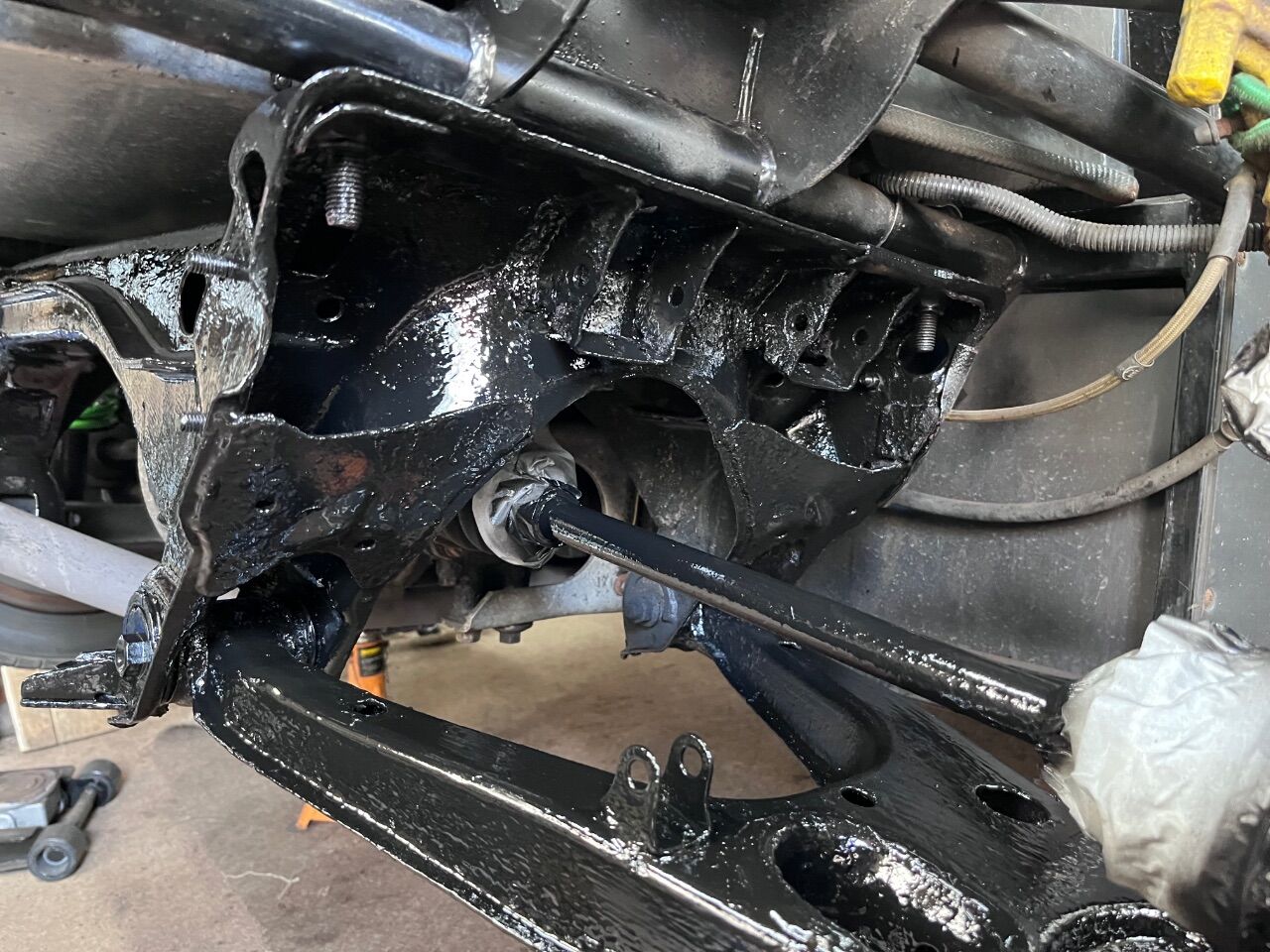

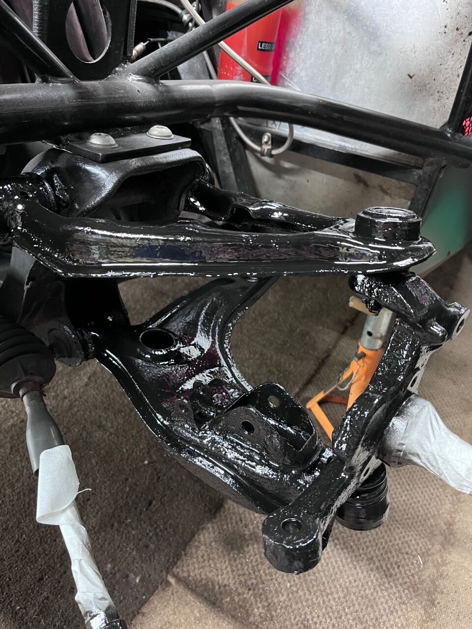

time to paint those other wishbones
a big improvement

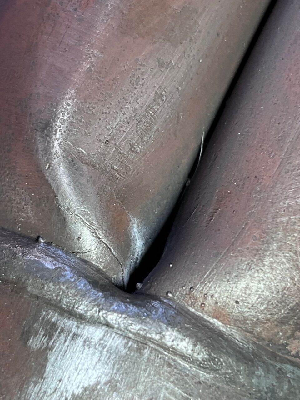

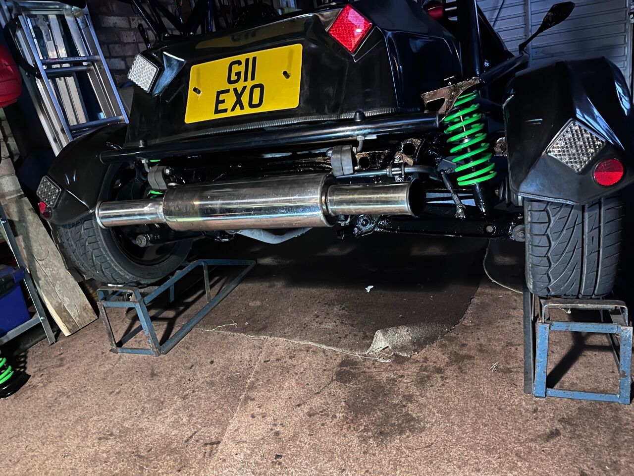

while the exhaust was off :)

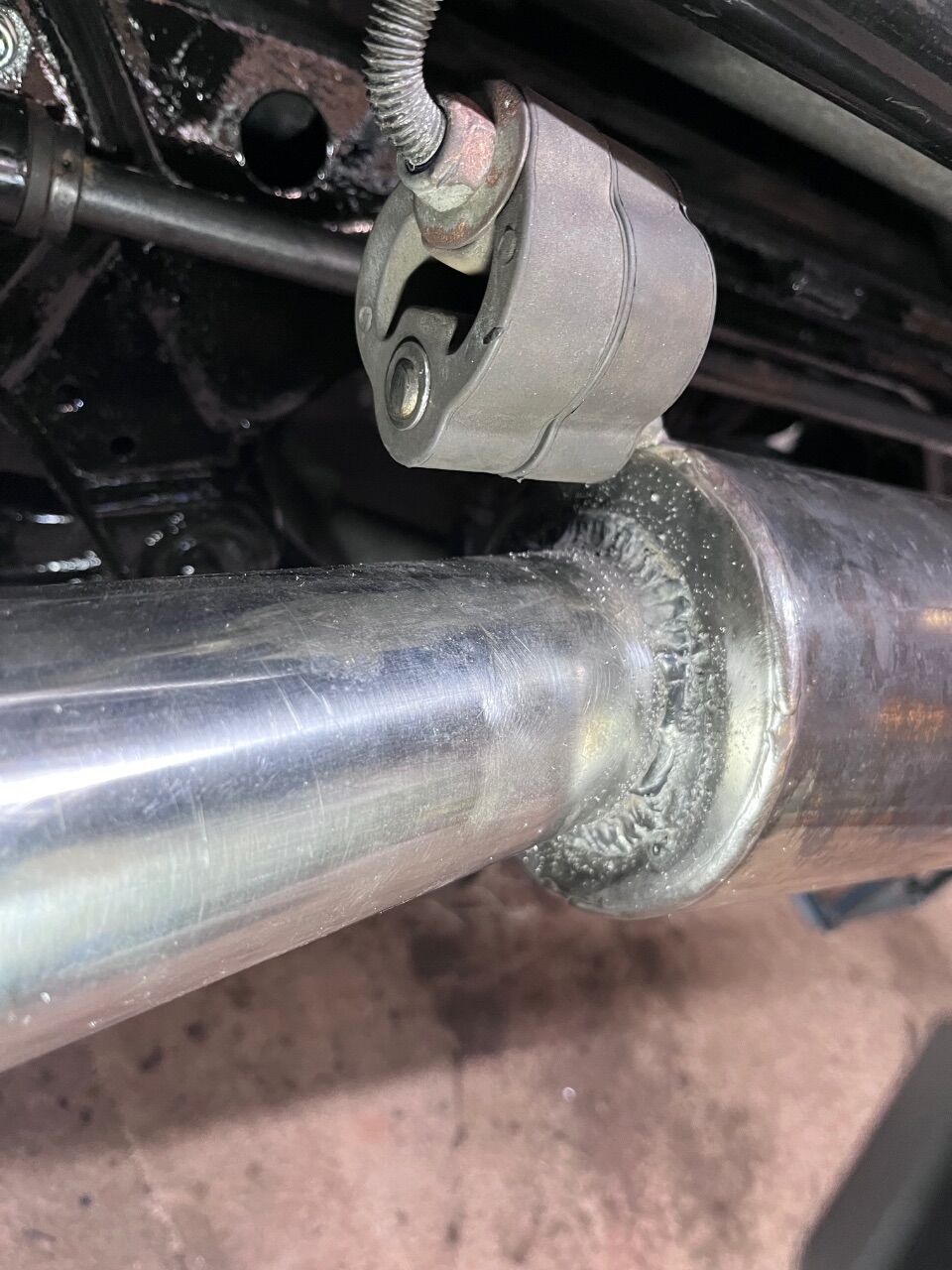

the exhaust needed a bit of fettling too
 suprisingly good for gasless mig on stainless
and back on the car - no more leaks

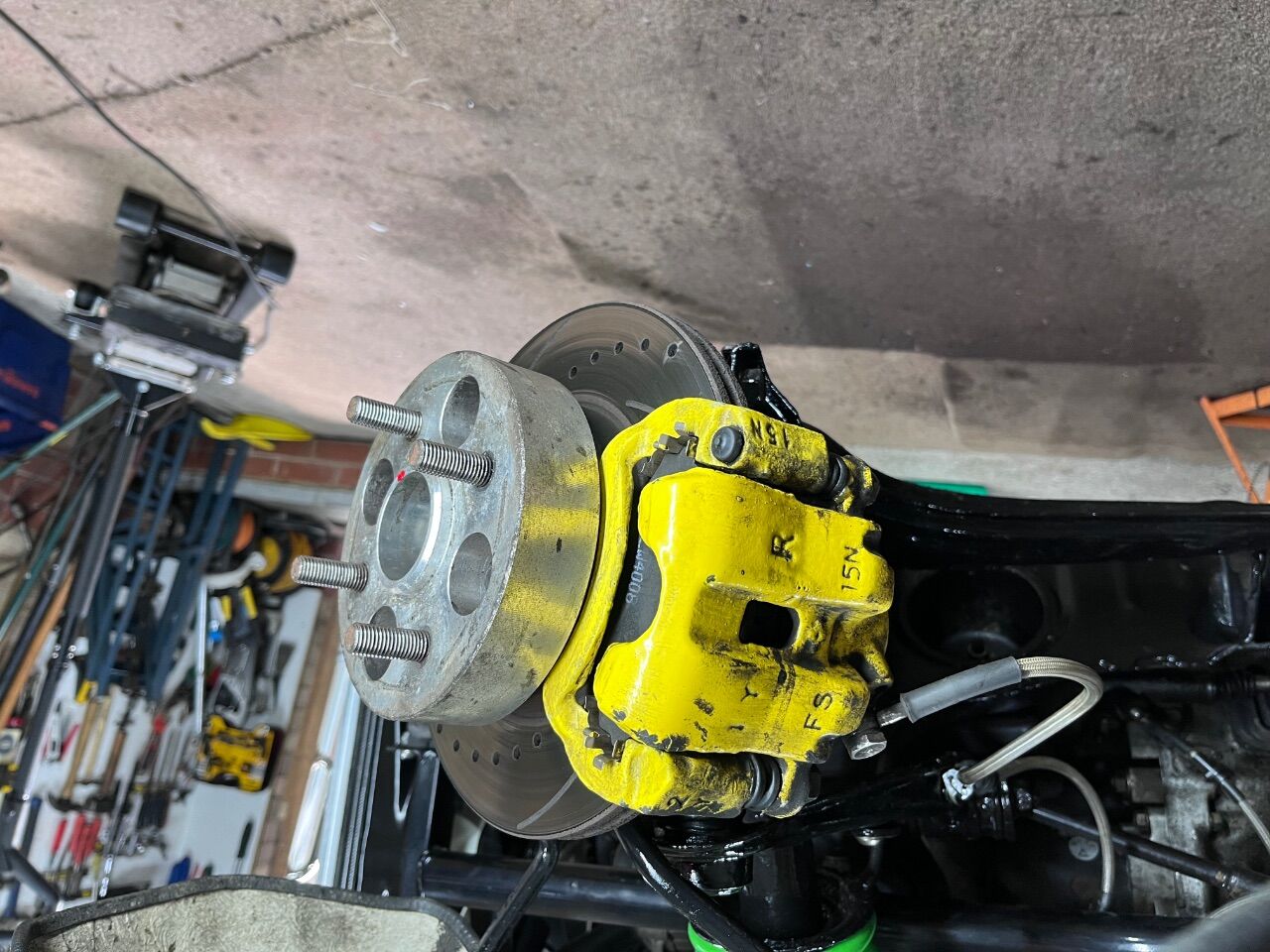

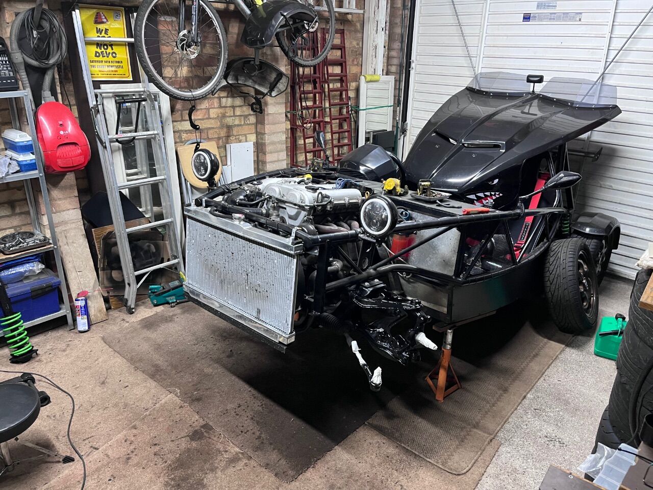

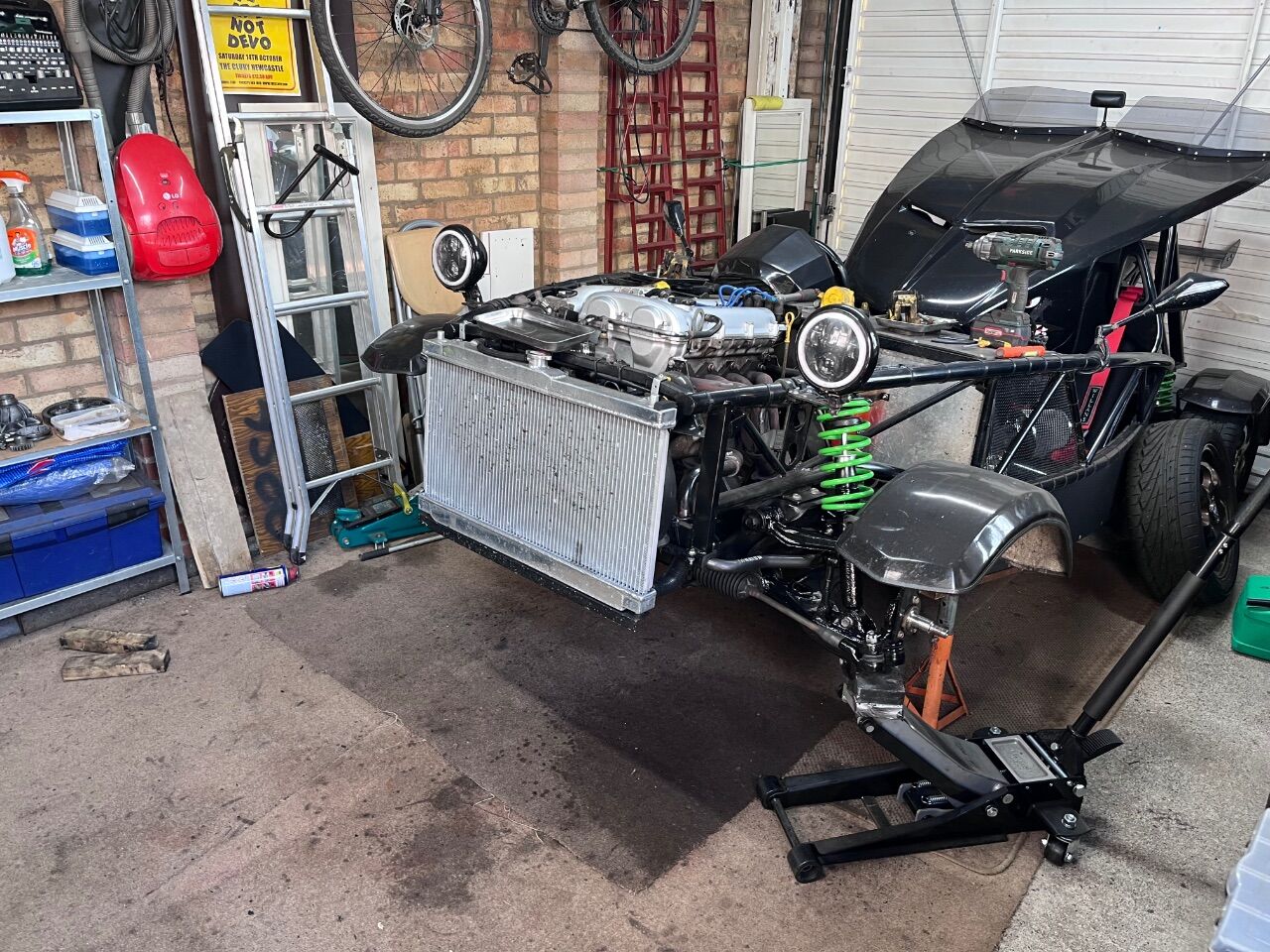

time for the same on the front end
should i paint the calipers to match ?
yellow might not have been the best choice but i’m running out of time so a wipe over with a rag will do for now

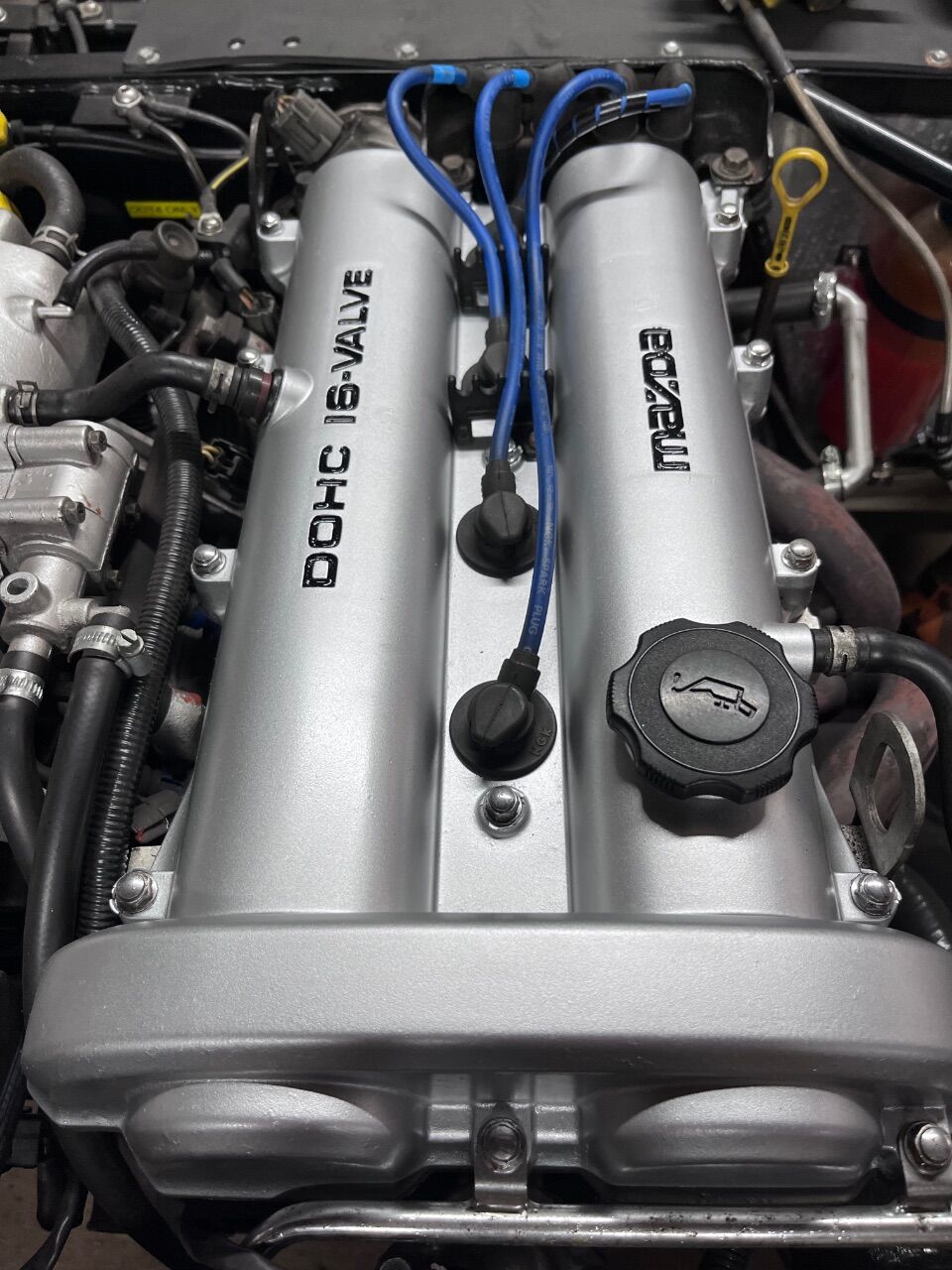

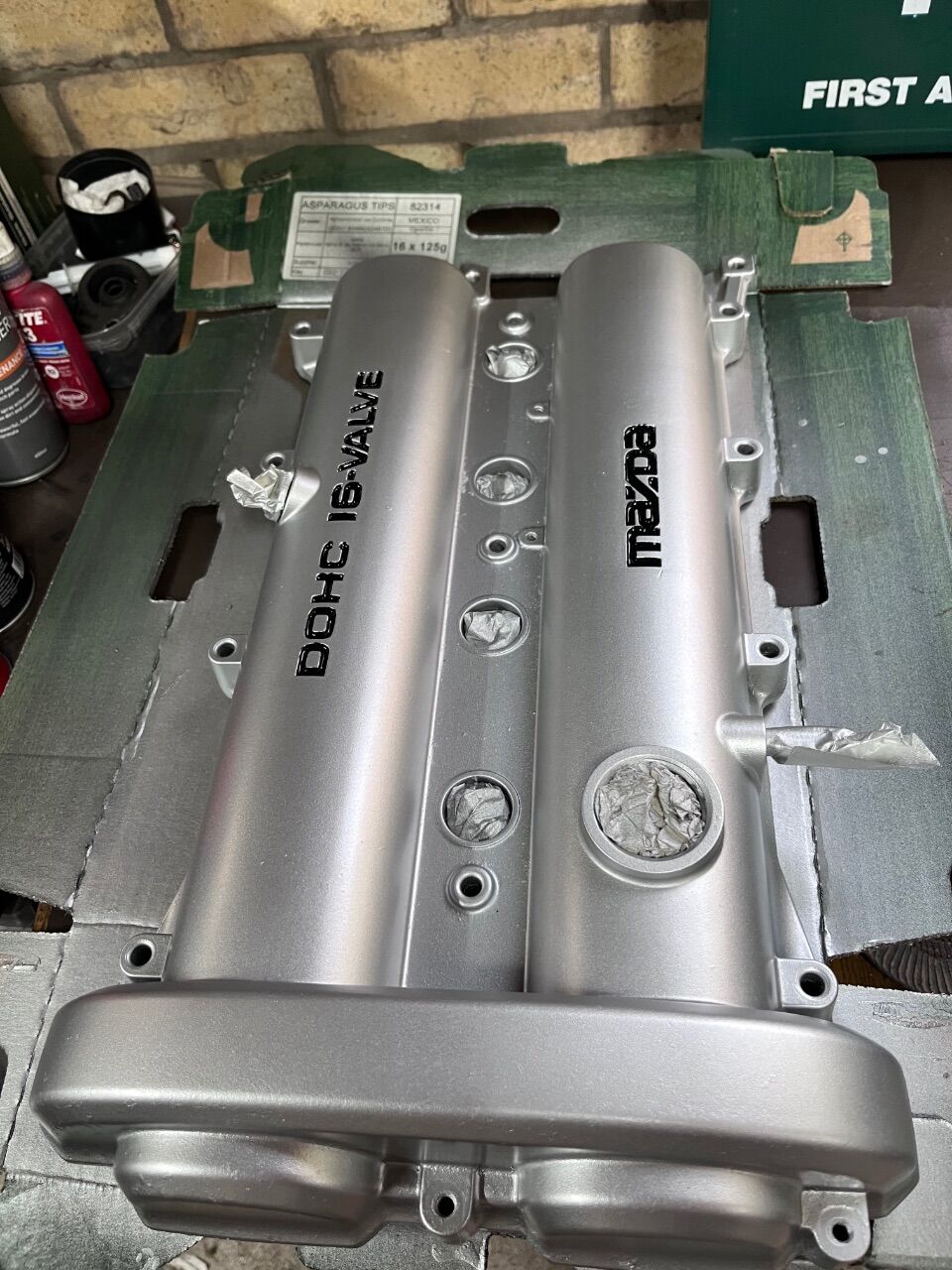

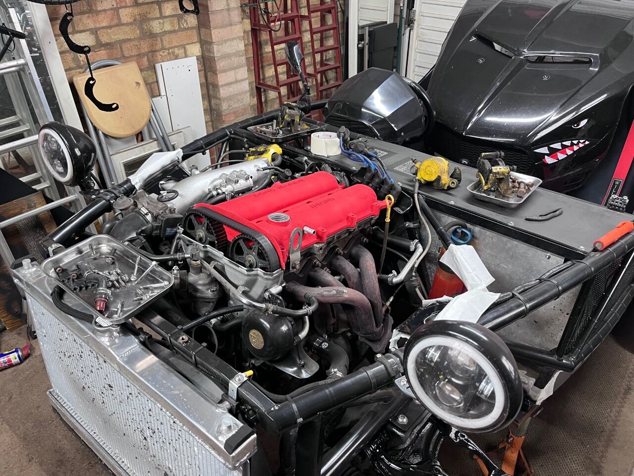

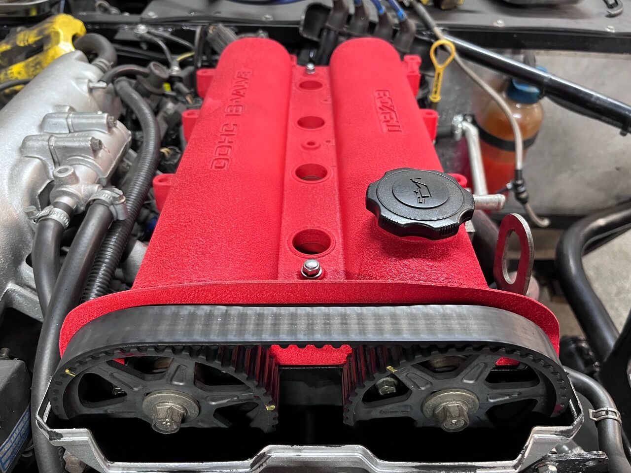

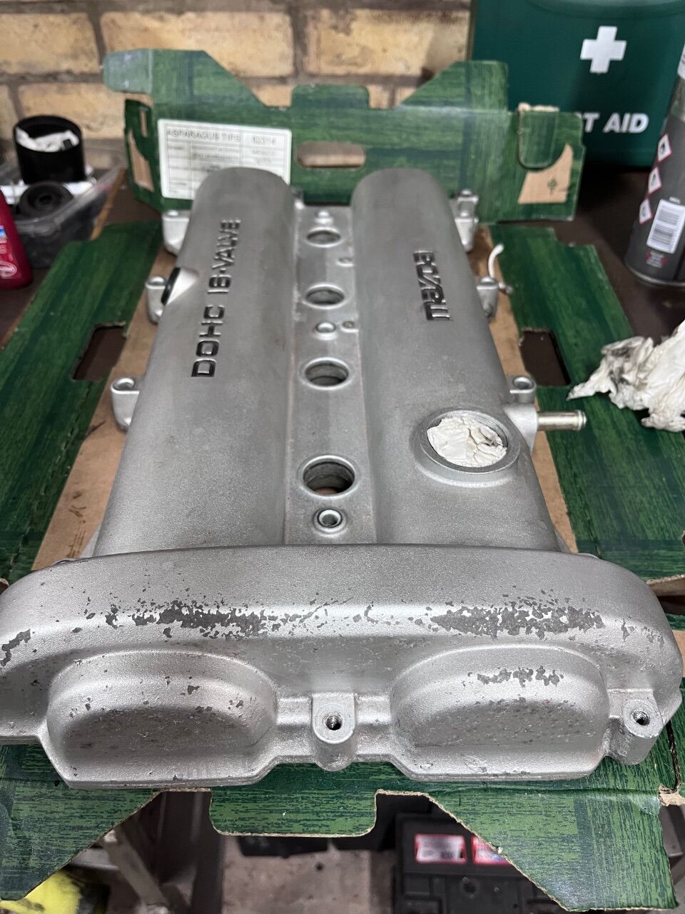

while it was up in the air, i noticed the cam cover looked a bit shabby
fortunately i had a spare
looks pretty smart but those open cam gears are just asking for trouble
so a couple of coats of wheel silver were applied and a very delicate bit of filling in on the lettering
much better

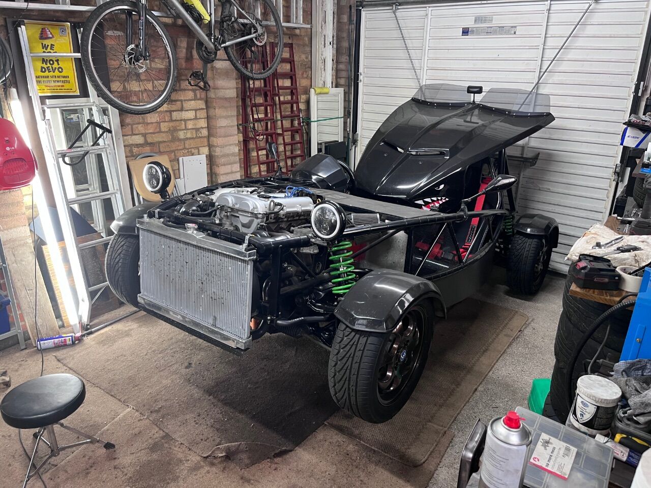

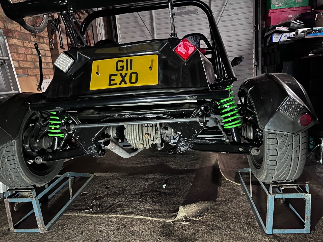

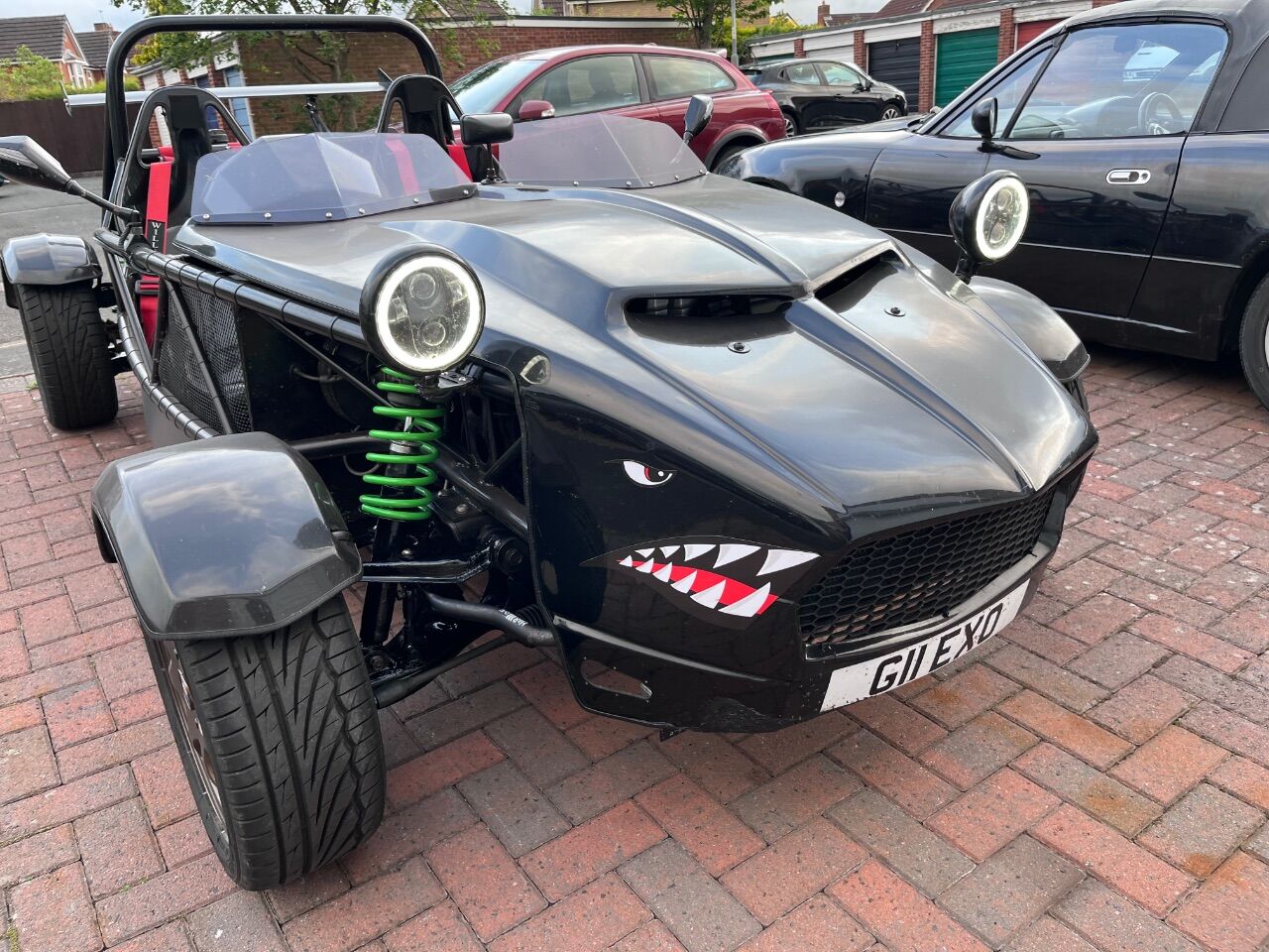

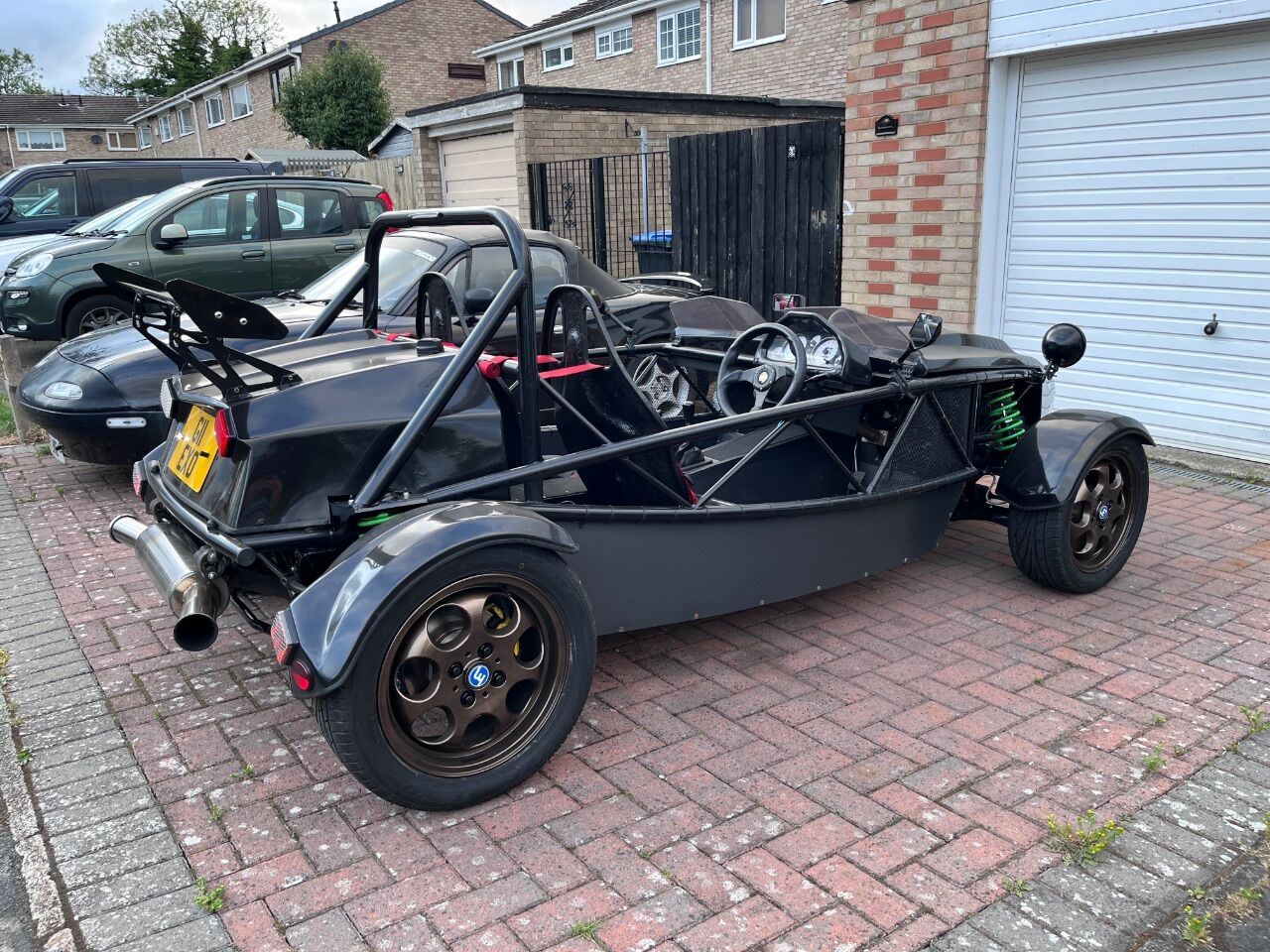

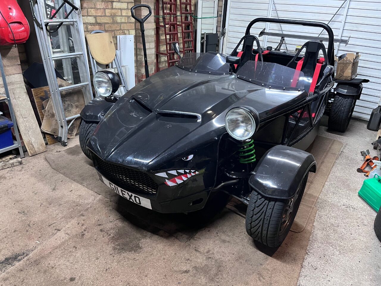

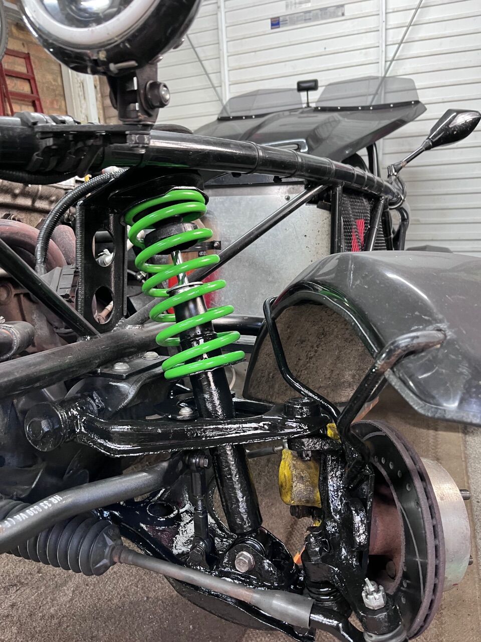

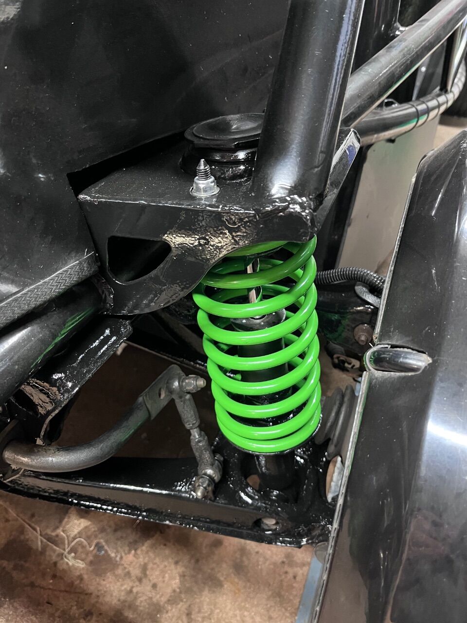

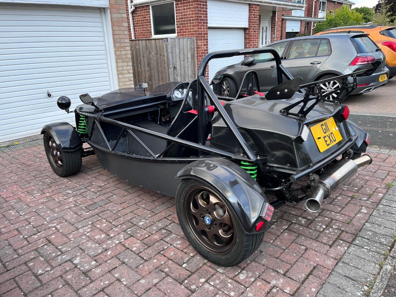

so, new suspension on, how does it look ?
scabby yellow shocks
shiney green shocks
i've gained about 40mm ride height ! doesn’t sound like much but it’s noticeable
and out for a test drive
it’s smooth as you like on decent roads but bouncier than mr bounce on a trampoline when the going gets tough :(
it drove brilliantly on the previous set up so maybe i’ll need to get them refurbed now ?
shame, as it looks great now with the green ones on
Looking good though sounds like the hulk springs need swapping over.
Was thinking in the pics they look more tightly wound then when i looked again they look like they're not quite sitting in the cups properly. Maybe that was pre seating?
it’s an odd design, the mk1 set have a flat perch whereas the mk2 set is stepped for the spring to seat properly.
i’ll strip the yellow mk2 set and get the springs blasted and coated then swap back. it’s not undriveable, just not as good - i probably won’t book any track time yet

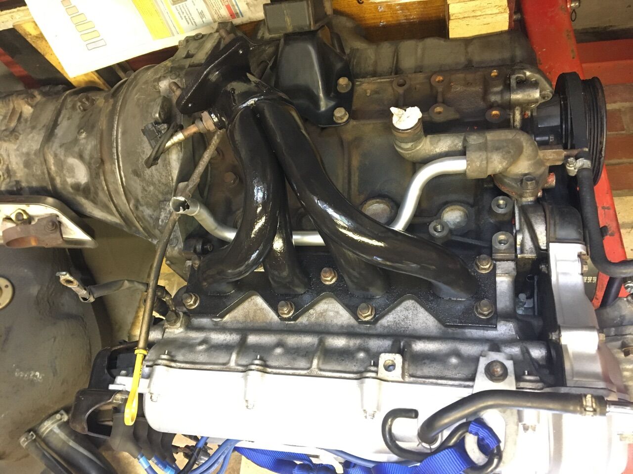

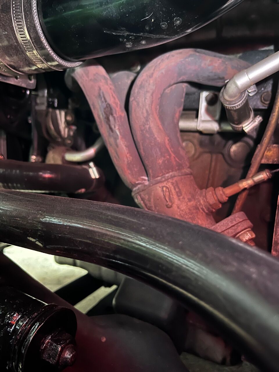

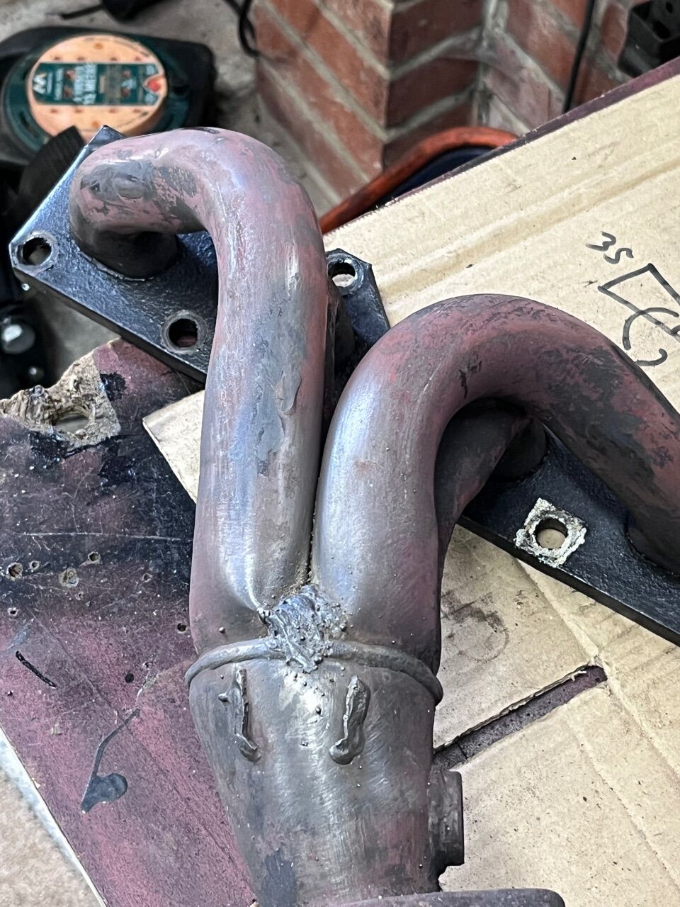

someone was asking on the exo group about exhaust manifolds and whether or not a heat shield was needed
i posted a pic of mine showing there wasn’t really much space for a heat shield but as there’s plenty of fresh air, it’s probably not needed anyway
shiney bright heat resistant paint lasted well :(

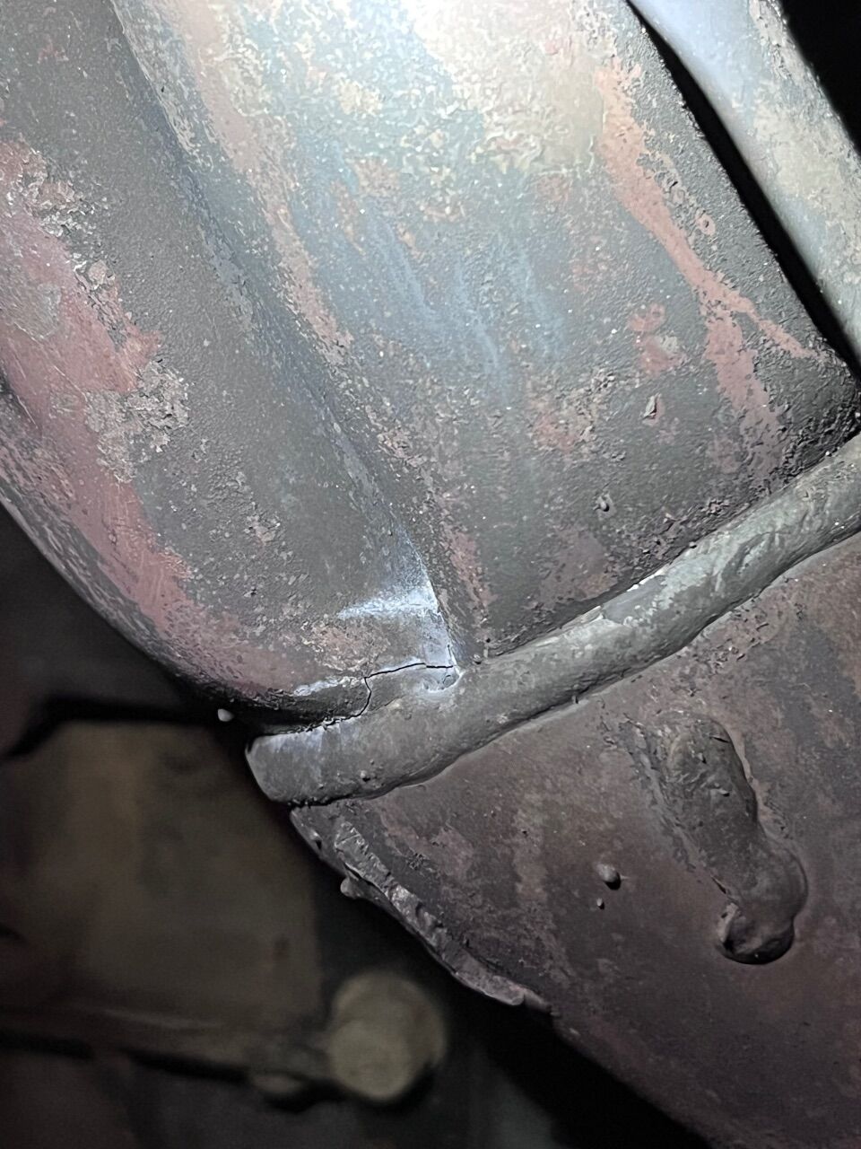

also, what’s that ?
bugger - i’ll whip it out to investigate
lucky i’m an ace* welder

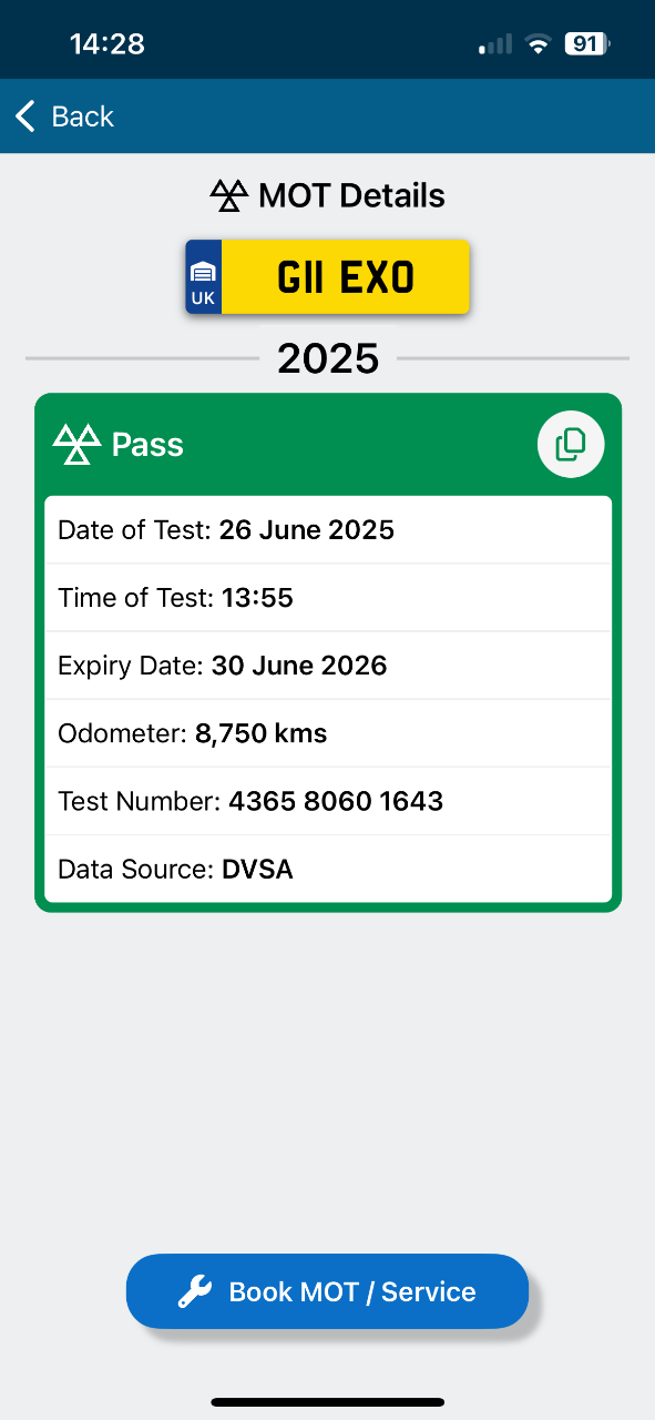

i refitted the catalyst while i was at it, its first MOT is due at the end of the month
mot due at the end of the month ?

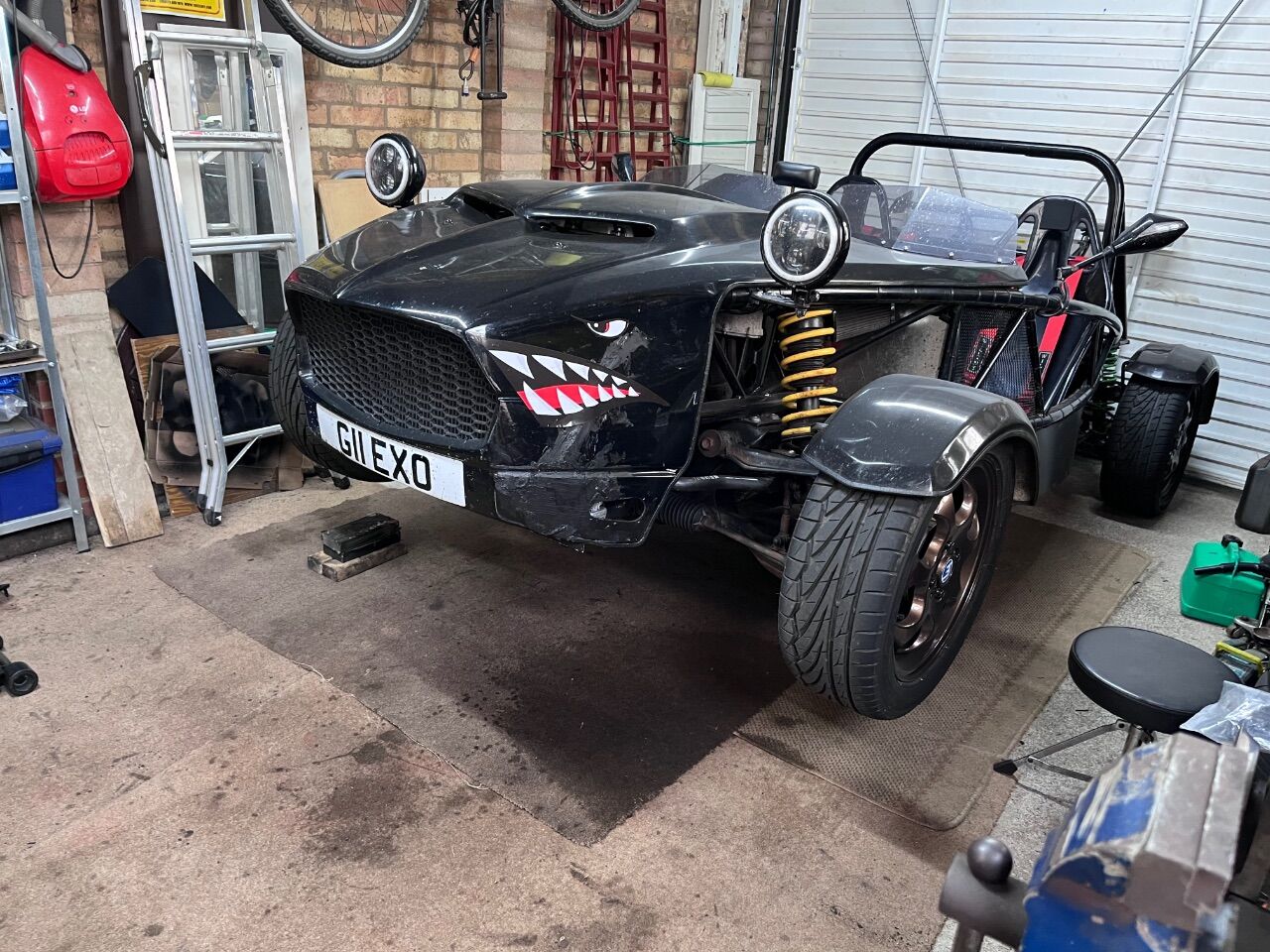

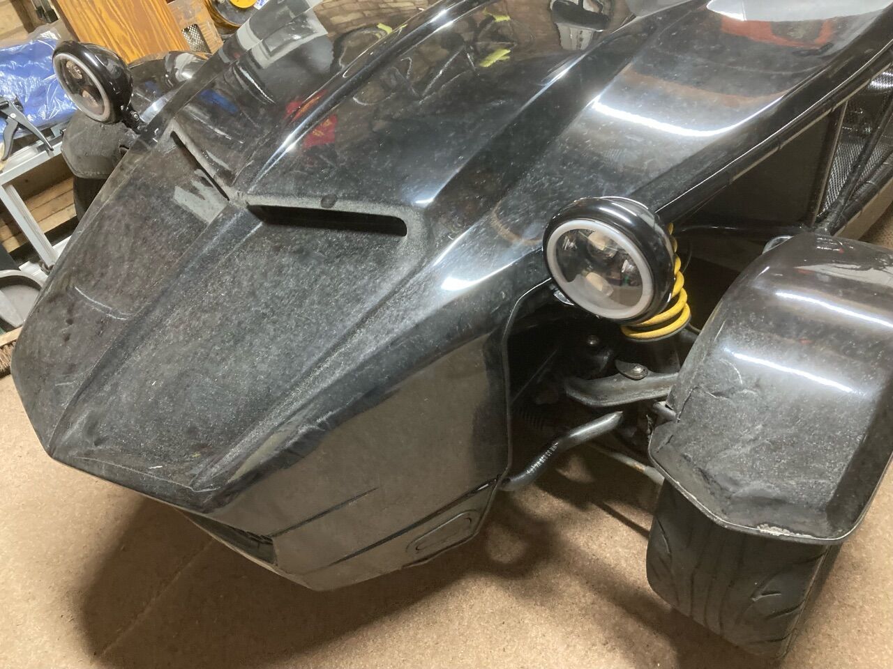

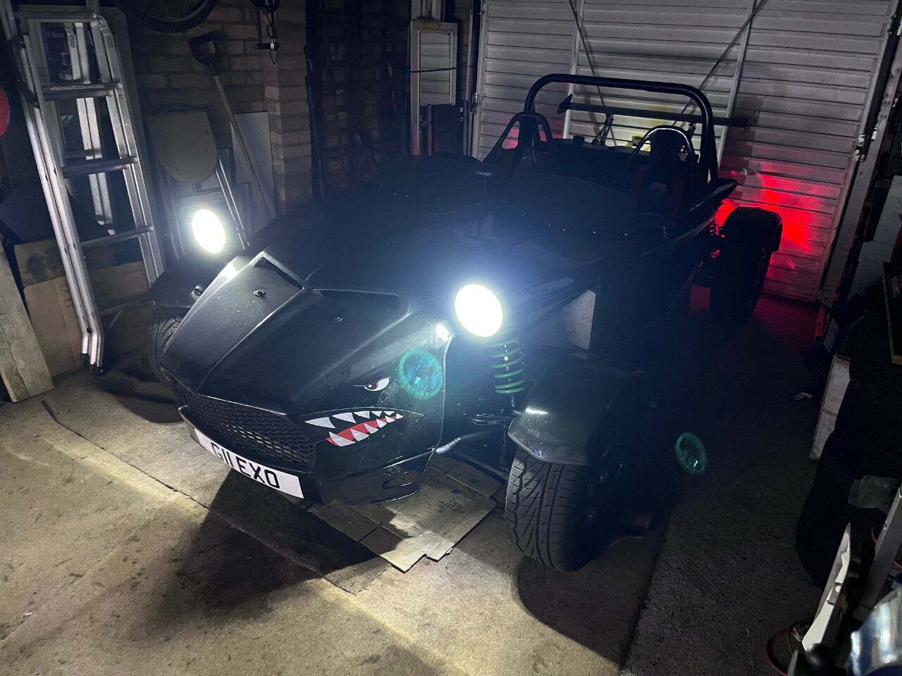

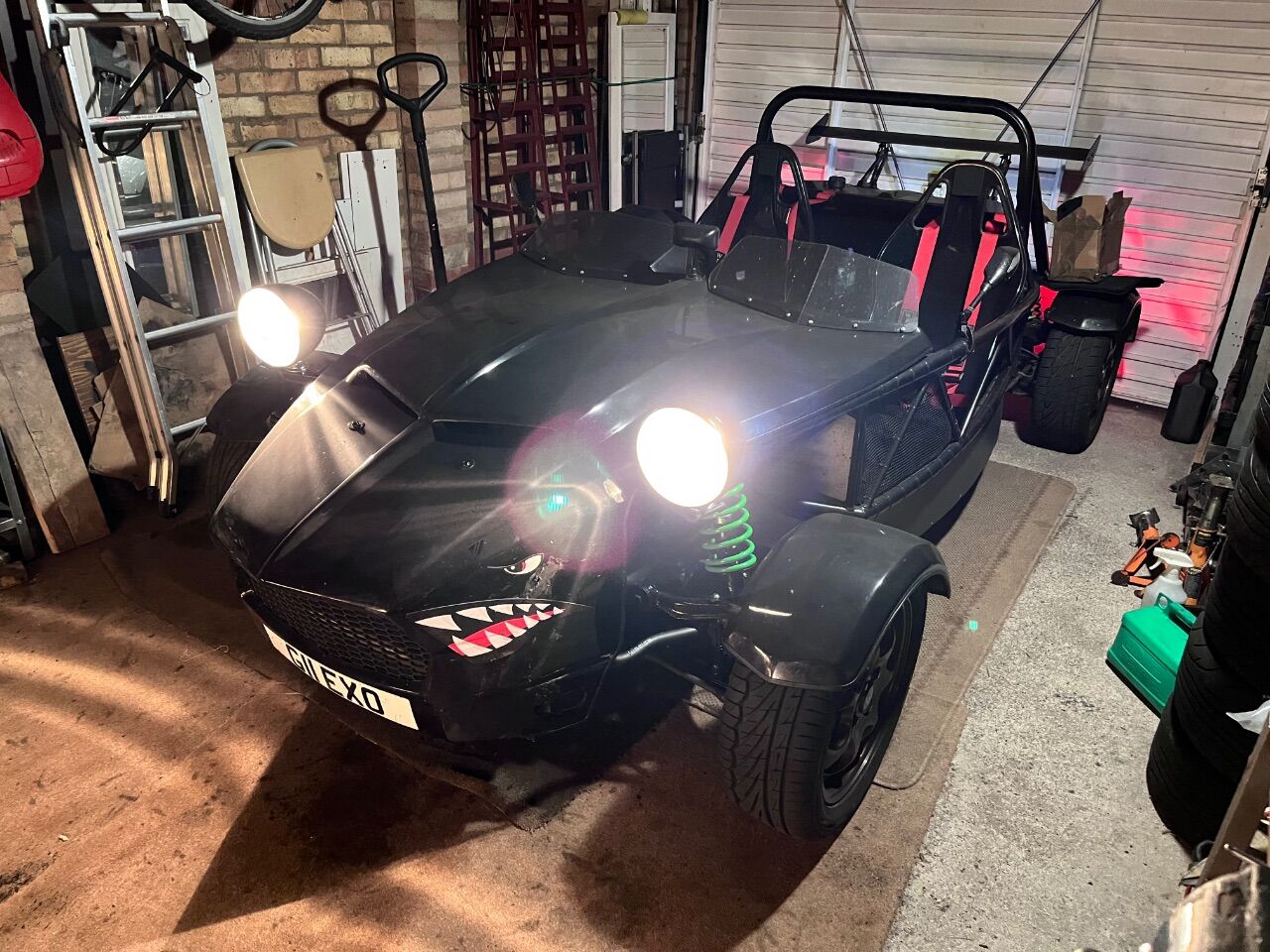

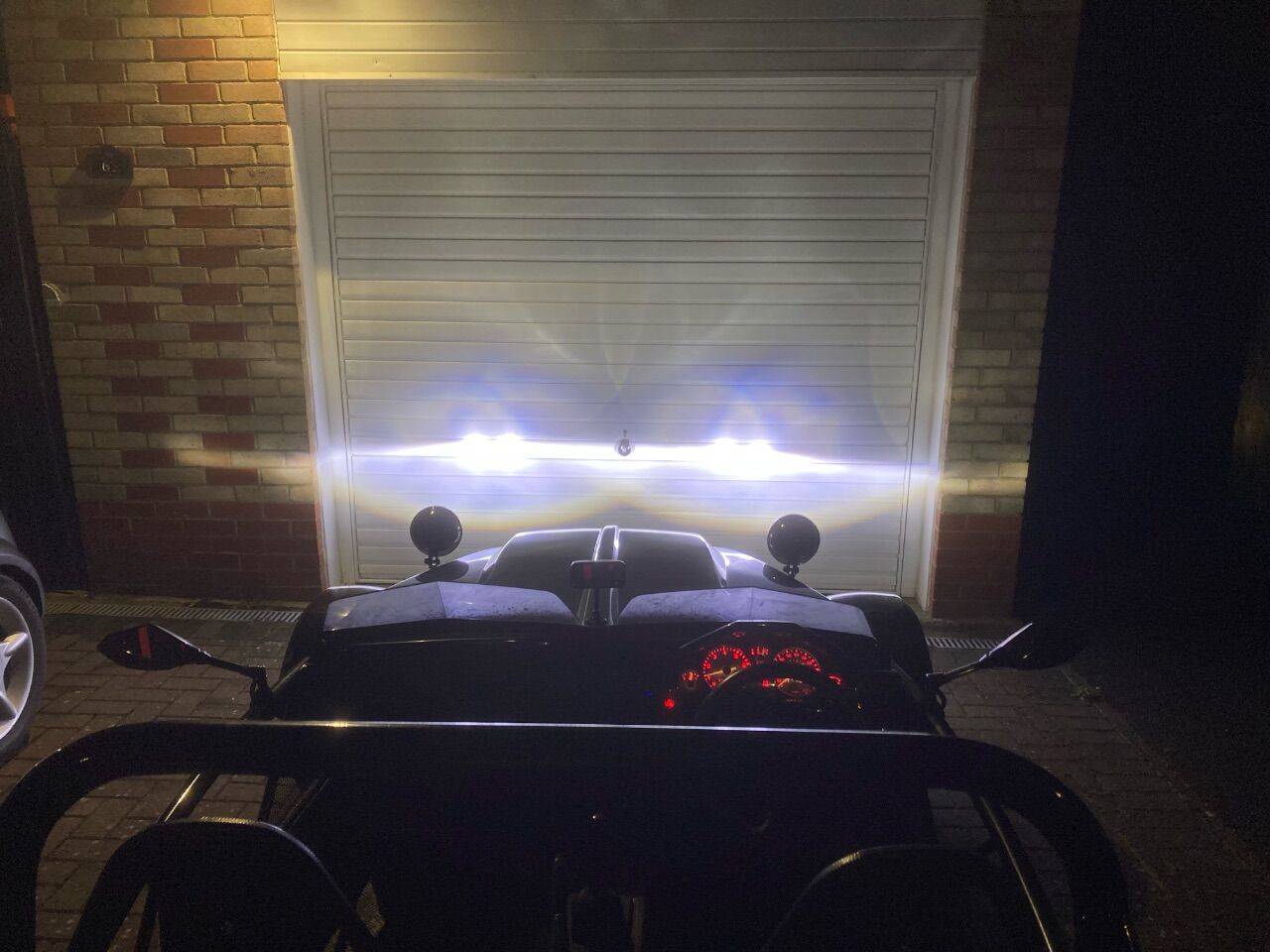

time to ditch those funky led headlights then
so these ugly bastards are back
good beam pattern on them

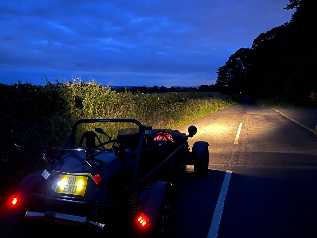

obviously i had to go for a test drive, they’re a decent light once i’d got them lined up a bit

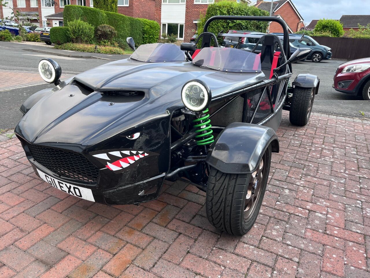

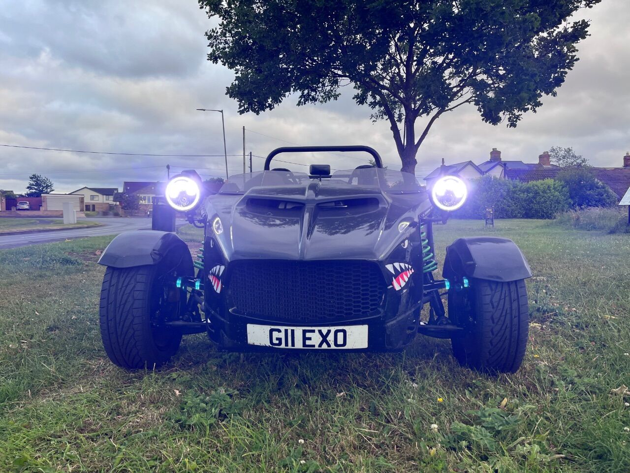

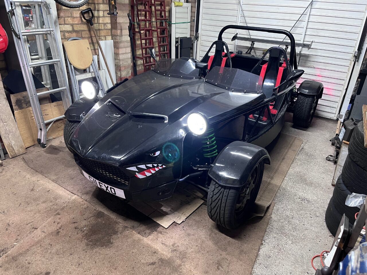

the giant headlights had been out on loan to another exo builder while he got his iva test passed.

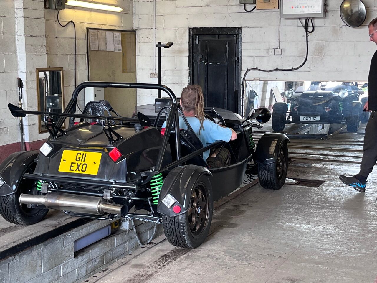

sorted !
had a bit of trouble with emissions, looks like the catalyst is on the way out :(
but a clean pass is what i was looking for - there will be celebrations tonight :)
not the best weather for a trip to the mot station but i arrived only “mildly moist”

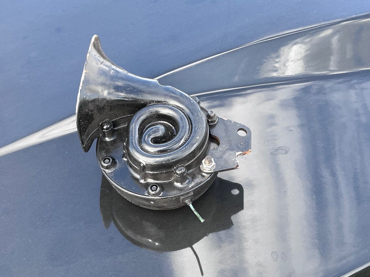

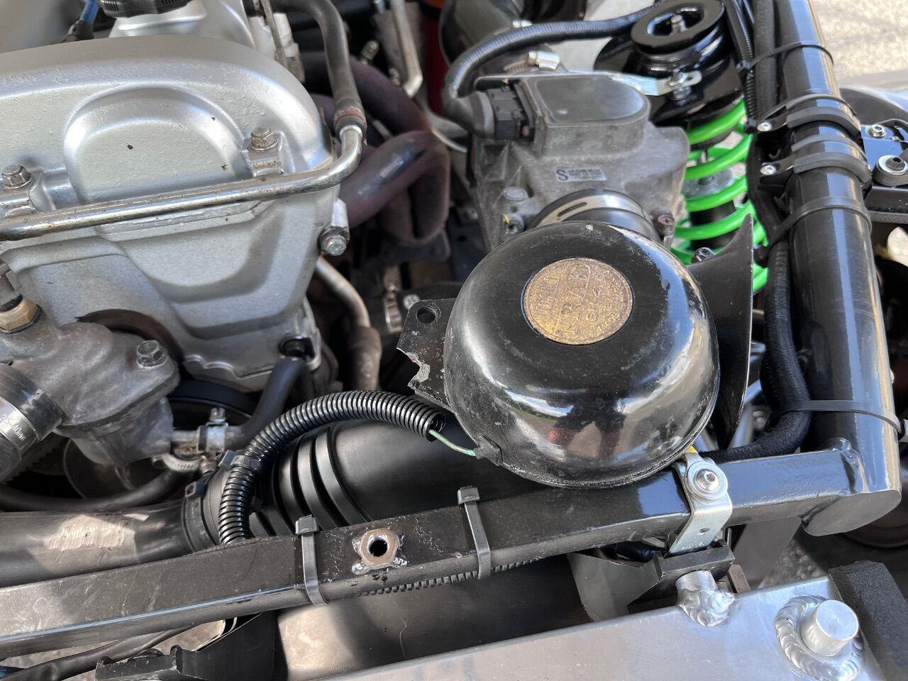

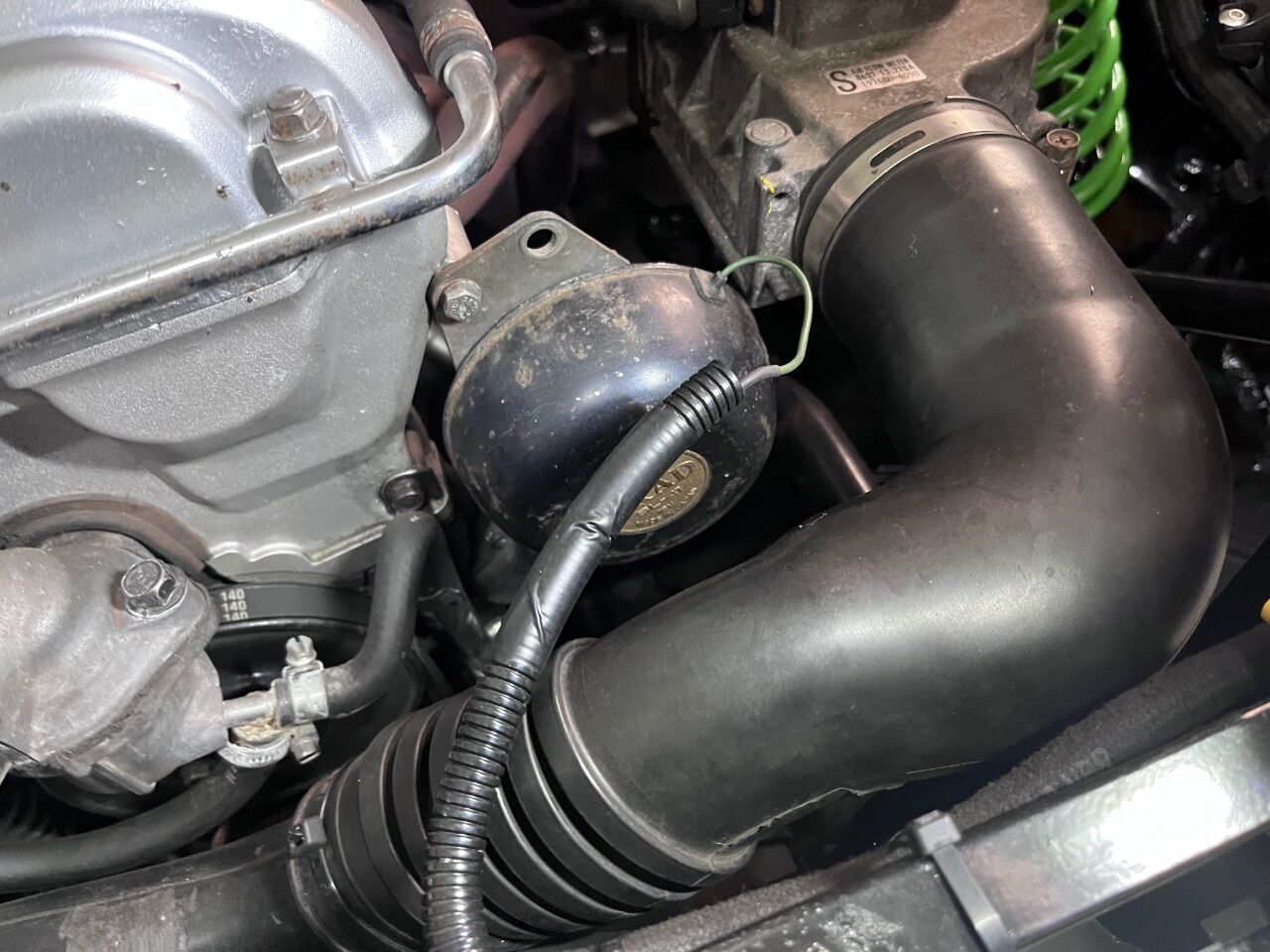

about half a mile from the ‘barn, i noticed an unusual rattling noise that quickly got a lot louder :(
pulling over, i had a look under the nose and immediately spotted the cause - the horn had vibrated itself loose and was rubbing against the water pump pulley
turns out the bracket had completely sheared through
not ideal, but an easy fix
back home, i dusted off the unused half of the twintone set and fitted it in place of its fallen comrade
will do for now, while i find something more suitable and mount in a less vibraty position

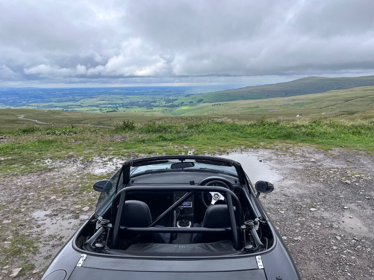

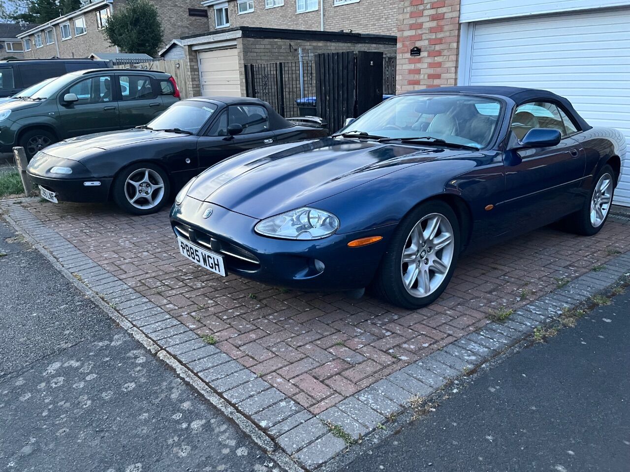

the little mx5 hasn’t been getting much attention since the jaag arrived
so i filled the tank and took it for a run out
Hartside Pass
seeing as Penrith is near Carlisle, and that is nearly Scotland, i pressed on up the A7 (what a road, barely a car in sight, lots of fun)  and found myself in Kelso.
so loaded up with supplies and headed for home
used a full tank of fuel just nipping to the shops !
and what a great little car that mx5 is, just loves being hooned round the twisties :)

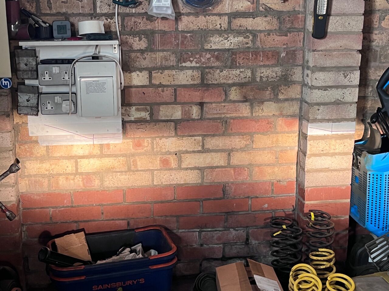

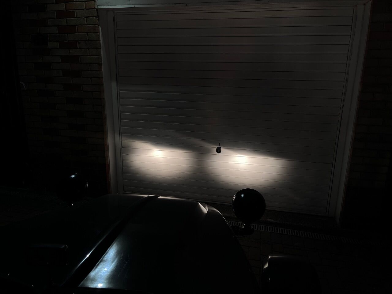

in the meantime, I marked up the headlight alignment on the garage wall
and stuck the jazzy leds back on
