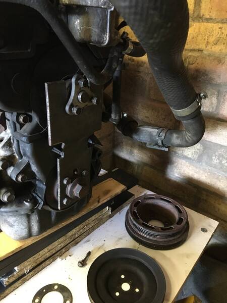

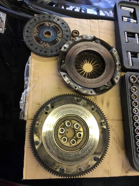

so I broke out the tools and pinged (pung ?) the clutch off
which would have been a bugger had I not thought of using @junkyarddog 's crank locking tool - handy piece of kit, that.

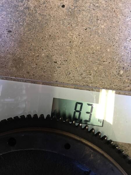

the clutch, it would seem, is bollocksed
pressure plate and flywheel have had a hard time too
hmm, should I fit a lightened flywheel, I wonder
yes, I probably should !

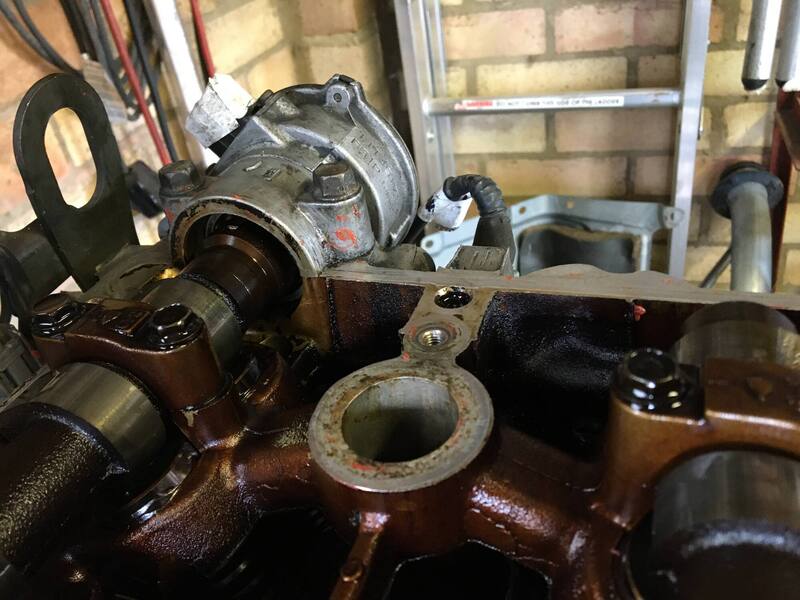

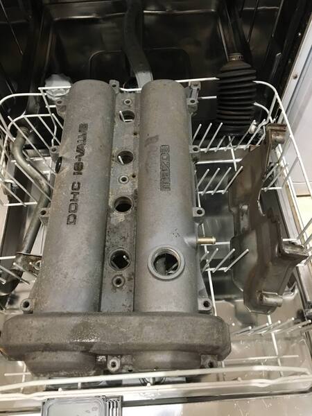

but now it's time to have a go on the cam cover.
I've been aware of the presence of a dishwashing machine in the kitchen for a while now, I'm quite content washing up by hand so have never investigated if it actually works.
Let's find out then !
Intensive :) that's the one for me
and we shall see what happens in a while - it's been making sloshing noises for a good hour now, hopefully there will be shiney parts a plenty when it's done it's thing.

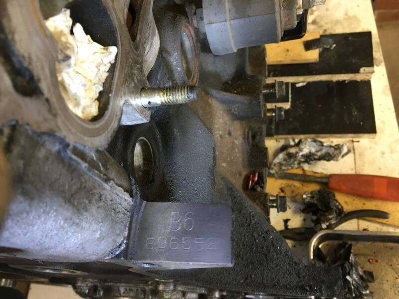

almost forgot, I found the engine number under all that grime
the kitchen isn’t smelling too good just now :( might not do this again
hmm, a bit better but I think I’ll stick it in for another cycle
Yes definitely do a lightened flywheel. It's on my massive list.

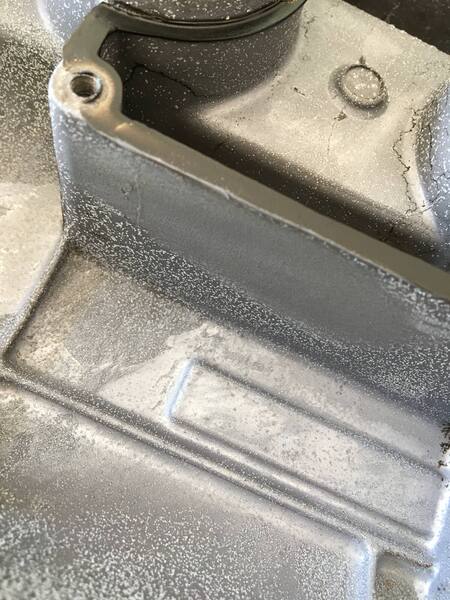

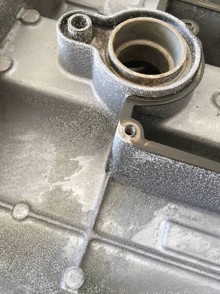

so what did I find when I opened the door this morning ?

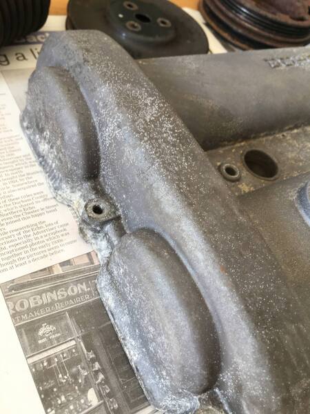

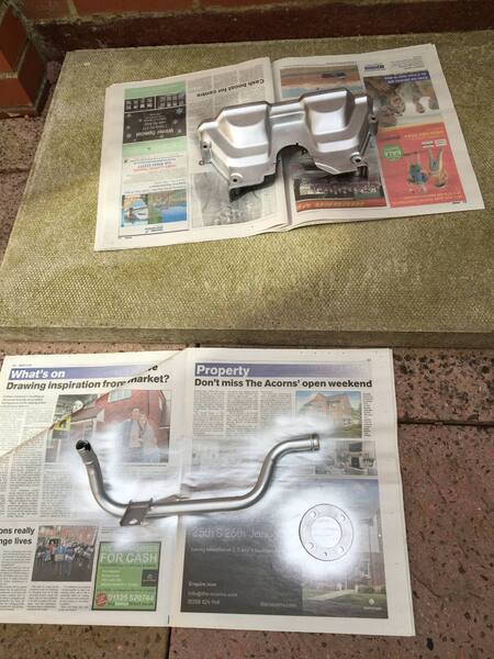

well, yes, it IS cleaner but what's all this powdery shit everywhere ?
I blame the Powerball (pinched the posh tablets off me mam)
thankfully, it just rubs off
but is going to be a pain cleaning all of the baffled bits inside :(

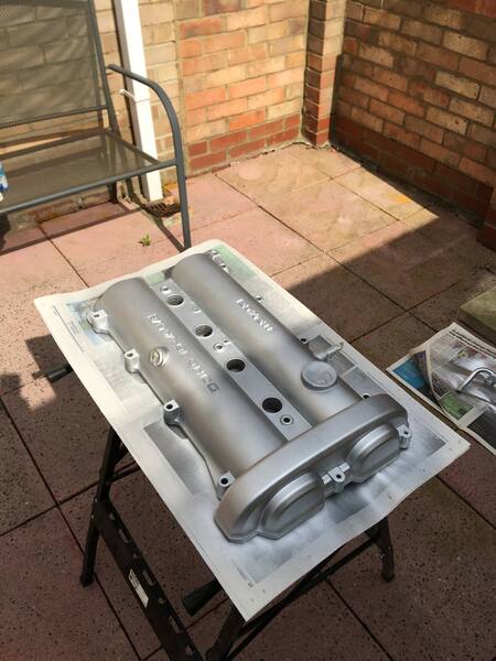

I took it outside and gave it a good hosing (!) but the residue was persistent. time to break out the big guns - a good rub down with thinners had it all smooth again, but still not very presentable.

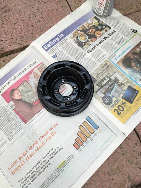

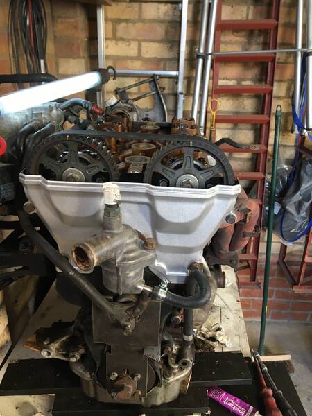

on the shelf next to the paint thinners, I happened across a half full can of wheel silver
that'll do the trick
not sure that stone chip was the best choice to do the crank pulley though ? looks like melted liquorice :)

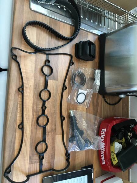

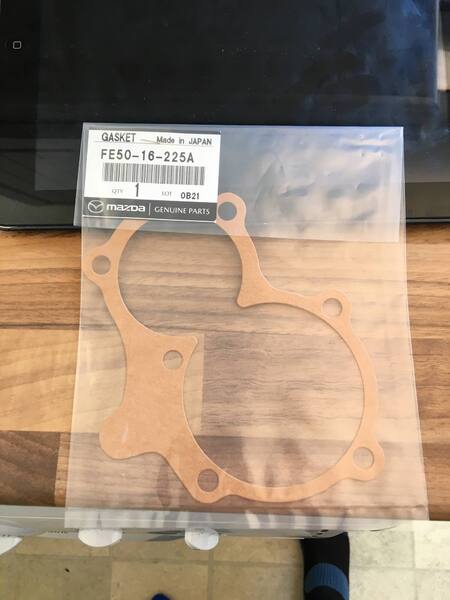

meanwhile, the postie had been
gaskets ahoy
plus the one that was missing from yesterdays parcel - that's bloody good service from Andrew at Autolink

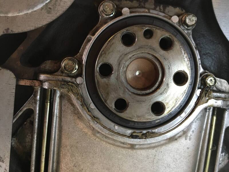

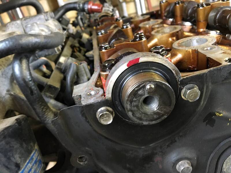

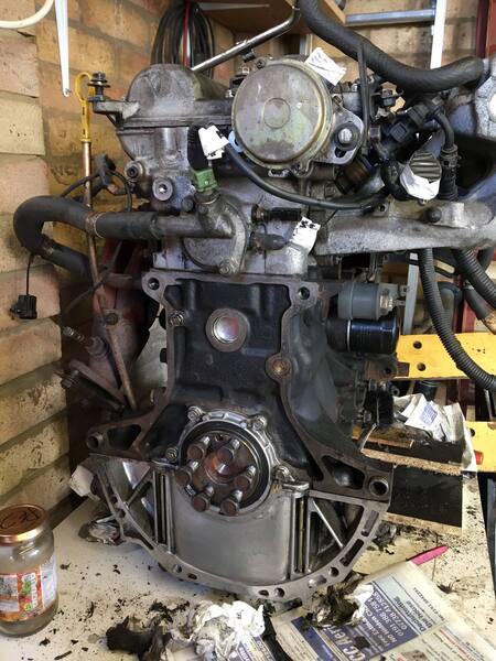

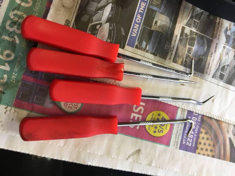

so todays task was to get stuck into replacing various engine seals
camshafts
cam angle sensor (was so old, it fell apart when I removed it)
crankshaft front and back
a new timing belt went on, I wire brushed the manky thermostat housing, popped in a new 'stat and fitted the timing covers
the cam cover is still drying so will go back on tomorrow.
but this weeks Top Tool Tip would be to get yourselves down to Wilkos and pick up a set of these little chaps - made pulling those seals so easy - and they only cost £2 for the set :)

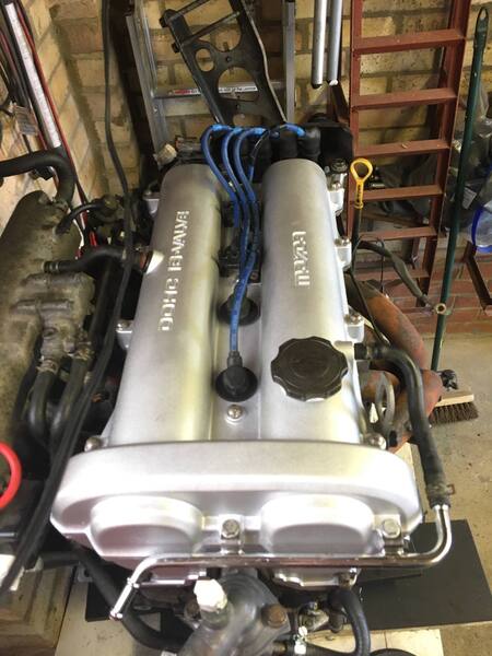

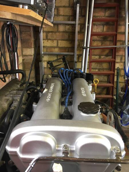

It is rather satisfying to be actually putting something back together after so many hours of taking it apart
the intake manifold rather lets the side down now :(
but overall an improvement.
In the first pic, notice how the shelf above the engine is sagging under the weight of my stereo, fixed in pic 3 by cunning use of a curtain pole :)
