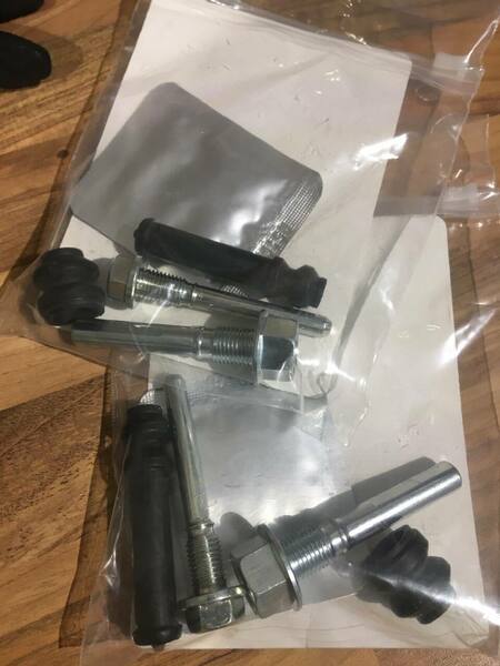

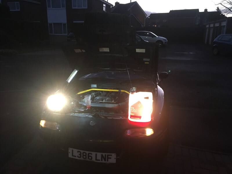

today's plan was to drive through to Durham, have a nice run along the riverside then come back and get these shiny new slider pins fitted to the exo's front brakes
so I jumped in the mazda, pausing briefly to top up the coolant (again) and set off towards Durham.

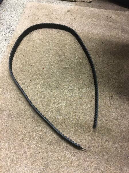

half a mile down the road, I ground to a halt :(
symptoms were alarmingly similar to last year when the timing belt snapped - but surely it can't be ? a new belt should last more than a year ?
I rolled the mx5 up onto the kerb and jogged home to enlist the assistance of my neighbour, the civic and a towrope

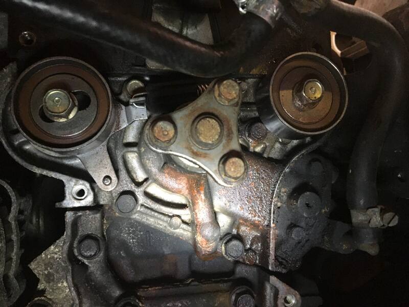

sure enough once we'd dragged the mx5 home :
one year and two days since the previous time it broke !
at least I know where my mysterious coolant leak is now :)
I didn't change the water pump last time as I was living in rented flat and had to do my spannering in the street - now I have the luxury of a nice warm, dry, heated garage to do my spannering in :) except I can't get the mx5 in there 'cos there's a bloody half built kit car in the way :(
hey ho. parts are on order and I'll have it running again in a couple of days. still not sure why it would have snapped though, the idlers are both free spinning - maybe I over tensioned it ?

That has to be a faulty belt, unless the leaking antifreeze caused swift deteriation or you have a binding part in its drive train..................... or covered around 50,000 miles in a year.  Good job it's not an interferance set up.
I've only done a couple of thousand miles in a year ( and a few trackdays :) ) not the end of the world, as you say - it's non interference - so easy enough to fix
I've emailed mx5parts, not to complain, just to let them know incase it is a dud belt and they've had others fail
Jesus, that's not good! Imagine how you'd feel if that was a year old belt on an interference engine...
When I took the belt off the 940, and also the V70 for that matter both were circa 10 years old and looked fine, they felt as though I could hang my own weight on them without them giving way. Usually it's the tensioner or pump that go West anecdotally?
Can we ask what brand the best was so as we can avoid them?
not sure on the brand, I'll need to check but it was the mx5parts budget option - I've ordered a Gates one from autolink this time, hopefully will be a bit better.
the water pump is driven off the alternator belt so shouldn't technically be under suspicion (although this one was leaking so may have contributed), the tensioners appear to be ok - who knows - like you say, glad it is a non interference engine

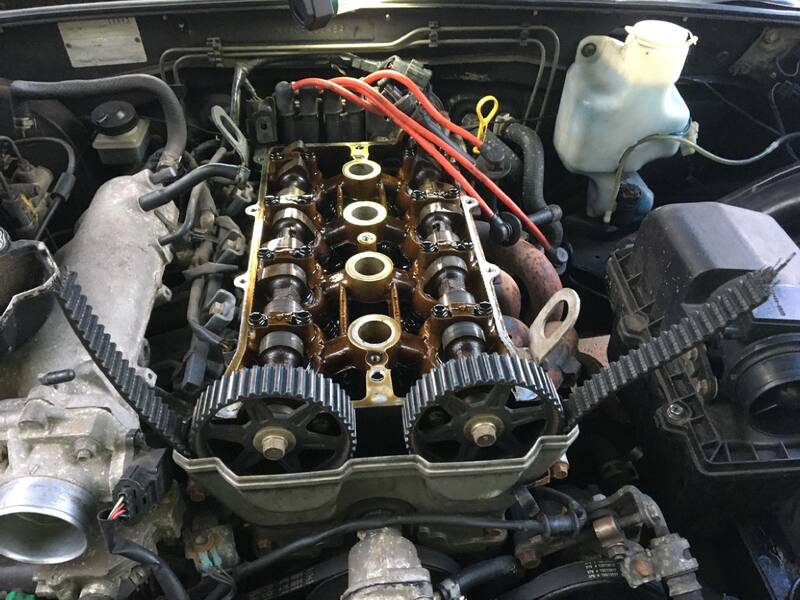

the weather was kind yesterday so I got on fixing the timing belt and water pump
not many pics as I was racing against darkness but got it all finished just as light was fading
intersting* points to note here - use of a 24mm and 25mm spanner clamped by vice grips to hold the cams steady while I fit the belt, use of the dipstick down plug hole #1 to confirm top dead centre
filled up and bled
pretty colours :)
I took it for a good hoon round the back roads and all is well, the heater blowing such hot air that I got the roof down

That is a brilliant idea with the dipstick to find TDC, i will have to use that myself one day !
19 minutes ago, camryv6 said:
So what do you think caused the belt to break ?
I'm still none the wiser - I'm assuming it was a dud belt. I contacted the supplier to see if they had seen any other failures but they hadn't heard of any. They did refund me the cost of the belt which was fair enough - might have been a very different conversation if it was an interference engine :)

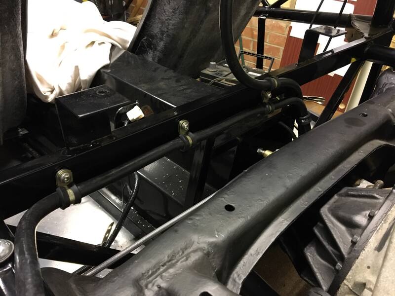

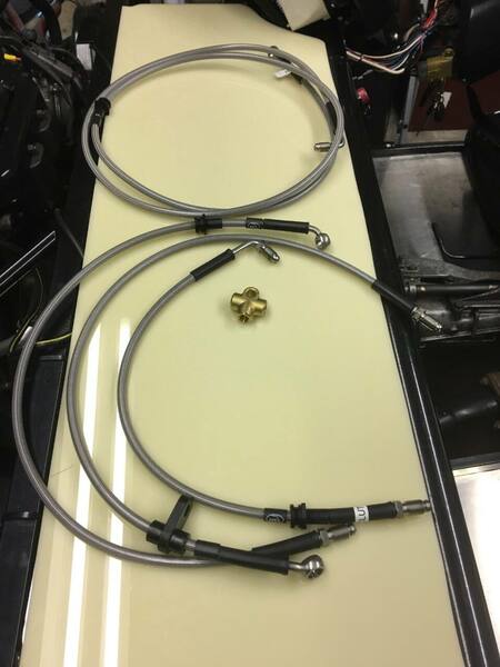

time to get these brake lines fitted :
step 1: remove exhaust manifold :( wtf ?
also had to remove the clutch and brake masters, coil pack, cam angle sensor and cam cover !
would have been so much easier fitting these before joining the chassis to the frame :(
just the rear end to sort and it will be time to bleed them up :)

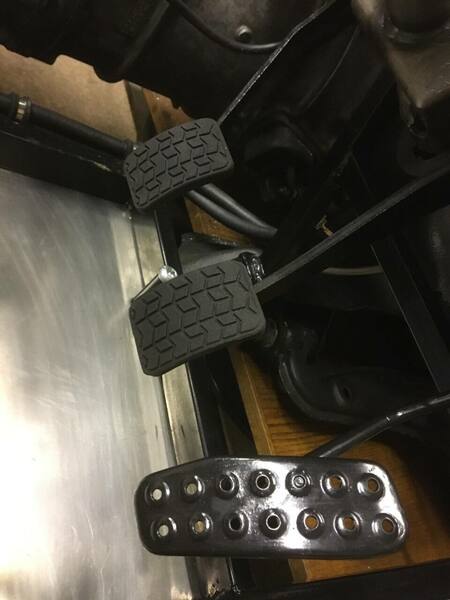

couple of nice easy jobs to end the week

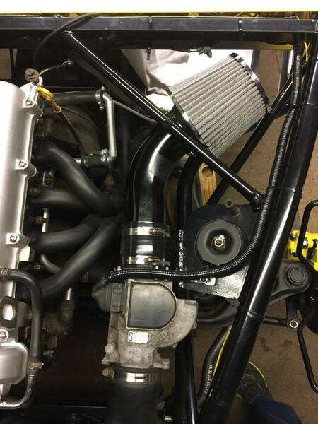

air intake sorted
and new pedal rubbers

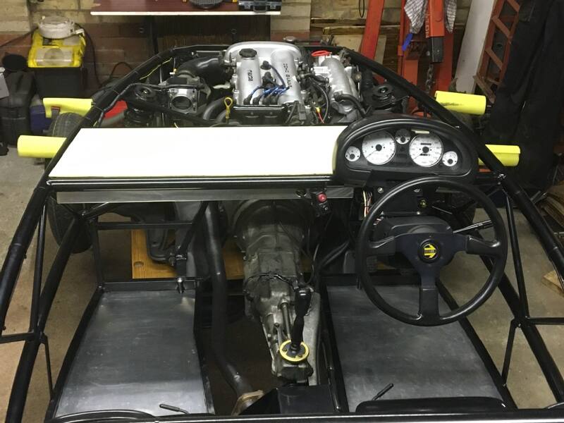

The ‘end’ is miles away but it’s close to making its maiden voyage up and down the street, which is pretty bloody exciting :)
Vidos will be posted, of course

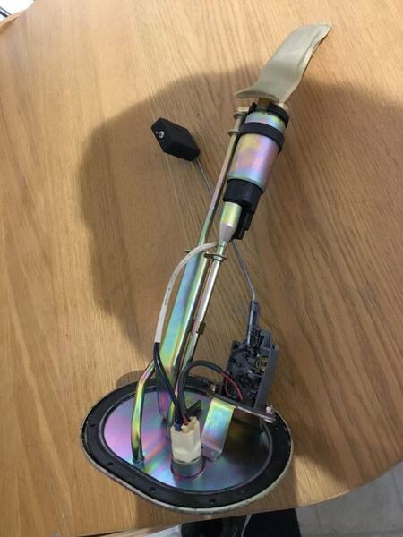

I've been fannying on with the exo's brakes for a while so it hasn't been started for well over a week - I thought i'd give it a go this afternoon - and the sodding thing won't bloody start !
a quick poke around turned up a loose ground wire, I sorted that and...nothing
the plug leads were a bit loose, I tightened them up and still nothing
turning it over with a plug lead disconnected gave me a good old shock, there would appear to be a decent spark so lets have a look at fuel then

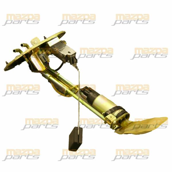

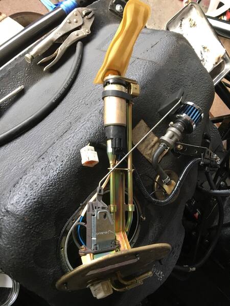

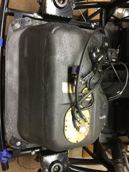

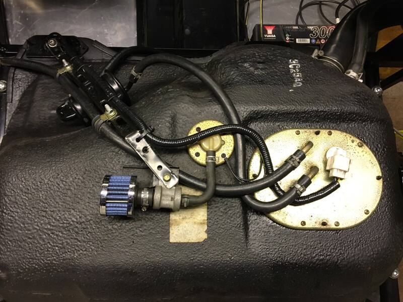

a fair bit of head scratching has led me to suspect the in tank pump -
having a quick look at the non broken mx5, if I bridge the f/p and gnd terminals in the diagnostic connector, the pump can be heard running, doing the same on the exo does not.
the feed to the exo pump is live when cranking and/or the diagnostic is bridged, the ground is good but the pump remains silent
one last test, apply 12v direct to the pump ? nothing - dead as a dead thing.
so tomorrow, I shall nick the pump out of the non naughty mx5 and confirm my suspicions - hopefully a nice easy fix, it's far too dark and cold to be doing that sort of thing tonight.
naughty pump lives here
thirty five quid off ebay
Here's the offending article
i stole the working one out of the good car
and it fired up first turn of the key - go exo !

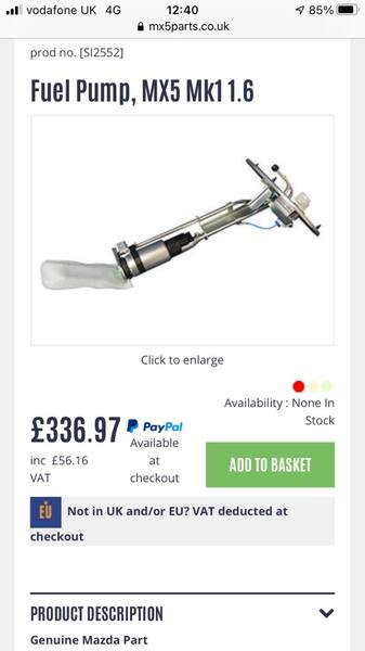

Lets have a wee look and see how much mx5parts are wanting for a new one
aye, mebbes not then :)

I took the slightly cheaper option of a run down to see the mazdadudes and brought home a used one for £25
i’ll probably upgrade later on if / when I go trubo
but for now, I tidied up my fuel hoses
yes, this is them tidied up

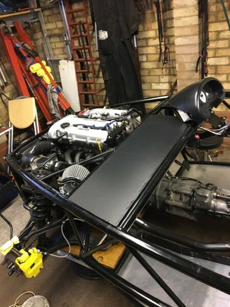

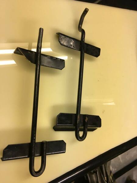

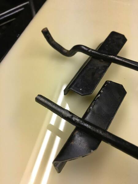

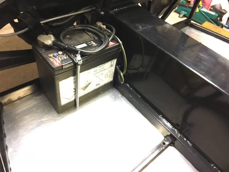

a few daft wee jobs : take one standard battery clamp, straighten the wonky end and cut a thread on it
I've left the cables long as I plan to fit a smoller battery and will probably relocate it

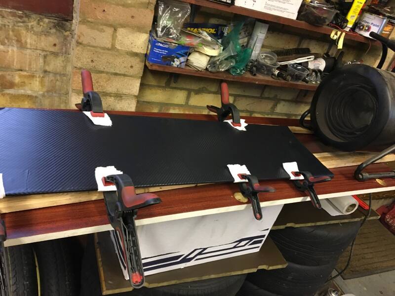

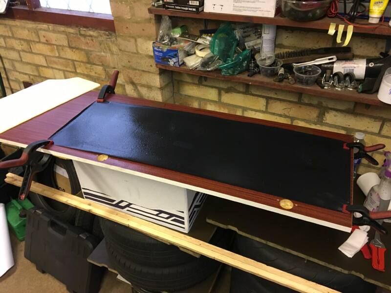

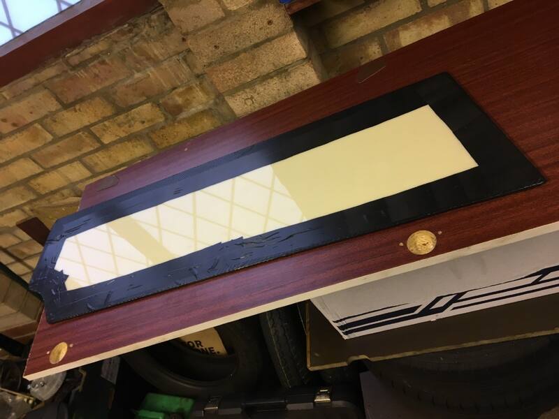

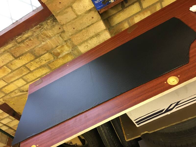

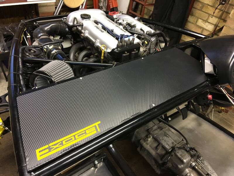

that wiring tray lid needs toning down a bit
I got a cheap roll of vinyl wrap off eBay and got stuck in
not perfect but definitely an improvement
stickerz ?
just the one for now - looks pretty snazzy :)

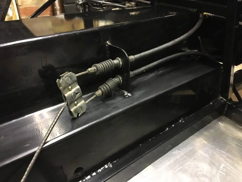

next job - handbrake cables
I gave them a quick clean up and a dab of paint

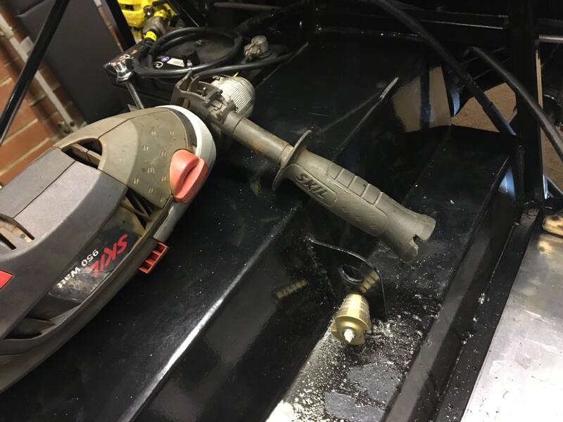

then needed to widen the mounting holes - I don't know what the bracket is made of but it twatted my cone drill :(
finished off with a hand file and got the little sods to fit
the paint on the clips and the handle is still wet, I'll bung them on tomorrow
