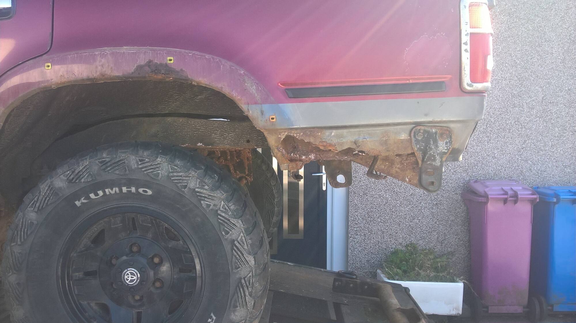

This was after a wee scrape of the old under-seal/paint...  seems that because it's been off the road so long and really dried out, this white stuff has bloomed... presume it's salt?
This was the sill end-piece I made up last time, didn't weld it in myself, which I regretted, but I just ran out of time and gave it to the garage to stick in.  Really enjoyed making it up though, and as you'll see, I'll have plenty more opportunities!  Door was holed, and wobbed up to test.

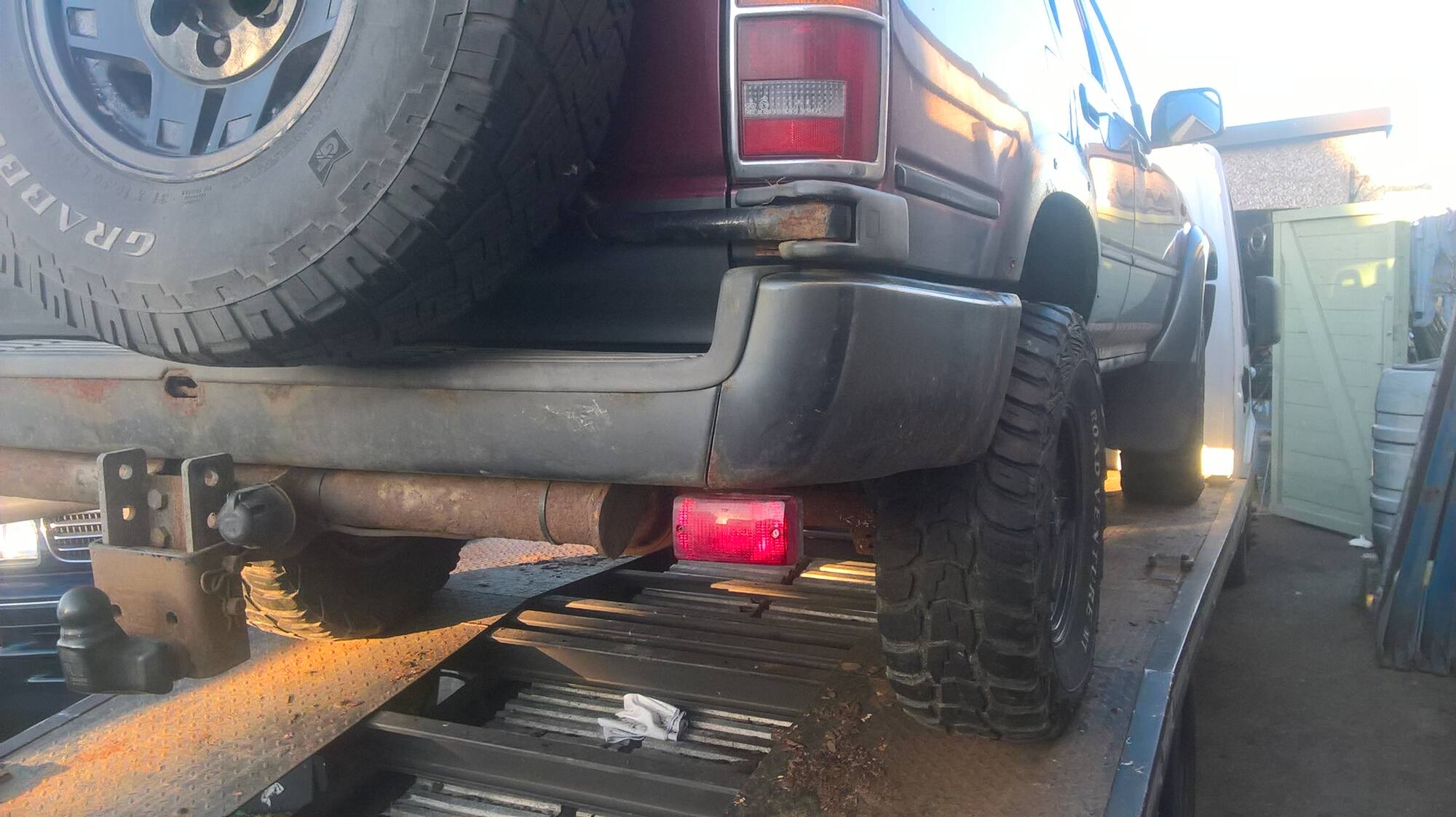

Preliminary wire-brushing/scraping... more salty goodness.  Also, found the offside spring is broken, had no effect on handling.
Exhaust went on last year, so at least there's one shiny bit!

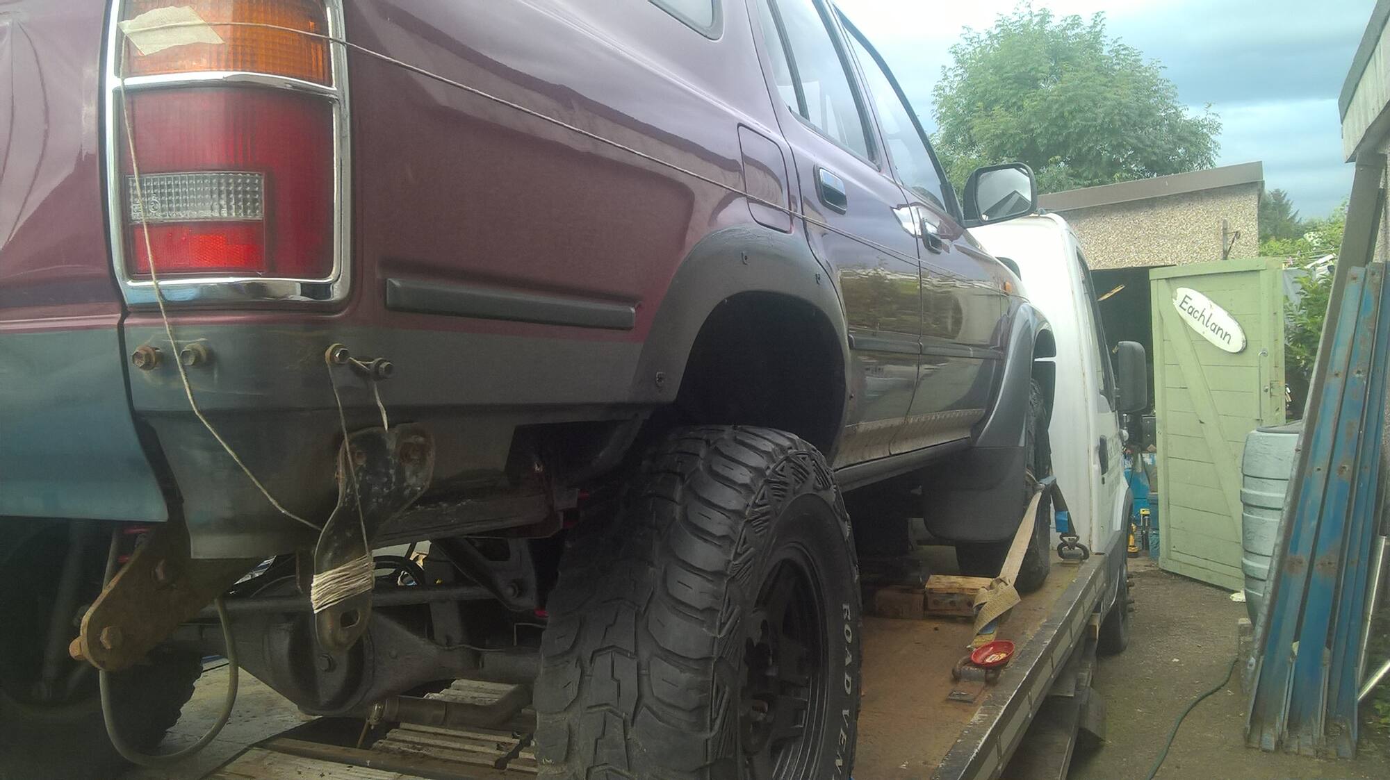

Towbar, bumper, wheelarch trims and spare wheel carrier off...  this lot weighed approximately one metric tonne btw.

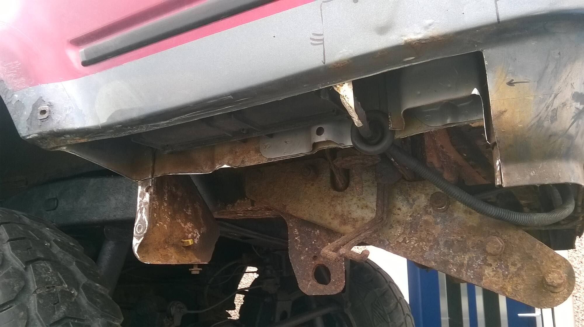

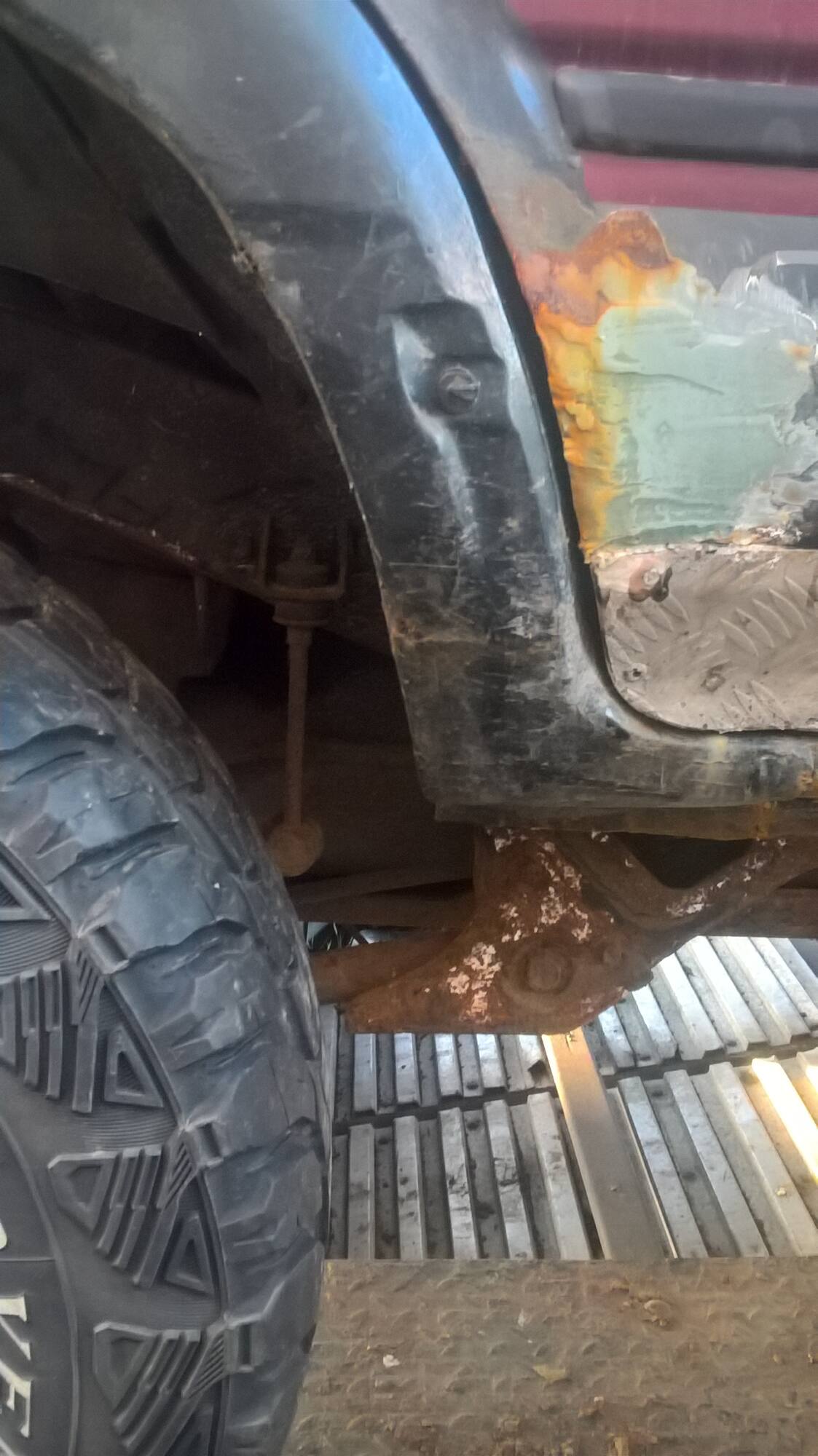

It's removal revealed some air where the lower body should be!
Offside not quite as bad, but still a sparkly stick job.

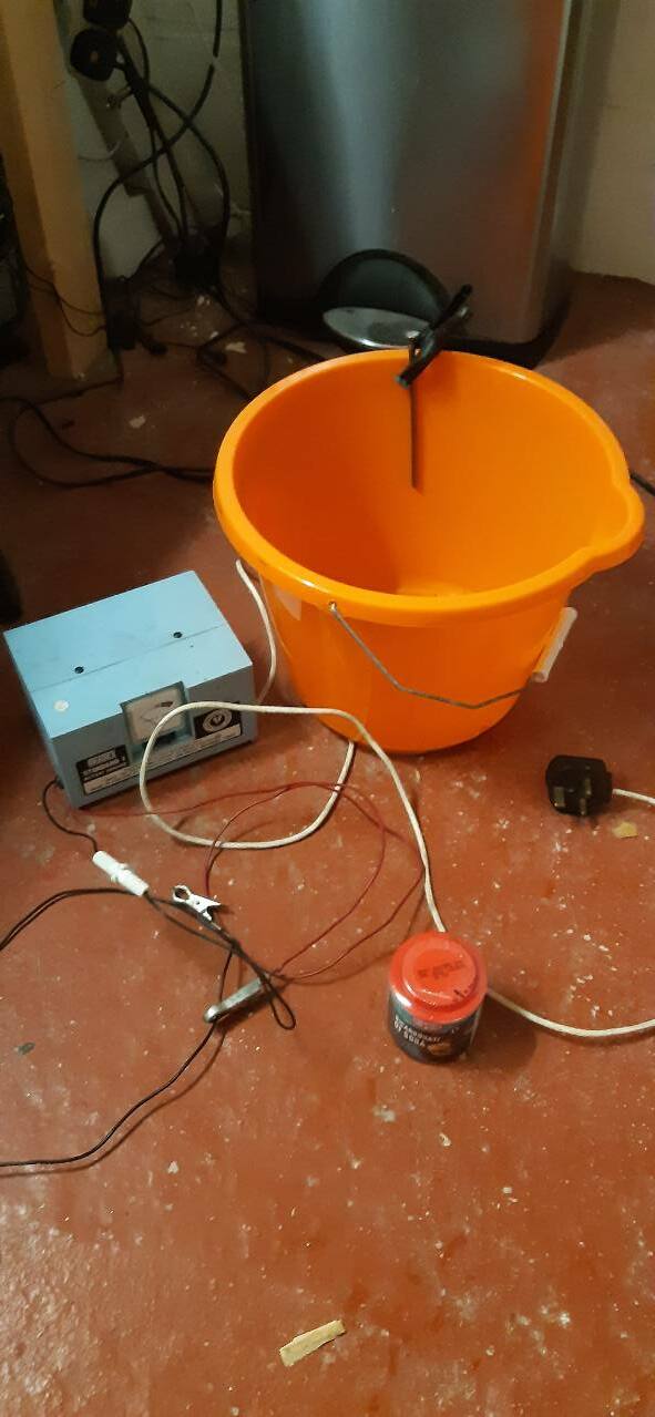

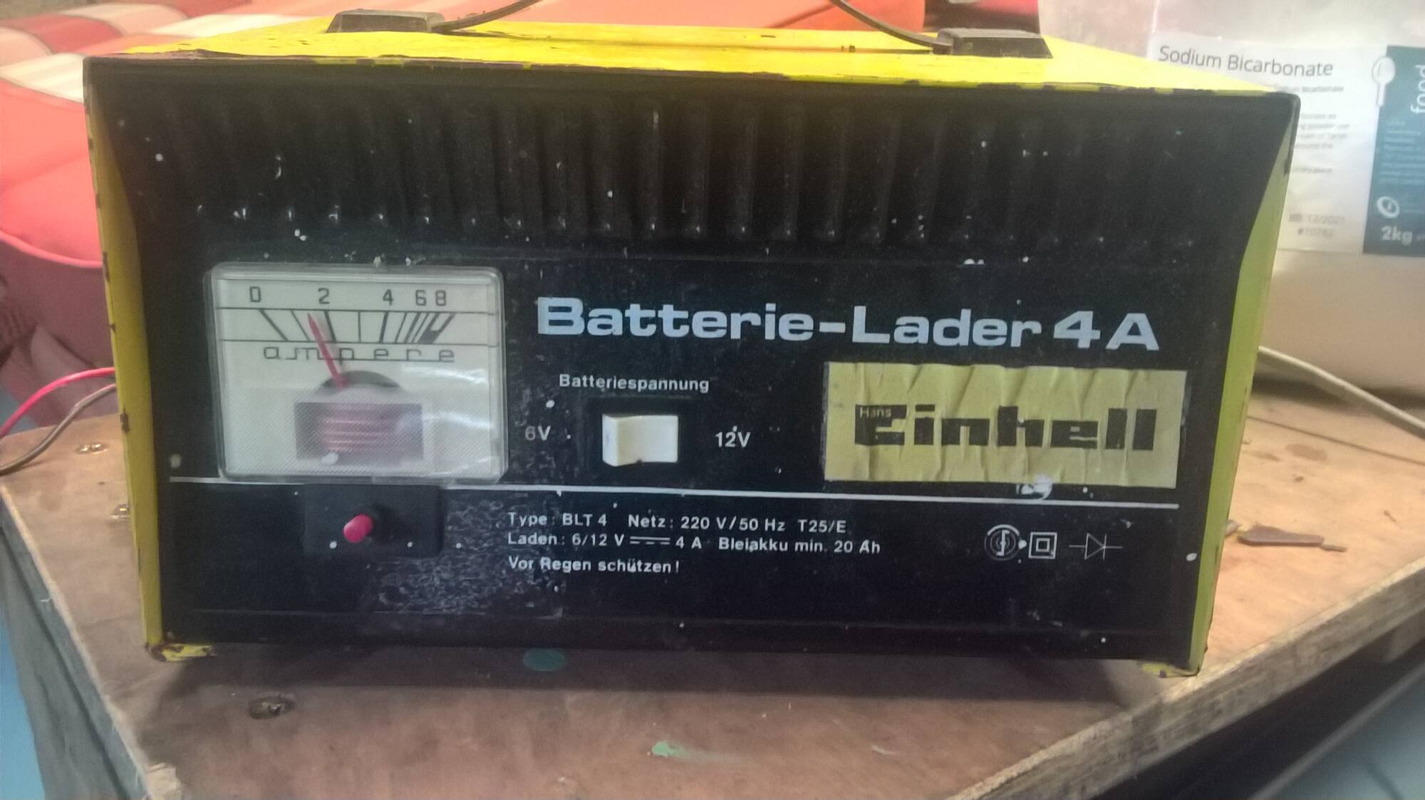

I have been interested for a long time in trying out the electrolysis rust removal technique, and today, whilst working* from home, thought I'd give it a go.
Ingredients:
Big plastic bucket/bin
Old-fashioned battery charger (new ones can tell they're not connected to a battery, so won't work apparently).
Water
Bicarbonate of Soda (or soda washing crystals)
Bit of steel for an anode, this will be gradually used up in the reaction
Bit of rusty jeep that will hopefully be *like new* shortly!
Pics:

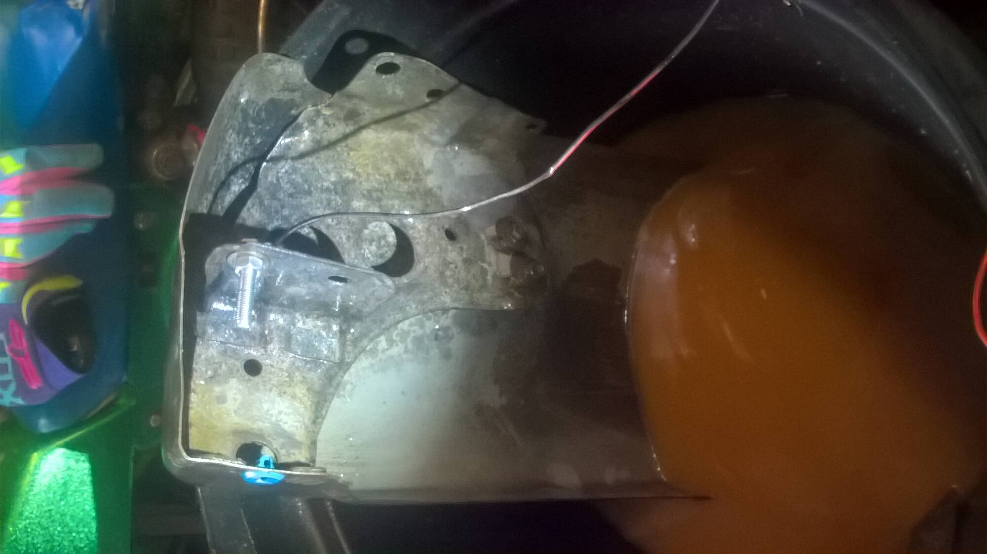

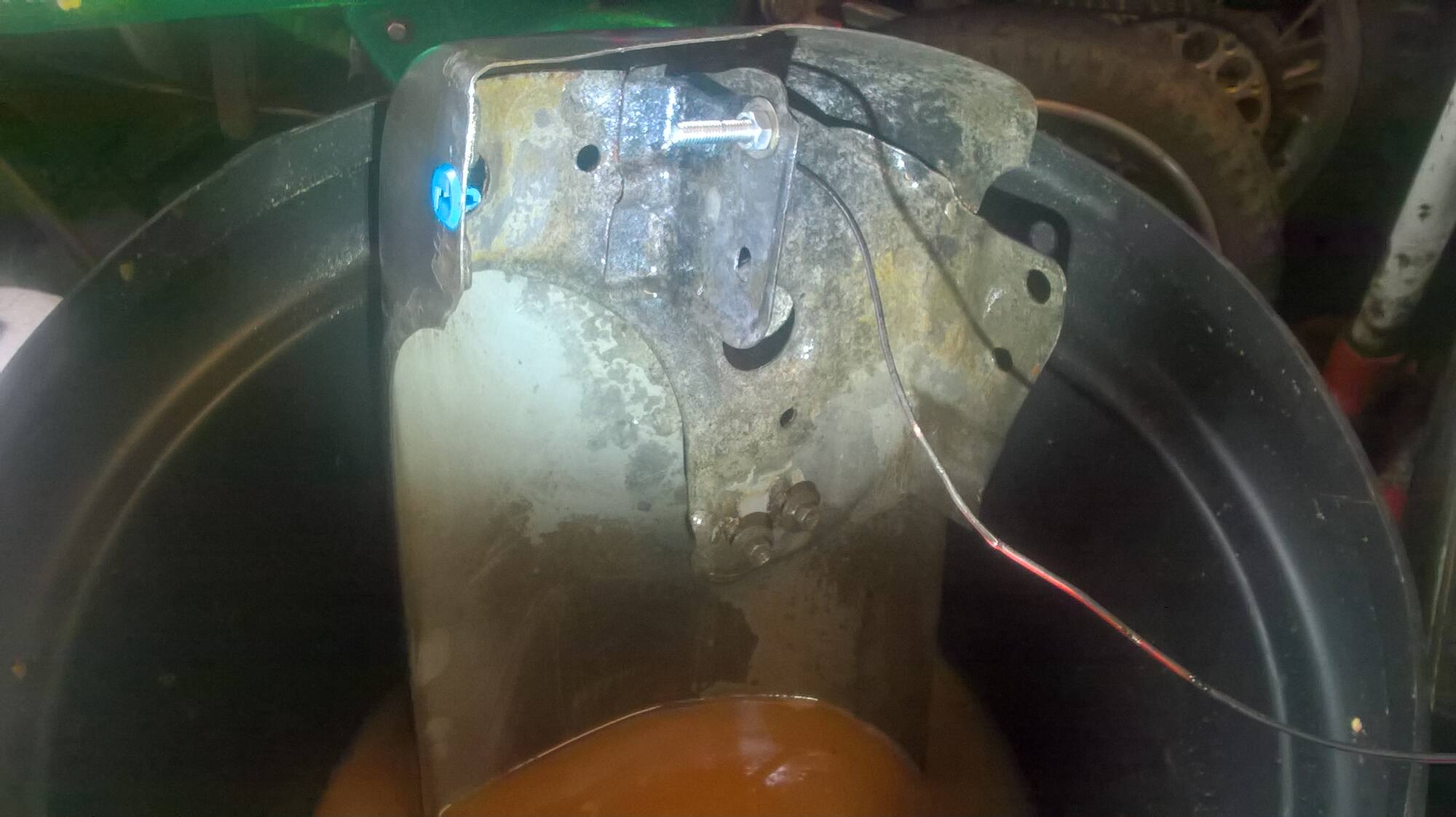

The workpiece is the offside corner bumper off the old jeep, the end in the water incorporates a bracket that is spot welded in, meaning it would have to be cut out to get at the rust behind it, if this works it'll be labour-saving in the extreme.
Couldn't get a decent pic, but you can see the bubbles streaming off the bumper and the anode, with the charger showing just shy of 2 amps.  We hooked everything up after stirring in a small amount of bicarb, switched on the charger and got just the smallest jump on the gauge.  I watched while we stirred in more bicarb (I would say a good mugful went in overall), and saw the needle creep up to where it is now (t'was pretty amazing!).  Apparently the bicarb isn't used up in the reaction, just helps the electrons flow...
Will report back with progress, I fully appreciate I may be preaching to the converted on here, but just loving the application of science!

First night in the Rust-o-matic 3000...
This was after I'd flipped it round to get the other end in.  Doesn't look much in the photo maybe, but it's done an amazing job.  At first it seems like not much has happened, but the rust comes off like a snake shedding it's skin when you touch it, and of course it's de-rusted every nook and crannie.  The bracket shown above is spotwelded into the bumper, and I couldn't think of a good way of getting to the back of it without drilling them out.

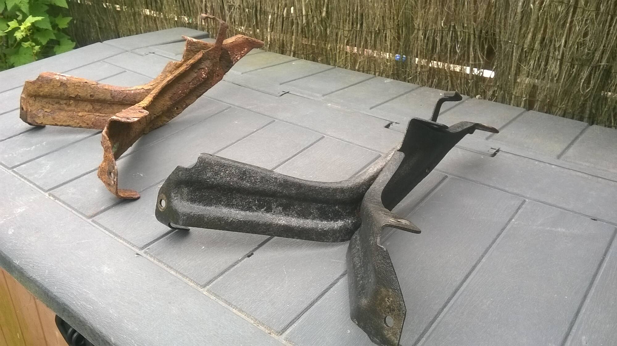

Never took a 'before' shot, but here's the other corner bumper for comparison purposes...
If you haven't tried it, and are wondering if it's worth the bother, then I can tell you that it is.  Tomorrow I'm going to top up the bucket and do the centre section of the bumper, which is really quite bad.

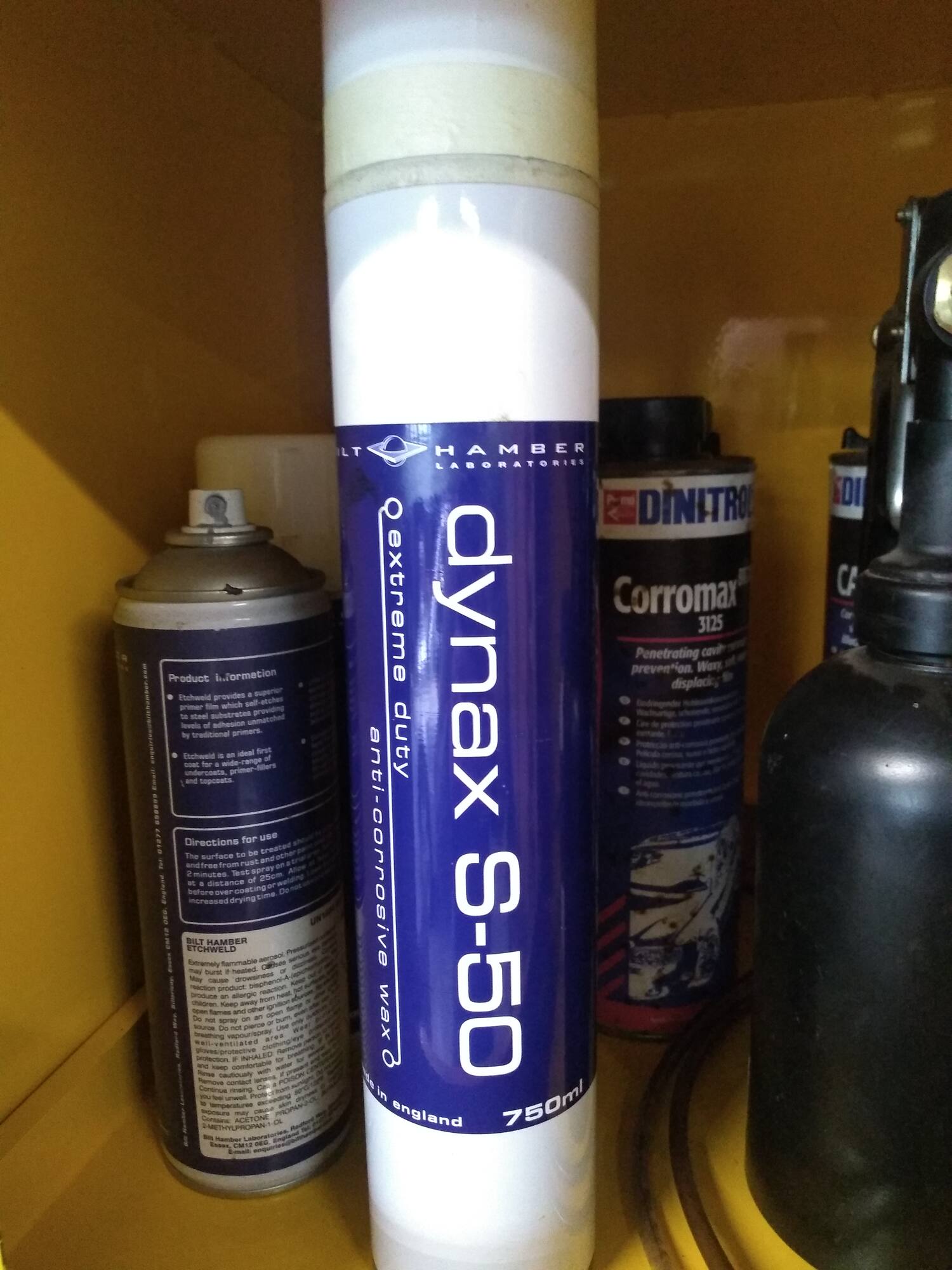

Wondering what to go for as a top coat, to be honest, the best I've ever found is grease (heavier and blacker the better), worked in with a brush.  This will probably end up that way, don't think I've the patience left for actually painting it!
Chassis rails are hefty things on a Hilux, so they'll be good for a while yet... plan to shoot some oil into whatever holes I can find also.

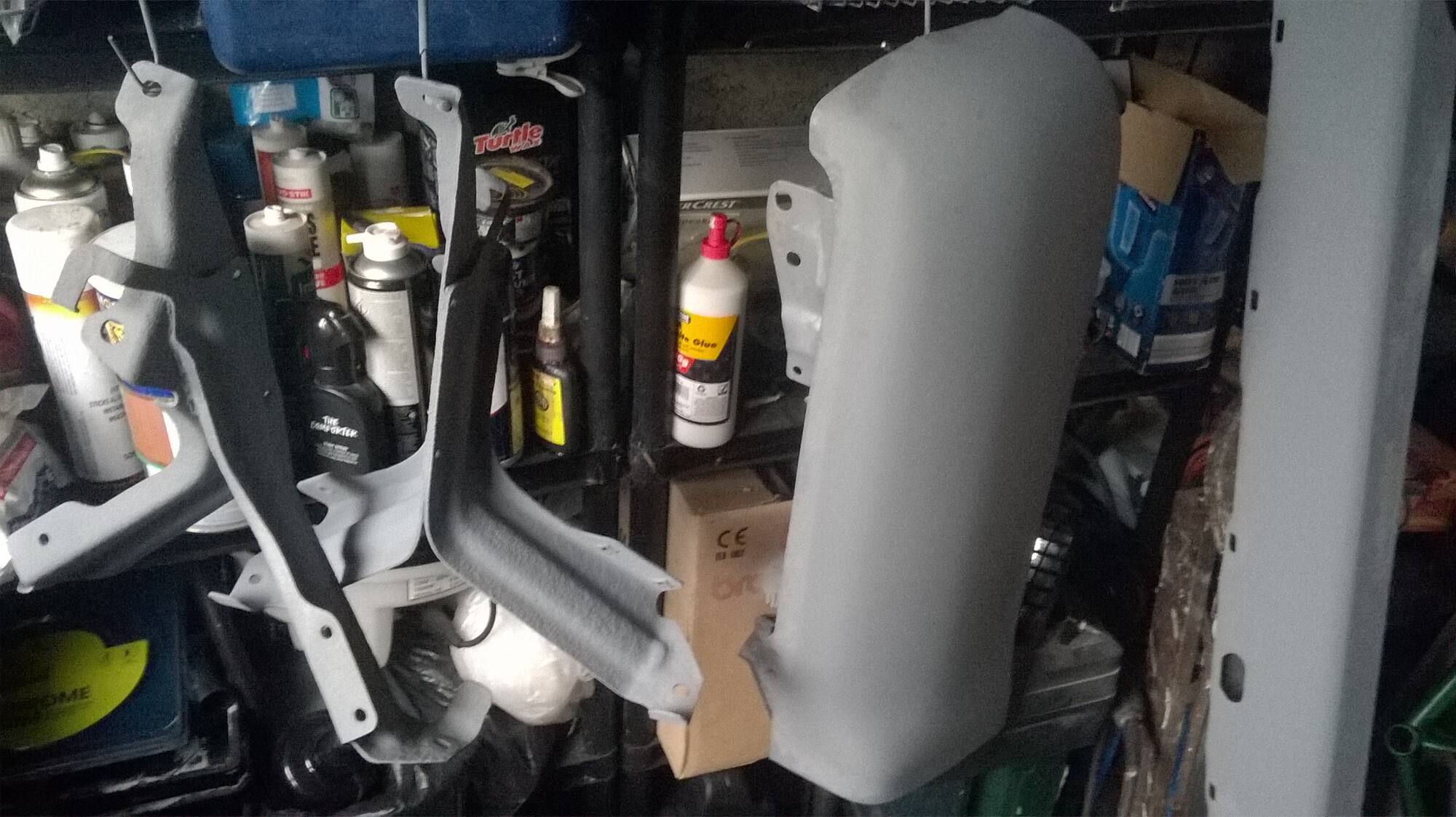

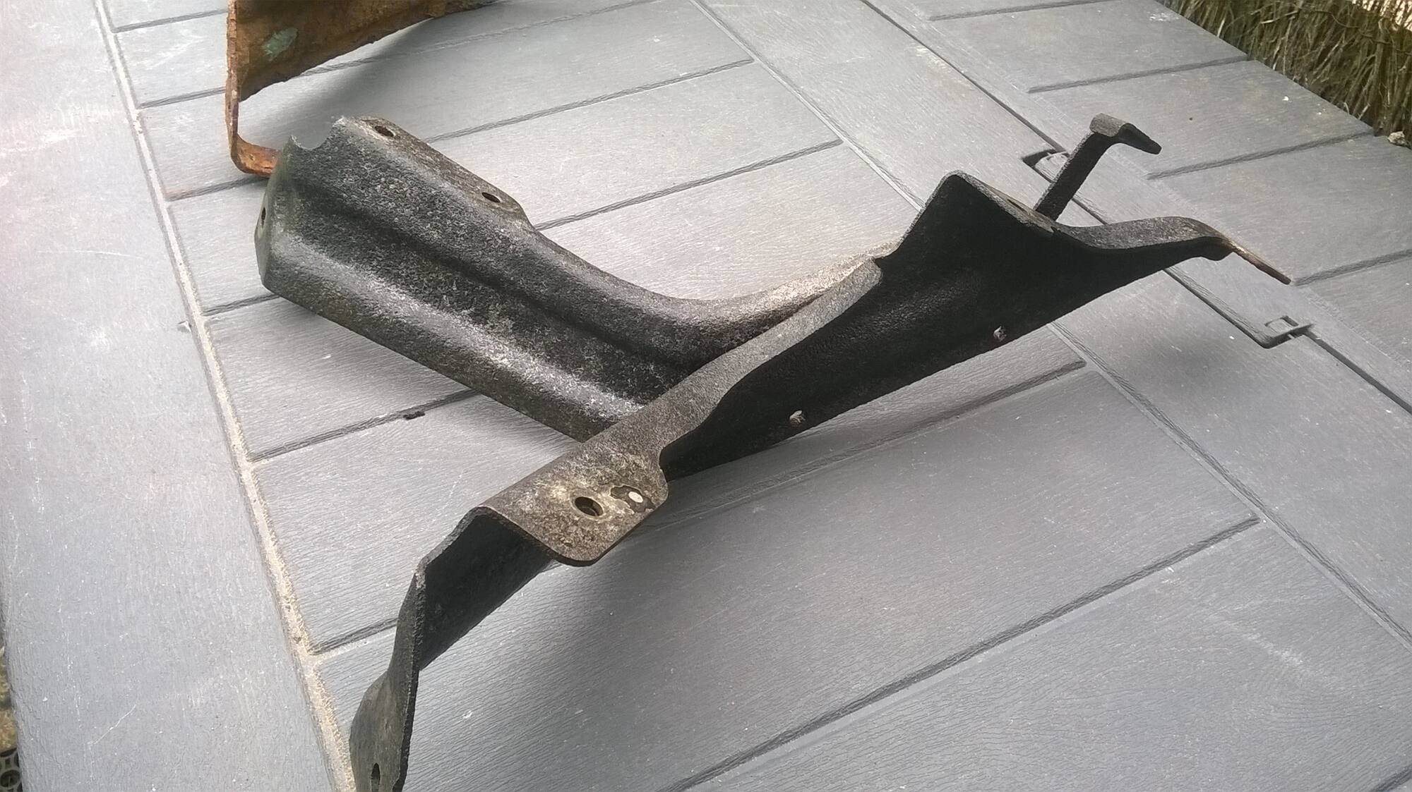

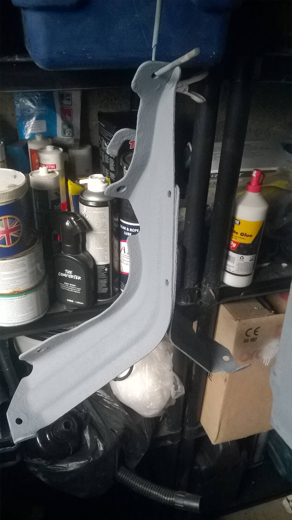

Started this morning with removing the bumper iron from the ol' rust-o-matic 2000 (electrolysis bath)... I know I've gone on about this before, but check out these 'before and afters'
I know, mind-boggling stuff...  Primered now, along with the previously de-rusted quarter bumper, and the remaining one in for it's bath night.

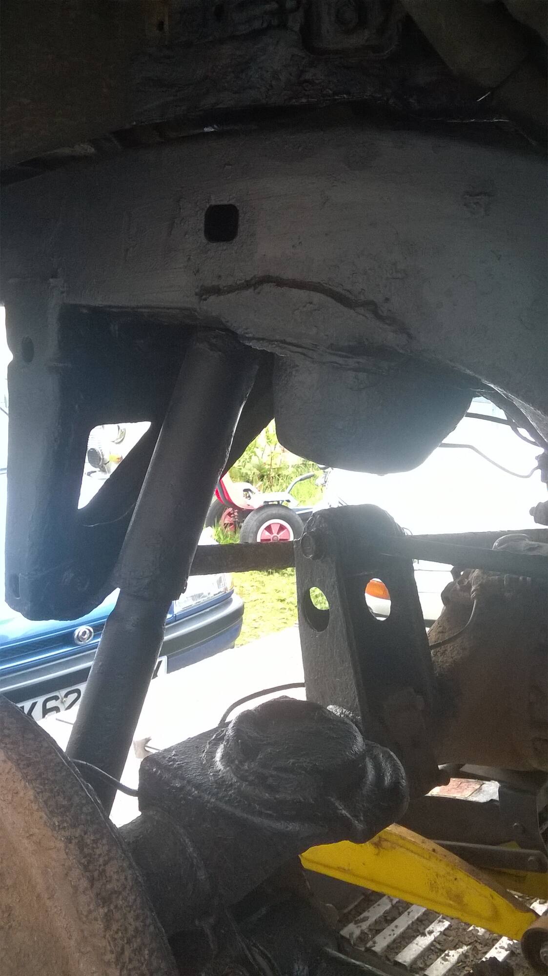

I then spent a few happy hours chipping rust off the chassis/axle/various components (I have found that the best method is literally hitting it with a hammer, sometimes my drive-through screwdriver, and dodging the ricocheting rust missiles), and slowly but surely a cleaner looking (and substantially lighter?) jeep is emerging.
To break the monotony, I primered and painted (Rustoleum) the anti-roll bar.  This gave me more pleasure than it should have, I may be losing my mind under there...

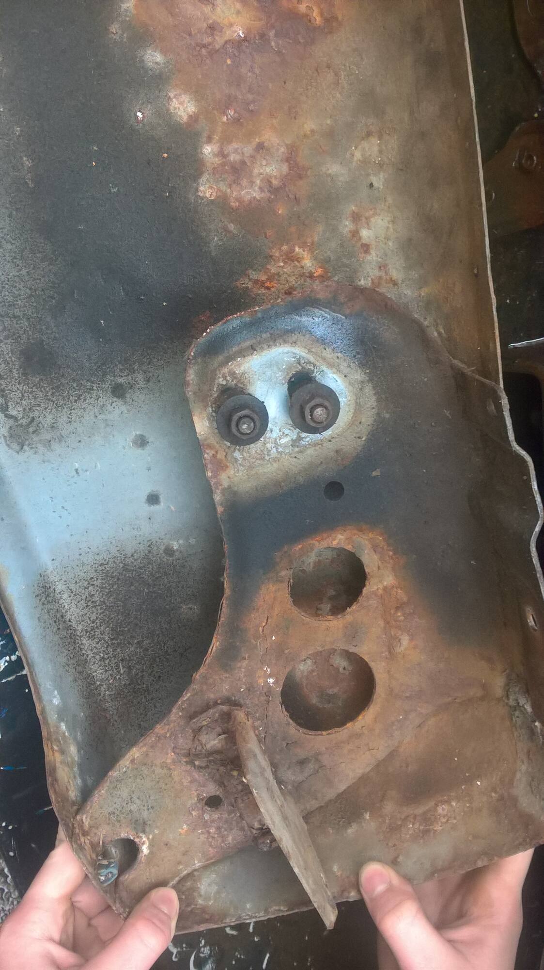

Bit more Vactanning, and then I had a good think about the repair panels I need to make up for the rear...  I did my thinking armed with an angle grinder, so this happened...
I was measuring out repair pieces to match Toyota's original design, but realised I would still be here next year if I didn't get a move on.  The plan is to just make a flat plate to seal up this bit now, I couldn't see why not, it's not structural, completely invisible once the bumper and mudguard is fitted, and will only rot out again...  I am even thinking about making it a bolt-on affair, thereby enabling annual checks and re-greasing.  Clever or stupid... you decide!  The picture below maybe shows up what I'm thinking better...
The pen marks on the body locate the template I made up so I don't lose my bumper mounting point location...  Wheels, by the way, are temporarily re-fitted because I was staring to feel nervous under there (wind was really getting up and rocking her about a bit).
Vactan looking a nice purplely (blurple?) colour, you may be able to tell where I've greased up the areas closest to the wheel wells...  this will be the topcoat, black, heavy grease worked in with a brush (a toothbrush in some hard-to-reach areas... a few hours of that'll have you questioning your life choices btw...).  Considered replacing the dampers (new springs should be here tomorrow), but decided against as these, although scruffy looking, are the original electronically-adjustable units as Toyota intended.  Amazingly, they still work... you can replace them fairly cheaply, but lose the adjustable-ness, or with Toyota units after simply re-mortgaging the house/selling a kidney etc...

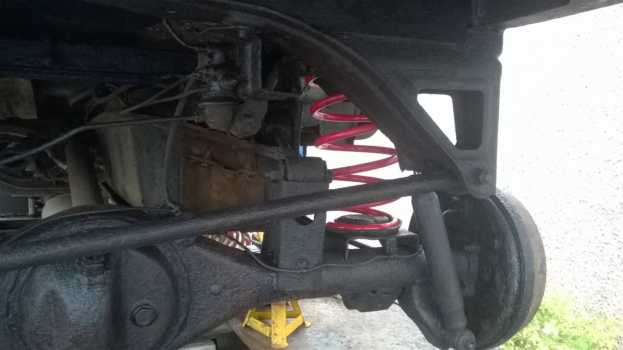

Back on her wheels today, just the centre floor and chassis sections to do now, and feel better under there this way.  Never moved on the axle stands, it's more the truck rocking about underneath when the wind catches her...
Got the other spring, anti-roll bar and some wee guards fitted first... the springs are 2" lift units (the only ones they sell at Roughtrax now), and needed to be compressed to nerve-shredding levels to fit.  The old girl will be riding high for a while I think.
Strung a line along her, trying to decide where to paint up to with the satin black (eventually).  I want something I can touch up as required over the years.  I'm sure that in the end, the Rustoleum will become all-encompassing!  The neighbours have all been very interested and encouraging, which is nice considering the noise that removing the rust has generated over this last week!

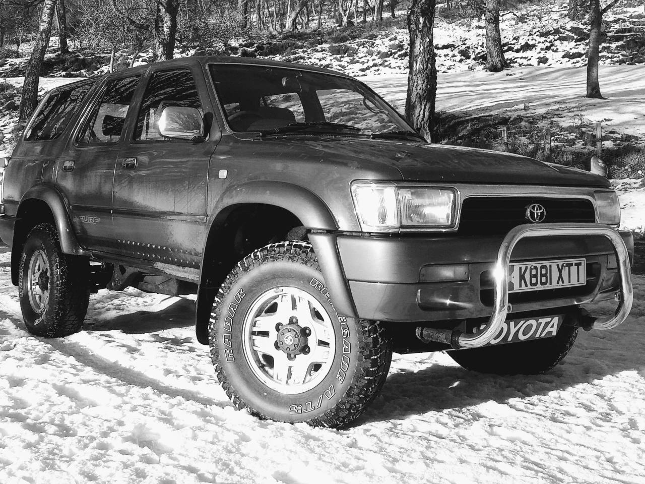

Anyway, today saw the fitment of my old wheels, with the new Radar Renegade A/T's on!  Feast your eyes on the rubbery goodness...
Strange for us to see her with silver wheels again, quite like it though.  Bit less aggressive than the satin black?  They aren't in the best condition, needing a rub down and spraypaint (not stretching to a refurb this time I don't think, although maybe one day... they're pretty smart these old 'cruiser wheels).  Warmer weather will be better for that job though.
The tyres have absolutely transformed the ride, she is super smooth and quiet now.  Strangely, even though they are the same size (31x10.5x15) as the Kuhmos, they stand a good inch-and-a-half taller stood next to each other.
Time will tell what the wear rate is like, first impressions are excellent however, and they are relatively cheap at £86 quid a corner from Camskill.  I chose them as the standard BF Goodrich/General Grabbers are getting a bit expensive to my mind, profiteering maybe as it's a fairly old-school 4x4 size these days.  In the states, Radar (made in Singapore) offer a 50,000 mile warranty on these Renegades, so hopefully they'll last a while.

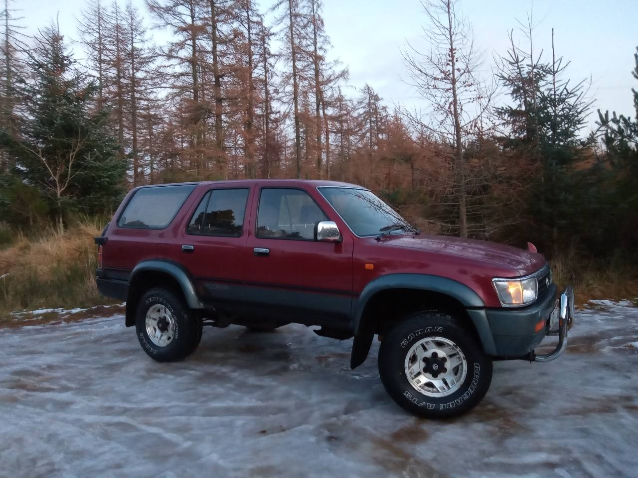

More shots of the Jeep in the very beautiful Speyside countryside...  New tyres have been well tested this past week, on commuting duties.  So far I'm really impressed, even in 2wd she really grips.  Hopefully the MOT tester will be happy this week and I can enjoy another carefree year of Surfin'!
