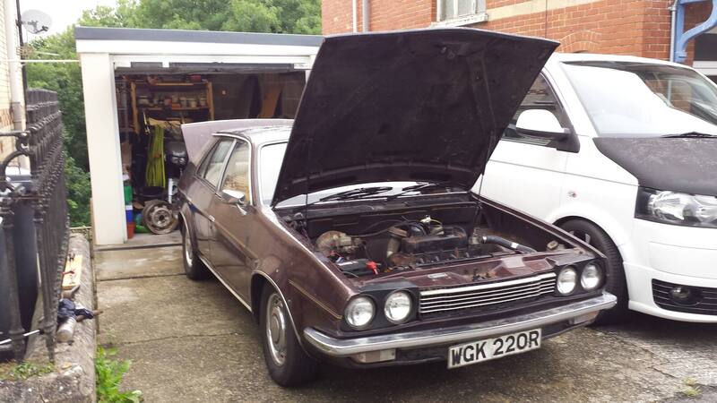

Sorry, wall of text incoming as I forgot to get any photos but I've had a silly grin on my face for the last couple of hours because after another tinkering session this afternoon I finally managed to get out for an actual drive in it!
Today's plan was to fit replacement waterpump no.2, a NOS Unipart item which spun much easier than the last one and felt like a heavier, better quality item.   I replaced the top coolant hose with the O-series version to fit the O-series radiator I ended up with. which unfortunately was about an inch too short to reach the thermostat comfortably on the 1.8 - this was resolved permanently* by unbolting the top radiator mounts, allowing it to tilt back enough for the hose to seat properly.  I then zip-tied the mounts on to keep the radiator stable, it's not ideal but it does work OK and will suffice until I can get the right sized generic hose to fit.
My mate than popped round for another socially distant assist and we rejigged the exhaust with another tin can to seal up the centre joint.  First start showed it is now much, much quieter and you can actually hear the engine - the only issue was the 30 year old corrosion protection on the new front pipe which took a few minutes to burn off and smelled quite dreadful.
A few short runs up and down the road and a few goes at bleeding most of the air out of the cooling system all went a bit wrong when the alternator belt started squealing and it took several attempts and eventually referring to the Haynes manual to find that the belt needed to be what I would consider to be extremely tight - 1/2 inch deflection - which once achieved did shut it up.  I'm not convinced the belt on it is much cop, it appears to be new from when the car was first woken up but I will probably get hold of a spare one anyway.
With that sorted, there was only one thing for it...a cautious test drive.  I chose a route which involved back roads and lanes through tiny villages thinking it would be 'safer' for a first try than the busier main roads near my house but I had forgotten that the route was extremely hilly.  Nonetheless, she performed well, the temperature stayed cool (my new fan seems to work a treat) and eventually, after stopping off at a mate's house where his 8 year old daughter assessed it as "smelling funny" I got brave enough to hit the A386.  Much to my surprise there were no real issues, she got up to 55mph without too much fuss and drama, didn't make any particularly strange noises and in the end I looped back round and ended up doing about 15 miles.  Not bad for her first proper trip out since 1992.

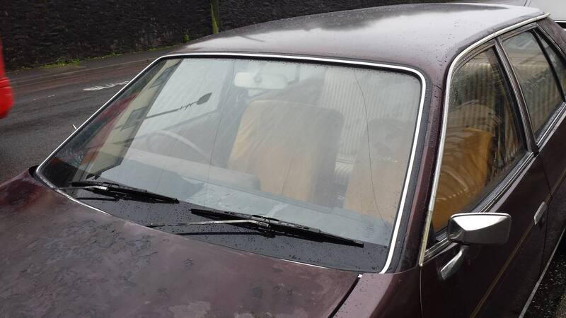

Just had a phone call, my expensive new seal which came from a batch the owner's club had made up has been fitted successfully.  The windscreen didn't break and it went well.  They found a couple of small rust holes in the drainage channel but nothing serious, they're filled up with sealant so shouldn't present an issue for now.  I'm quite relieved!
After fitting the new battery the drive across town in rush hour to their workshop turned out to be stress free, even when I got halfway and realised I hadn't actually put the seal in the car and had to go back home and get it.  The driveway looks odd without the Princess parked on it, should be able to pick it up tomorrow afternoon and then it's in to my mechanic on Friday for suspension, tuning and welding.

I picked it up from the windscreen fitters today, they have done an amazing job, it fits perfectly and they even managed to find the correct totally not fake chrome insert - the old one was a brittle yellow thing with bits missing.
I am very pleased and it only cost £60 which I think is a bargain, the other quote I got was twice that.

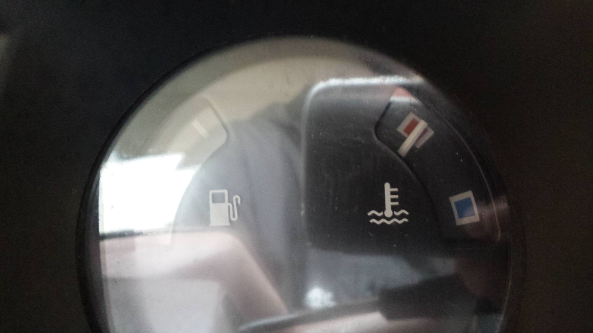

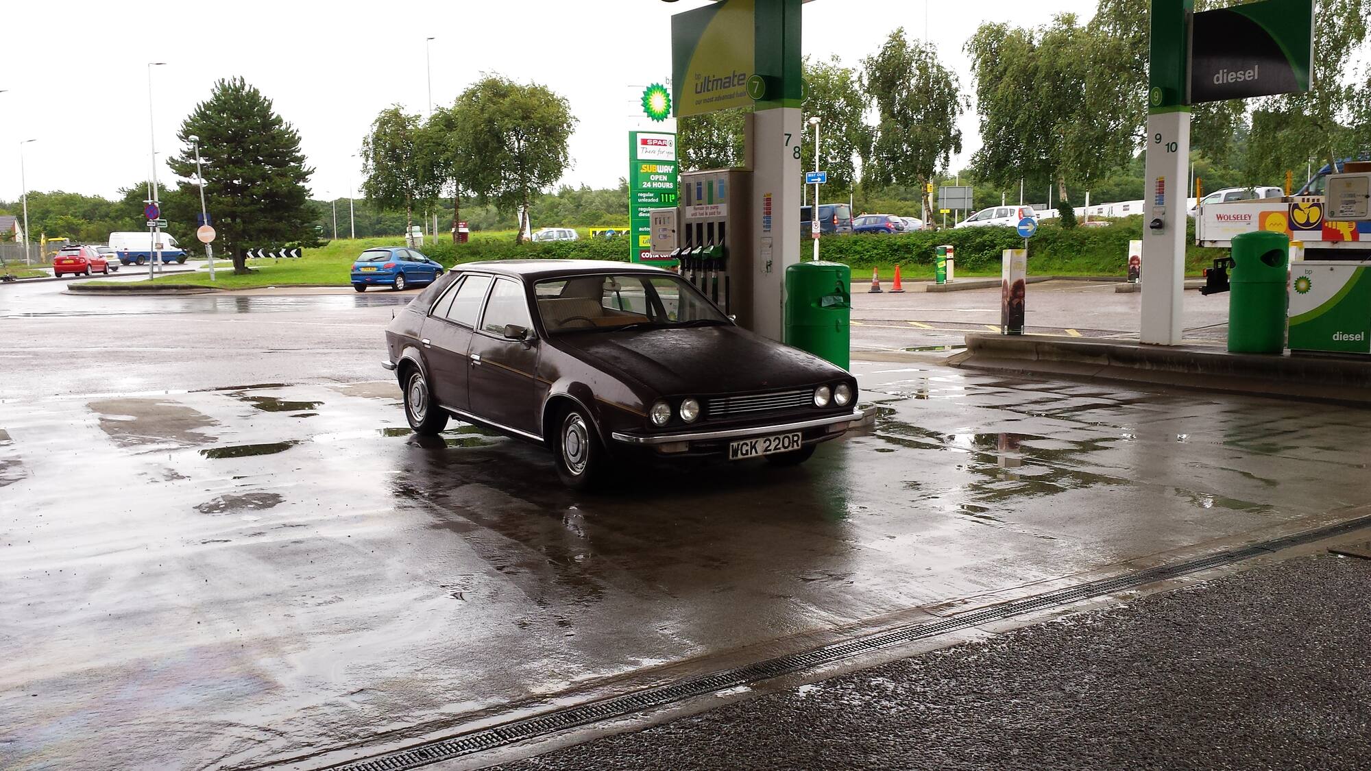

I celebrated with a detour to a petrol station for £20 of BP Ultimate as the fuel gauge doesn't work so I have no idea a) how much is in the tank or b) how many mpgs she's currently doing - I suspect probably not many until the timing and carb are tweaked.
On leaving the petrol station the fanbelt decided to go full screech on me again - it would only quieten down on a low idle but that meant dropping the choke off which made it stall on a busy roundabout.  Ooops.  Got it going again and screeched the 2 miles home.  Parked it on the road, left it idling while I moved my Octavia off the driveway to park, backed it onto the driveway and only then realised it'd got a bit hot.
Ooops.  I usually watch the gauge like a hawk but took my eye off it for a few minutes too long.  There was a gush of steam and lots of bubbling noises, I had visions of a blown off hose or something worse but it turned out to be just overflow out of the header tank.  It doesn't look like my new fan kicked in and I also think it might be spinning the wrong way so will have to attend to that.  I reckon it probably still had airlocks too, it's fine out on the open road but at low speeds or when stopped the temperature climbs until you turn the heating on.  It's still on the old thermostat, I have a new one to go in but the stat housing is welded together so I haven't wanted to start bashing at it yet.
