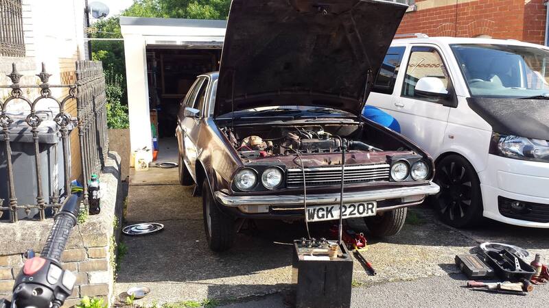

I started it up for the first time in a week earlier and was surprised when it ran for a few seconds, died and refused to restart.  A quick inspection under the bonnet showed a fuel filter containing a lot of brown sludge and not much else...hmmm, how long ago did I put £20 in it?  Quite a few weeks ago and it's done 65 miles plus a lot of idling since then.  The fuel gauge doesn't work but shoving the car around a bit let me confirm there was at least a bit of petrol still slopping around in the tank.
I went and filled up my jerry can, put a new fuel filter on it and turned the ignition on but the fuel pump stopped after a few seconds and the filter was empty.  At this point I decided to get seriously technical and selected a very specific long handled screwdriver with which to give the fuel pump some encouraging taps.  Still nothing, but I felt I was on the right track by hitting things with a screwdriver handle so applied the same treatment to the carb float bowl, which caused a sudden flurry of action from the pump and a surge of grotty brown fuel into the filter.  It then started and ran fine.
All this means one thing is clear...the fuel tank is going to have to come out for cleaning, but in the mean time I'll keep it topped up and replace the filter regularly.  Looks like my nicely cleaned and rebuilt carb will have muck in the float bowl again too despite the filter, so that's going to need attention.

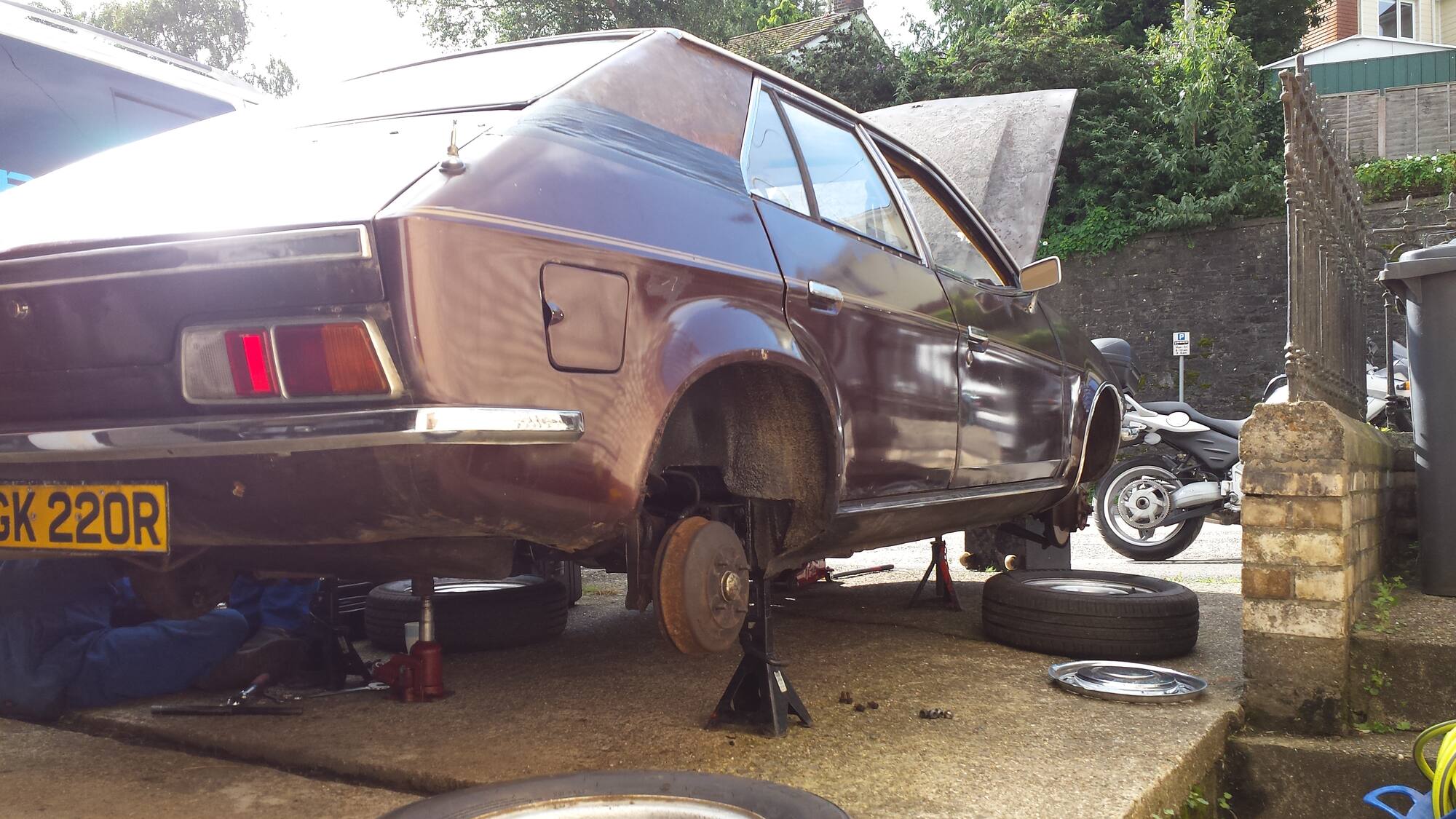

Sit rep: some bolts on the rear cooperated but passenger side is seized solid so the radius arm is coming off and being replaced with a spare they've got in their LDV.
They work fast!
  • Like 11
One seized passenger side radius arm.  Hopefully the drivers side is better but they have brought replacements for both.
Passenger rear is finished.  Drivers rear is not seized which is good news.  Less good is that it is full of a nasty concoction which appears to be mostly LHM.  Someone from the 80s messed up!  He said it's very common, they're flushing it through to get rid of it.
Front not going so well... one of the pipes is rotten and snapped off.  He's trying to sort a fix but it's not a common failure and you can't get the pipes.
  • Sad 2

That split pipe is exactly what mine did, except it looks like you've actually got some material to work with to get a joiner in there.  Fingers crossed for you here!
There's some serious hot torch action going on at the moment, fingers crossed.
When he pulled out the drivers side displacer the last jolt caused an eruption of nasty LHM/Hydragas fluid mix to vomit out of the pipe under the bonnet.  Sadly this means all the displacers are probably ruined, I do however have 4 freshly rebuilt ones.
Looks like he's saved the pipe, exciting!

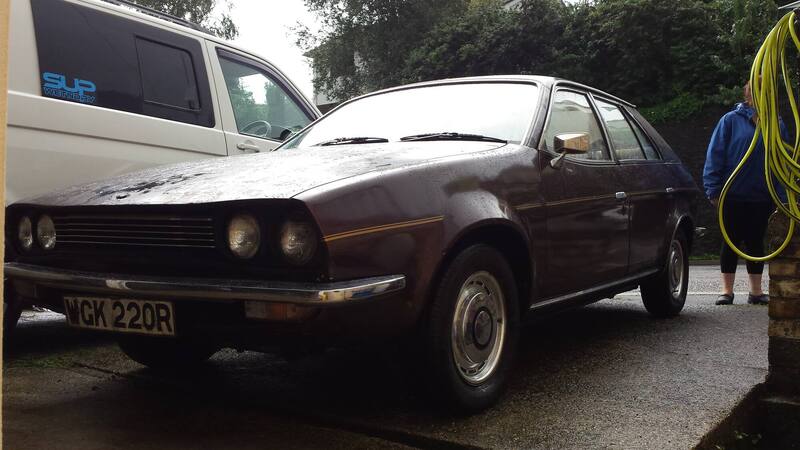

It's done!
It's also now raining on a biblical scale, that started as the last wheel hit the ground so they timed that well.
Once this passes it needs a test drive to settle it down and any adjustments can be made to the ride height.
Happy days!

Second test drive completed, still having all the rain ever but they've finished, left for home and she's looking much better.
Ride and handling now vastly improved, needs a proper test when I can see where I'm going and the roads aren't a foot deep in flood water though.
