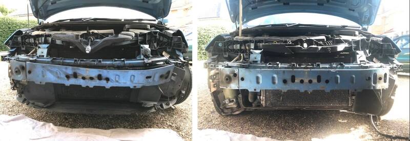

Ford Focus – WF08 JMV (& RO08 WLK) – Accident damage repairs
The plan: Remove the front of RO08 to work out how it’s put together, remove the front of WF08, put the front of RO08 on WF08 and then go inside happy having done a good job.
Part one occurred over Thursday and Friday evening, save a few odd and ends. The only issue was some degrading of the plastic nuts where the wings and bumper are held together. The rest of the parts were in nice condition.
Part two was a bit more difficult because of the damage, but eventually I got all the bits off (not pictured: the passenger wing came off shortly after).
Below are a couple of before and after photos of the crash beam and front cross brace on WF08. It’s interesting to see how much damage occurs underneath the bumper when things can look unscathed from the outside.
Putting it back together on the same day as taking it apart was pretty pleasing, what with still being able to find everything and remember where everything goes. The only bodge was that one of the three ECU mounting points had snapped in the crash and zipties came to my rescue. To offset the bodge karma I refitted the bumper with new stainless nuts and bolts rather than the naff plastic ones that had almost all disintegrated on both cars.
After much faffing with the final trim clips and them plastic-screw-push-pin things of doom it was done! New* bumper beam, bumper skin, front top cross member, lights, radiator carrier, bumper skin, grille, air intake duct and passenger wing successfully swapped. What I did forget was which side I took a photo of for the before and after shots! Full disclosure: the geekier amongst you may notice that I'm now rocking a Titanium front end although the car was originally a Style. Let's face it, this may be the only forum where that that is considered a downgrade betraying my bASe spec credentials - and it may be the only place on the internet where someone might have noticed ?

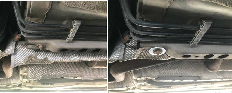

Heat Shields
While under the car I noticed a couple of the heatshields were dropping. It looked like galvanic corrosion had dissolved the heatshield within the dimensions of the old washers. A couple of mahoosive washers sorted that out.
