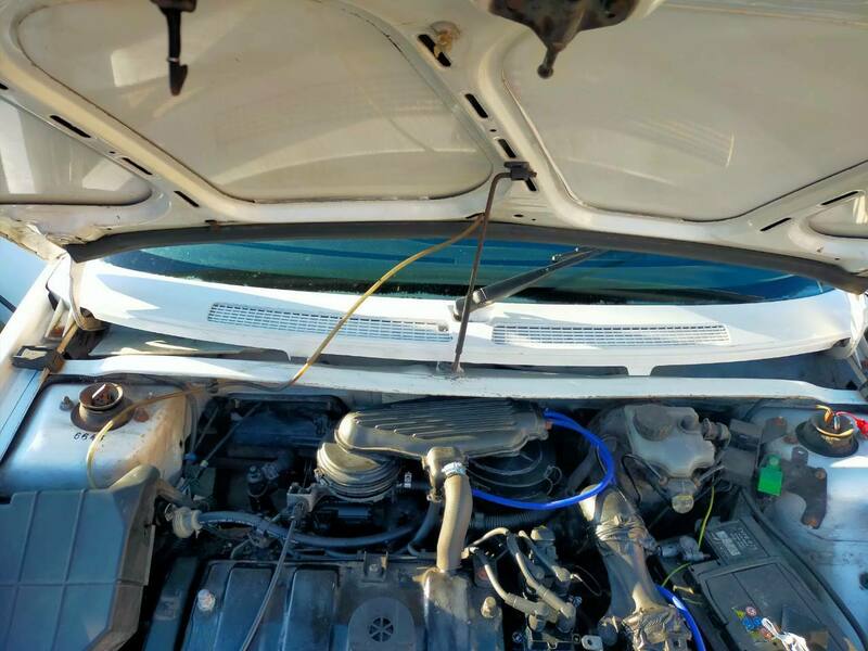

Still battling with the slight hesitation, so I decided to try to restore everything about the air flow back to stock (I did have an aftermarket filter on, and there was always a vacuum port blanked off). Also almost every join leaked. Replaced everything as per the manual.
It seems to have improved things a little, but there's still a hiss/suck noise from somewhere.

Also, can anyone identify this part?
  • DoctorRetro changed the title to The Doctor's travels through time. This sucks
If you mean the white piece with a vacuum tube on it, I think that’s the advance mechanism going to the ECU. Sorry if you are trying to get a name for it, I’m not sure  :( It probably won’t make a difference but I had a friend whose 106 drove poorly and the vacuum tubes (blue ones that you have here) entering the air system above the air filter housing were reversed. Again, I don’t think that’ll make a difference so apologies!

That hiss will probably be the intake manifold connection from the crankcase breather:
The little T piece which that hose (and the blue one you also have) connects to has a teeny tiny hole in it which will make a whistling, hissing noise depending on if the engine is being revved or at idle. I blanked it off on my engine to no negative effect. Keep the big pipe from the cam cover connected as that's the actual vent.
1 hour ago, AxWomble said:
vacuum tubes ... were reversed
I've checked the photo in the Haynes manual, to see how they go.
Hmm, the tube on this was blanked with a screw when I got the car, but I didn't notice a hole. Will have a look
This is an old photo, but I cut my old intake housing up to see what's going on inside. Basically, you have this T piece next to the main hose from the cam cover. The little T part goes to your vacuum controlled air mixer (which you have and it's using blue pipes). The large part of the T has a hose which connects to a nipple on the intake manifold, directly below where the TBI bolts onto the manifold. Inside the T piece is a pretty big air restriction (the internal diameter is restricted to the size of a pinhole) which is where your whistling comes from. If you can, pinch the pipe shit while the car is idling and see if the noise goes away. It did for me and I deleted it as I have a manual air mixer. As you do, you can pull the T piece off, and blank the end that fitted in the intake housing.
See, I did that, because I had a K&N thingy on, but it was hesitant and running like crap. I'd removed the entire t piece and blanked off.
It's running better with everything back in place.
Yeah it'll run rich with it blanked off as with it open, it needs more fuel to run properly. I'm surprised the ECU doesn't correct itself and lean out the mixture.
I think it is trying to, but that coupled with the 99 octane fuel and the 1124cc instead of 954cc was too much for it to handle. Maybe 😂
