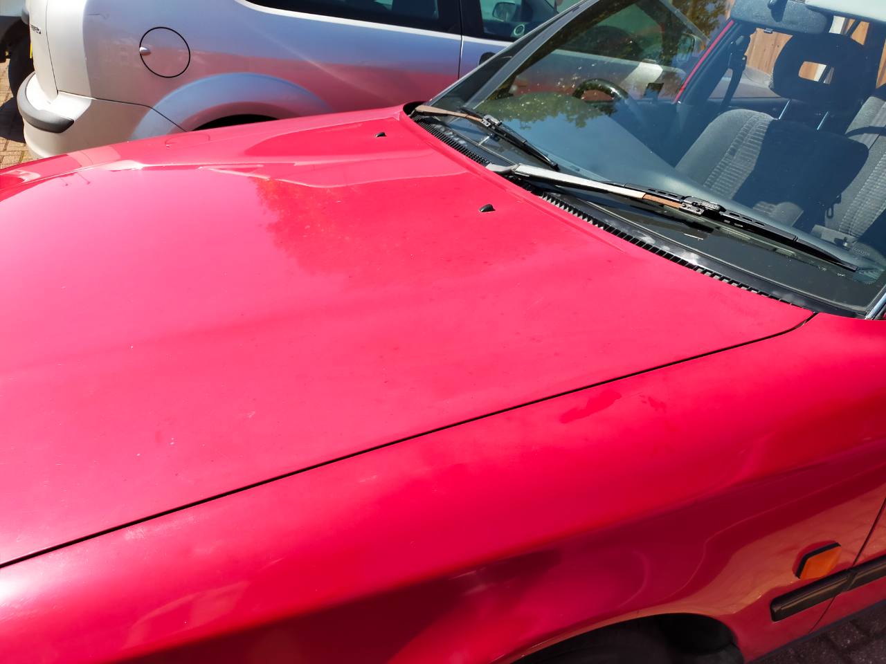

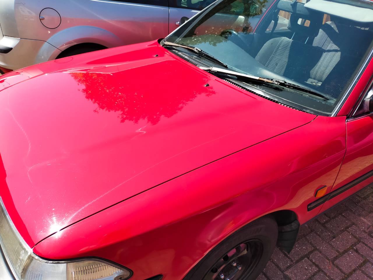

Got a present from Claire...
Had to try it out. Lesson 1, if you're an amateur, don't start with a huge panel like a bonnet..
Needs a lot more work.
Anyone fancy helping?

What products are you using, also I think black is the sortest pad, I think orange is the most cutting*
*disclaimer - I don't know what I'm doing..
What he said ^ Black is usually the softest pad for fine finishing or possibly polishing.

Cool, thanks. I didn't know what the colours meant.
I'm using some sort of G3 stuff, but it's level 1, for cutting.
There's a bit to learn!
Don't do it under the hot sun. Cover black trim unless you enjoy spending hours getting white polish marks off!

For machine polishing, I would recommend recommend orange foam pads.
They are the medium one and would work well on a faded red with a medium cutting compound like g3 or I use a cartec one. Green and black bottle, can't remember the grade off hand.
A tip when using the foam pads. Before first use, wash the pad thoroughly with hand hot water. This softens the pad and prevents scorching the paint which is a common pain with a new pad.
Keep the pad clear throughout cleaning regularly (an air blower blowing on the pad whilst it's spinning is a good method if you have access to one)
I avoid using the pads with water. I get a better cut using them dry and you don't get anywhere as much white splatter over everything.
Last tip, don't use too much compound at a time and keep going until its throughly worked in and then hand buff any residue off.
Oh, and save the black pad, it cam be used with a fine finishing compound or polish as a final step.
Just my 2p worth, hope it's some use to you

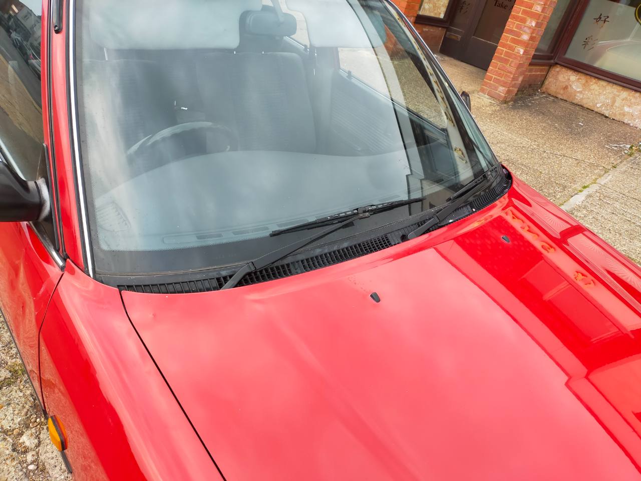

Wipers suitably blacked.

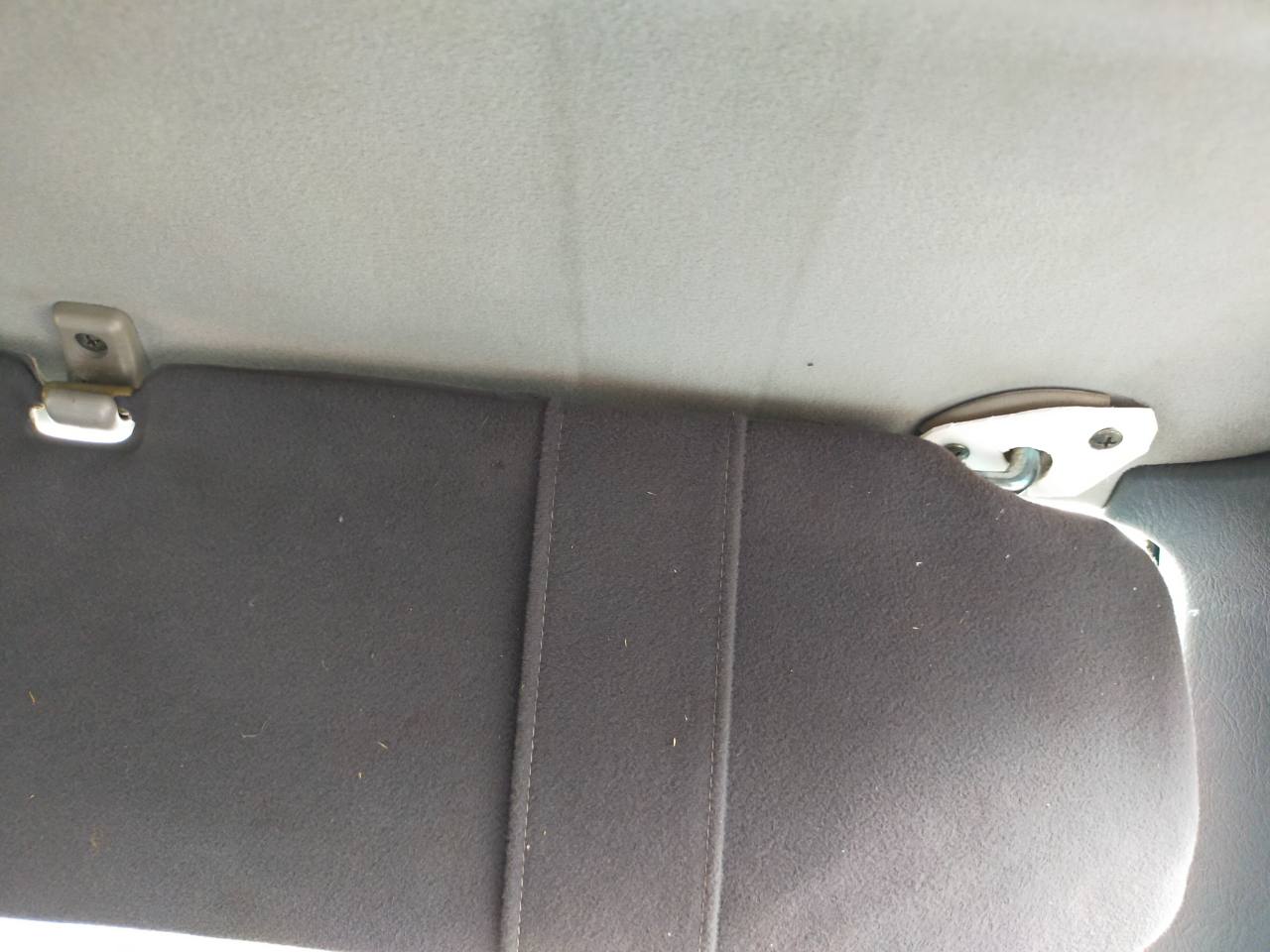

Also had to make a bodge to sort the snapped sun visor. It's amazing how much you miss them when they aren't there!

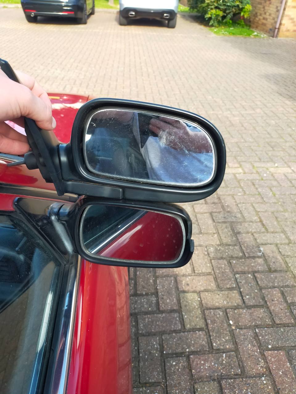

I'm an idiot
Guess that's getting returned then. 🙄

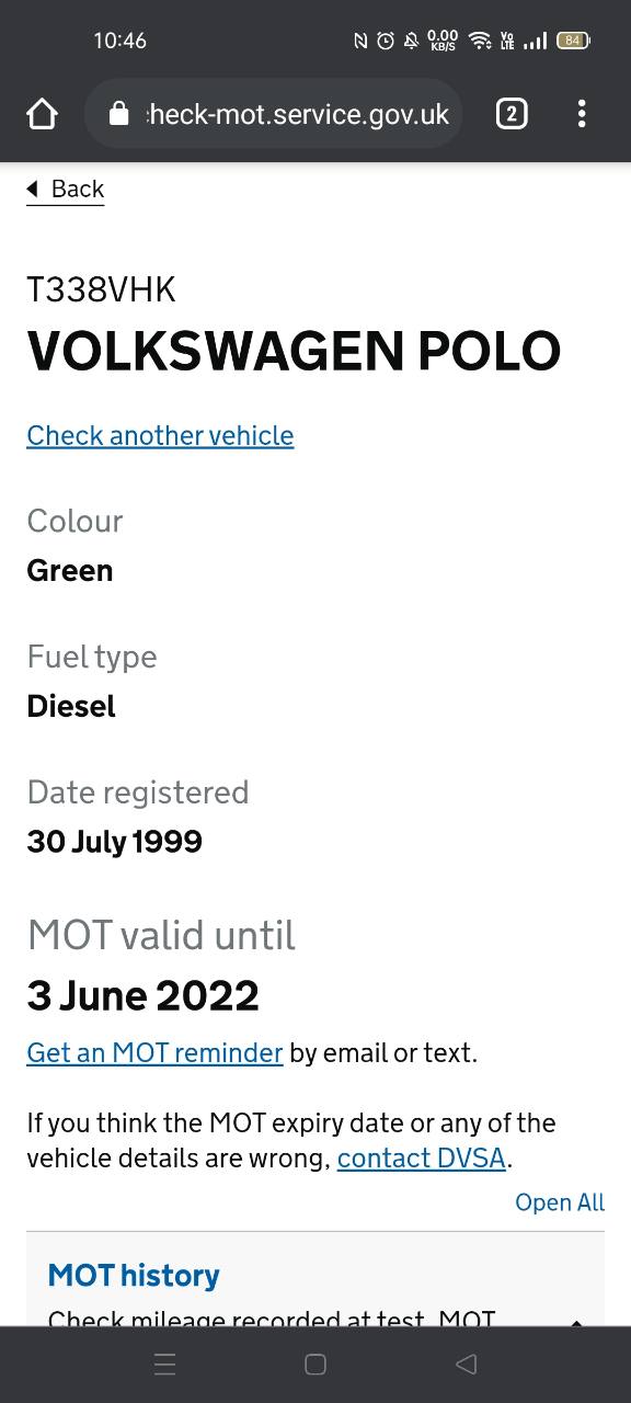

Couple of advisories, but at least I now have the piece of mind that it's got a full ticket.
