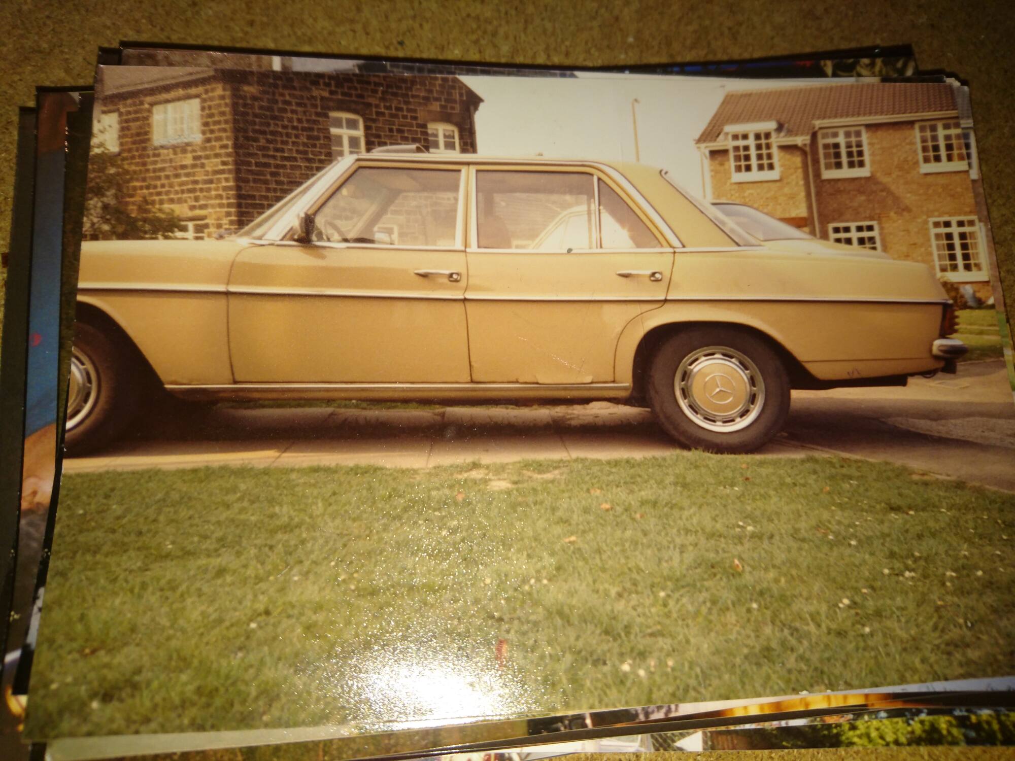

It looks well. I found a pics of ours from back in the day . That's me on the bike. The reg was Q82 WWJ.

They are well put together but do suffer from rust, as most cars of this era did.look at pics above of the beige one, it was probably only 8 or 9 years old in that pic, door bottom already bad.
