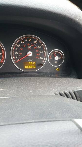

Astra - Still at parents house. Being booked in to local garage (the one I used when I lived there - so I trust them). Shocks all round and investigate EML - Bank 1 running lean.

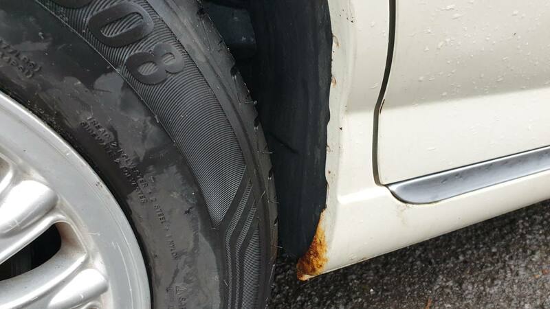

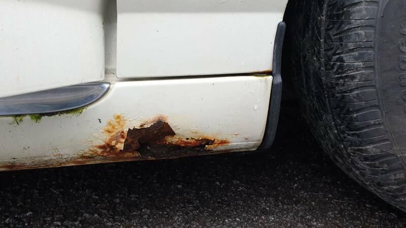

Rover 75 - Given away by Montytom (see his threads) and I am very grateful. Being collected by transport company on Saturday 30th Jan, delivered straight to local welder to repair offside sill.
Today I've ordered a front sill repair section from Tom Hobbs (good rep in R75 community), new jack pad from ebay and two galvanised copy sills (slight over kill but at least the welder will have metal of the correct shape to chop up if needed).

Fixing the Astra - went to parents to sort some probate papers.
Bunged some fuel in and found the petrol cap was very loose.
Tightened it up and EML went out.
Result

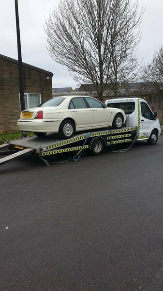

Well today is the day.
In about 20 mins, she gets picked up from @montytom.
No collection thread, as she is being delivered on the back of a truck.
Will post pics when she arrives.

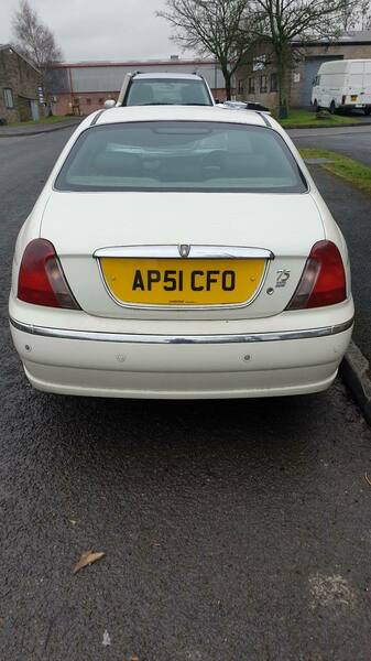

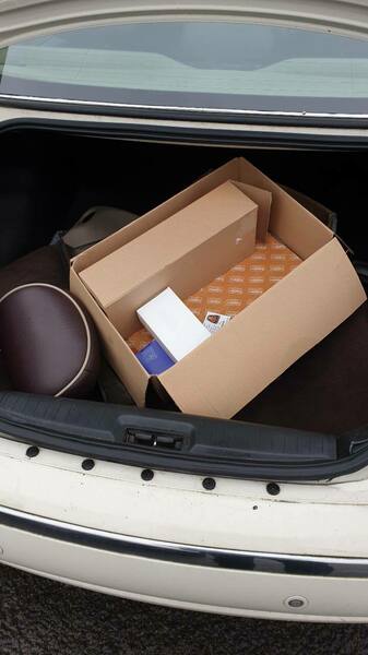

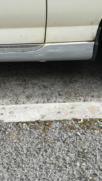

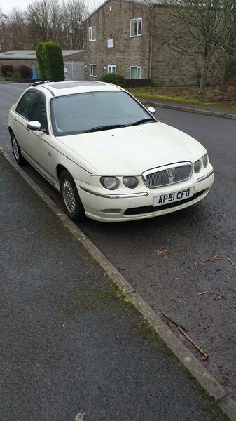

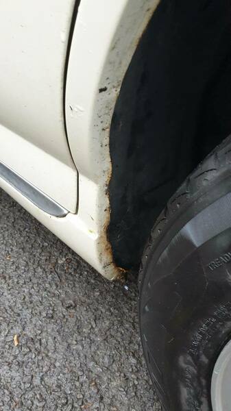

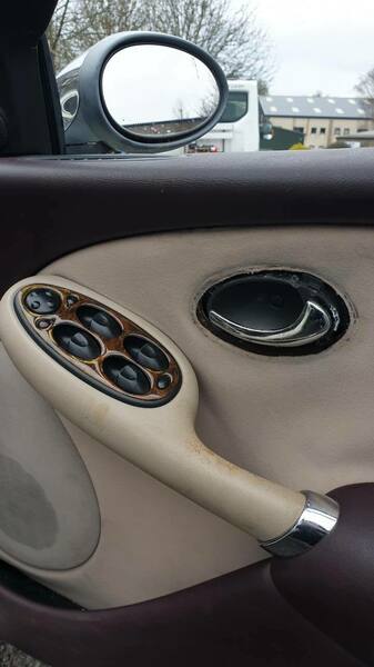

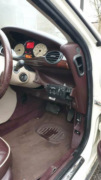

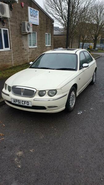

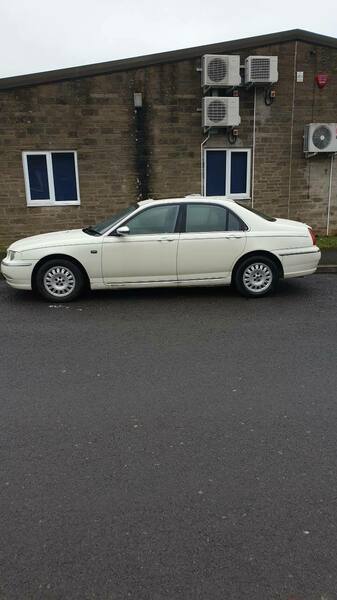

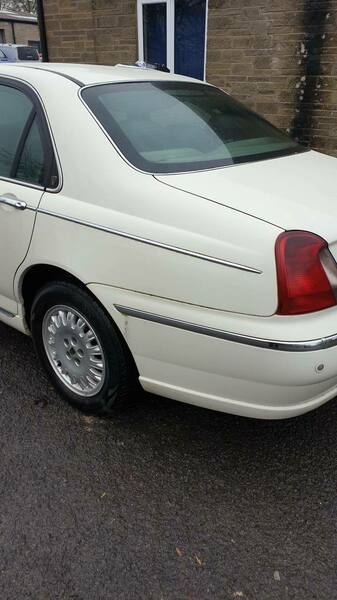

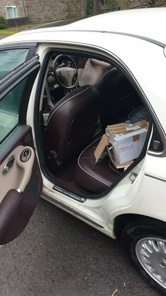

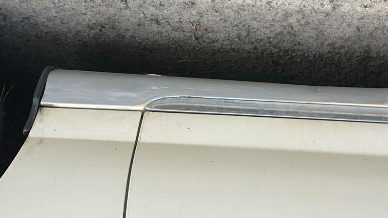

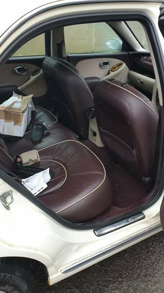

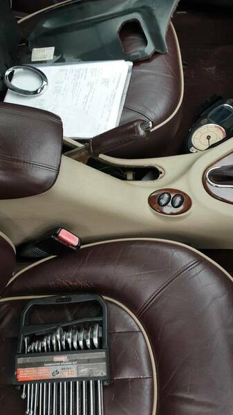

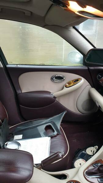

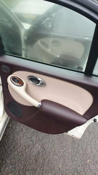

Ok fellow shite ists. Its here.
Airbag / abs light on. As described by monty it makes a bonging noise when driven.
Drives ok. Started up with no problem.
For your delectation and amusement here's some pics.
20210130_120457.thumb.jpg.7a622cc02f6372f909b94e6d78371010.jpg20210130_121246.thumb.jpg.d045ac52cc7acf35b013519c5936267a.jpg20210130_121250.thumb.jpg.05f12483d7430680d09e8e481d5d1dc0.jpg20210130_121254.thumb.jpg.8b001e3f27e0ab35c2fdbf2727c2311a.jpg20210130_121258.thumb.jpg.82214533d03c802cfcf16e054e66c8d3.jpg20210130_121307.thumb.jpg.bb5acfe42ae5a0173e031a5c7a32273b.jpg
20210130_121310.thumb.jpg.1cd5b9126743af279e54c12e391622ba.jpg20210130_121326.thumb.jpg.9776a66ef3a623e4642980c273111002.jpg20210130_121343.thumb.jpg.673d9025285f10d002cab51726ac3c8b.jpg20210130_121345.thumb.jpg.fbe99f36dbefe029a7408a71c83fe00e.jpg
20210130_121350.thumb.jpg.4ad3f420e7cb31443b141922f5d594ff.jpg20210130_121402.thumb.jpg.5312c1b0981cdac48e34c15a35290320.jpg20210130_121410.thumb.jpg.c084d52ce957cf70440e29b3bbfb1652.jpg20210130_121415.thumb.jpg.dcb09ea19cbb1c93ff17688fdb4e4aea.jpg20210130_123255.thumb.jpg.68ca95c3e95e3463bce1ff565fa24111.jpg20210130_123301.thumb.jpg.5e47a469b94da94148ea378bb2decc81.jpg20210130_123313.thumb.jpg.cc8e65e335d001220549159b990b181c.jpg20210130_123325.thumb.jpg.94e7011db503dd0a3a1c0696d3064465.jpg20210130_123334.thumb.jpg.9576b96e0536fb92c63519a99b3fa65b.jpg

It doesn't matter about the binging! It is a wonderful looking car. I hope Parrot gives it the care it deserves 😅😅
Great looking thing. Wonder if this was part of a Japanese order that wasn’t delivered (I seem to remember this sort of colour combo was part of the order in around 2001 ish) fairly unusual to have a sunroof too. Great to see it get sorted.
Are they xenon headlights? Odd as I can’t see the washers in the bumper.
Halogen projectors I believe. You are right, if zenon would have the washers.

I don't think it's a Japanese order as the Crown wheels would have had decorative dimples between the bolt holes.

Quick R75 update. Its finally on the ramp at the fabricators. Its been in a queue since delivery last Saturday week.
Slight glitch. No locking wheel nut can be found, so the existing ones are being removed in a very careful* way. Been told that damage to alloys is a possibility :(
At least its on the ramp.

Rover 75 - welding done. New front offside sill. Primered ready for a bit of paint.
