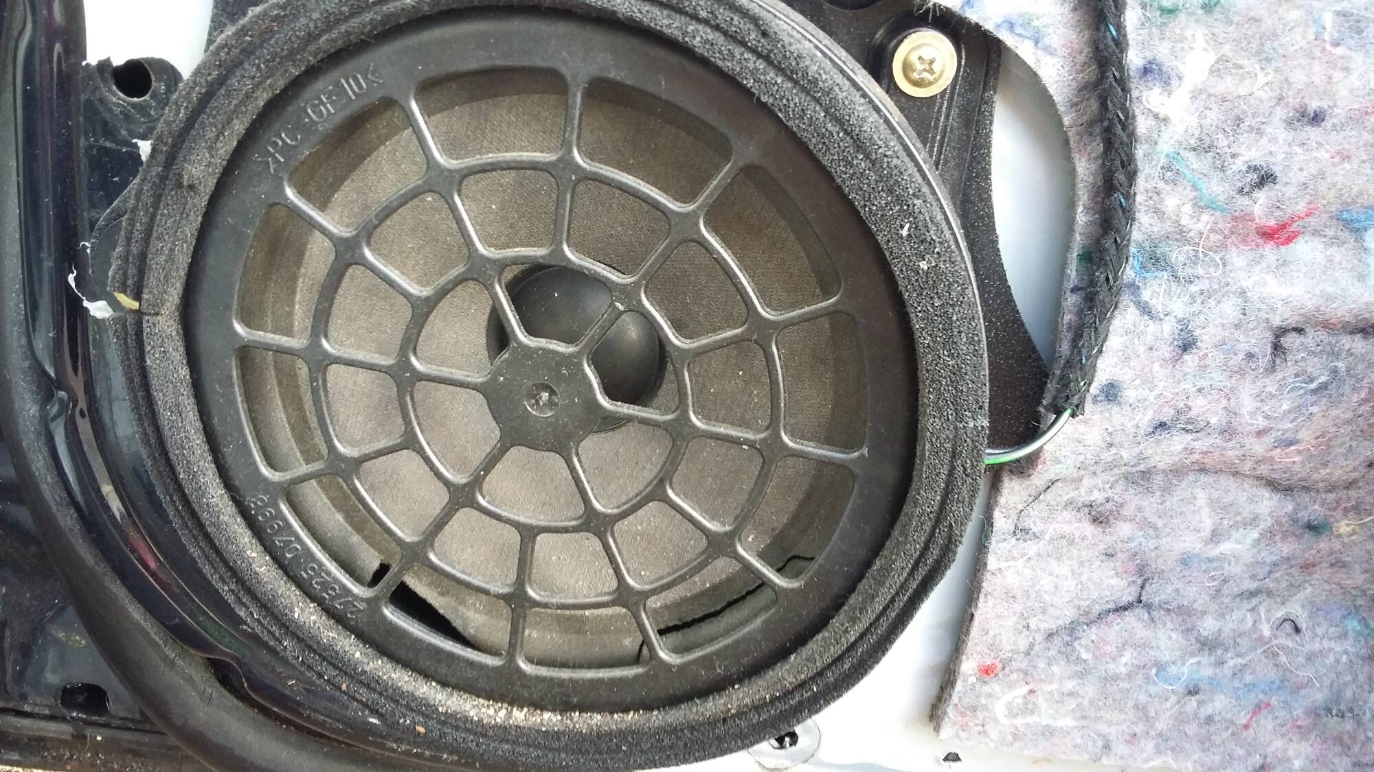

I was unimpressed by the factory audio, despite it having a fancy remote control.  Putting in my kit was easy though, standard ISO harness so took about 5 mins!
Unfortunately the speakers are shot, ruining Stuff Like That.  The forum bike Jag had the same issue, just age I suppose.  I've got speaker adaptors on order so I can fit some decent ones.
