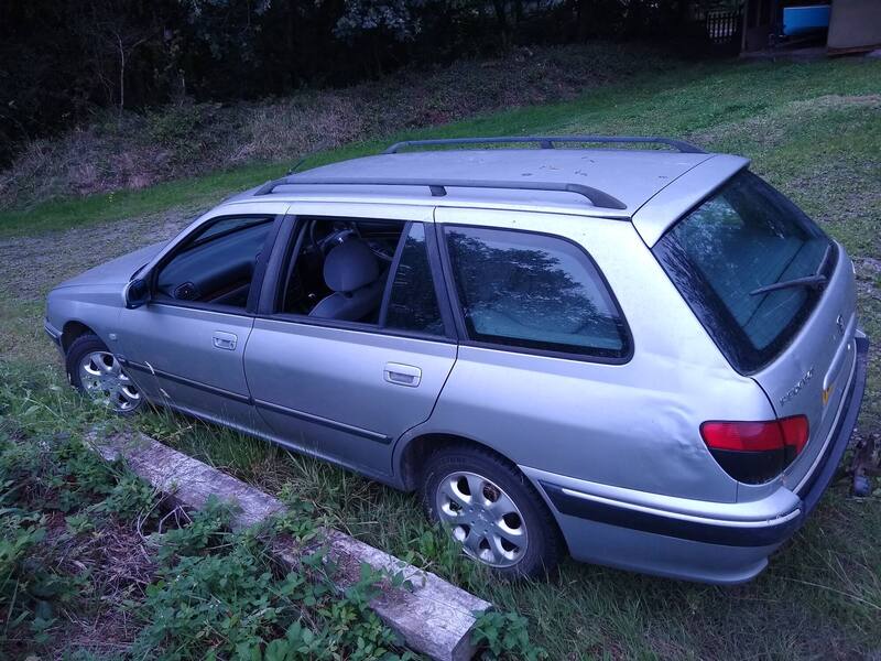

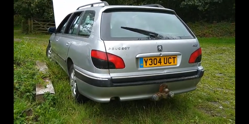

JWG Posted August 8, 2019 Share Posted August 8, 2019 Hello, this is my first post here although I've read the forums there from time to time. I'm not certain about what I'm going to do with this vehicle yet but without further ado; This is a Peugeot 406 which has been, literally and figuratively, outstanding in its field. It was a family car my dad bought well over ten years ago and used every day for an A/B road country commute into a the nearest large city almost fifty miles distant - he replaced his previous 405 with it, that having accrued over 200k miles. It lived a frugal and reliable life in Devon, went on holidays through France and Spain and was handed down to my mum for dog carrying and plant purchasing duties. After the clutch started to slip (slightly) in about 2016 mum decided she didn't want to drive it anymore and it was dumped and handed down to me to get rid of. I decided to pick it up as I remembered it's delightfully wafty comfort. I drove it around for a year after the mammoth DIY task of removing the gearbox and replacing the clutch, input bush thing, release bearing and driveshaft oil seals. I replaced the strange multi link arms on the rear suspension and had a full four wheel alignment carried out, replacing the four tyres at the same time with all season Bridgestones. The 406s are famous for bad rear tyre wear on the inner edges and I was happy to have cured this and reset the handing to 'surprisingly good'. After the year of anonymous silver estating, many tip runs with trailers full of rubbish, working on the house and picking up a huge hearthstone I parked the 406 up in a barn. I'd subsequently backed it into a rhododendron bush and a Dartmoor granite gatepost and my brother had handbrake turned it into a civic Vti in a rare moment of ill judged thuggery. In all honesty it looked rough and I was embarrassed to drive it. It shed it's modest private plate, returning to a Y registration and curled up in a concrete barn. It's a long way from civilization here, and after the fields are cut and baled, mid to late summer, I get the jump leads out and transfuse some agricultural electrons from the tractor into it's vital veins. I scrape the dried latte owl dung from the windscreen and the 406 lives again on verdant grass highways as a field car. It's rusted somewhat now, the rear subframe needs welding and all the calipers and discs most likely need replacing but the beating hdi heart is smooth. Any rational person would weigh it in, bank the pounds and pence and move on, but I can't help thinking that it's not done just yet. davehedgehog31, Dan302, privatewire and 15 others 18 Link to comment Share on other sites More sharing options...

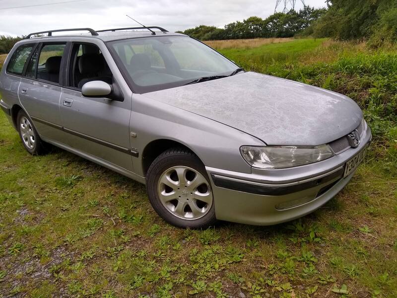

JWG Posted August 8, 2019 Author Share Posted August 8, 2019 Thanks both, here's a quick walk around from earlier. Im liking the smoothness of the hdi compared to my current VW PD engine. Jim Bell, 500tops, BlankFrank and 1 other 4 Link to comment Share on other sites More sharing options...

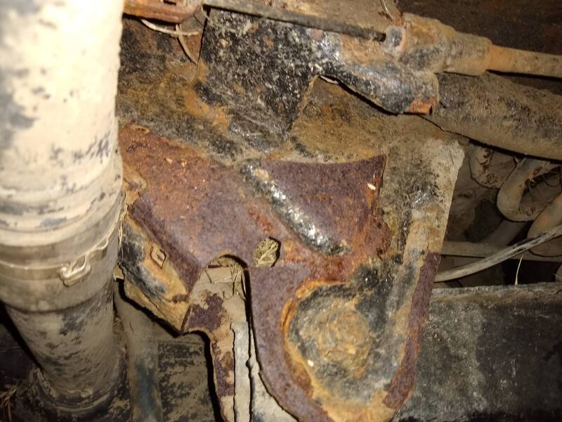

TooManyPeopleMovers Posted August 10, 2019 Share Posted August 10, 2019 7 hours ago, JWG said: Thanks for that, will keep this up to date with some progress and hopefully this thread will help motivate me to do some work on it! I'm planning to drop the rear subframe and disassemble the rear suspension to tackle the grot and then to look into the brakes. The grot is mostly confined to the rear subframe I believe. The rear brakes on these are a bit weird in that the handbrake operates a set of shoes inside the discs via cables whilst the regular calipers are used for the actual braking, this system goes wrong lots and most of it needs replacing by now. There's also a CV joint to sort. No cruise on this one despite the extra column stalk which is there to adjust the radio settings. As you say still a good looking car, I particularly like the front headlights/grille/bonnet area. Is the rear subframe particularly difficult to remove? I think I've heard of that hand braking system on other cars too! I'm fairly certain our Honda CR-V Mk2 has it....or at least, a couple of years ago our mechanic charged us for the repair of the handbrake drums after we drove out to the airport, and back, a journey of around 30 kilometres, with the handbrake on one "click"....and cooked the handbrake I was not driving (Or in the car) at the time. The handbrake light was, and still is, functional. I did see that stalk! It's definitely an appealing feature - I can't think of many mid-late 1990's cars that had audio controls off the steering wheel - pretty advanced for its time. Looking forward to future updates and nice photographs! Craig. Link to comment Share on other sites More sharing options...

Lord Sterling Posted August 10, 2019 Share Posted August 10, 2019 Looking great. I really like these late 406s. Fatha_Sterling used to use some regularly from the car hire place he worked at briefly yeara ago so I remember these when they were new. Subframe just looks like its got a load of surface rust which could be cleaned a sprayed over with some rust protection coating unless I'm not looking hard enough. Yep, that 406 has quite a few years left in it I reckon. Link to comment Share on other sites More sharing options...

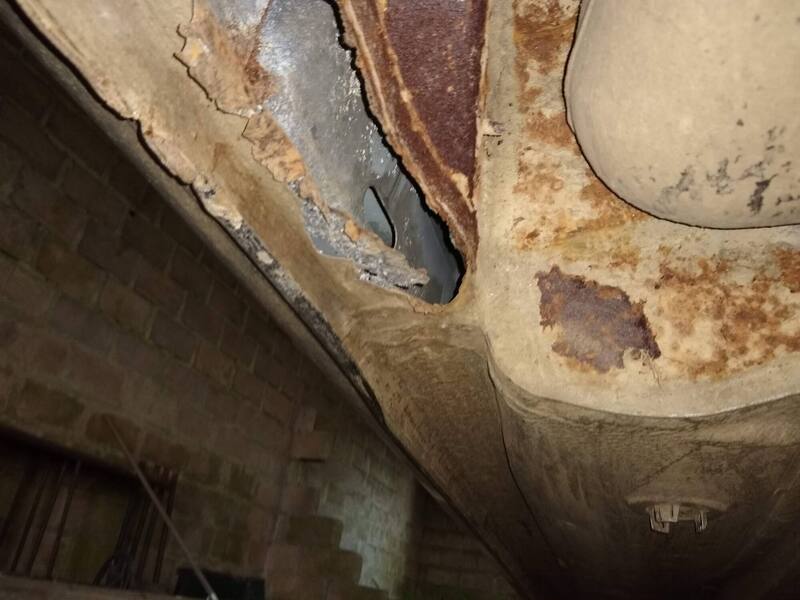

JWG Posted September 7, 2019 Author Share Posted September 7, 2019 Oh dear, more grot than I expected! ( Rear left sill in front of the suspension) davehedgehog31 1 Link to comment Share on other sites More sharing options...
JWG Posted September 7, 2019 Author Share Posted September 7, 2019 Would anyone interested in this as a fixer-upper, bearing in mind that it needs at least 4 calipers /discs/pads probably brake pipes subframe is very crusty and it needs a bunch of welding ? (Sales pitch of the year !) Link to comment Share on other sites More sharing options...
