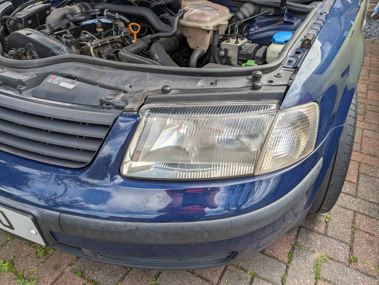

Headlight cataracts removed again.

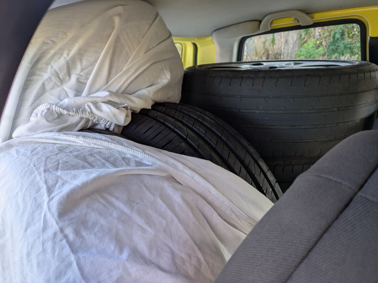

Fitting all the Passat's wheels/tyres, and four new tyres in the Lupo was a challenge, but we managed it somehow

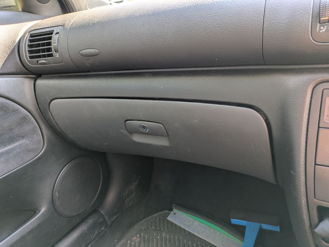

In slightly less good news, the glovebox I bought off eBay ages ago is not only the wrong colour
but also has a faulty latch on one side so it doesn't close properly. No way in to fix it as the inner and outer parts are plastic welded together.
The biggest problem I seem to face with this car is the plastics are getting brittle, this is the third glovebox now as the handles break off, when I removed the glovebox this time part of the support structure broke off the dashboard so I had to reconstruct it using epoxy. Various other bits of trim have broken inside the car and the options are 2nd hand/equally old or Chinese repop that doesn't fit, or is designed for LHD so doesn't work.
