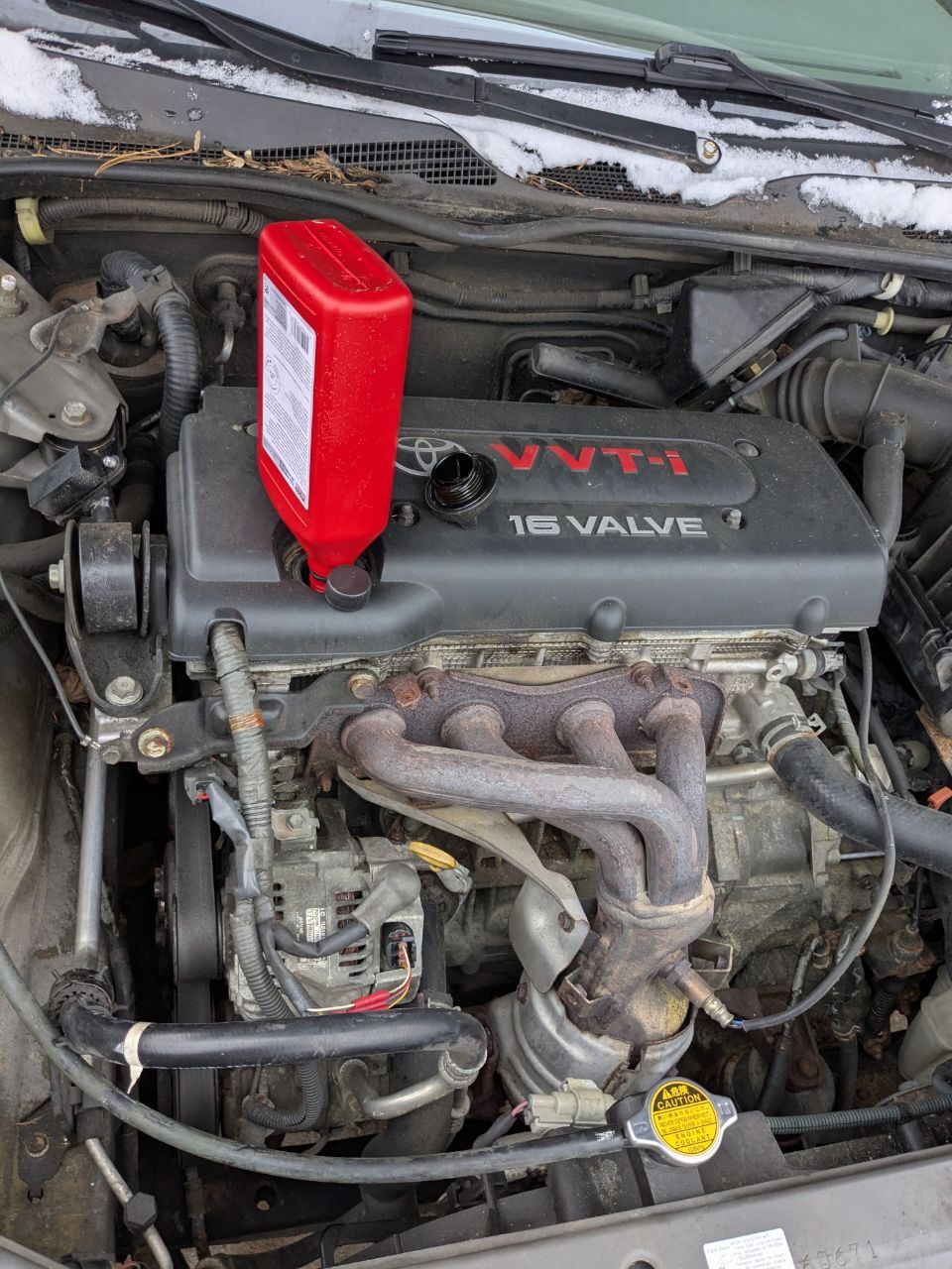

While driving to the DIY store the oil pressure light flickered every time I pulled away from the lights or a junction. I pulled the dipstick and found there was no oil on it. I took the emergency quart out of the back seat and dumped it in the engine. I checked again, still nothing. Uh oh. 3 quarts later (the engine takes 4 quarts/1 gallon, all US measures) and it's showing nearly full again. In summary, the engine almost lost/ate all of its oil. Fantastic.
Meanwhile I was wanting to see which accessory had the grinding noise/whine. After watching some videos on YouTube it looked like releasing the belt tension would be easy enough. Expectation:
Reality:
19mm tensioner hex rounds over completely with a 19mm socket. Bloody brilliant.
I am now very cold and very fed up.
I'm going to book it in with Toyota tomorrow and they can look the entire vehicle over. It's too damn cold to stay out there for any period of time and it's only going to get worse, especially with more snow on the way. Our local dealership is pretty good and the service advisor is a family member, which helps.

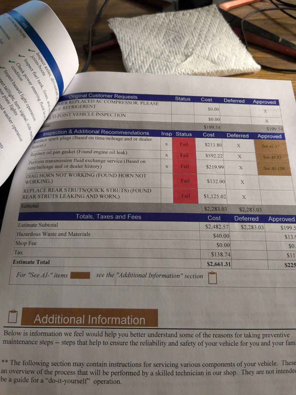

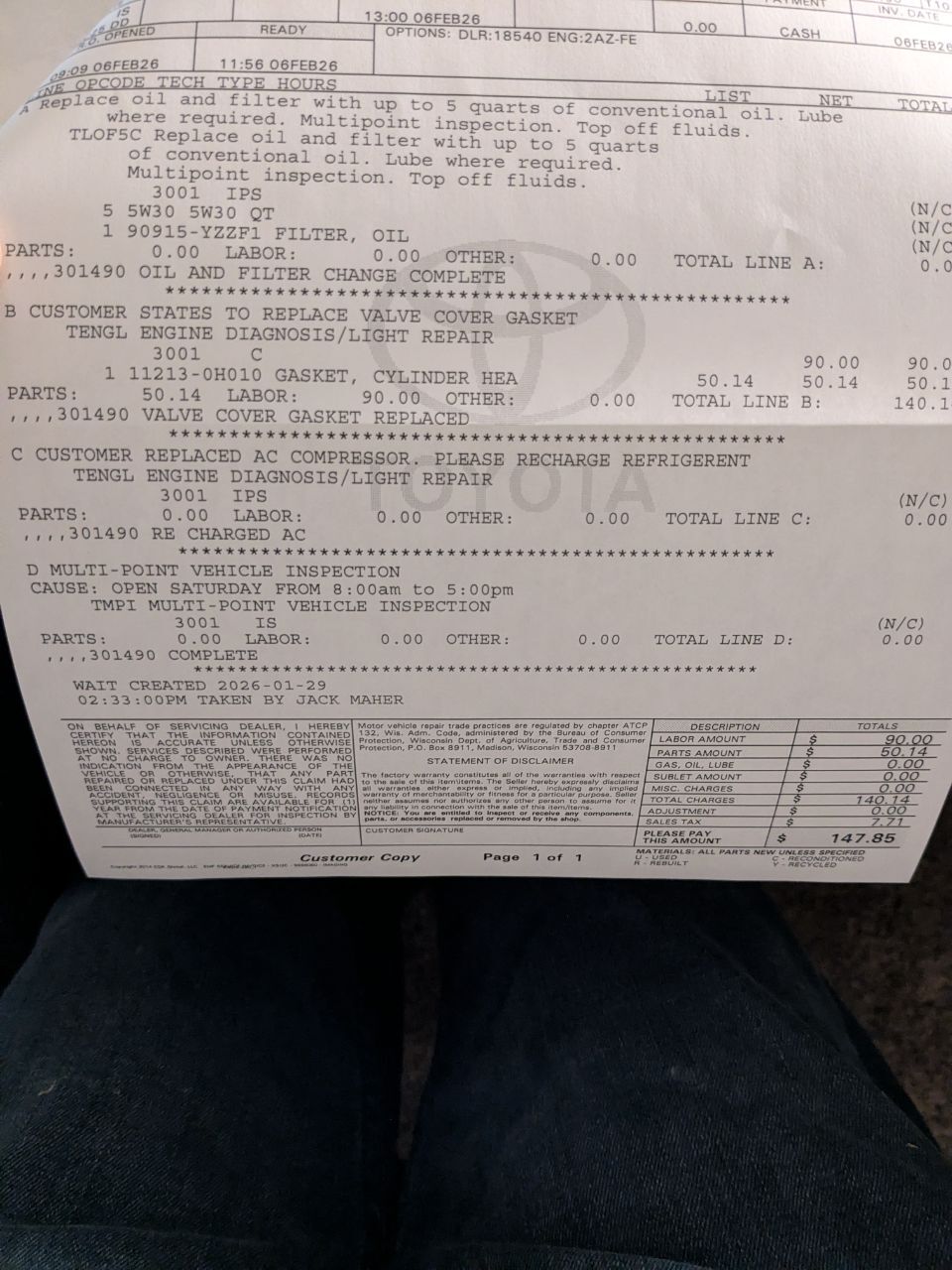

I threw the Camry at Toyota and got them to do a multi-point inspection. The aim: diagnose the clunk in the rear and the coffee grinder noise up front. They found the following:
  • Registration lamps dead,
  • Engine oil leaks,
  • Transmission oil leaks,
  • Accessory belt old and cracked,
  • Coolant looks like shit,
  • Air filter dirty,
  • Horn not working,
  • Water pump is the source of the noise. We'll get back to that one.
I was then handed a nice printed report sheet containing this info, generic reasons why each fault should be fixed and an eye-watering cost breakdown-
"Oh cock", I said. $69 just to fix the plate lights alone?!
There was no mention of any issue with the rear end. Instead, the rear shocks and suspension components received a "pass". There was no mention of the SRS light either. I thought they hooked a scan tool up? I pressed the advisor (who's a family member) to explain and he said the technician looked and there wasn't anything obvious. They did complement how nice everything looked, mind you. I can't remember the explanation as to why the SRS light wasn't noted but when I mentioned it, Jack The Advisor put it and the horn problem together and said it's likely a faulty clock spring in the steering wheel. Clock springs are also expensive AF, one from Dorman is $320. Since this was a general, multi-point inspection the clunk, fluid leaks and the horn/airbag fault would be subject to a separate diagnosis I'd need to pay for. As for the P0136 code, they recently had a similar Camry come in with the same issue and the battery was equally ruined. They put a new battery in, cleared the code and nothing has come back since. We're hoping for the same situation here.

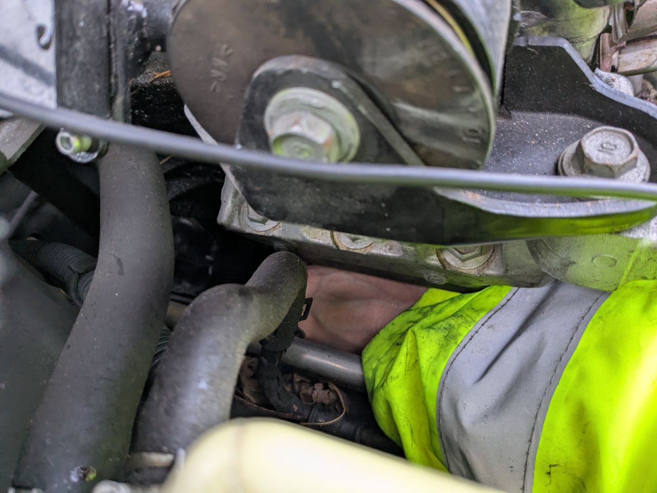

I'll preface this whole saga by saying the front end of this car was designed to go together easily, not come apart. I wish, in the nicest possible way, for the committee responsible for engineering this to take a long walk off a short pier.
After enough motivation (I watched a bunch of YouTube videos showing how simple* it is) I coughed up $90 for a water pump, ventured outside and drained the coolant. Most of it went straight on the ground instead of the bucket. It was also green instead of red, and not much came out. Great start. Next up was fighting, once again, with the blesséd tensioner. By this point the "dummy nut" was barely hex shaped at all, but seeing the cost of them I decided to keep on fighting. I eventually won, using a 1/2" ratchet, conduit and a breaker bar as a lever
PXL_20251210_225637035.jpg.a5bcb144e7d5fd7e2b38339fff695624.jpg PXL_20251210_225644856_MP.jpg.d6ff8f3b3059596f41be9691d186c7a1.jpg

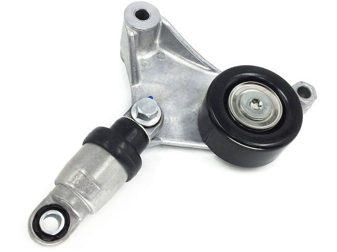

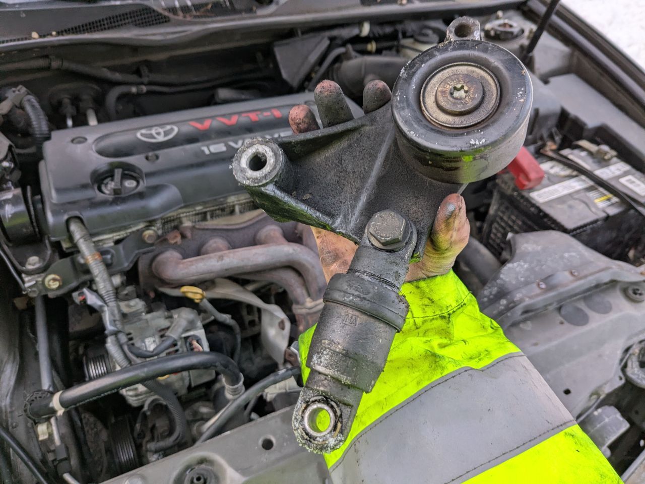

Let me take a moment to explain how evil this engine bay is. Most manufacturers use a spring on a pivot. Toyota, for whatever reason, doesn't. They use this peculiar hydraulic assisted spring shock absorber thing...
Accessory Belt Tensioner - Compatible with 2002 - 2006 Toyota Camry 2.4L  4-Cylinder 2003 2004 2005 - Walmart.com
...with a bracket made of soft, spreadable butter, leading to this:
Or worse, this!
Broken Tensioner Belt bolt : r/CarRepair
Luckily I was spared the pleasure of this happening. The same can't be said for dozens of others, however. This is an incredibly common issue.
Additionally, there is almost 3" of room between the side of the engine and the wheel arch. Everybody in YouTubeland uses a breaker bar, but evidently they use one with a tiny swivel because mine, with a regular size socket attached, interferes with car body and A/C plumbing. Said plumbing also gets in the way of the breaker bar's swing when you're close to releasing all tension. Once you invent enough new swear words, the tensioner grants you the ability to roll the belt off the alternator pulley. Incidentally, you have to maintain a lot of pressure on the bar while rolling the belt off, otherwise you're at square 1. Do not pass go, do not collect your £200. Not even my old 850 was this bad.
With the tensioner fight over I could then tuck the belt away, dismount the alternator and undo the water pump. To be honest, removing it was fairly easy (relatively speaking), except I had to take my gloves off in order to have any kind of dexterity.
Four 10mm bolts and two 10mm nuts later, it was off and more green coolant promptly fell on the floor.
PXL_20251211_005513620.jpg.d28a9c86ce97411b92d337f415aafeea.jpgPXL_20251211_010700406.jpg.f85adf044c44a930e77561f2c2a814c1.jpg
I'm not too sure why but the old pump was glued on with RTV. All the new pumps I found for sale came with paper gaskets. However, this did prove it had been replaced at least once before. Rather curiously, it didn't sound all that gravel-y when I spun it by hand. After cleaning the gasket surface with a green Scotch pad, I carefully folded the new water pump into position and began tightening everything up. Toyota was kind enough to provide two studs to hang everything on to make installation just a little easier.
I would like to say installation was as easy as removal, but alas, no. I think I dropped the 10mm socket 4 or 5 times. The first few times I dropped it, I was lucky; it fell straight down and hit the ground. The bottom two bolts were the most difficult pair. The forward one isn't bad at all as it's rather open. On the other hand, the rear bolt has a rib in the casting right next to it, meaning I had to move my ratchet in strange ways to get it tightened up.
Then I dropped it.
The ratchet and extension buried themselves between the subframe and arch liner, while the socket broke free and lodged itself between the engine and the subframe. Those 10mm sockets, man. Cue lots of panicked crawling about in the slush and ice trying to find it. With my hands now frozen solid, I mustered up enough energy to carefully  finish bolting the pump down, install the pulley, reinstall the alternator (that was fun*) and prepare myself for re-tensioning the belt. I went back inside to warm up and eat dinner.
To further explain how evil the engine bay is, the 2AZ-FE belt layout is below, with the 850's layout for comparison:
2004 Toyota Camry Serpentine Belt Routing and Timing Belt DiagramsVolvo 850 drive belt routing • Volvotips
Note the 850 engine's convenient placement of the tensioner, PAS pump and belt routing. Having messed with the belt, tensioner and PAS pump on an 850, I can say it's not very bad, though the alternator location is inconvenient for replacement purposes. Swedish engine design for the win. I can't tell you how long I spent just trying to lay the belt in position (with one hand wedged between the engine and body) so I could loop it over the alternator. With how little clearence there is between the accessories and the wheelarch, movement is wished for, not guaranteed. While I was dealing with the water pump the belt flopped out of the power steering and A/C pulleys. One would reasonably expect there to be room to guide the belt around the power steering pulley, but there isn't. The back of the engine bay is just as cramped as the side. Direct access from the top is impossible because of the top engine mount, then power steering hoses just above the pulley. I'd have to break my arm in 3 places to reach in that way. At least the A/C pulley was relatively simple to deal with.
I reckon I spent more time faffing with the sodding belt than I did replacing the water pump itself. It was about 8:00 by this time and the only light I had was from my phone and a streetlight. As it happened, my husband came out to see how I was doing, so I asked him to hold the phone while I made one final push to get the belt aligned and instal-
*clonk*
Bugger. The hex is now completely round.

Easier, more like less difficult, and only slightly. The tensioner bracket went in first. Without the spring installed, it made folding it into place a lot a easier. Of course, since the bolt had to be put through the bracket first, getting it into position was still a struggle, especially as there's no clearance to do it from underneath. Then threading the bolt back in was a massive effort. See also- unbolting the old tensioner. The bolt is fine thread so the slightest amount of cockeyedness will make it bind up, which happens often since you have to crush your hand into a stupid shape to reach in there. After I got it finger tight I then finished it off with a spanner, turning it one flat at a time. I believe there is a torque spec for that bolt, but I'd love for any Toyota engineer to tell me how the ever living fuck I'm supposed to use a torque wrench on it, without pulling the engine. With that struggle over, I then put the 'spring' back on. Despite only being two bolts, it was just as aggravating as everything else thus far. The bolthole on the tensioner for the spring is juuuust above the opening in the wheelarch with, surprise surprise, no clearance. Back to using spanners again.

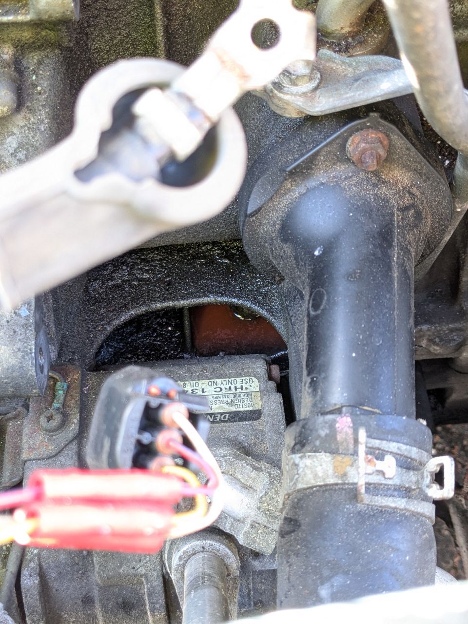

So The Man From Toyota, He Say:
"It's not the alternator I'm afraid, your A/C compressor is totally fucking fucked, m8. Big time" and proceeded to show me. Lo and behold, there are metal filings and shrapnel stuck to the magnetic clutch. The smoking gun was the noise would shut up when the compressor engaged. An OEM part would cost north of $600. Aftermarket parts were anywhere from $230 to $400, bad product reviews included. The book time for the job is around 3.5 hours. In total that work would cost me $1150. Oh dear.
After being given the quote I told advisor Jack I'd make some phone calls and give him a decision in a couple minutes. He said that was no problem, so I called my friend in Kentucky (who facilitated purchasing the car), and explained the issue. He contacted the PO and then told me I'll have a known-good, used A/C compressor waiting for me, when I fly down next week, for free. Smashing. The previous owner, being a mechanic himself, went on to explain a large part of the book time is down to evacuating and recharging the A/C system. Actually changing the part is no worse, if not easier, than any of the other work I have done, and it doesn't take much time. Well that's not too bad I guess. Here's hoping for warmer weather in a week's time.
Jack was very embarrassed and apologetic for the misdiagnosis and subsequent frustration. He offered compensation and we came to an agreement. It looks like I'll be getting a free oil change and an AC tune up once I'm done with work for the year. The diagnostic session today was also FOC.

Happy new year everyone.
I can't really remember what happened last post, but I believe things were looking on the up with some free parts to finally end my wailing and gnashing of teeth.
While I'd like to say everything went smoothly and the problems all went away and we all lived happily ever after, they sort of didn't. Shocking, I know. Firstly, scheduling changes meant my work was delayed, so I didn't pick up my free alternator and A/C compressor until early January, when my friends came up to visit. I drove them around my corner of the state for a few days and by the end of it, the compressor pully had enough of life and (what was left of) the bearing exploded. When I got around to looking at the 'new' parts, the alternator was fine but the compressor was full of water, seized up and the pulley would rumble when spun. Some questions later and I learned the compressor had been open to the elements for around a year. This was slightly* aggravating, but y'know, free parts etc. etc. Around this time I also noticed I had to keep topping the coolant off and I couldn't see any obvious leak, which just added to the general mood.
Fortunately, some more jobs had come my way so I spent two weeks down in Kentucky doing those. Unfortunately, as soon as we got down there, forecasters had started predicting the great winter snowmageddon for the end of that week and the entirety of the South basically shut down for half of my stay. Happily though, I was able to order a brand new compressor and it was dispatched from a warehouse in the north of the country, so it avoided all the weather delays everywhere south of central Indiana. I might have to write about my southern snow experiences at some point because it was a really hilarious and equally infuriating shit show.
So I get home and remove the accessory belt (and for the first time ever it was easy and took 10 seconds) and the old alternator. Really boring stuff, didn't photograph, however, look at what it exposed-
Hello, coolant. I wonder where you came from?
I put this to the back of my mind since I still needed to remove the compressor. It went well-ish
After totally not venting the refrigerant into the atmosphere, I was able to undo one hose just fine but the other was basically corroded to the stud. This must be a common issue because the new one uses bolts instead. Anyway, after unbolting the compressor and using a hammer, everything finally separated. Also note all the metal dust on the right side of the picture. All of that used to be a bearing.
After extracting the compressor I could finally look at the damage. It's crazy. Hopefully these pictures show how bad it got:
PXL_20260202_225450502.jpg.b949b362d1f530cb67651b48907cf176.jpgPXL_20260203_202402594_MP.jpg.42c4b858ae0c301a0708311da777c16f.jpgPXL_20260203_202406582.jpg.3659e5b8bdbd0cc9d87394b66fdfc74e.jpg
There was just no bearing surface left. It was all gone. After the bearing detonated, the pulley got so hot it shrunk the labels and melted the plugs. Had the clutch not been there the pulley would have fallen off.
Now I could turn my attention to this coolant puddle. I figured that the only place it could have leaked from was the thermostat neck, so after draining* the coolant (*spilling most of it on the floor) I took the neck off and removed the 'stat. This is what I found:
BOO-YAH! I'm pretty sure this is my smoking gun. After putting a new 'stat and gasket in, I bolted all the cooling stuff back together, refilled the radiator and got on with reassembly.
New O-rings were put on the AC hoses of course. Rather surprisingly, putting everything back together wasn't all that difficult and I had it all back together again within an hour, so I was pleased. I originally didn't notice the belt wasn't fully over the water pump, however it aligned itself just fine after cranking the engine over. Boy, it's so nice having a quiet engine bay. It makes driving much more pleasant.
So, now what? What's left to fix? Well at the moment, not much else, really. Assuming the coolant leak has been rectified, there are oil leaks to fix, the screwed up back suspension (I am fairly confident it's shock absorbers) and the steering wheel clock spring to replace. On Friday it's going to Toyota to get the rocker cover gasket replaced (since it's leaking on every side), get an oil change and have the air con recharged. We'll see how long the engine stays full this time. Aside from vacuuming the interior out after salt season is over, I don't think there's much else to take care of.

OK, so Toyota did some work on the vehicle, here are some pictures of the report I received:
In summary, they charged the air conditioning, performed an oil change and changed the rocker cover gasket, all for $148. In the words of Hubert H. Humphrey, "I'M PLEASED AS PUNCH!" For the first time since buying it, the car is very civil to drive with every accessory functioning like it should.
This isn't the end, however. As noted on the invoice the cause of the Sloppy Rear End™ is down to blown out rear struts, so that clears that up. My service advisor told me aftermarket is basically the only option because ordering OEM parts on their end is complicated and very expensive, plus they aren't much better than aftermarket parts. That's fine, I can replace them in the summer.
Additionally the sump gasket leaks, but not nearly as badly as the rocker cover. Since all I wanted was the leaks slowed down, I'm happy for the time being. I've been told I'll need to jack up the engine so I can drop the sump and change the gasket. I'll monitor my oil loss and see if it's worth doing. The engine definitely burns a little oil, but I don't mind.
For some strange reason, they are very keen to change the transmission fluid and replace the pan gasket. I'm not so sure because I know of several instances where high mileage transmissions had fluid changes and they then turn into a box of neutrals. The theory is so much clutch material gets into the oil that, when it gets replaced, the transmission slips into oblivion. The spark plugs are also due for a change and I already knew about it, but I've just been too lazy to deal with it.
Lastly, I need to get a clock spring for the steering wheel. The horn doesn't work and neither do the air bags. Fortunately, one of my friends recently bought a scrap Camry from the same year and I've been given carte blanche to rob it of any parts I need, so hopefully something can be done there.
