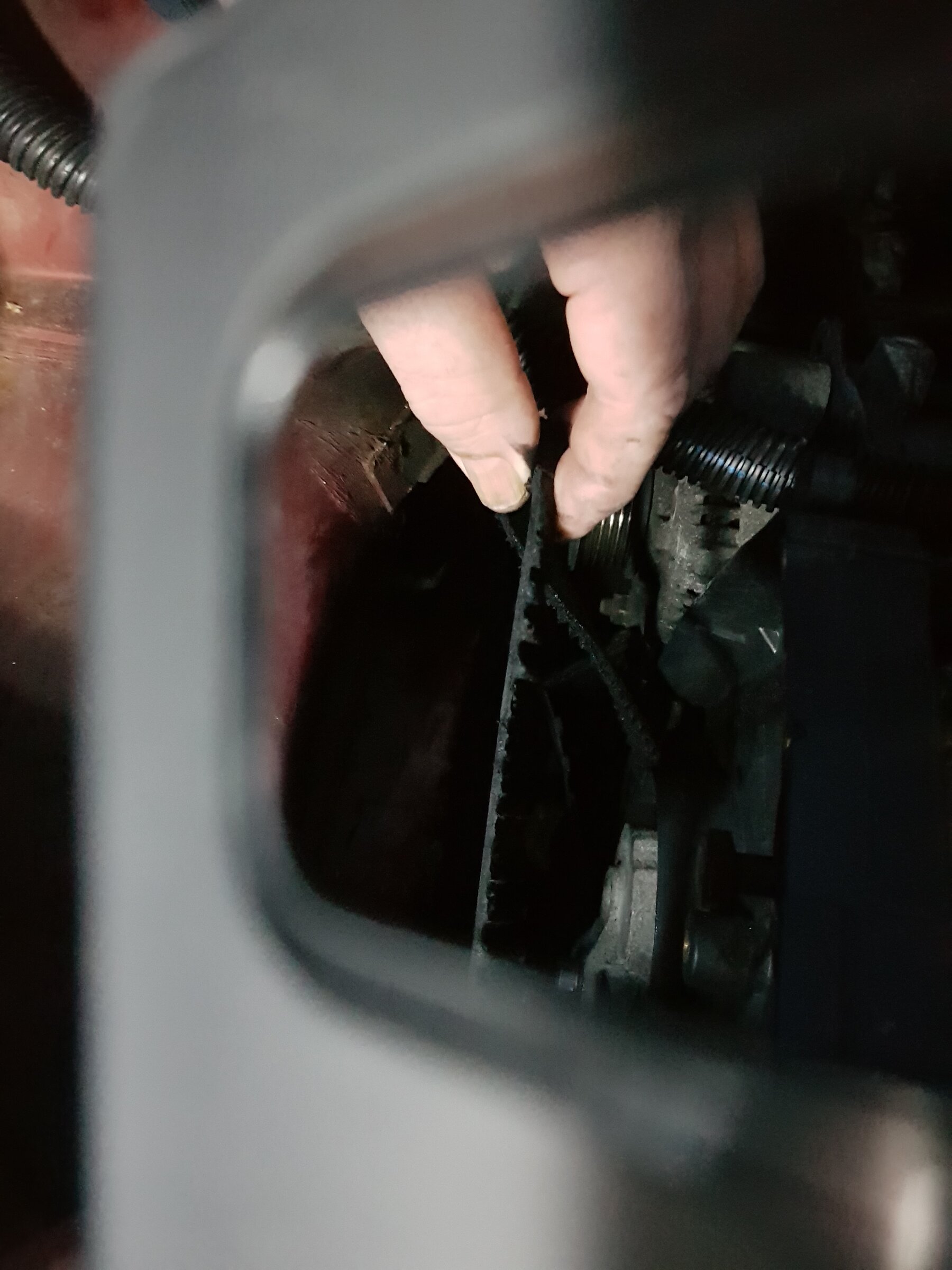

Me working nights has stopped me doing anything due to very long hours at work.
My dad woke me up and said you had better come and have a look at your car.
He showed me the cambelt and said you were very lucky that it didnt go due to it not having hardly any teeth left. (its a non interferance engine)

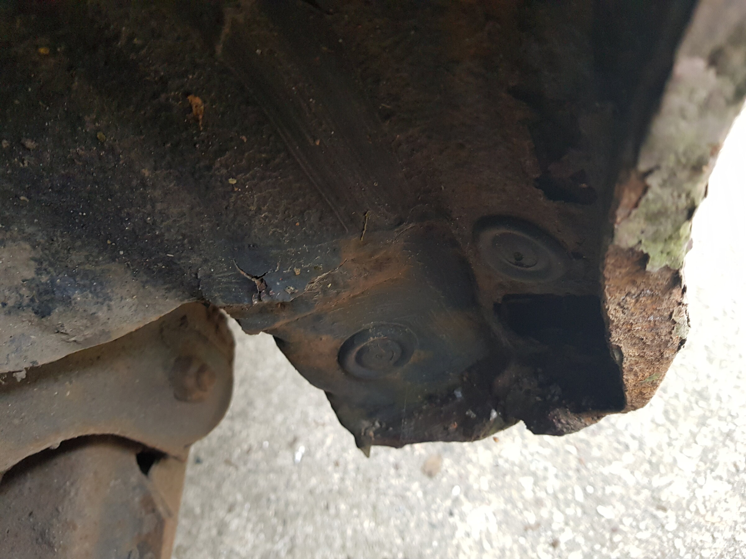

The car is now in bits and he has taken friday off from work to get it all sorted for me. We had a look underneath the car and its very rusty( which we knew)
There are a couple of big holes in the inner rear arches and alot of underpaint peeling so we have got some stonechip and after rubbing down will paint.

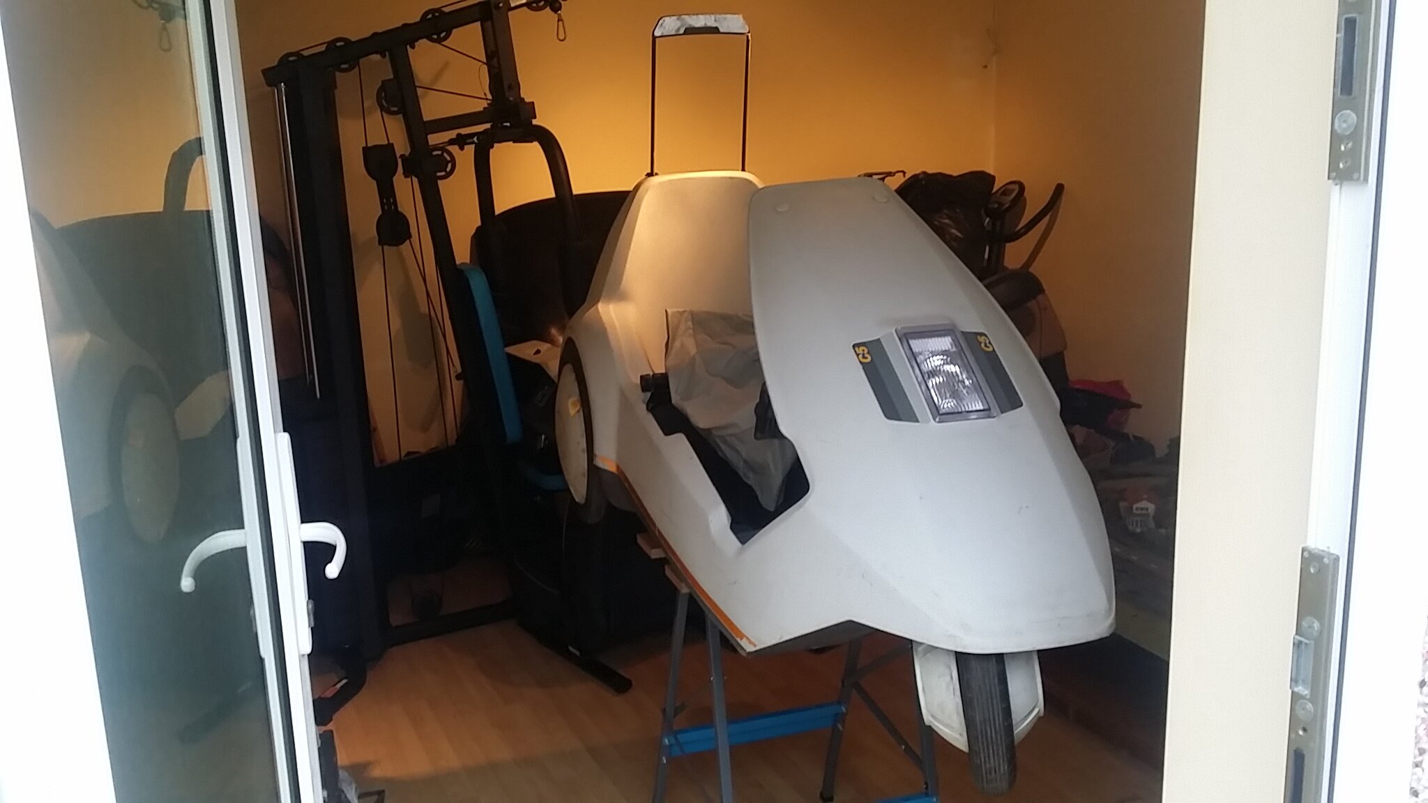

Also I can fit my sinclair C5 in once i complete that.

Saved just in time looking at that belt! I take it the C5 fits in the back? I would love to see the C5 at some point as I don't think I have ever seen one other than in pictures!
This is class, watching with interest and pleased to see you got to the belt in time. Not sure if these are interference or not but either way that looks to have been properly close to going!
That belt is fucked. I’m surprised it hasn’t jumped a cog when starting it.
Massive soft spot for a mk3 Astra, such a shame they are so few these days
That is seriously getting your money's worth out of a belt.
Well spotted !

How bad is the rust underneath? Is it just surface rust?
The rust underneath is actually quite bad ie fist sized holes found without trying so far
I hope it fits I have not actually tried it but it looks commodious. If ever we get to the same show I'll bring it along(once it's back together)
They are non interference from what I have been told. It surprised me when I saw it
It's strange isn't it. It started up and then got delivered and ran absolutely fine. I never started it myself.
Well spotted !
It has paperwork stating it was done 3 years ago. Just glad we checked it as the cover was cable tied together.
Learnt to drive in my dad's MK3 van. Another with a massive soft spot for them, make it live ?
Proper dodged a bullet with that there belt.  As far as Close shave go, you'd have people buying the timing belt manufacturers because they were that impressed
My dad thinks the garage tensioned it up incorrectly. Hence it looking the way it does

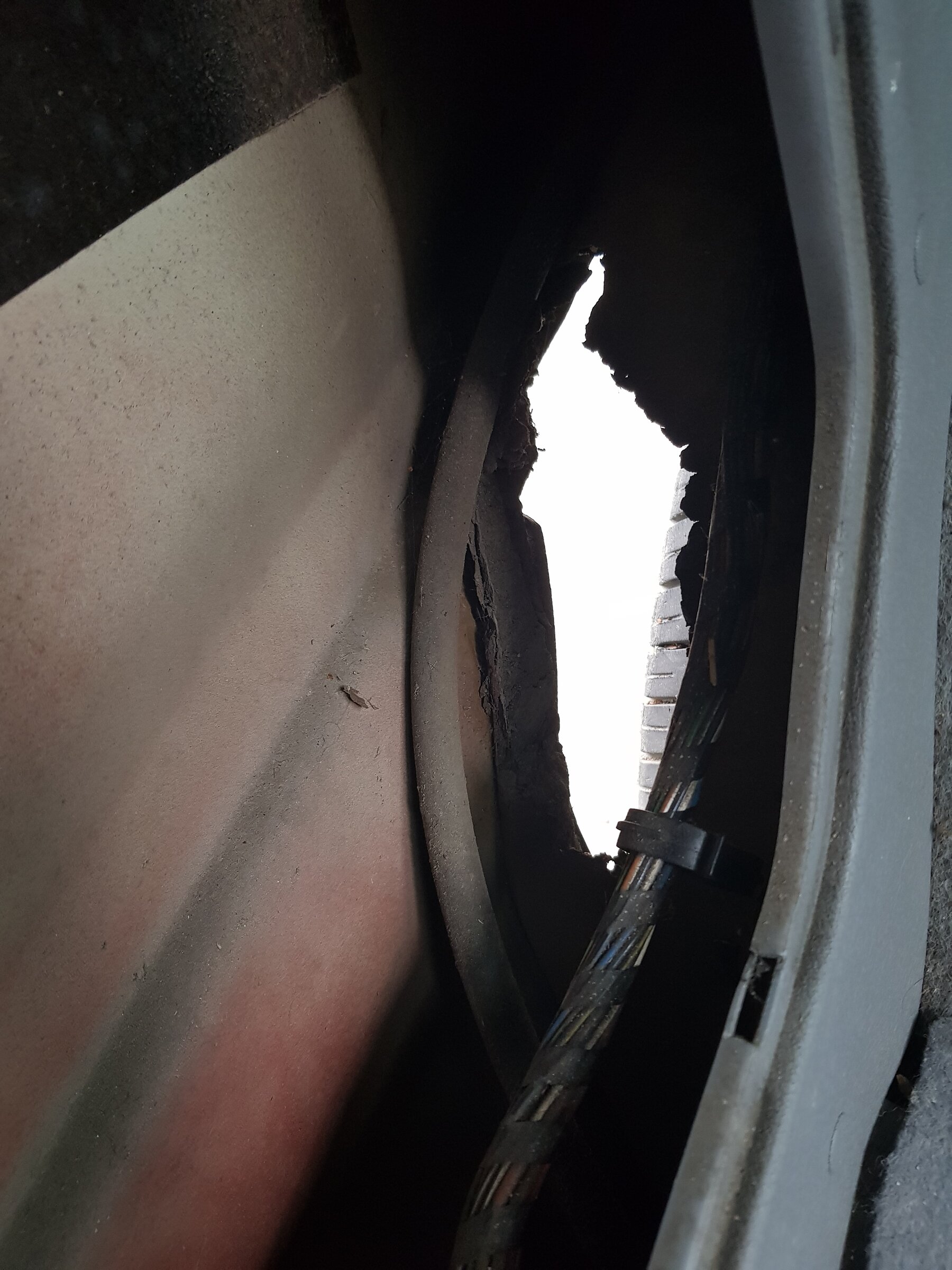

My dad has been through it and found 2 bits which will need welding up (mot failure) they are about 4 inches round.
The other bits are not structural but alot bigger.
My dad had a quick poke around and I took these pictures. The rest of the car is solid just the back end is a bit soft.
If it's the boot corners that are gone, just bodge them so they don't let water in as they're not structural.  My Cav is the same, and I've got pieces of cat piss tarp covering the gaps.  Passed the test OK.  I'm not that fussy so long as the rest of the car is relatively safe and mechanically in good order!
Thankyou. Yes the boot corners have gone. The near side inner arch is the big hole with the tyre in view. And both sill ends.
My dad says the skills are the things that need welding the rest is not an mot issue.
Thanks again Thomas
I can’t be right sure from looking at the pictures but I’d say it would’ve a fail as the hole in the arch is in a prescribed area within 30cm of a suspension mount.
Oh right bugger. Thing is that's just a quick push with fingers made it like that.
If you imagine a sphere of 30cm from the perimeter of a suspension or seatbelt mount that’ll give you a good idea of if it’s a fail. Like I say I’m just going on the pictures.
If its 4 inch now though could be more like 8 once you’ve chased it back to solid metal. I’d try and get it on a ramp and be able to properly check the underside before spending anything on it. Likely candidates for rot will be the spring mounts, get something like a blunt old chisel and poke up into the centres. If these have gone I’d have a rethink.
