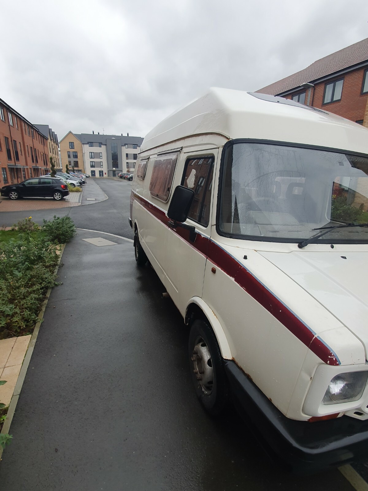

JEEZUZ.. Low miles tho....mainly under water I think
18/01/2021 17:37 Fail
Mileage:
86,123 miles
+ 4,290 miles travelled since last MOT.
Refusal Notices
  • Parking brake efficiency less than 50% of the required value (1.4.2 (a) (ii)) - Dangerous
  • Offside rear leaf spring to axle fixings loose to the extent that relative movement is visible (5.3.1 (a) (ii)) - Dangerous
  • Nearside front brake hose ferrule excessively corroded and likely to fail from chassis too flexi at caliper x2 flexi pipes (1.1.12 (f) (ii)) - Dangerous
  • Offside front brake hose ferrule excessively corroded and likely to fail from chassis too caliper x2 flexi pipes (1.1.12 (f) (ii)) - Dangerous
  • Nearside front bumper likely to become detached bumper mount corroded & holed (6.1.4 (a) (ii)) - Dangerous
  • Service brake efficiency below requirements (1.2.2 (a) (i)) - Major
  • Offside rear brakes imbalanced across an axle (1.2.1 (b) (i)) - Major
  • Nearside rear parking brake inoperative on one side (1.4.1 (a)) - Major
  • Offside rear parking brake inoperative on one side (1.4.1 (a)) - Major
  • Offside front windscreen wiper does not clear the windscreen effectively (3.4 (b) (ii)) - Major
  • Nearside rear stop lamp(s) not working (4.3.1 (a) (ii)) - Major
  • Rear registration plate lamp inoperative in the case of a single lamp or all lamps (4.7.1 (b) (ii)) - Major
  • Offside front upper suspension component ball joint excessively worn (5.3.4 (a) (i)) - Major
  • Offside exhaust has a major leak of exhaust gases tail pipe corroded & holed (6.1.2 (a)) - Major
  • Nearside front brake pipe excessively corroded from flexi too bulkhead (1.1.11 (c)) - Major
  • Nearside brake pipe excessively corroded from flexi in middle too rear (1.1.11 (c)) - Major
  • Nearside brake pipe excessively corroded from flexi in middle too rear 2 pipes (1.1.11 (c)) - Major
  • Rear brake load sensing valve linkage defective and function impaired (1.1.17 (a)) - Major
  • Nearside front integral body structure or chassis has excessive corrosion, seriously affecting its strength within 30cm of a body mounting body out rigger no 1 corroded & holed (6.2.2 (d) (i)) - Major
  • Nearside integral body structure or chassis has excessive corrosion, seriously affecting its strength within 30cm of a body mounting body outrigger no2 corroded & holed (6.2.2 (d) (i)) - Major
  • Nearside integral body structure or chassis has excessive corrosion, seriously affecting its strength within 30cm of a body mounting body outrigger no3 corroded & holed (6.2.2 (d) (i)) - Major
  • Nearside integral body structure or chassis has excessive corrosion, seriously affecting its strength within 30cm of a body mounting body outrigger no5 corroded & holed (6.2.2 (d) (i)) - Major
  • Nearside integral body structure or chassis has excessive corrosion, seriously affecting its strength within 30cm of a body mounting body outrigger no 6 corroded & holed (6.2.2 (d) (i)) - Major
  • Nearside front integral body structure or chassis has excessive corrosion, seriously affecting its strength within 30cm of a body mounting body structure corroded & holed nr frt body mount frt of wheel (6.2.2 (d) (i)) - Major
  • Offside front integral body structure or chassis has excessive corrosion, seriously affecting its strength within 30cm of a body mounting body structure corroded & holed nr body mount above ft wheel (6.2.2 (d) (i)) - Major
  • Offside integral body structure or chassis has excessive corrosion, seriously affecting its strength within 30cm of a body mounting body outrigger no1 corroded & holed nr body mount (6.2.2 (d) (i)) - Major
  • Offside integral body structure or chassis has excessive corrosion, seriously affecting its strength within 30cm of a body mounting body outrigger no2 corroded & holed nr body mount (6.2.2 (d) (i)) - Major
  • Offside integral body structure or chassis has excessive corrosion, seriously affecting its strength within 30cm of a body mounting body outrigger no3 corroded & holed nr body mount (6.2.2 (d) (i)) - Major
  • Offside integral body structure or chassis has excessive corrosion, seriously affecting its strength within 30cm of a body mounting body outrigger no4 corroded & holed nr body mount (6.2.2 (d) (i)) - Major
  • Offside integral body structure or chassis has excessive corrosion, seriously affecting its strength within 30cm of a body mounting body outrigger no5 corroded & holed nr body mount (6.2.2 (d) (i)) - Major
  • Offside integral body structure or chassis has excessive corrosion, seriously affecting its strength within 30cm of a body mounting body outrigger no 6 corroded & holed nr body mount (6.2.2 (d) (i)) - Major
Advisory Notices
  • Offside front shock absorbers has slight external damage to the casing (5.3.2 (b))
  • Nearside rear integral body structure is corroded but structural rigidity is not significantly reduced inner cill corroded & holed (6.1.1 (c) (i))
  • Offside rear integral body structure is corroded but structural rigidity is not significantly reduced inner cill corroded & holed rear of wheel (6.1.1 (c) (i))
They could have summed it up far more succinctly by just putting "It's fucked m8".

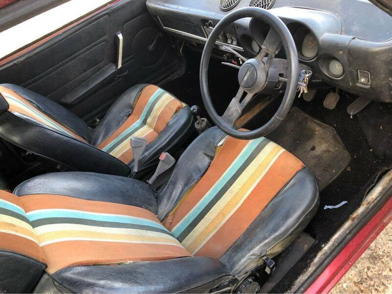

Interior good, needs new van!!! LOL
cheap enough to rob the engine and box tho......collection could be a pisser at the Mo tho!!
They already had
Furthered by the picture of the lush* and comfortable* interior:

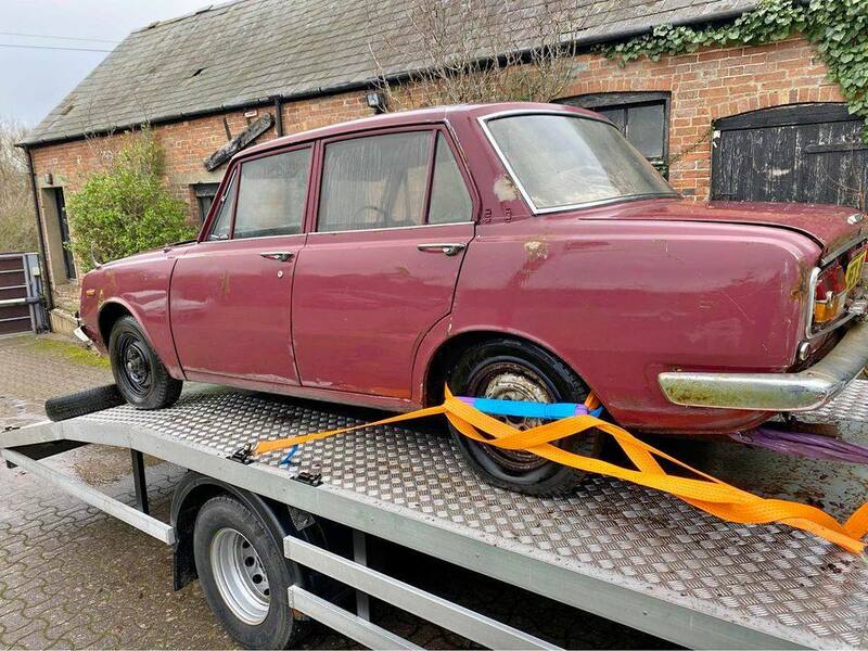

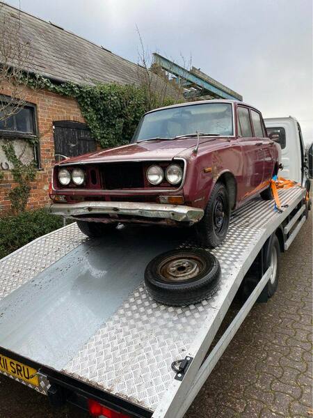

4 hours ago, Wilko220 said:

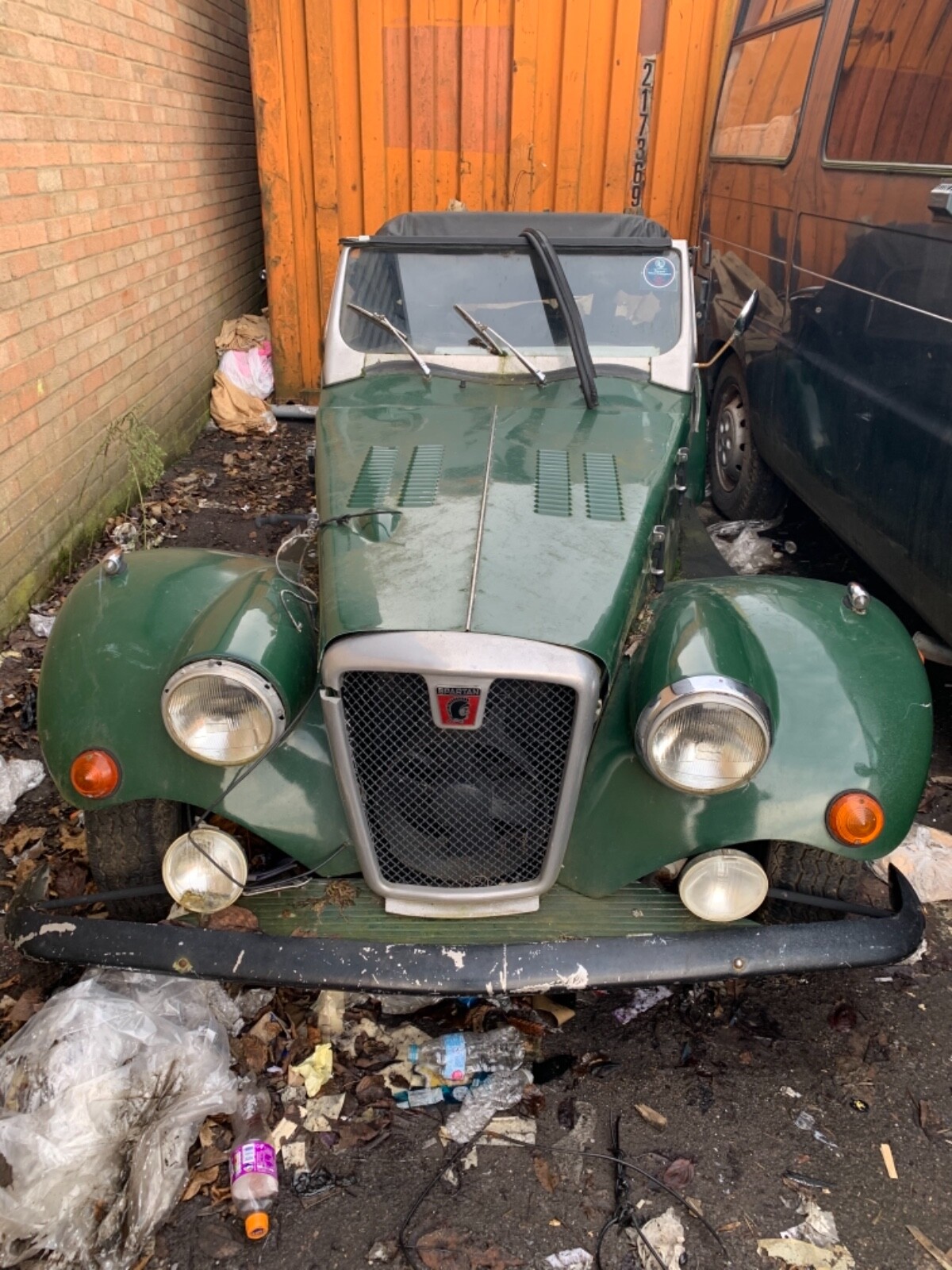

Been there, seen it, done it, and boy do they rot like fuck. No shot of the engine, just in case somebody has "liberated" the 40 DCOEs and replaced them with the twin Stromberg.
Wow!!! I was about to get sniffy because of the painted bumpers, but I just clicked through and I must say, that is MEGA. Seems like a right old BWARG as well for 650 groat.
