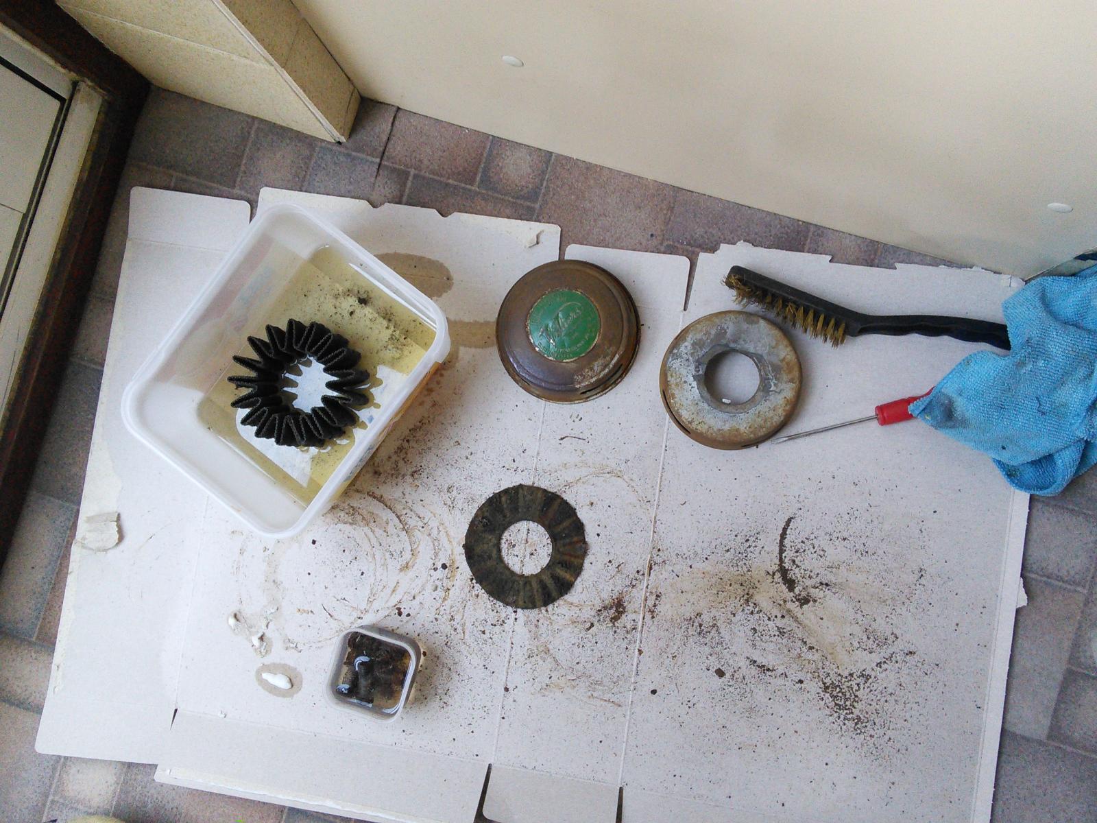

I've bronze brushed and vingered the air filter in an attempt to do another free temporary fix*, although a new one will be bought should this project succeed!
In all honesty, a new one will be needed, this is just going to suck rust into the carb.
