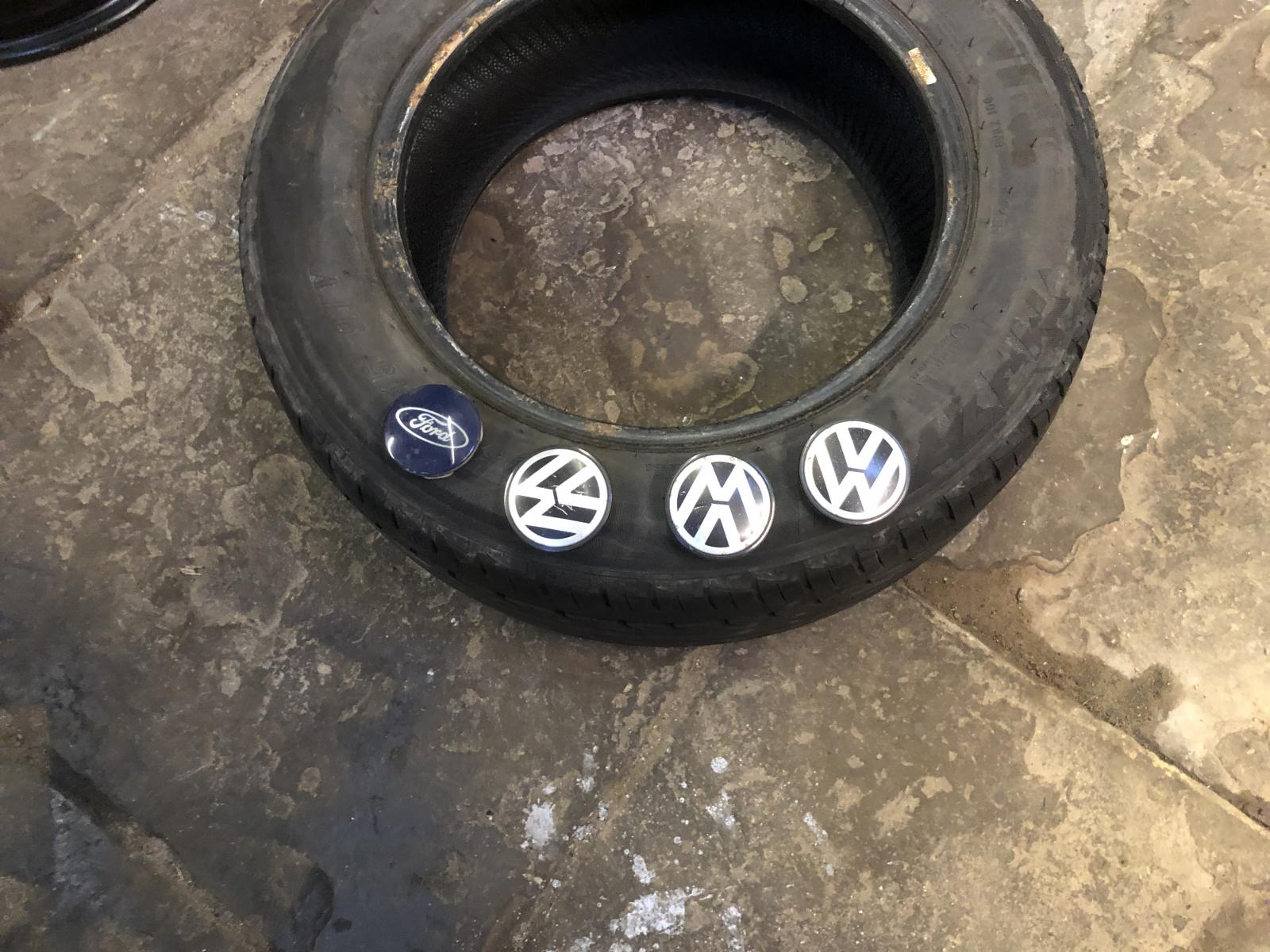

Let’s find some centre caps for the alloys. Yep, they’ll do...

Fucking lol at the VW logo still being visible on those :D
Improving* this nicely
Only on 3...number 4 says Ford...

They fit because they are VAG wheels off an A3 I broke. Much better than what it came withpost-19511-0-77878600-1547494428_thumb.jpg
No they are personalized. WV. Like the numberplate.

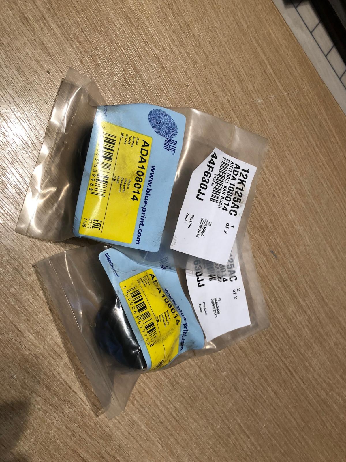

Other than that, there was still a slight rattle over the potholes which has been tracked to oval anti-roll bar bushes.
A new set are on order and in the meantime, I’m currently drilling out two snapped anti-roll bar mount bolts.

Next job was the roll bar bushes. A pair were delivered which actually cost as much as a complete bottom arm with bushes and ball joint...go figure?
Once the broken bolts were drilled, I attacked them this morning with the gas axe and an easy-out before refitting the roll bar with the new bushes.

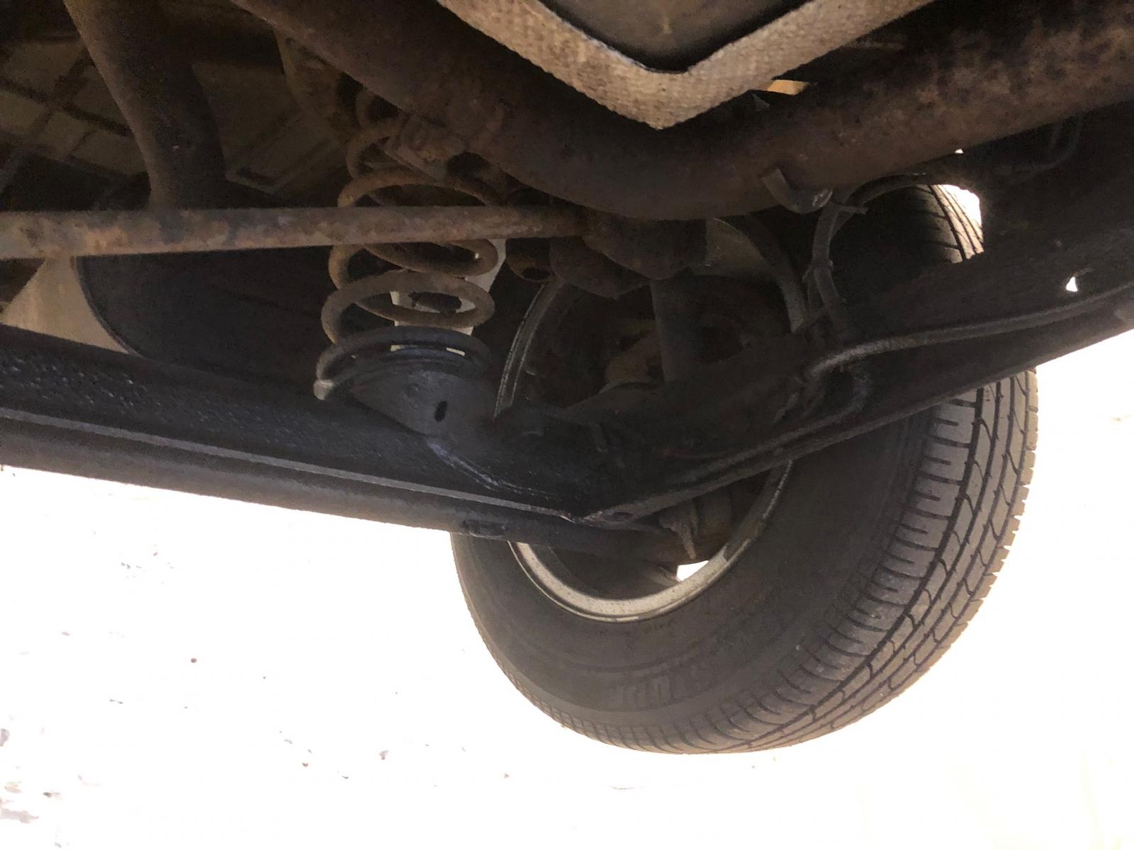

The eagle eyed among you may have spotted fresh paint...whilst it was up in the air, I took the opportunity to clean up and treat the rear axle and front subframe with gravel guard. Other than a bit of scab under the offside front outer sill where someone in the past has tried jacking it, it's now remarkably solid and clean under there.

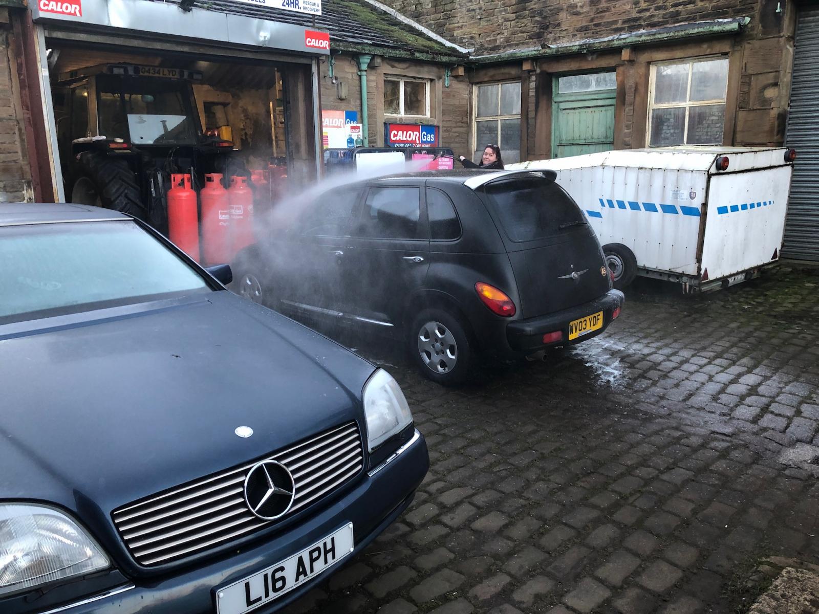

Last job on the cards is a wash....not sure it makes much of a difference but hey ho...
Pleased to report the ham-fisted jacking up at the front weren't me guv. That rear axle and subframe looks well nice - job jobbed :)
No, the damage is years old but pretty insignificant anyway. It’ll probably get a tidy up before the next test as part of my ‘working through the previous advisories’ list but it really is quite tidy under there.
