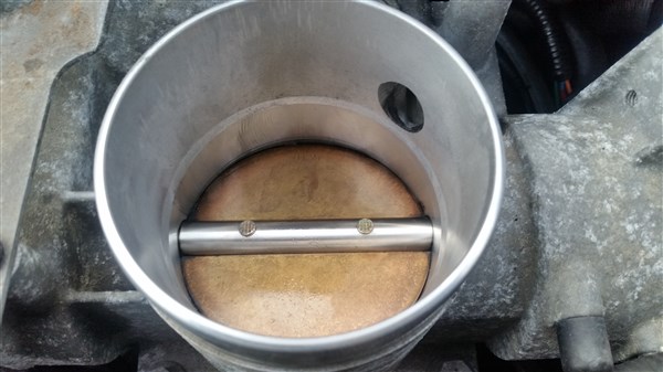

Throttle body is now clean, no more slight jerk on & off the power -

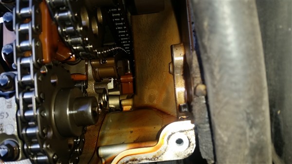

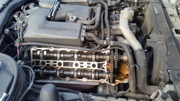

I've checked the tensioners, this age engine should have the Mk3s and it looks like it does -

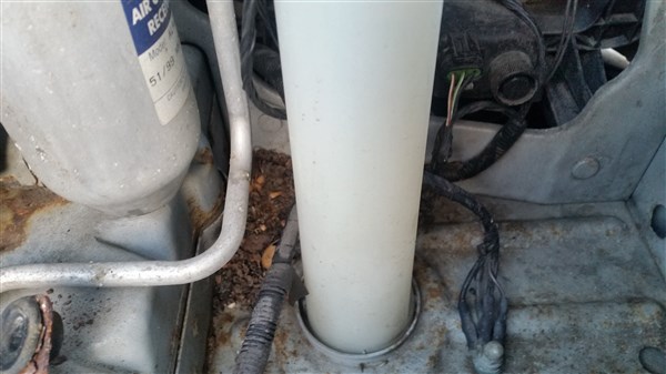

It appears squirrels have been using it as a larder -

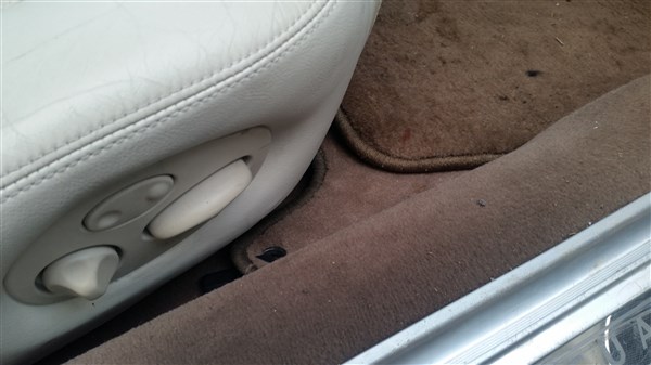

And for LS it's got too many mats! Genuine floor mats & then what feel like lambswool ones over them. I think the lambswool ones are coming out as they makes the pedals too low.

I was wrong above too, I don't have mk3 tensioners, I've got mk1s so they need changing. Usefully* every guide in the world mentions three versions, but looking on Jag's classic parts site there are six versions... they all supersede to the same final revision so it's not really an issue. £89 a side for the secondary tensioners, I'll have to get them ordered up soonish for piece of mind.
