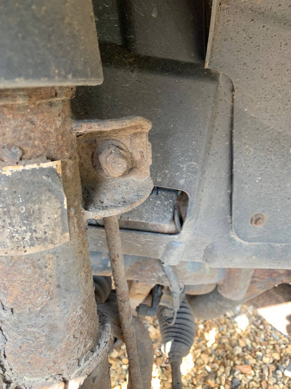

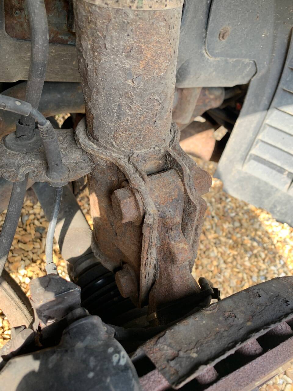

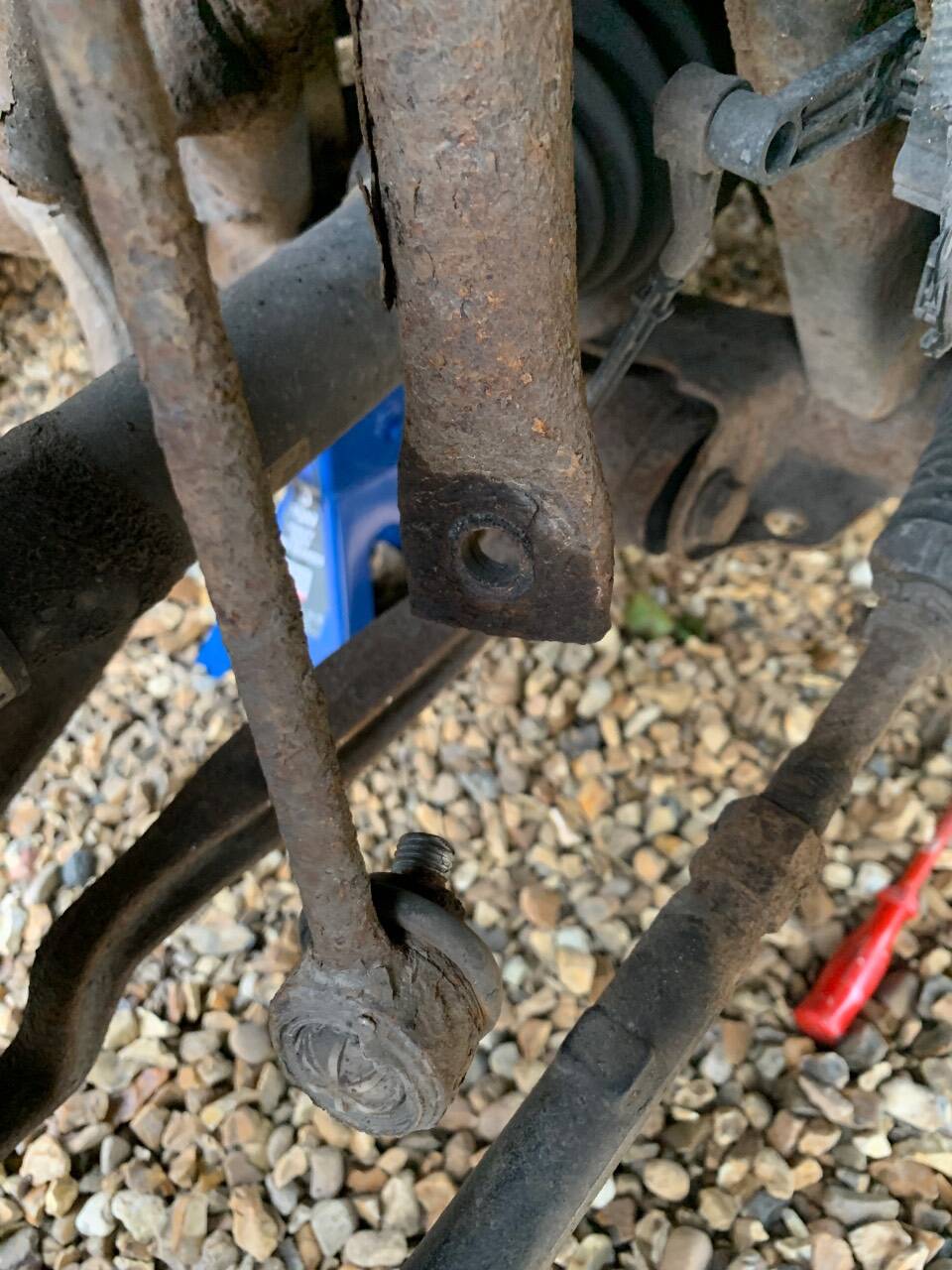

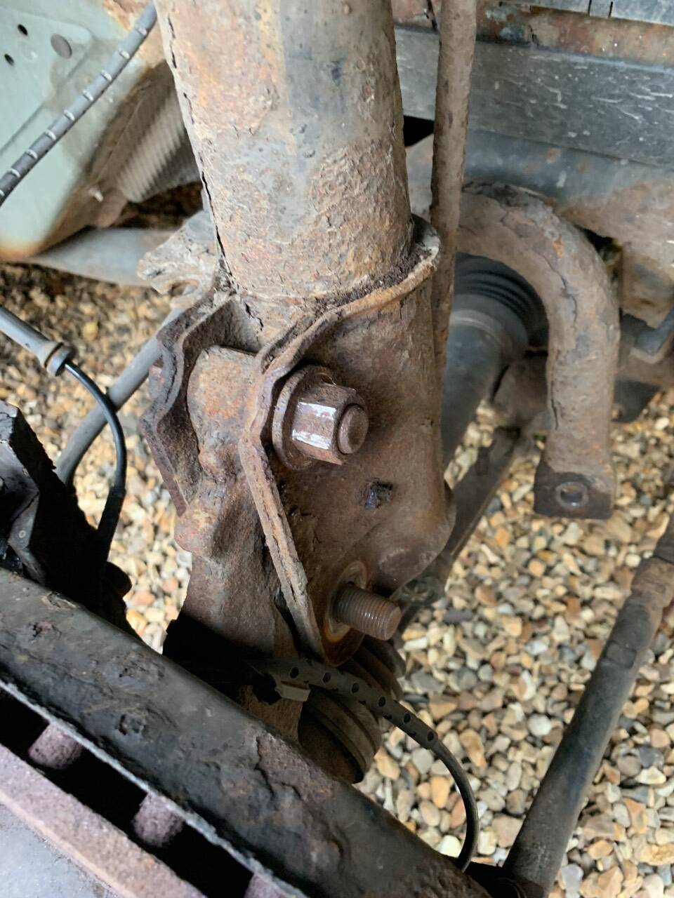

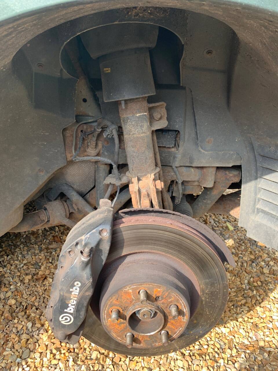

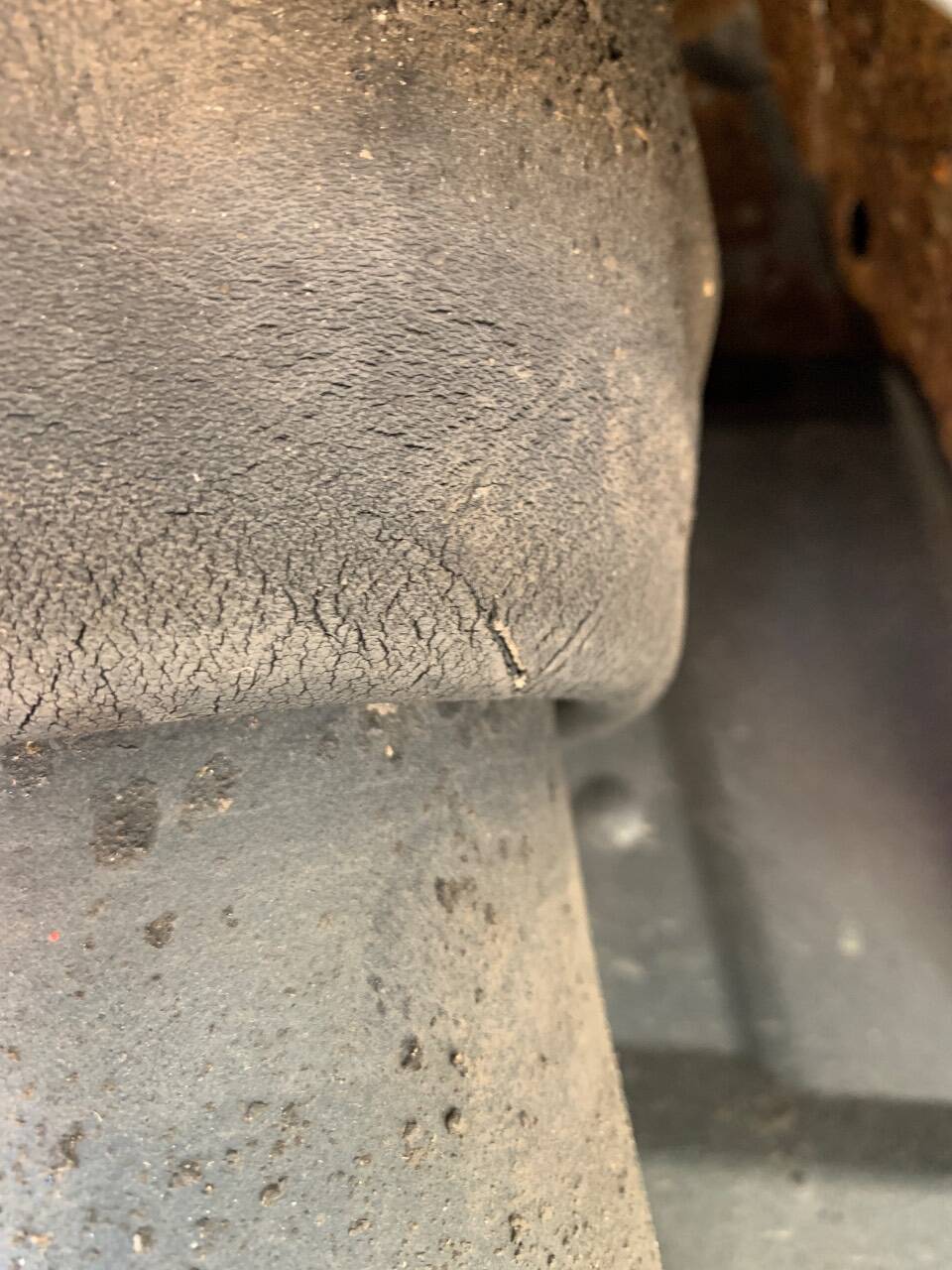

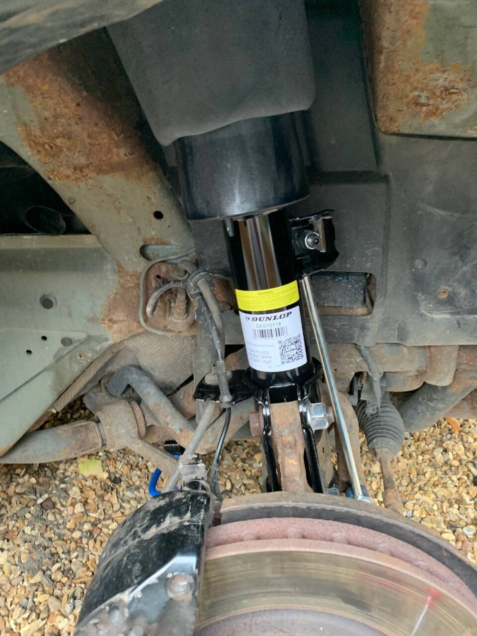

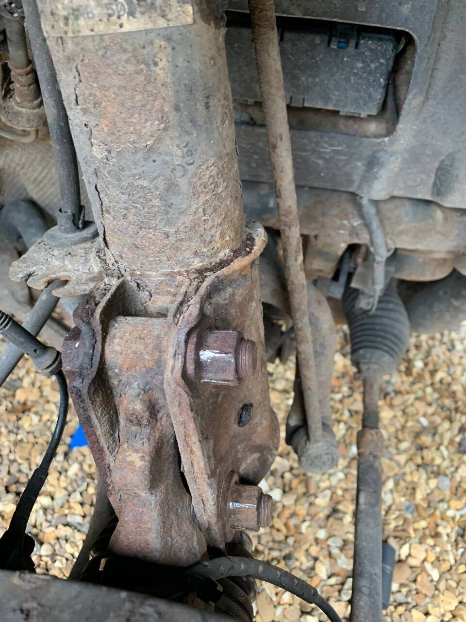

I took another load of shite to the tip in this the other week and the suspension seemed to have a bit of a fit with the front end skyward and the arse sat down. Sorted itself after 5 mins or so. When I got it home I decided to run it thru low to high. It managed low well enough. Unfortunately high only resulted in a loud hiss from the offside front and ‘suspension rising slowly’ message on the dash. It would appear I had ruptured my bag so to speak.
Since then, it’s adopted the traditional L322 stance of sat prostrate on its bump stops as it evacuated all its air.  I had a peek behind the wheel and it’s on its original strut. They do sell airbags on their own but I did not relish the thought of stripping all that down after 18 winters worth of corrosion had done their worst, so I’ve bought the full strut, bag n all. Cheapest I could find from a known brand was £300, gulp. I’ve ordered an ARB link as well in case I need to go medieval.
I’ve had the wheel off tonight to see what I was up against before battle commences tomorrow.
As expected really. My tin of plus gas has decided it will no longer spray, so I’ve left them all soaking in 3in1 overnight.
That’ll be my leak then.
The arch liner was the usual war to get off but after dremeling a screwdriver slot in a rounded off torx screw and getting my Irwins on most of the fucking horrible 8mm corroded mounds that were once bolt shaped I wrestled it off. To be continued.
Incidentally I’ll probably be moving this on soon once it’s working again, if anyone is after a cheap one.
Range Rover - 1
James - 0

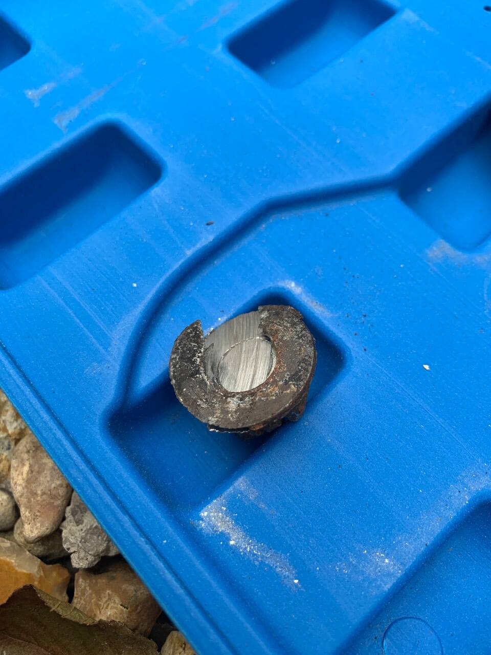

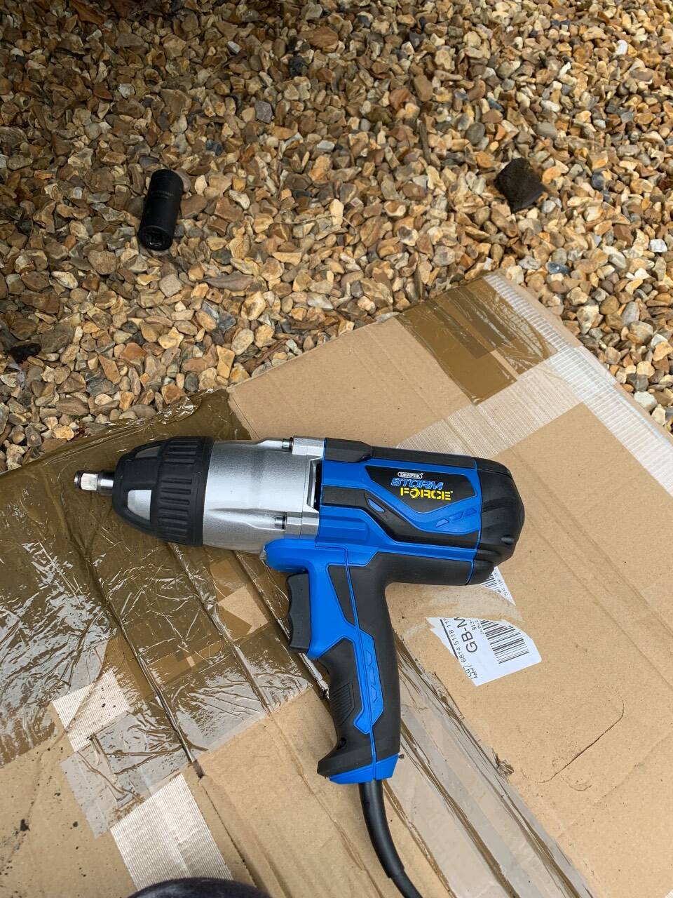

I had a blowtorch on the top one for about 5 mins then hit it with this big bastard which spins hub nuts off for fun and still nothing. This was after attempts with a weedier impact and a breaker bar and scaffold pole, which was going to break the bar.
I’m going to have to order some new bolts and get cutting. So I’ve another week of looking at this:
Stanced on 21s Yo!
  • J-T changed the title to JT’s fleet: Range Rover’s burst it’s bag
Bolts came, so I decided to have another go after work. I’d also ordered a bolt splitter, which I decided to try on the smaller bolts on the drop link. It was shit, blunted almost instantly and just made a mess, so I ground the fucker off, take that you bastard!
That must have relieved some pressure on the strut because I could now get some movement on the hub bolts with a 1/2” breaker bar and scaffold pole. A few minutes later I had those off and a quick blast with the impact unseized the bolts so they could be knocked out.
It was plain sailing from there, I was a bit concerned about the air line connection but it came undone easily. New strut went in ok and jacking up the hub got the new drop link in and it was all buttoned up.
Longest task was putting the sodding arch liner back in. Anyway, started up, did the steering lock to lock so the steering angle sensor didn’t get upset and put it in high…
Im calling that a win, no hissing and it’ll cycle through low to normal to high and back down. Hopefully it stays up over night!
