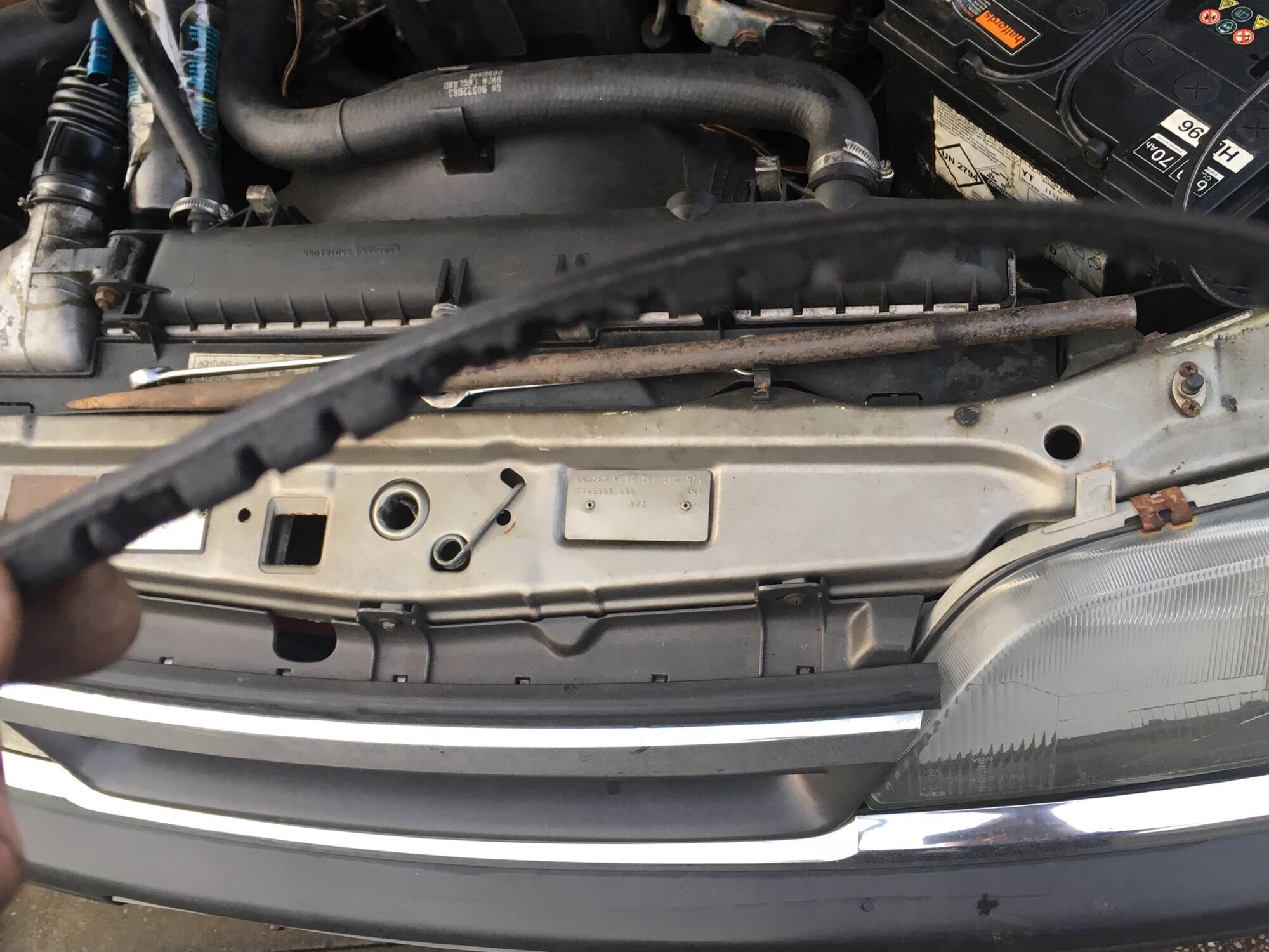

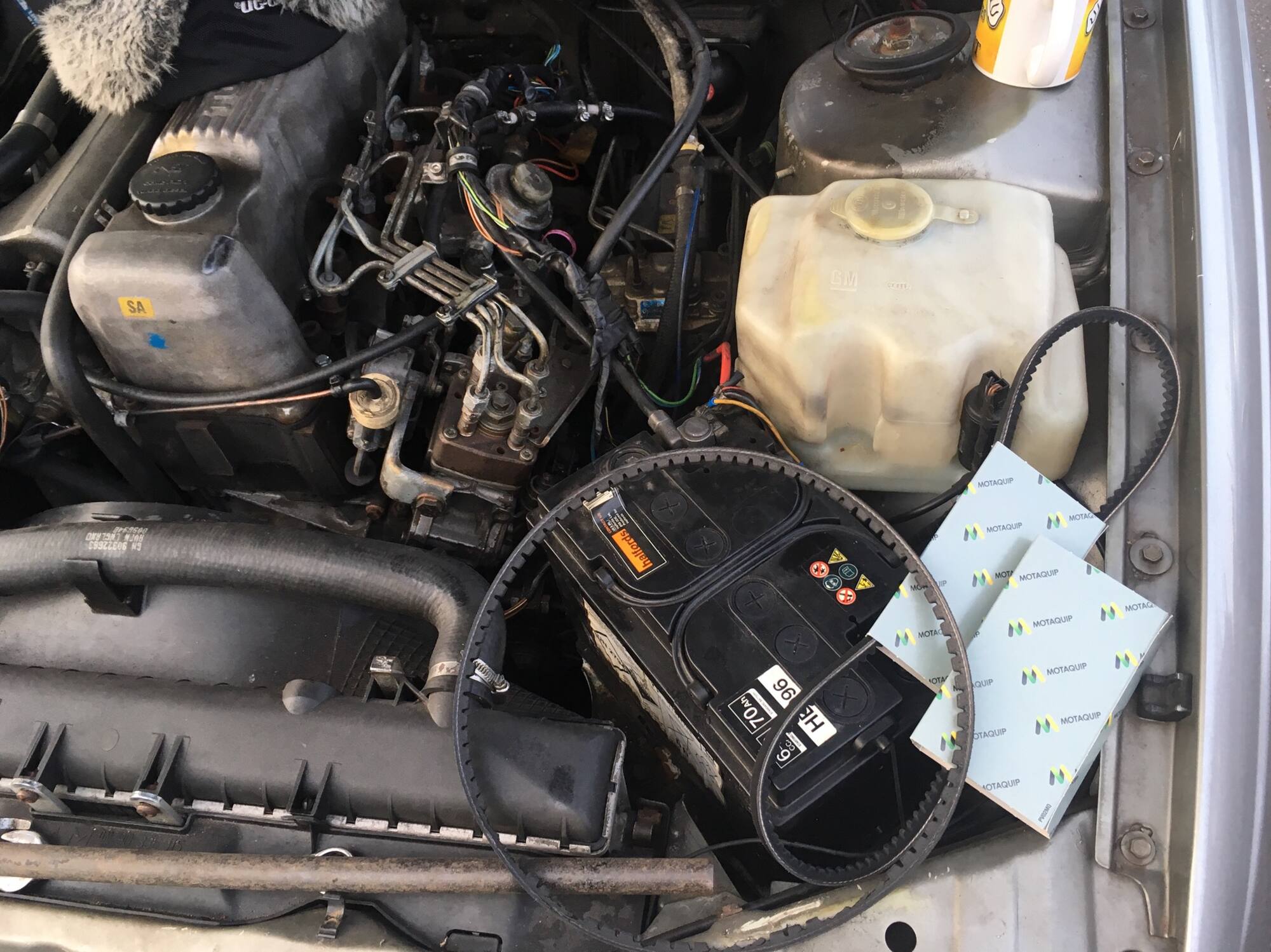

ive been using it every day. It’s alternator belt squeals occasionally and I’ve been adjusting the belt when it does. Until it reached the end of its adjustment. I took the belt off to find it’s borked. Completely. A trip over to a local motor factors had some in stock so I bought 2.  No more adjusting the belt for a while!
The washers also packed in. I’ve been waiting for them to run out of fluid so I can clean the bottle out as it’s more like spermy potato water. Removed, bleached, scrubbed and refitted with fresh screen wash. Cleaned out and adjust the jets. Another thing sorted.

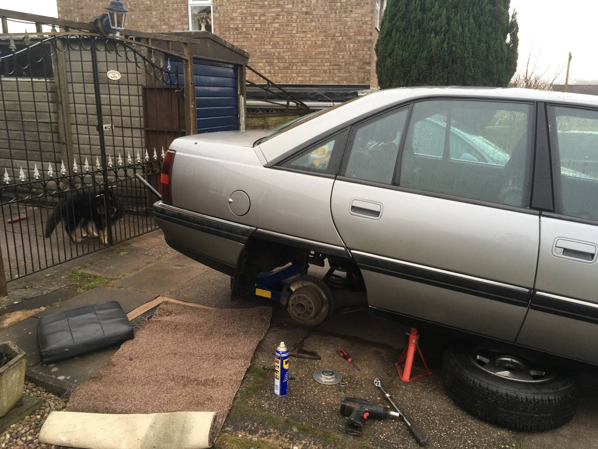

I set to doing the rear springs today. Motor factors were quick to get a pair in. £72 for both not too shabby. Same suspension setup as the omega. A pain in the arse to do. Old case out easily but the new was shit to go back in. Probably due to it being heavy duty. Took all afternoon to do, got pissed off, threw some tools up the drive etc etc. After building it up it sits on stilts. So I’ve ordered another standard spring. Can’t be doing with that.

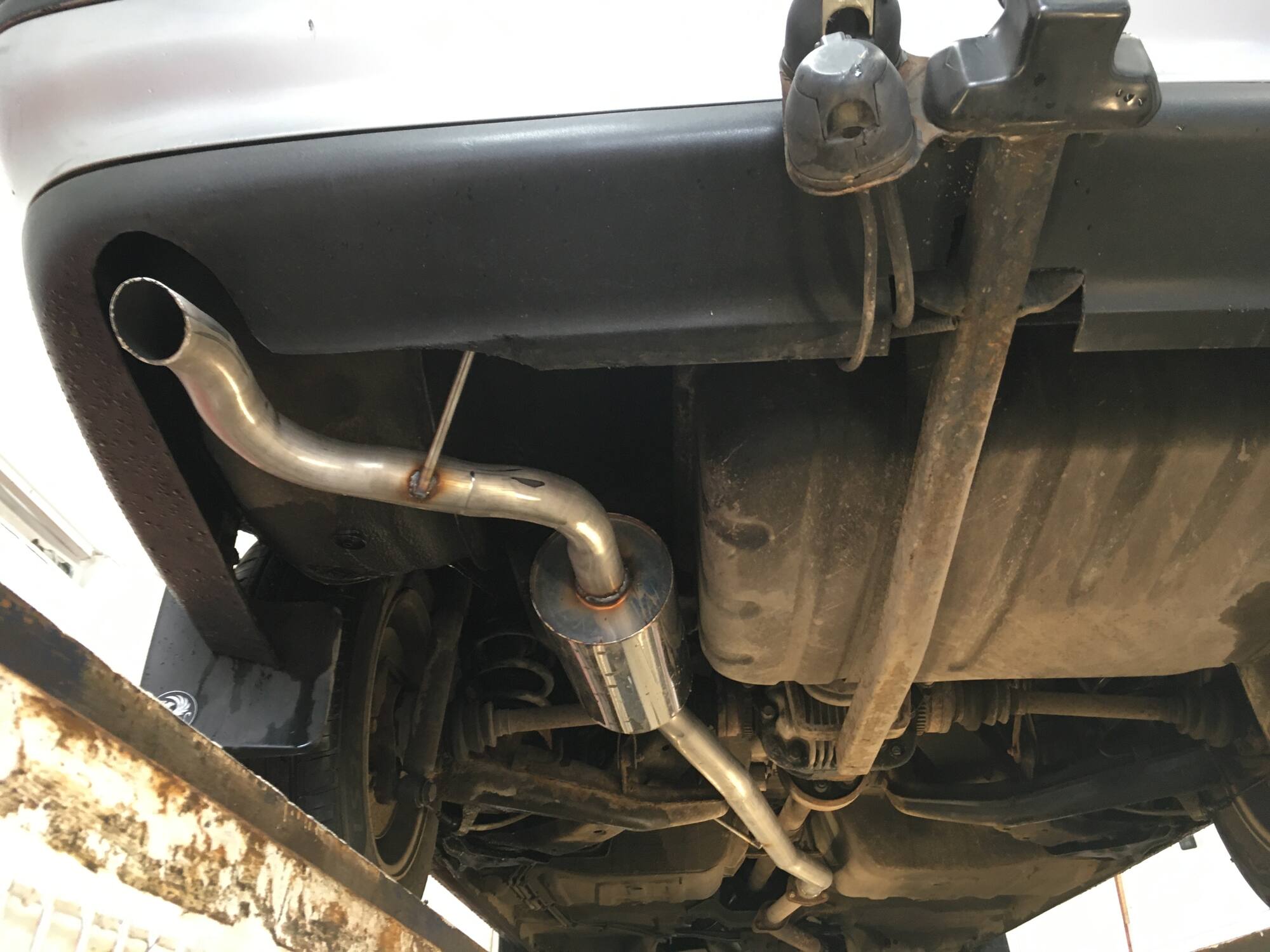

Pre lock down saw the back box fly off spectacularly (while lent to a friend) in good old vauxhall fashion. So I bodged it up with a piece of ST220 pipe to see it through.
today I’ve been to get a Powerflow box fitted. Wasn’t cheap at all, but the original centre box pipe was rotten as a pair and I was fed up of patching it. So this has been made. Then I went straight for MOT. Wasn’t interested in a Boris MOT, as I don’t want to be testing stuff in winter thank you very much. Passed with flying colours (2 advisories on the rear sills but I’ve waxoiled them to stop them getting bad)
Doesn’t really smoke much anymore (not as bad anyway) so a plus all round.

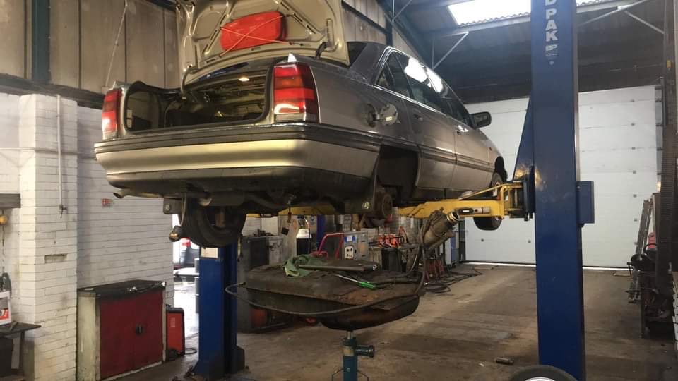

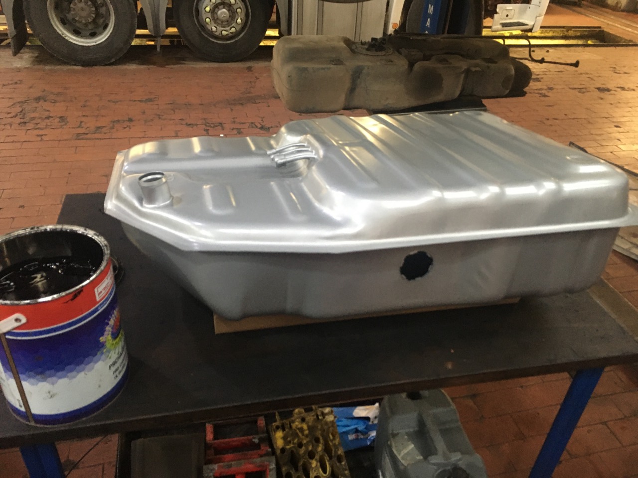

So the carlton sprung a fuel leak a couple of weeks ago. I drained as much out as possible and then ran it till the light came on. New fuel tank sourced from Latvia for about 90€ and it arrived yesterday. With not a great deal to do at work I’ve painted the tank with chassis black and left it under an industrial heater for a few hours.
once it’s fitted, it’s goodbye to the carlton. I’ve been toying with selling it for a few months now due to wanting to thin my fleet out to make room for something more modern that can be reliable and still tow my caravan. I’ll be sad to see it go but it’s going to a carlton enthusiast so I know it’s going to a good home.
