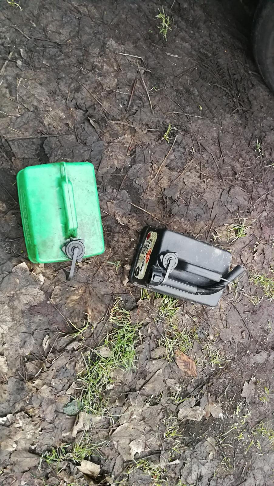

My neighbour has offered me some diesel he found in his shed (black can)
Looks legit

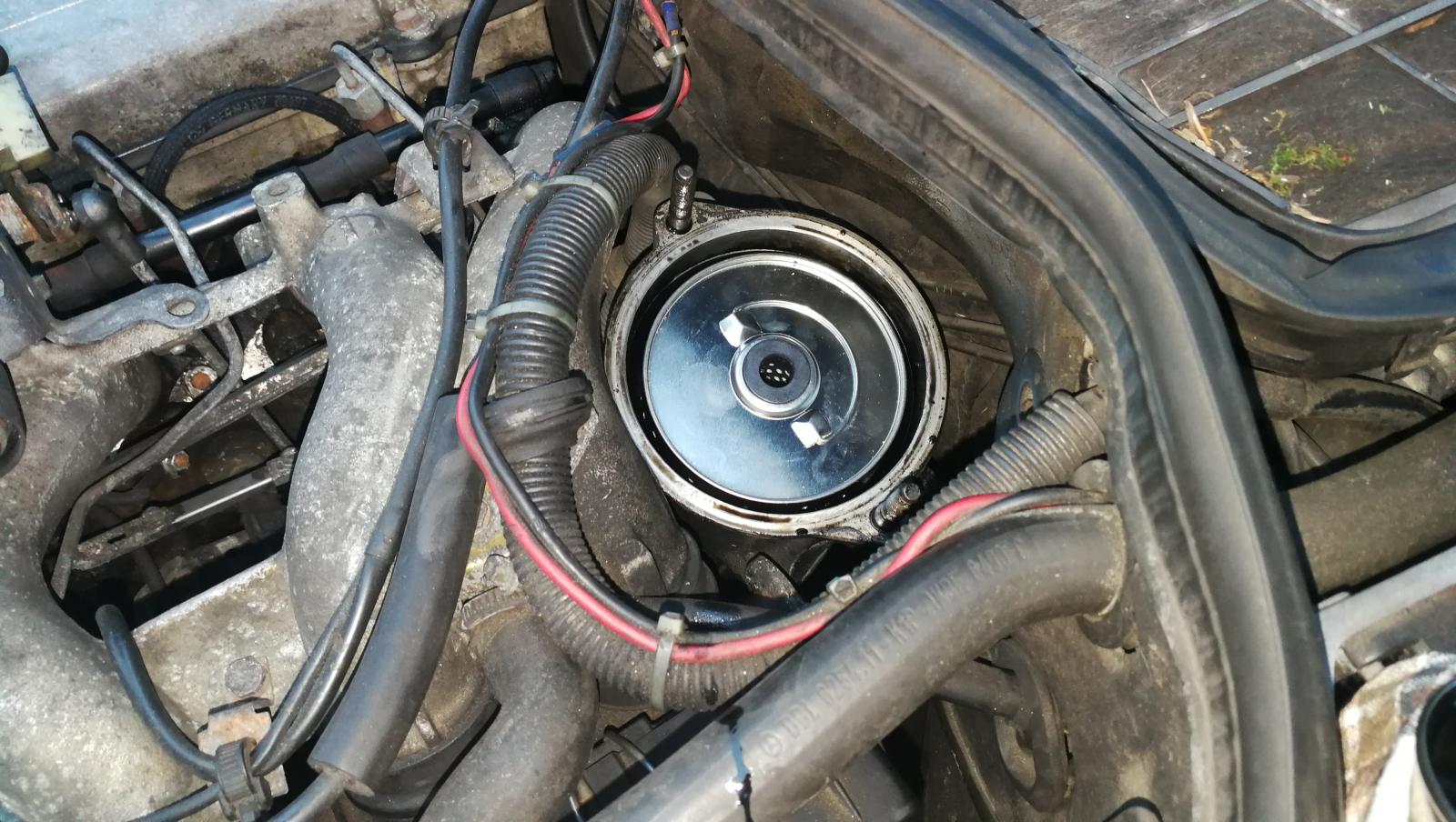

Whilst the PELA did it's thing (and keeping an eye on it, as it only holds 6L at a time!) I set to removing the oil filter.
First, it was bonnet to 'service' position, and then loosening the single 13mm bolt, and 2 13mm nuts holding the filter housing lid on.
The construction is similar to the filter housings on the BMW M30 engine, but much more over engineered.
The BMW only has a central 13mm bolt. It keeps pressure even round the top seal, so God knows why there are an additional 2 13mm nuts holding the filter lid on the Merc?
The 2 13mm nuts come off straight away, but the 13mm bolt needs unscrewing and removing to allow the lid off past the bulkhead.

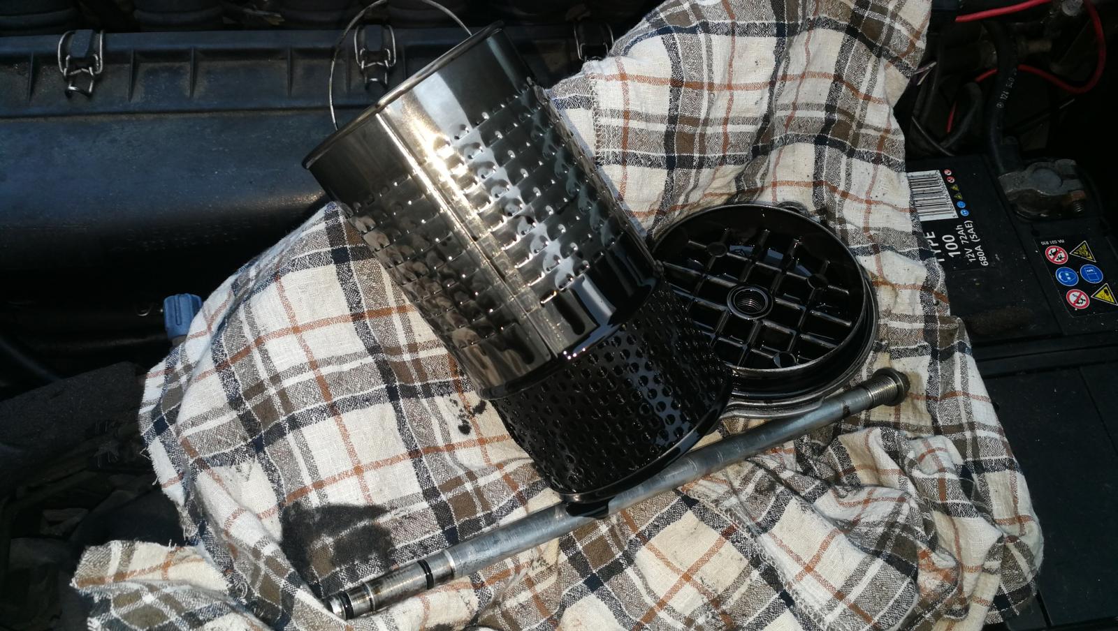

The old filter was tired, and the stylish* Waffle construction of the lid can be seen.
Next step was cleaning out the filter housing And getting the new filter popped in . Marvel at the handle !
