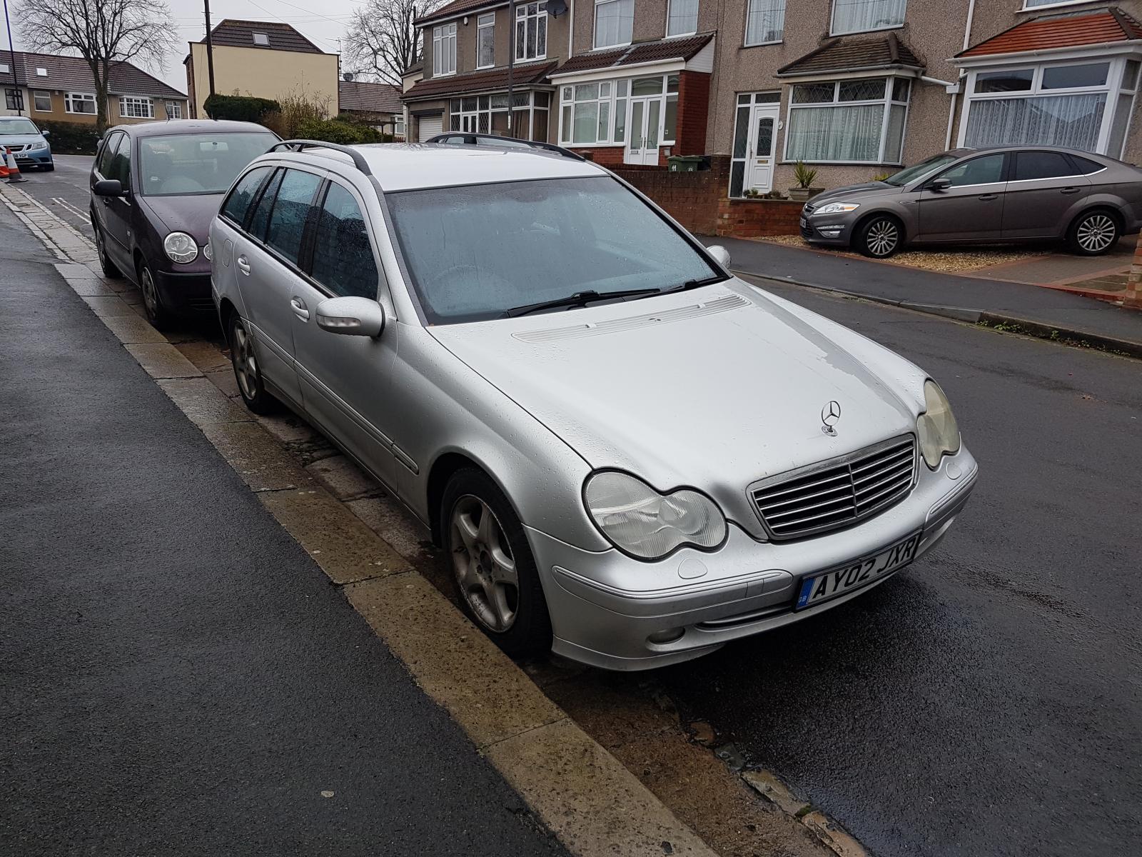

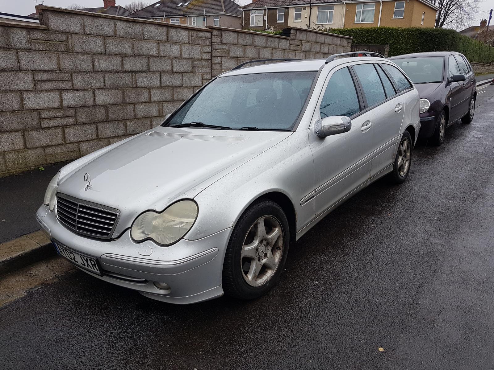

So behold my new Acquisition
It's not without its issues though.
Firstly, it's not wearing its 250k well and the bodywork has numerous issues although these are easily sorted.
It idles quite roughly and has a bit of a knock when cold although this seems to disappear when warm. I'm betting Engine mount or possibly a faulty injector or Fuel rail.
I'll bung Delphi on it and see what's what over the next few days.
I'll leave you with some crusty pics

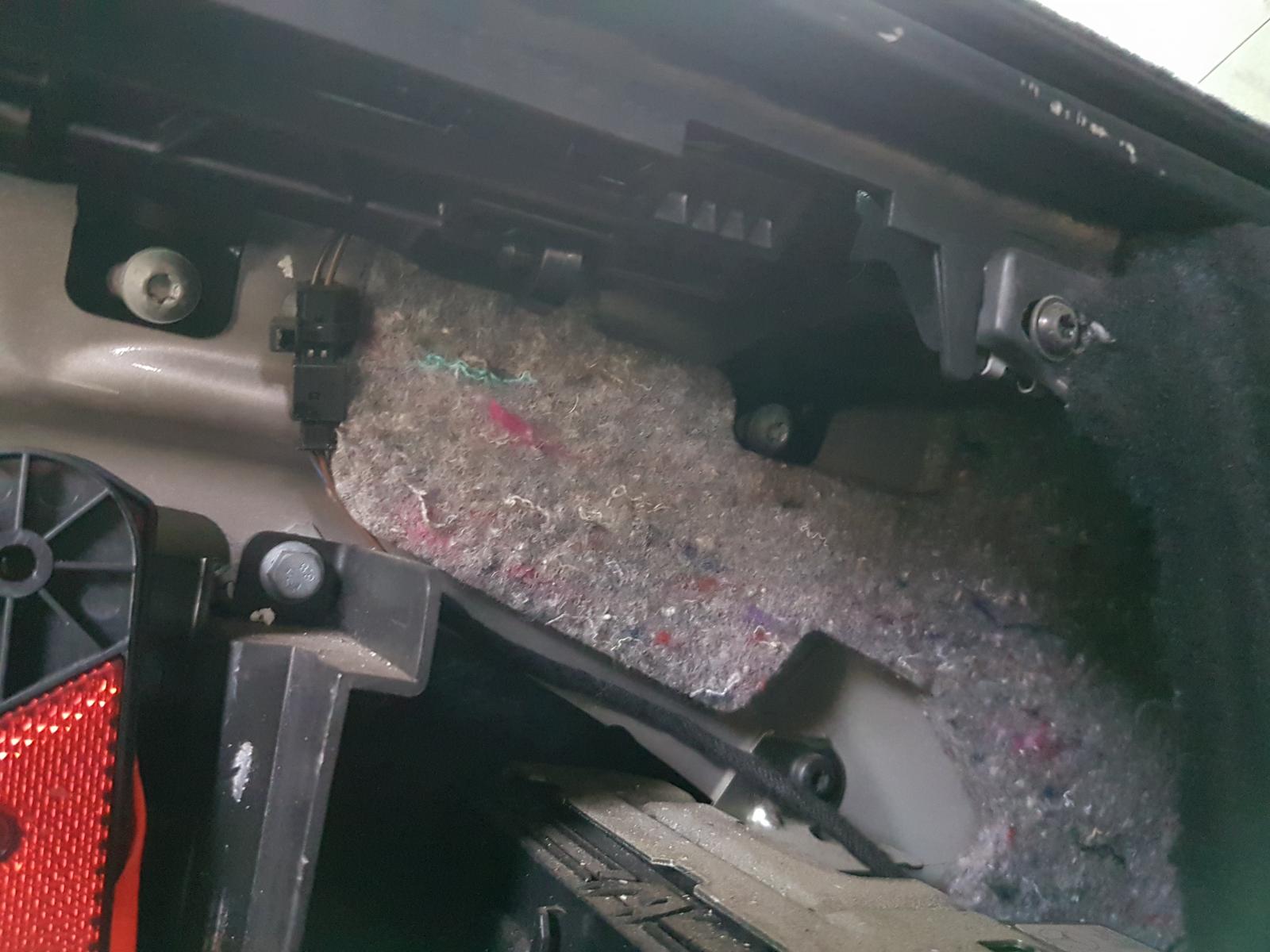

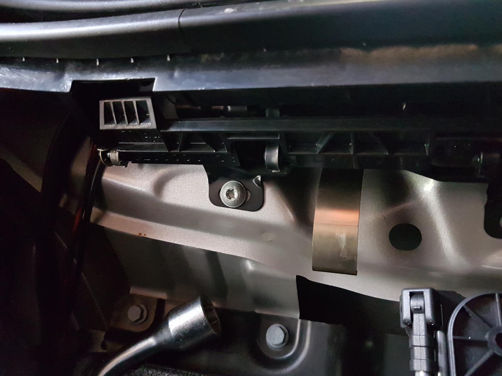

Can you please tell me, maybe with photos, how the cubbies in the boot are supposed to attach? The left one in mine (hiding the first aid kit) won't stay in place but I don't understand the locking mechanism - it doesn't seem to go anywhere near where it should, but there's nothing obviously broken, no rough plastic etc.
Thank you!
I asked Bramz this but predictably he's moved it on before getting round to replying :)
Thank you!
Yep no problem. Won’t be till tomorrow as it’s in my mothersteve79s garage at the moment but i’ll grab some photos for you then.
Thank you!
Took some pics the best I could hopefully they'll be of help!

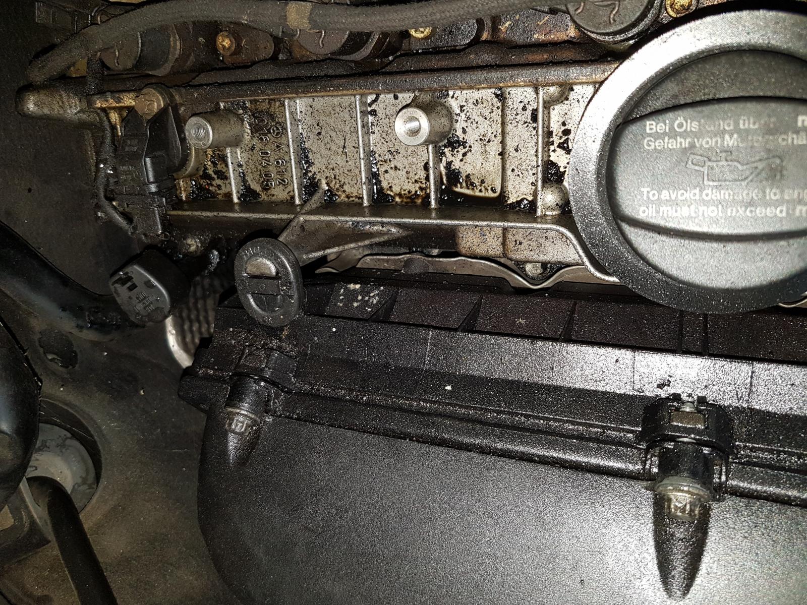

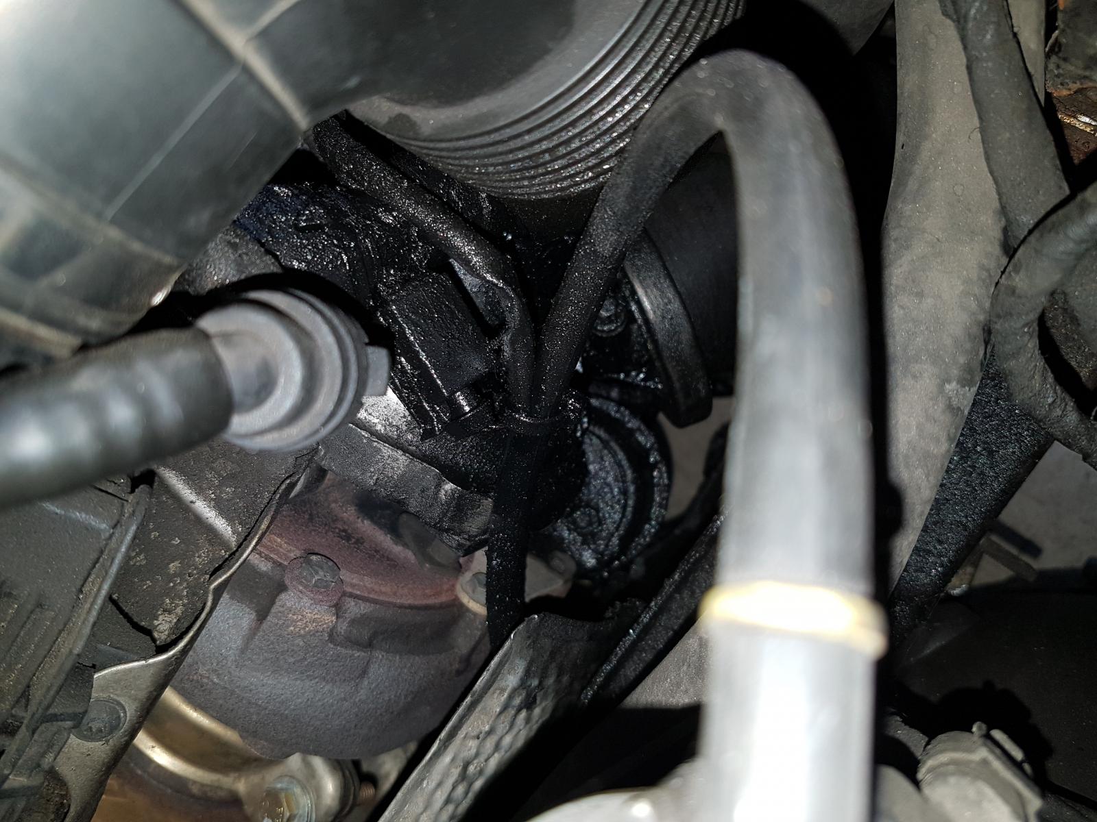

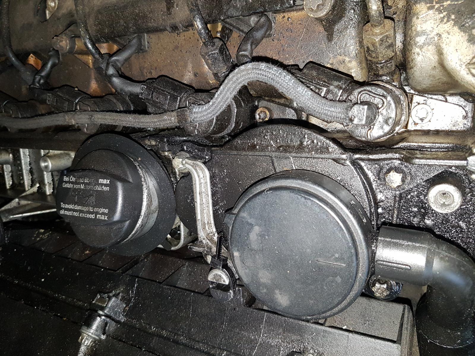

Having now served it's purpose for multiple tip runs the Merc has now been sold and is off to spend its remaining years in a more sunny climate somewhere in Africa!
Now have to find something that'll shift the big pool of oil on the garage floor!
