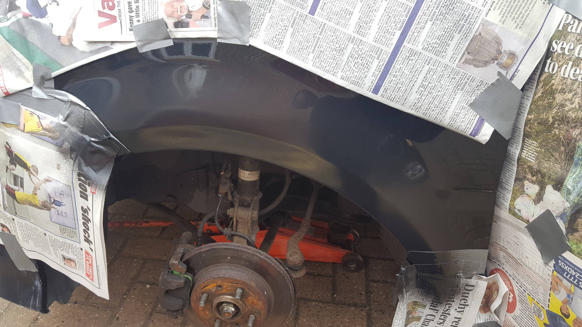

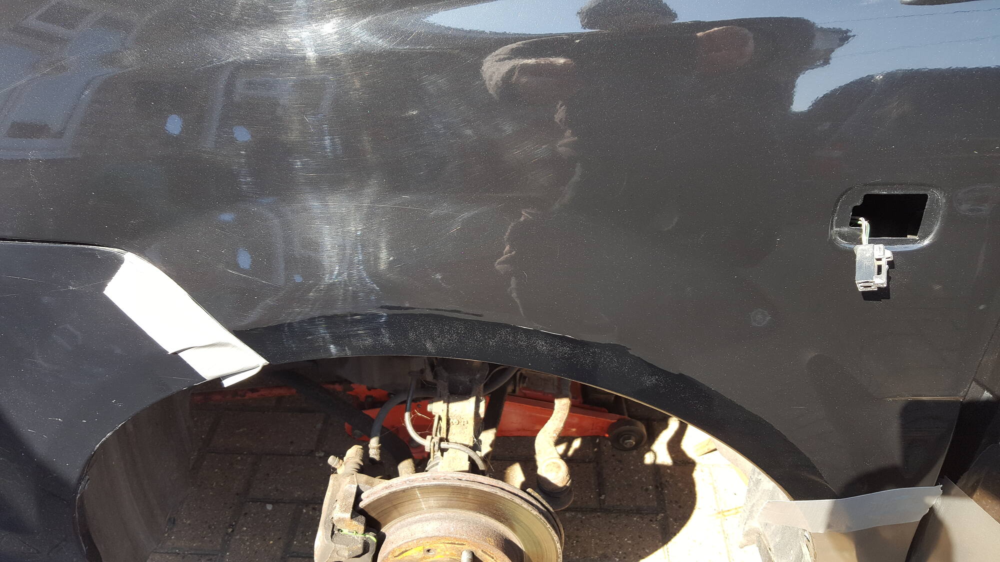

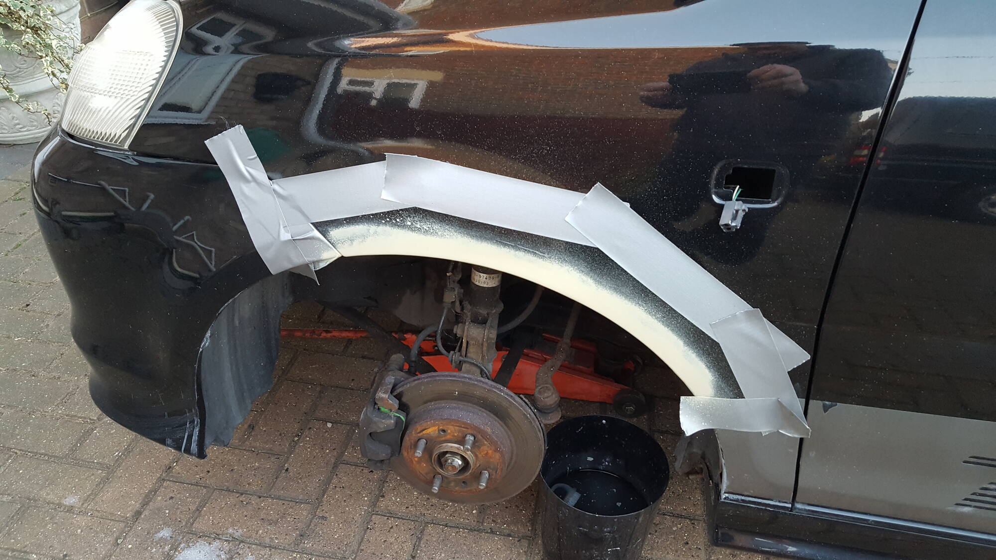

Joey spud Posted May 13, 2020 Author Posted May 13, 2020 Done some Daihatsu tinkering last week. The annoying chirping noise was the drive belt and a new one has 100% cured it. Although the one i took off was fairly new it was the one that was fitted to the car when the alternator was seizing up and when i removed it and looked a bit more closely there was melted bits stuck inbetween its ridges stopping it sitting snugly in the pulleys groves. A while back i quickly painted the front arches with some cheap generic black paint just to protect them through the winter months. To be fair it only really noticed it bright sunlight. The paint is a mica black and the exact same colour as my Avensis and shonky Hiace and i had a can already. I never seem to have much success with metallic and lacquer finishes but picked a nice hot day with little breeze and gave it a go. No masking tape so my best gaffa tape was used instead. I gave it three light coats of colour keeping quite tight to the arch then three full coats of lacquer over the top that i sort of dusted out towards the middle of the wing. After a couple of days hardening i gave them a gentle compounding with G3 and G10 and to be honest they have come out far better than i expected,it won't win any prizes at Pebble Beach but looks fine when compared to the rest of the car. And i finally joined the 21st century and spent out on a new smart battery charger. It's the kiss of death leaving a battery standing idle and the YRV one is only rated at 300 amps so can't afford to loose any of its modest capacity through suphated plates. I thought £23 was a fair price i for a soft start,pulse charge battery conditioner/charger. Just need to get it mot'd again now. Jim Bell, rainagain, paulplom and 7 others 10

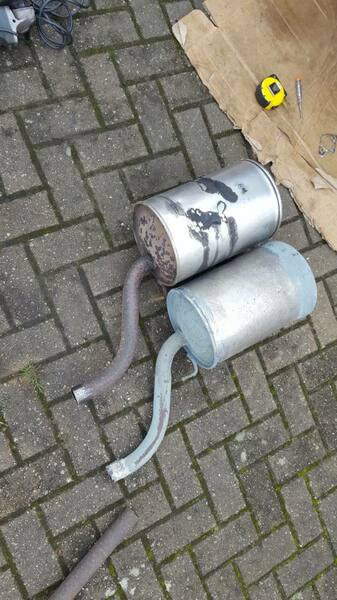

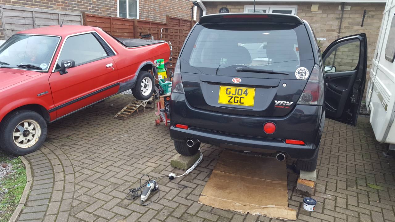

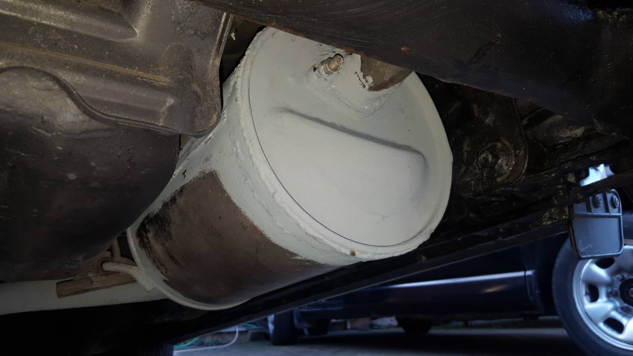

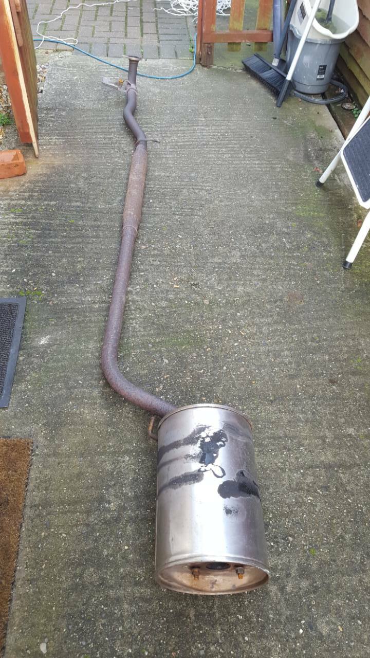

Joey spud Posted January 24, 2021 Author Posted January 24, 2021 After sitting unused i have got my arse in gear and got it mot'd While it was left idle the exhausts main silencer box decided to rot out so i cut it off and boshed a patch around the flaky bit and welded it back on again. Then a few days later the offer of a free YRV exhaust popped on Facebook in nearby Tunbridge Wells. I was going to fit the whole lot but the fixing bolts in to the cat/manifold felt like they would snap before yielding so it was a cut'n'shut job once again. What with Boris,the Subaru and the sister in laws caravan taking up all my entire stock of ramps and axle stands i had to go old skool and use high density blocks. The Mot man advised me of smeary wiper blades and slightly binding front brakes. The wipers were replaced with cheap ebay ones and they seem ok but i doubt if they will last six months before deteriorating again. The brakes i have never been happy with the pads are Ebc green stuff and they are crap when cold,create shed loads of dust and start to judder badly when you repeatedly brake from 70mph untill they cool down again. Maybe they can only be fitted with new discs or i didn't bed them in right but either way for twice the price of a decent OE pad they are not for me so i have boxed them up and put them in the boot for its new owner. So this time i have replaced the pads and discs with Mintex stuff which i have always been happy with. It was only when i removed the discs that i realised just how shagged the backs of them were. That's much better. And a quick road test reveals the little car stops just as well as before but without the judder, once back home i jacked up each side to see if there was any brake bind and also used a cheap infared temp gun to see if one brake was running hotter that the other and all seems good. All that's left now is to look in to an annoying vibration at 60 to 80 that i think is a wheel balance concern so i'll take them to work with me a borrow a balancer while i am attended a tyre depot somewhere. That now leads to getting it advertised and sold. Everything works on it the rusty bits are gone and its been well coated with sealant and wax underneath. The not so good is the paint work across its bonnet and bumper is heavily peppered with stone chips (the paint on Daihatsu's is really thin),the n/s front spot lamp has a corroded reflector and the cheap rear tyres are cracking inbetween their tread. BlankFrank, Fumbler, Soundwave and 6 others 9
