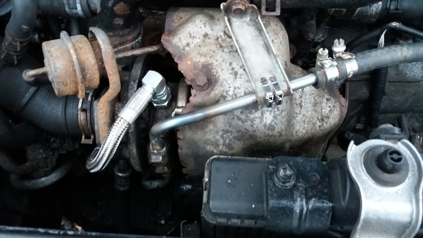

So instead i took my corroded turbo coolant pipes to my local Pirtek place and the lad said he can make something with a 12mm banjo and 10mm tails for the morning so that's a result.

I picked up my turbo pipes from Pirtek,when i left the old ones there to be copied i didn't ask how much.
That was a school boy error on my part,oh well they fit well enough.

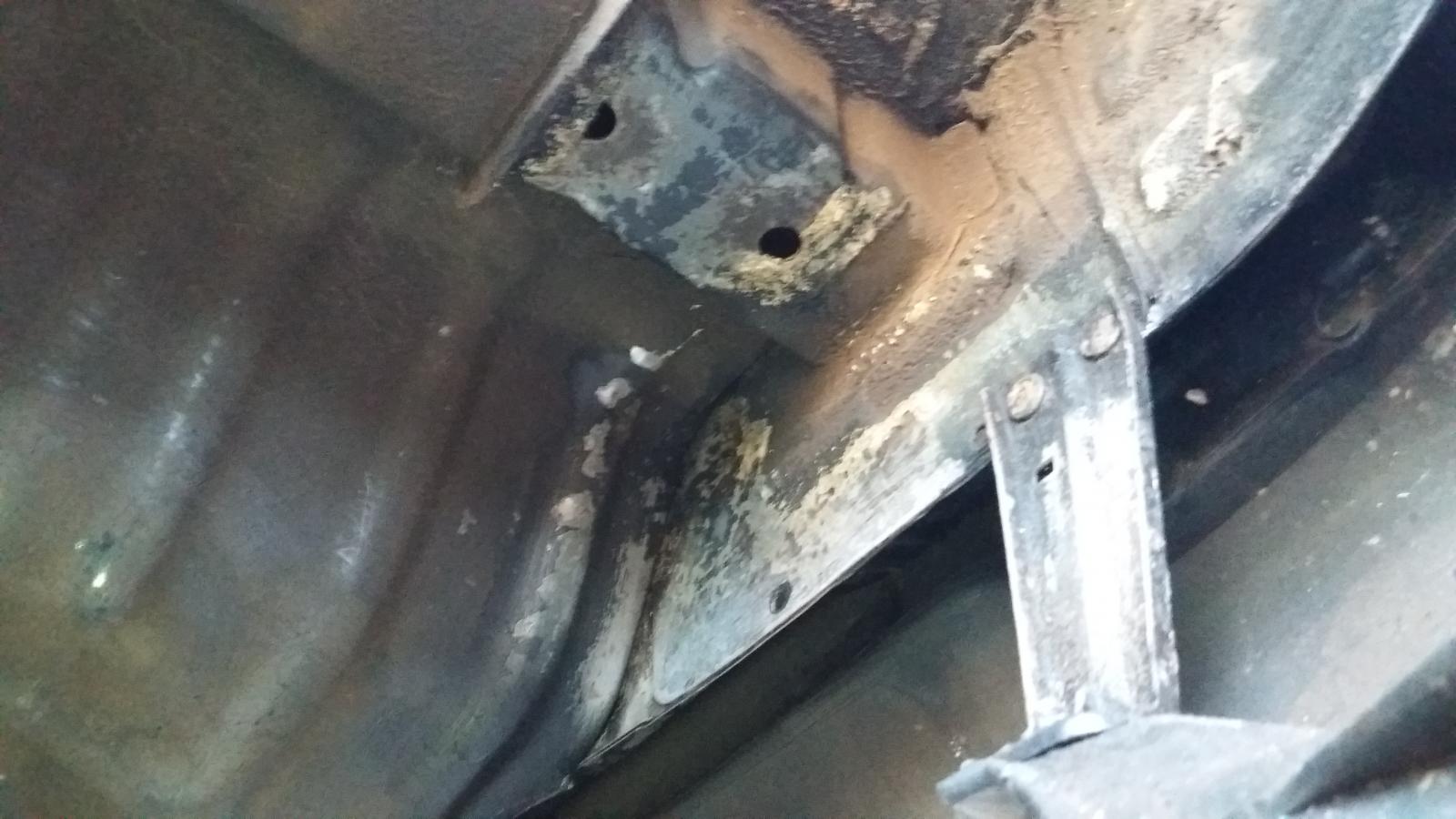

Although the rust holes are now history looking under the little Daihatsu revealed a lot of surface corrosion that if left would surely bite me on the arse later so it was out with the grinder powered wire brush and various chiesels to clean away anything dodgey before giving it a good soak with the rust treatment.
Some grotty bits after scraping the worst bits back to good metal.
And here's some bits after the rust treatment.
I do like this rust treatment but it does slow progress down somewhat and the weather has been utter shite too,but i think that is all the corroded bits now revealed.

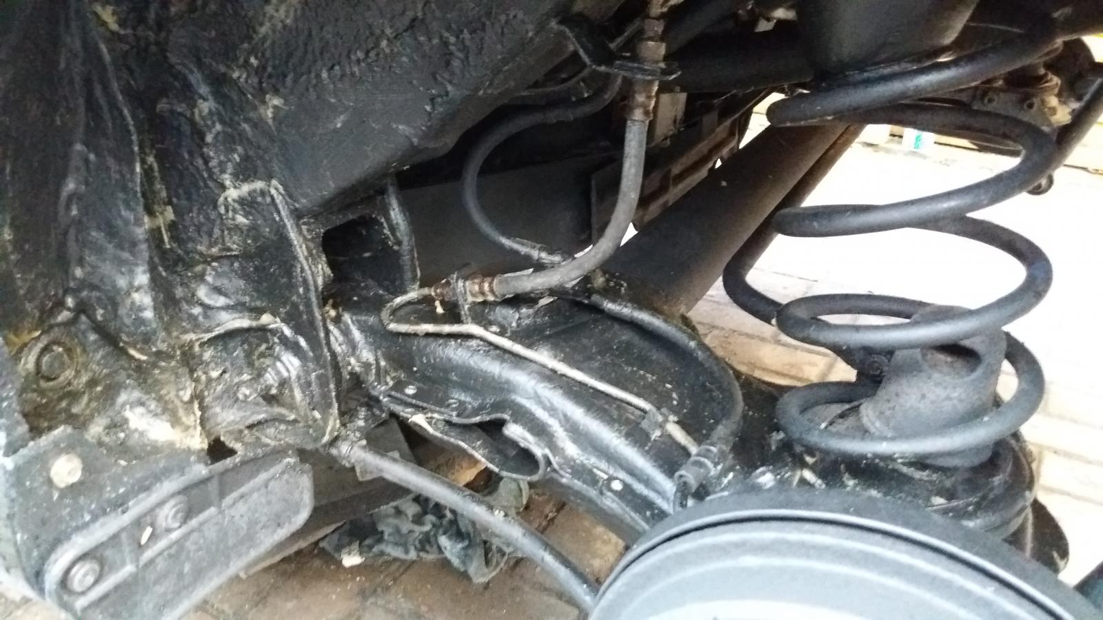

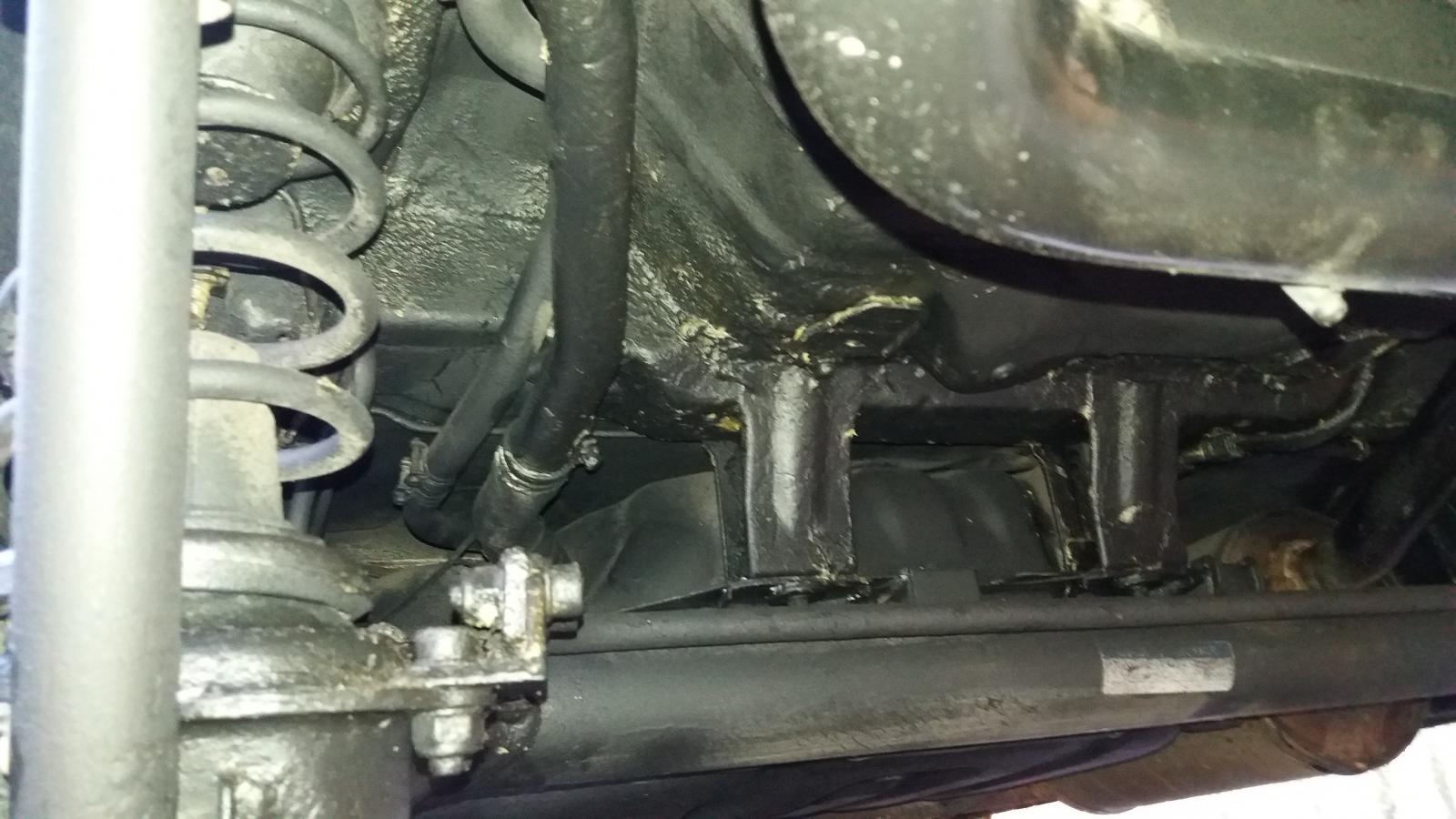

Between the rain and putting up Fairy lights etc i got underneath again used the zinc rich red oxide stuff followed by the shiney black chassis paint to cover it all up.
I had been buying my Stone chip paint in 500cc rattle cans which was starting to get a tad expensive so i wheeled the compressor down from the shed,dusted off my shultz gun and bought a couple of one litre stone chip canisters instead so i could really go in big.
Stone chipped to within an inch of its life.
I picked a dry,not too windy day and waited for the neighbours cars to leave the proximity and gave the underside a serious coating of the black stuff.
Happy with my results i went inside for a celebratory Baked Potato and Fursty Ferret only to return later and find the stone chip had reacted with the shiny chassis paint and gone sort of crinkly in places.
It was then that i remembered why i had stopped using it on my Scimitar chassis and bunged the stuff out of sight up the shed.
After letting everything harden for a few days i went over it again but this time with a bit more restraint just dusting the stone chip on in thin layers.
This sorted it out and it now looks rather Dandy.
Then it was out with an inch brush and an appliction of a bean can (or three) of Waxoyl to give it even more chance of surviving till next winter.

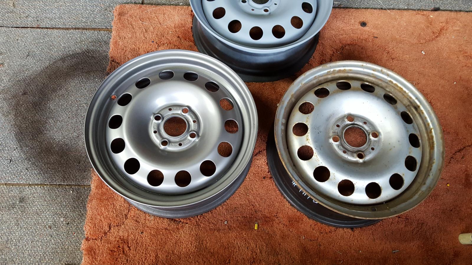

So the little car needs a couple of tyres before I can mot it and the wheels on it are really rough,two of them are leaking due to corroded rims so they need a good referb but that's £160 I don't have and I don't much like the wheels anyway.
So I have bought a set of standard steel wheels from a Bini One instead and will either leave them silver or rattle can them white until I find a set of wheels I like / can afford.
A couple of decent part worms have been sourced too.

I got these very cheap Bini wheels while I look for / save up for some alloy rimage I really like.
So up the shed I set up my referb production line.
Despite the cold weather they have come up really tidy.
the dark steel grey colour matches the turbo 130 livery just right.

A new gasket should be here in the morning so I decided to look at something I had been ignoring.
The paint finish and rust protection on these little Daihatsu's is a fair bit below what Toyota and Honda were doing 15 years ago and there is evidence of rust bubbling away merrily under paint on the front arches.
I tried to not see it every time I walked past but I knew I had to do something now rather than when the weather improved so I scraped the effected paint off easily with a stanley blade then cleaned the metal beneath with 80 grit before treating with undiluted rust killer.
So the rust is now hopefully all treated I just need to decide how to cover the bare metal over until I can paint it properly when the temps rise again.
