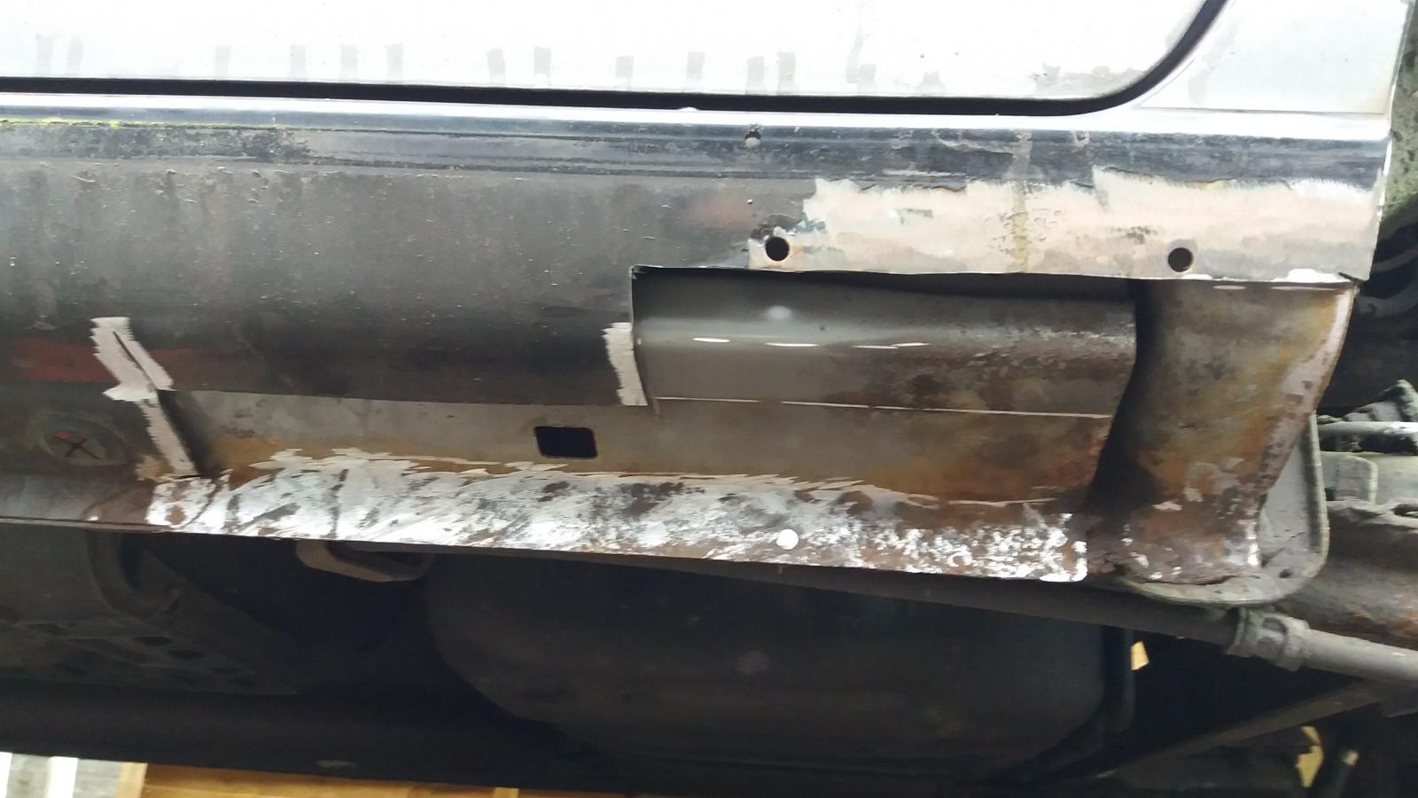

Joey spud Posted November 12, 2018 Author Posted November 12, 2018 I got the sparkly stick out today. The plan was to cut out the rear end of the o/s sill and see what's what but i wasn't too happy with the front of the sill either.I was able to knock a hole thru it if i used a chisel. So that'll be a 45cm x 12cm bit of zintec required then. I think i have caught this just in time as once i had ground away the spot welds the middle stiffener panel was nice and shiney.One more winter and i think the rust would have gone to town. I have made a start covering the void but the light beat me today. ^^ just for mr egg ^^ tooSavvy, theshadow, mitsisigma01 and 15 others 18

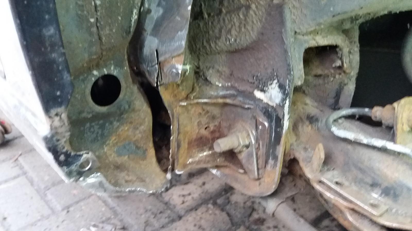

Joey spud Posted November 13, 2018 Author Posted November 13, 2018 A live report from the rear sill of the YRV. It's a bit more than just the outter sill skin that needs a tickle. Jim Bell, theshadow, egg and 6 others 9

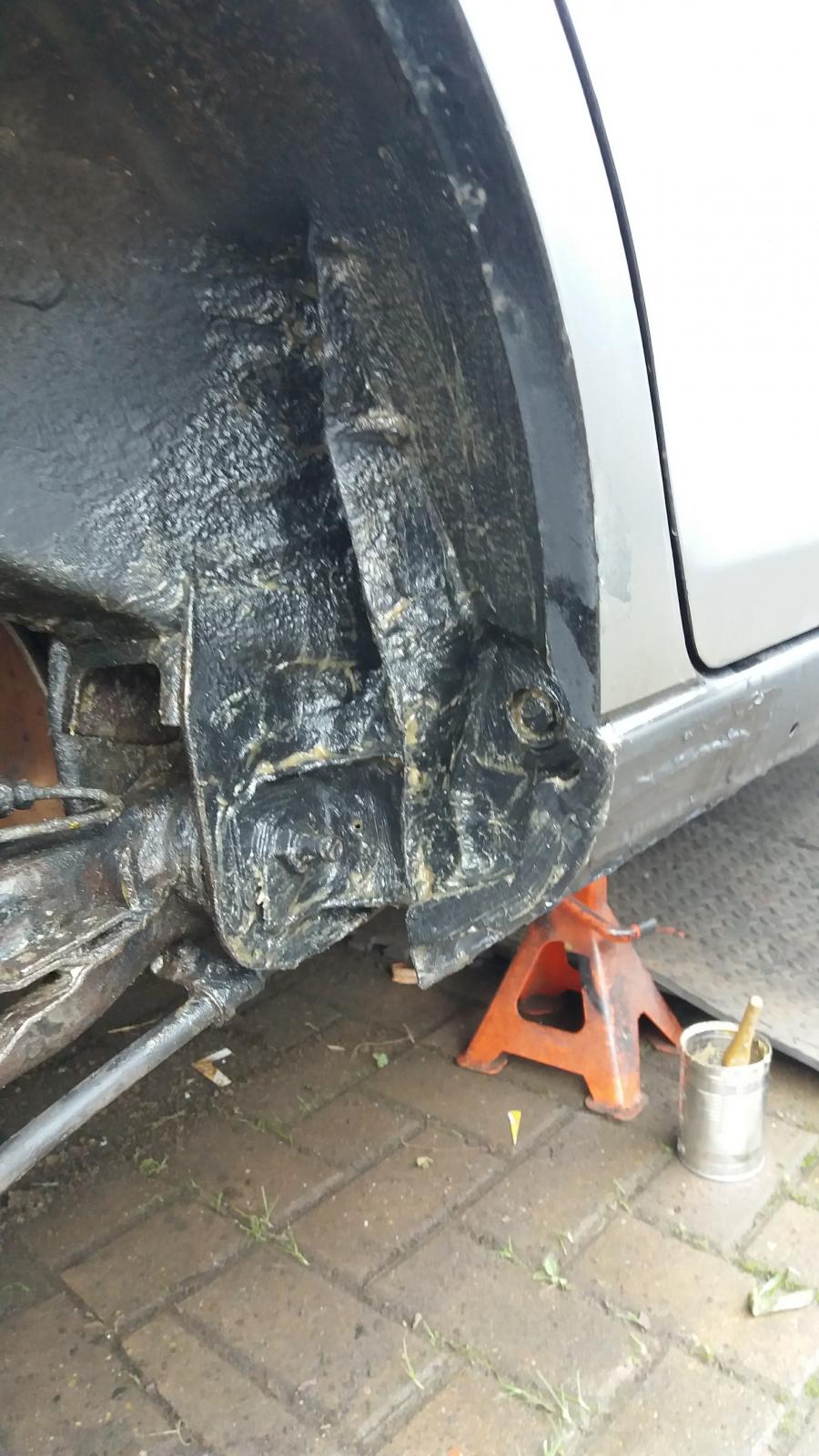

Joey spud Posted November 13, 2018 Author Posted November 13, 2018 1.2mm zintec is the way forward when it comes to scabby 14 year old Jap cars which is just as well as i have enough of it up my shed to build a small Battle Ship.As all the repairs are going to be hidden behind the plastic skirts they don't have to look perfect.This section was popped in first to close the inner arch to sill section,it is a terrible design that allows dirt and damp to sit and fester.That'll do for me Tommy.As it's been remade from 1.2mm steel i have been able to really wind the amps up and get some good penetration going.Handily there is a big gromit hole to let me fill the inside of the sill with stickiness (waxoyl).I have given it a couple of coats of red oxide today and tomorrow i will Tiger seal the joints,apply chassis paint then sprinkle with stone chip and finally brush on a bit of clear waxoyl.I think a new set of shoes wouldn't hurt either. I had to derust and paint the gearbox sump too as it was looking really rough. The guy i bought the Daihatsu from had been doing an 80 mile daily commute in it for the last four years so i think it's wearing its 114k miles quite well. mat_the_cat, theshadow, Bucketeer and 14 others 17

Joey spud Posted November 15, 2018 Author Posted November 15, 2018 Various coats of red oxide,chassis paint and stone chip later... And just for luck Waxoyl too. It's been turned around to do the other side now. yes oui si, Tickman, skattrd and 14 others 17

Joey spud Posted November 16, 2018 Author Posted November 16, 2018 The weather down here has been misty and damp today and my mojo finally turned up at lunch time so outside i ventured.I was hoping the i could get away with just repairing the rear end of the sill but no once i cleaned up the front end little pins holes became evident.So a cutting disc was fired up and a big hole was made,pleasingly the inner sill and stiffener panel are still good.At the rear end the inner arch has suffered a bit more than the other sides.Again i think i have caught the rot just in time.I think one more winter would have really hurt it.As it was so damp outside i didn't wheel the mig out the front and instead had a good scrape and wire brush session underneath.I had read that the fuel tank filler necks were prone to rotting through so had a good prod and found it was really clean at the fuel cap end but when i followed the pipe to the tank i noticed that the breather/vent pipe part of it was swollen and scabby and really not fit for purpose anymore.Looking at this rotten bit i think can cut the worst section out and use household copper pipe or even the plastic stuff instead and join it either end with rubber hose/hose clips. Sheefag, GrumpiusMaximus, theshadow and 3 others 6
sierraman Posted November 16, 2018 Posted November 16, 2018 Solid repair that. Should see the rest of it out. Joey spud 1
