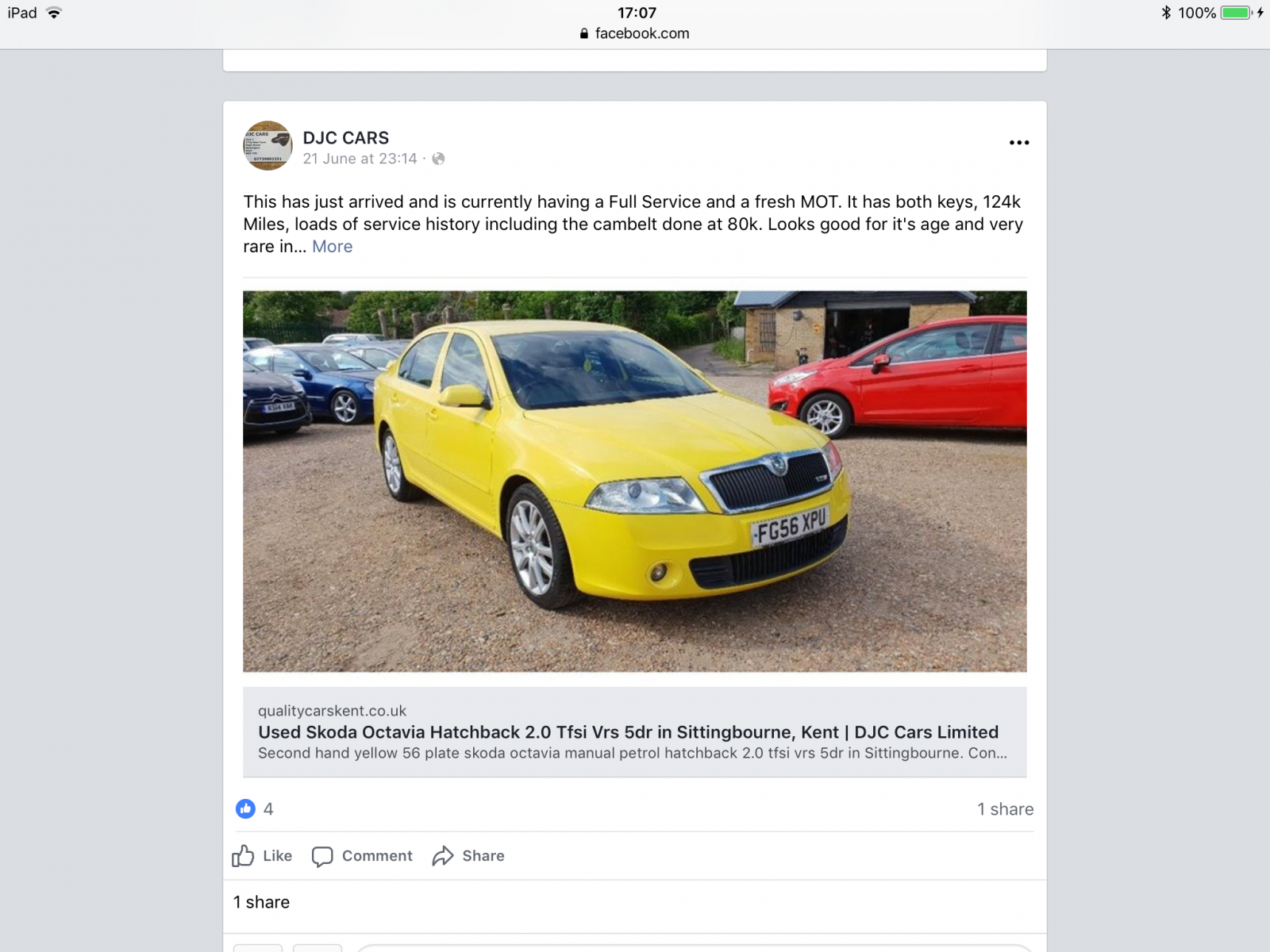

It’s an 07, petrol. Yellow....
Will be the 2.0 TFSi lump if petrol. The better generation of these lumps too. Got the same engine in my TT. Is it manual or automatic?
Mostly a Golf Mk5/Seat Leon/A3/etc, so common faults on them are similar to these. Generally pretty hardy cars though. Some stuff have problems, notably back calipers sieze, bonnet release handles snap and general VAG fobiles. Just makes sure everything works (Aircon included).

EA888 was later. This should be a EA113. Early EA113 had chain issues too - engine code CCZA but I think they were only ever in the early Golf GTi. This is most likely the BWA which is the best of the bunch.

Ok, so deal done, and driven home
Initial impressions, seems ok in a modernist sort of way ( really not me)
Goes well, plenty of poke, quiet, dull, boring, safe etc etc etc.
Wife’s happy, so everyone’s a winner. ‘Spect it’ll need loads - list being compiled.
