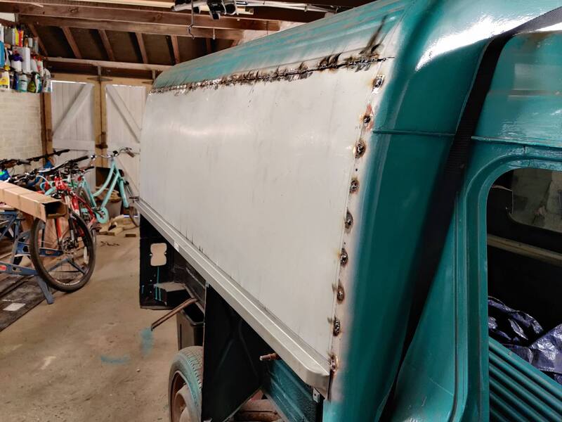

meshking Posted April 26, 2020 Author Posted April 26, 2020 So where did I get with this? We last saw this with paint on the back half with new doors but no glass. Enter one wife who decided that a house extension was more important, a new job that is taking up a lot more of time than my old job and not much happened. The van was left with a thick coat of dust, until the building plans were complete. We're still not there, but decided given the lack of travel I can now get on with it. First thing was the window sides. This didn't turn out well on one side - the new surround I made up was too small in some places and the existing metal too weak in others. I decided to replace the entire side with a sheet. Worked out ok, need to get rid of a big dent that appeared whilst welding. Then I replaced the side rail and the wing with a metal one with correct large ripples. The fibreglass ones on the van weren't looking too good so I took the plunge Now with those wings on one side welded in, my thoughts are turning to cleaning up the engine bay ready to a bit more paint then get it running. Stripped out the old full side: Sized up new zintec sheet Welded in and checking rail and wing for fit: et voila: 320touring, brownnova, Joey spud and 17 others 20

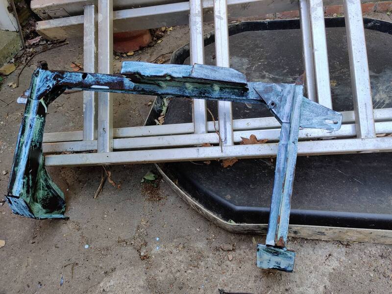

meshking Posted May 23, 2020 Author Posted May 23, 2020 Where did I get to? Oh yes. I ran out of abrasives, so ebayer "Dr Abrasives" to the rescue. I thought I would firstly get some better tunes into my garage, bit fed up listening to tinny music through my phone. Rotel amp, Jongo bluetooth and B&W speakers will do the job! Finishing off cleaning the panel between screen and bonnet and cleaned up the bulkhead enough for a simple coating. One thing I hate about cars that have had paint is when people only paint the outside. So I've painted the insides and will be painting the underside of the bonnet as well the outside ( which is currently green). Unfortunately, I think I'll have to stop here since my plaster appears to have changed colour. Sigh. RobT, brownnova and strangeangel 3

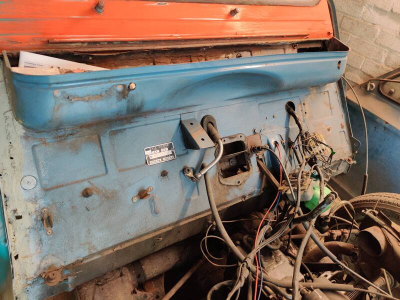

meshking Posted May 23, 2020 Author Posted May 23, 2020 Having recovered, slightly, from my finger injury I took another look at the bulkhead. I had noticed this plate before, doesn't look particularly factory: So I unclipped the accelerator cable to find the tension of the cable was holding in two pieces of steel either side of a rusty hole Not too keen on rusty holes, and definitely not keen on just painting over it. Look alike the welder is coming out again tomorrow.... strangeangel, somewhatfoolish, rob88h and 2 others 5
320touring Posted May 23, 2020 Posted May 23, 2020 Ah that's a bit of a bugger to find. How is access?
meshking Posted May 23, 2020 Author Posted May 23, 2020 It's not too bad, hopefully be able to let in a small repair panel. The rust is isolated to that area. 320touring 1
320touring Posted May 23, 2020 Posted May 23, 2020 25 minutes ago, meshking said: It's not too bad, hopefully be able to let in a small repair panel. The rust is isolated to that area. Good news:) looks a bit like the section where the MK1 Golf clutch cable goes through a single skin bulkhead. The movement weakens it over time then it rots
meshking Posted May 24, 2020 Author Posted May 24, 2020 23 hours ago, 320touring said: Good news:) looks a bit like the section where the MK1 Golf clutch cable goes through a single skin bulkhead. The movement weakens it over time then it rots Yep - single skin - so just weakened and rotted through. Shouldn't be too bad a job, just need to let my finger recover for a few days and then I'll dive back in. 320touring 1

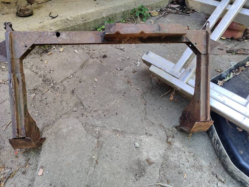

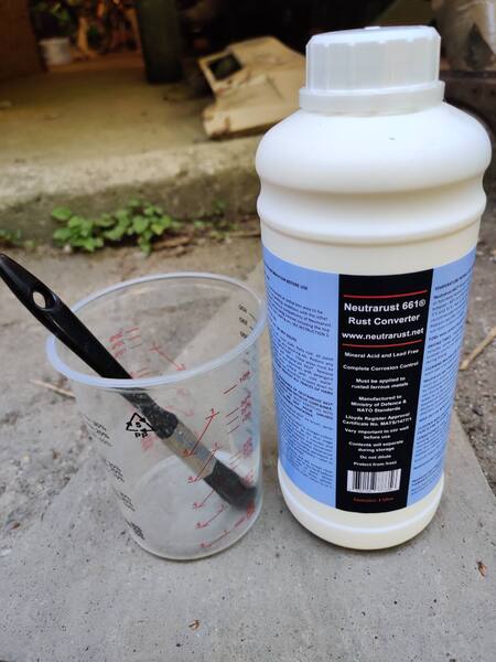

meshking Posted May 31, 2020 Author Posted May 31, 2020 My finger injury has recovered enough now to wear gloves. Earlier I had cut a plate to fit Got busy with the welder this morning: It'll do. Also bought some vactan alternative and went to work on the goal posts: Time will tell how good it is I suppose scdan4, egg, LightBulbFun and 9 others 12

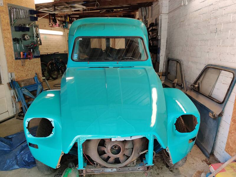

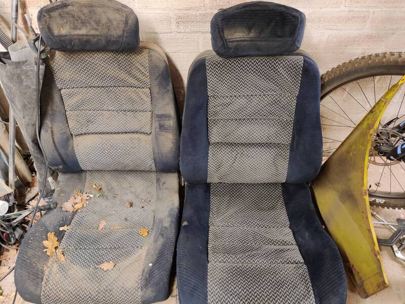

meshking Posted June 7, 2020 Author Posted June 7, 2020 Snuck in some time on the van this weekend. Decided it was about time to start painting and accepting that it's never going to be show quality. First up, sort the bonnet. The final prime the van side: Now get the rustoleum out and paint! fairly happy. It was a new gun and I don't think I thinned the paint sufficiently. Hopefully it'll buff up nicely. On Saturday I also got fed up with the dirty seats. I had pulled these out of the van when I replaced the floor and left them in my dumping ground (or conservatory as it is known elsewhere). This meant that my cats had become rather partial to sleeping on them and they were then shoved into the garage when building works started last year. Hoovered and used some upholstery cleaner gave this half way through: Both seats are now done, making the interior hopefully a much nice place to be! RobT, anonymous user, Mr Laurence and 12 others 15

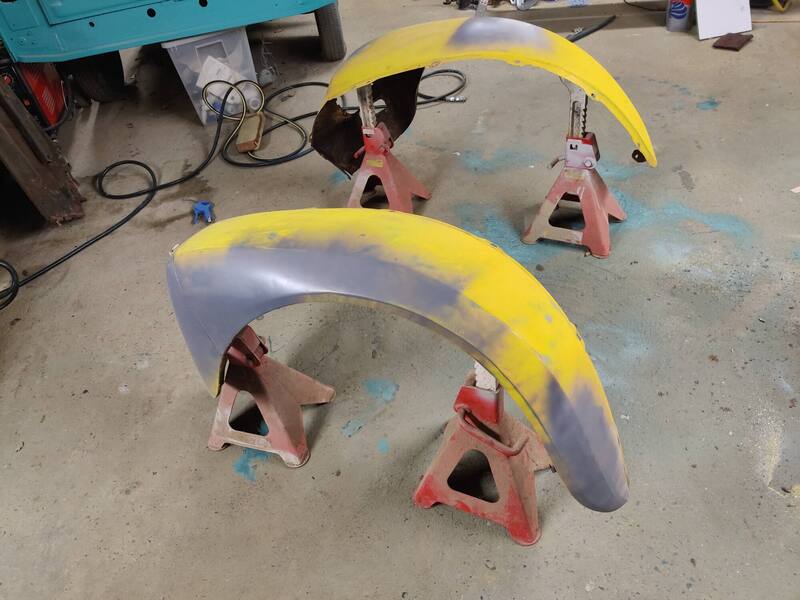

meshking Posted June 14, 2020 Author Posted June 14, 2020 Friday night I decided that rather than sit and fall asleep in front of the TV (up at 4am does that to me) I would go and sort the front wings. Bit of bashing and fillering first (channeling my inner gas monkey / Boyd Coddington with filler levels) got me here: Then here: Saturday morning started with an attempt: But the paint gun clogged with a massive paint lump because (a) I couldn't find the filters and (b) I'm not very good at this. Tried again and got here Needed to get the space cleared for my Lotus to return from its holiday in my mum's garage whilst we had building work done. Having seen the amount of dust on the van I'm really pleased I did that now! Started putting it all together lightly: Happy with my 10foot paint job. Next job is to turn it round and finish the other side. I have another wide ripple panel to go on the rear and need to paint the doors. That's proving to be a pain - can't get hold of another windy window door apart from the abattoir in Oxford. Might see if the club has a good slidey window door in their stores. 320touring, 500tops, paulplom and 6 others 9
