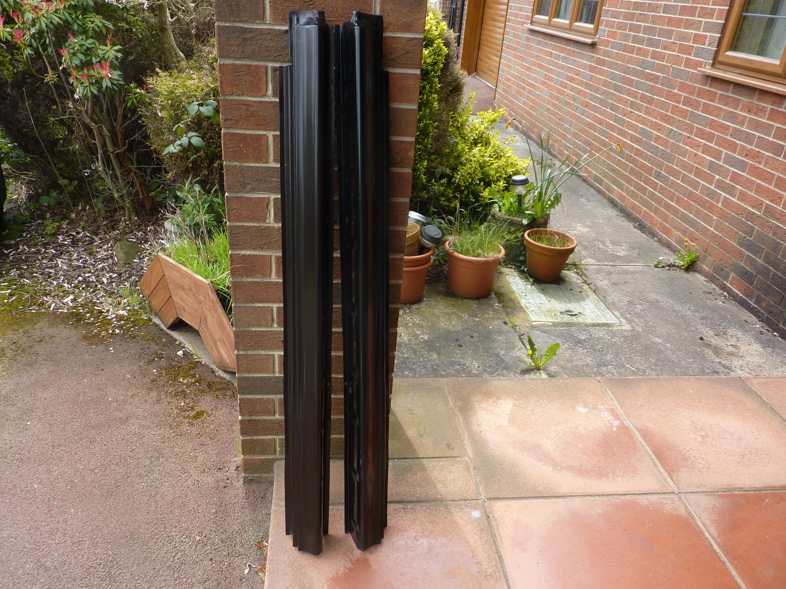

SiC Posted November 27, 2018 Author Posted November 27, 2018 dont cap it completely sealed, it needs to have a drain hole at the bottom, from factory it was a 1/2 inch square that was around 1 1/2 long. Otherwise the wing will have no where to drain too.Yeah ... I forgot about that. Well I didn't and I left bits pulled out between the membrane and sill for draining. Except I did that a couple of weeks ago and when I welded it up, I forgot what they were there for. So I flattened those bits up and welded them. Oops! I'll just have to drill some holes in the sill for drainage purposes. I was planning to do that anyway so I can get Dynax tubes or similar to line the insides with protection. purplebargeken 1

sharley17194 Posted November 28, 2018 Posted November 28, 2018 Sic understood me, only a ADO16 nut will get it! Theres a random shaped hole from the factory at the end of the sill. Its to help rot them out faster in future or let the water out that will def get in....one or the other.
Eddie Honda Posted November 28, 2018 Posted November 28, 2018 The front end of the sill tapers in behind the wing and is open-ended originally, I would sketch it out as I can't find a photo, but if you look at the top ends of these..
SiC Posted November 28, 2018 Author Posted November 28, 2018 Yeah mine is aftermarket sills and don't have that stepped section. So the front of the sill was always open to the elements? I guess there was a reasonably good reason they did that? (Apart from making it likely to rust and thus planned obsolescence - an Issigonis specialty) somewhatfoolish 1
