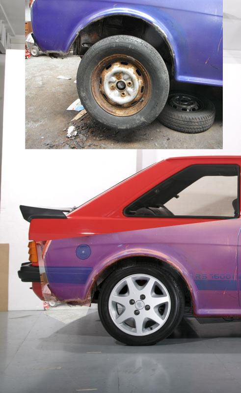

I have a recollection of an engine swap car that was fitted with Mk1 Golf arches.  I think they had to use front Golf arches all round because the rears were too small.  It didn't look out of place either, even though they weren't very curvy, but then it did have wider minilites fitted so that's probably why.
Having said that, a cheaper alternative is 2 door Escort rear arches.  Similar profile to the Golf, so should in theory work.  You don't want the four door version because the rear arch is stepped to accomodate the door.  Front wings are more expensive and don't have the complete arch because of the bumper so that wouldn't save you any work.
https://www.ebay.co.uk/itm/ESCORT-MK3-4-1980-1990-REAR-WHEEL-ARCH-2-DOOR-R-H-NEW-KK-KLASSIC-PANEL/220785462902
Good hunting! What are the chances that it'll be a similar size to the 1100? I guess it doesn't matter too much as long as it's close?
I'll need to get both sides as 1) my OCD can't have it different on either side, 2) the other side is going to need equal amount of fettling anyway.
It's probably pretty close.  I used the photo I had of the Princess steel I offered up to the car, which I know is 14", and a picture of a Mk3 Escort 1600 on alloys which I believe are 14", and overlaid the two.  It's a bit crude but it looks like a reasonable candidate, you won't know for definite until you actually try it, of course.

Escort arches are totally the wrong profile and would look ridiculous.

It's obviously fucked but the front arch lips should be okay, and provide enough metal to rebuild your rears and still look like an 1100 and not a Yugo 45.

One thing I have noticed is the line of the arches is very important. RBJ is right, it's likely to look silly if another arch is grafted on.
Letting your eyes follow the arch line from the front to the back on this picture makes that clear. It's an integral part of what makes an ADO16 shape, an ADO16.
This car isn't going to be original and I've accepted that fact. But I don't want to ruin it.
Even though I have removed a fair bit of arch, there is still a fair bit left of the profile.
