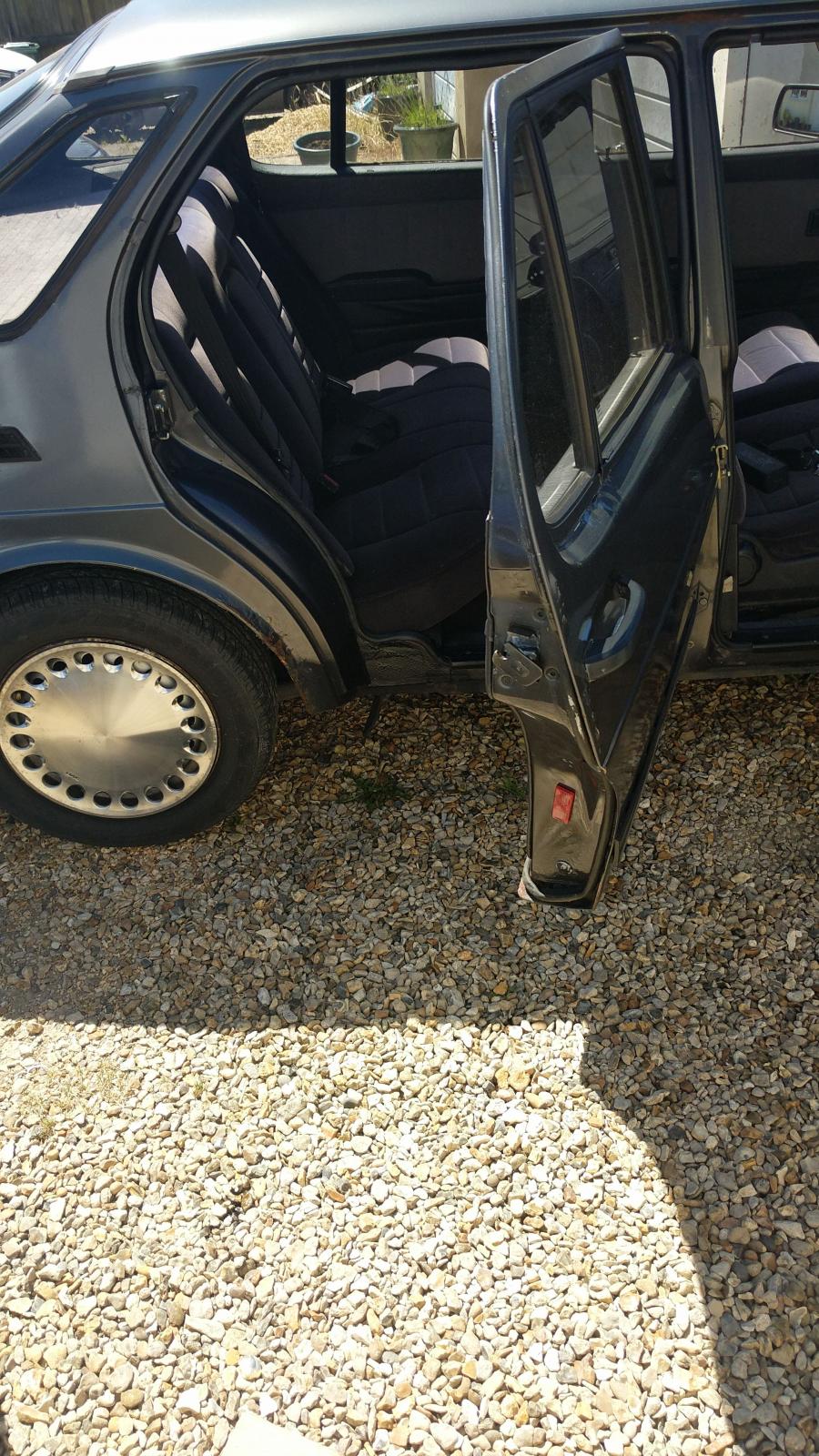

For example, one of the doors wouldn't unlock, which obviously meant it wouldn't open. However:
A sharp smack on the door card allows you to lift the snib and the door opens. It'll work fine until you lock the door and you have to hit the door card again.
It's progress. It's slow but it's there. Another point of consideration is the cracked exhaust manifold. It's definitely a bit cracked, and obviously in an awkward place. I was informed you can't remove it without dropping the engine however it looks like you can, but it's a ballache.
I've bought firegum instead. God help us all.
So I was feeling good, cracking on in my usual style of doing jobs I thought I could just get sorted.
However, this one is proving to be a bastard.
It opens fine from the outside, however the internal one just won't budge. It seems pretty seized but it's hard to tell. Anyone have any ideas? It allows for a couple of mm travel, but that's it.
Biggest dickhead of the day goes to me for not checking that the child lock was on!
Sounds like the sort of thing I’d do, taking a week off work to fix a car and spending all of day 1 barking up an entirely spurious tree.
Still counts as progress though, I’d say.
On the plus side, the doors almost work perfectly now. And the central locking now works on all the doors.

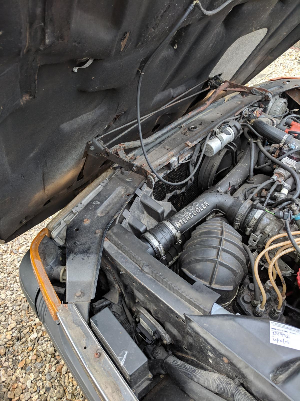

The turbo pipe that was loose? Do you mean the main one that has 'turbo intercooler' cast into it? FFS. I must have had it off for some reason and forgotten to do it up properly. I've definitely had it off at least once because you have to remove all that gubbins to replace the air filter. What a wally.

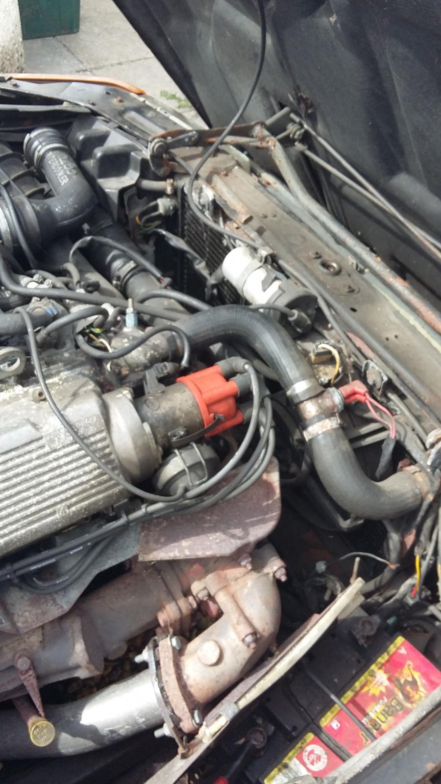

The exhaust manifold will come off without moving the engine (I know because I removed it in-situ when I did the headgasket) unfortunately I'm not sure there is such a thing as an uncracked 8 valve turbo exhaust manifold. Gun gum or epoxy will bung it up for a bit but I found it would burn off well under 1000 miles.
The temperature gauge IIRC used to under-read so be careful with that.
My old car! It was a lovely old thing, I'm sure you'll get it sorted in no time. Although the back end was rusty it was (and hopefully still is) remarkably sound around the awkward to fix front chassis legs/driveshaft tunnels.

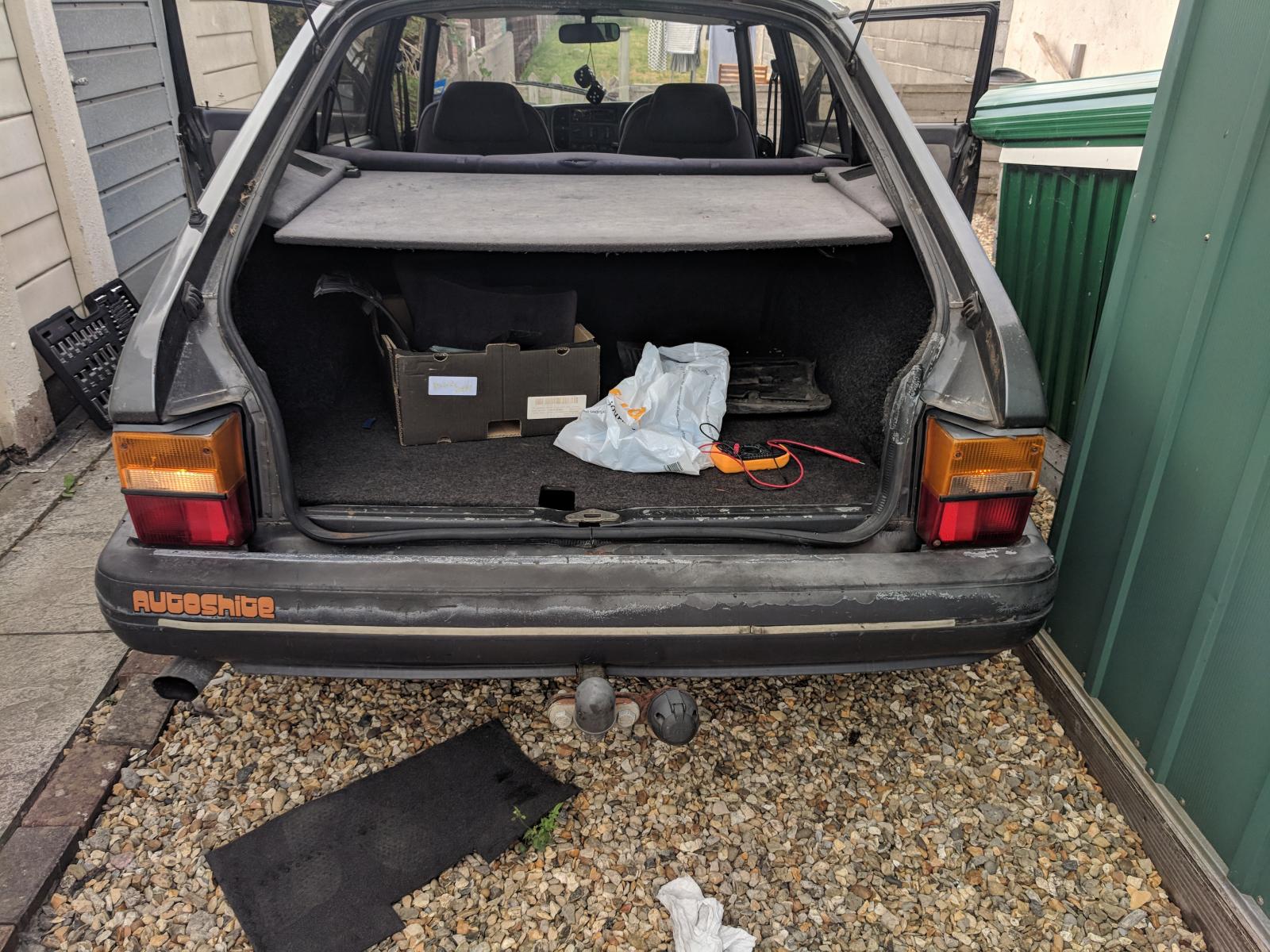

Then the fun of the back lights loomed on me.
They didn't
know what
to do.
So the fun begins, and I actually really like the simplicity of the rear lights.  Just unscrew the covers and the bulbs are all there.  No fiddling around in the boot or pulling stuff off you know will never fit back in place correctly.
A few of the bulbs were out, luckily Halfords had a sale on lightbulbs so I had already stocked up on every single type of bulb it could need.  I forgot the after picture but all of the lights were working, with the exception of the reverse lights.  The bulbs looked fine which led me to believe it was related to the reverse switch.  This involved taking the centre console out, a job that was surprisingly simple.
The reverse switch is screwed into the side of the gearstick housing, and usually has a couple of washers between the housing and the switch. Favouring the idea of the free fix, I took out a washer, screwed it back in and
Bums. Two secs.

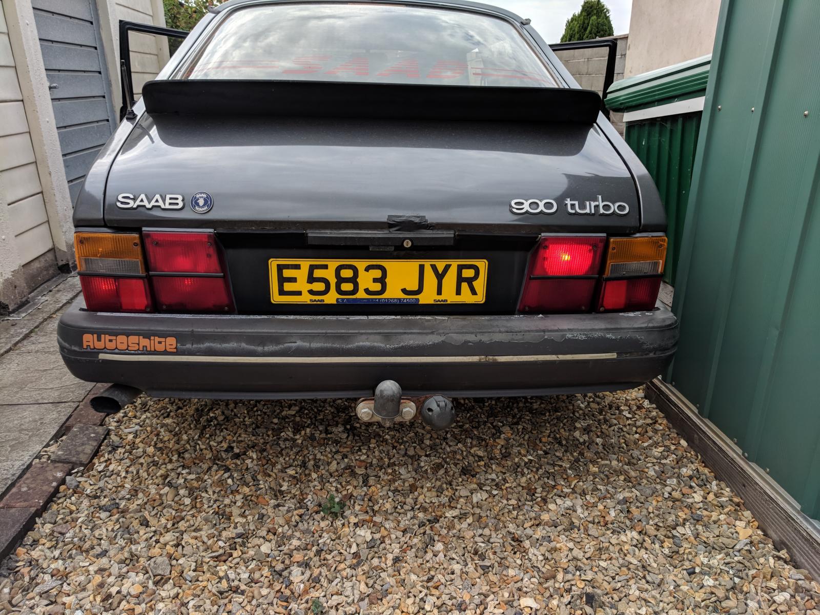

Much better.  The cat enjoys being in the car when I'm tinkering, so here's a photo of her with the spoils.
At this point a couple of the lights in the rear were being intermittent again, so I reopened the lot and cleaned the bulb contacts with electrical contact cleaner. All now working as expected!

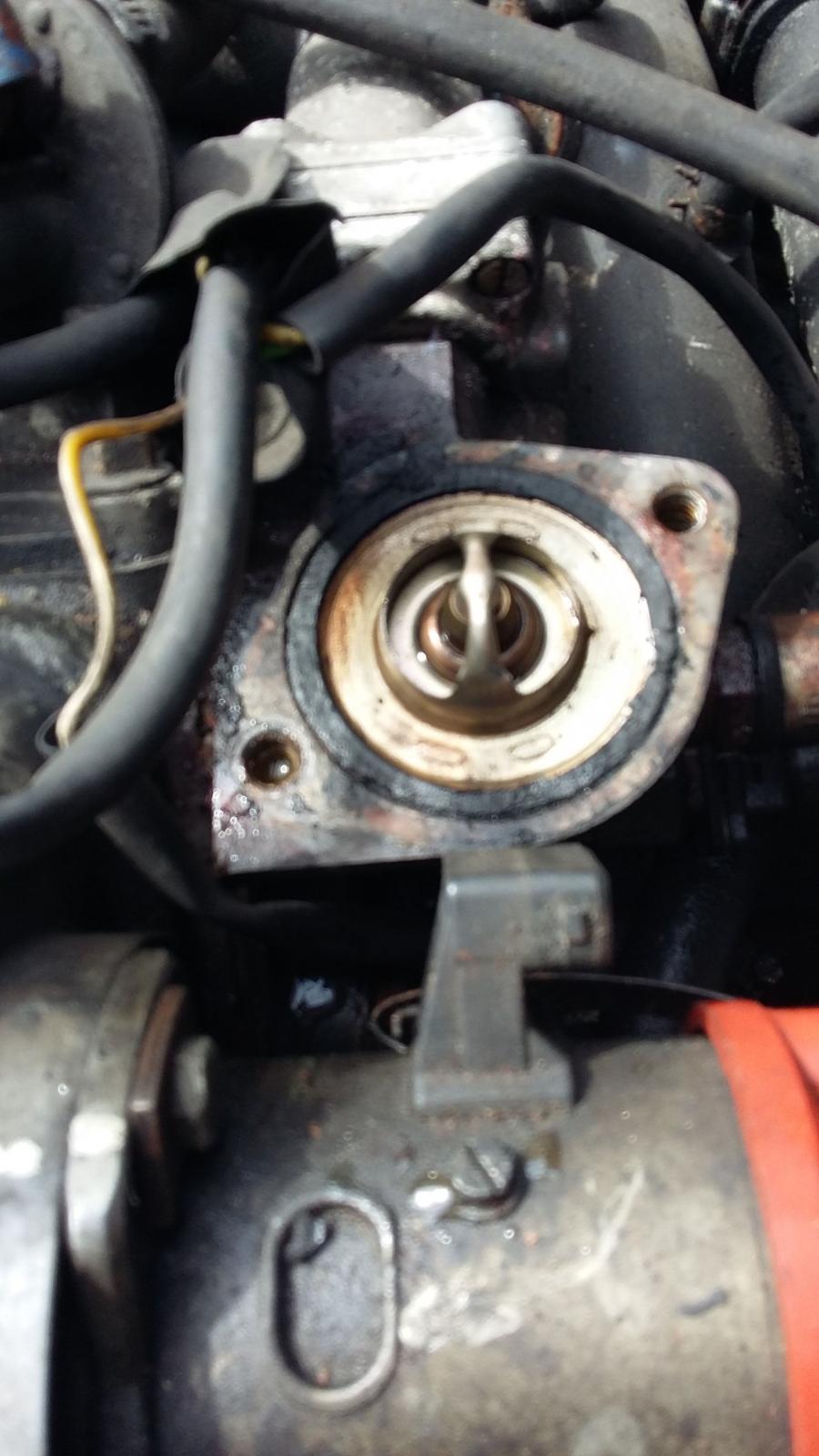

And so to work.  The first two things I wanted to check were that the thermostat was operating correctly, allowing the flow of coolant to work its way around and that the fan worked.

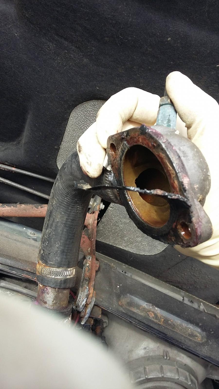

Two bolts take off the thermostat housing.
(Unfortunately I bounced between my phone and a courtesy phone so pictures will start to look a bit cack) The thermostat was revealed, however it would not budge at all.  Careful screwdrivering didn't help, I wasn't sure what I'd do.  Then I had an idea...
I had a little strip of elastic just lying around in one of the cars, no idea why I didn't just throw it out, but I looped it around the top loop, and increased the tension and out it popped.  It was a bit of a bodge, but my thinking was the elastic had a bit of give to avoid damaging anything, but would still have the pull.  I've kept it in the glovebox for another time!

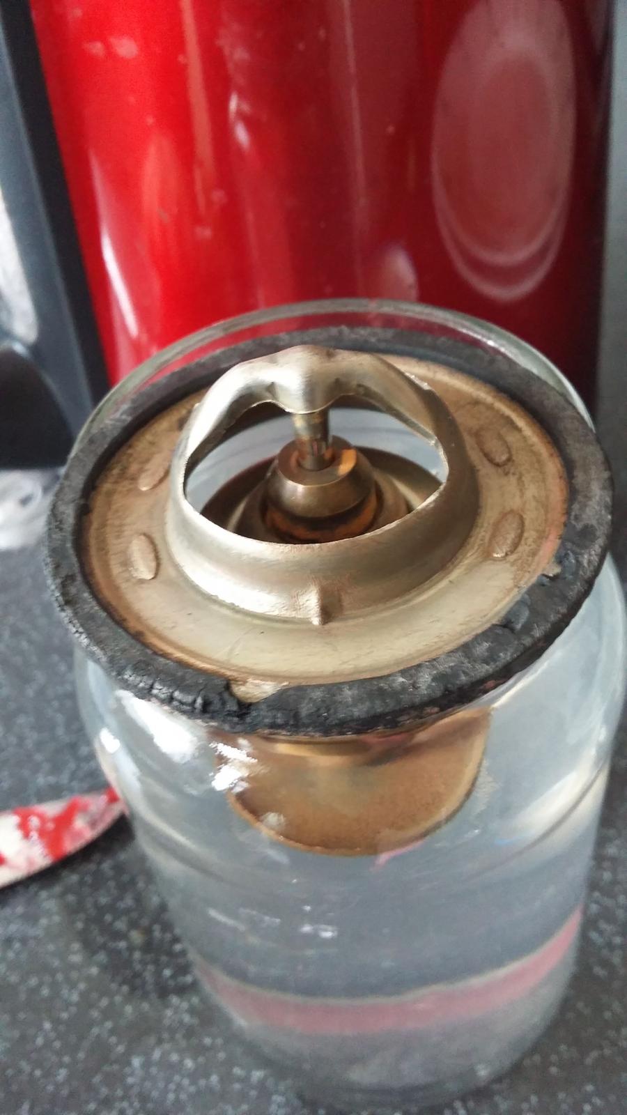

Now the stat was out, it was time to test it.  The missus would never let me throw it in a pan and boil it, so I had to improvise with a jam jar filled with boiling water.
It opens, it's all good. (Is the bit missing from the seal a concern though?)
However, there was another concern - the gasket on the housing was in a complete state.
Time to get online and have a look.  In the meantime:
£4 on ebay later and I had an assortment of gasket sheets in differing thicknesses to go through.
I went for the 1mm, new gasket cut out and fitted onto the housing.  Happy days!

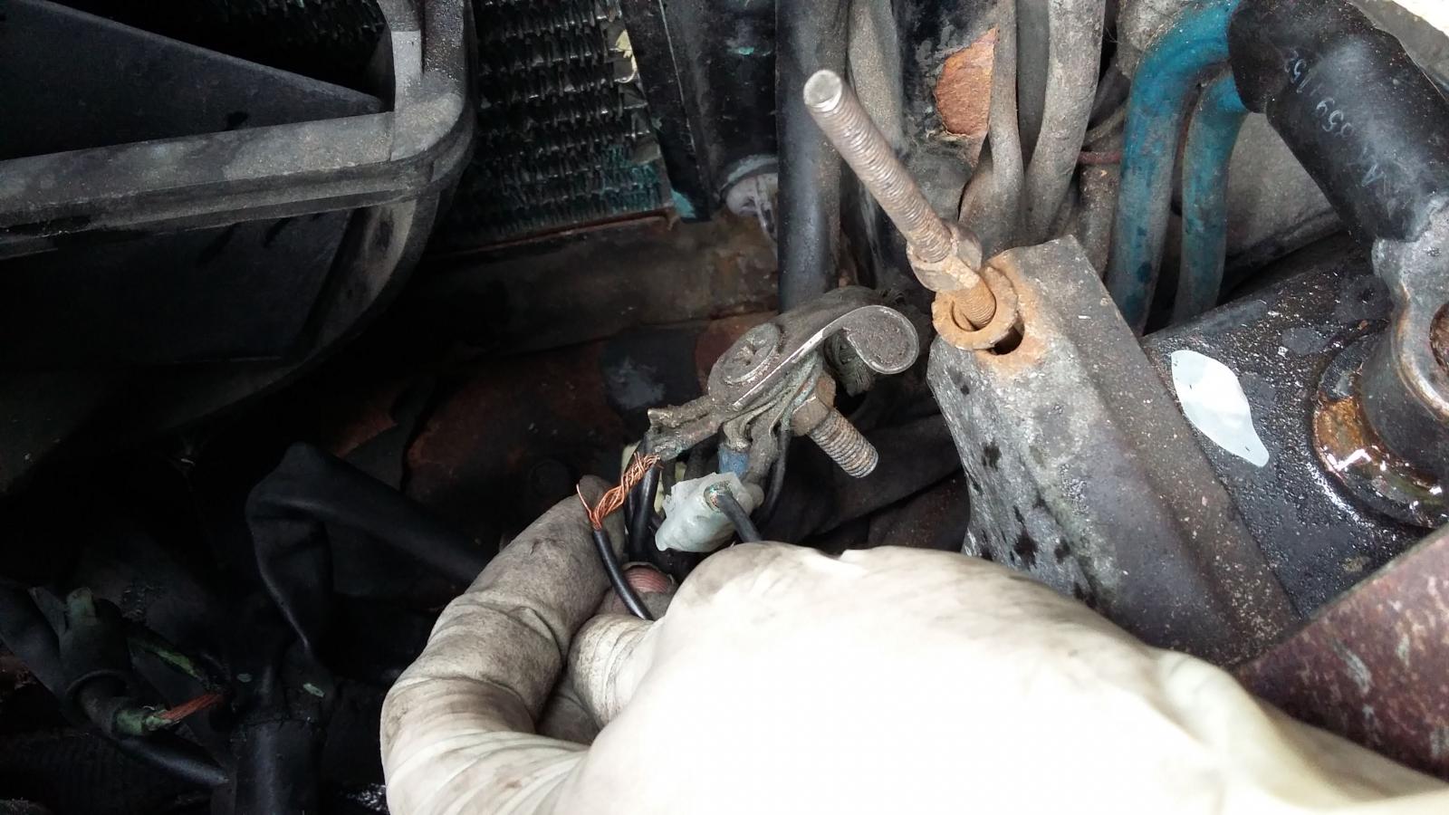

I was happy with the state of the thermostat, so the next thing to focus on was the fan.  The first step was to look at the wiring, as they commonly go bad as it runs along the front.  Doesn't help when you find stray wires rattling around in the engine bay.  I rigged a multimeter onto the connectors to the fan cut in switch, and was getting little to no voltage, however, when I brushed this wire against a bit of metal I suddenly got a decent voltage!

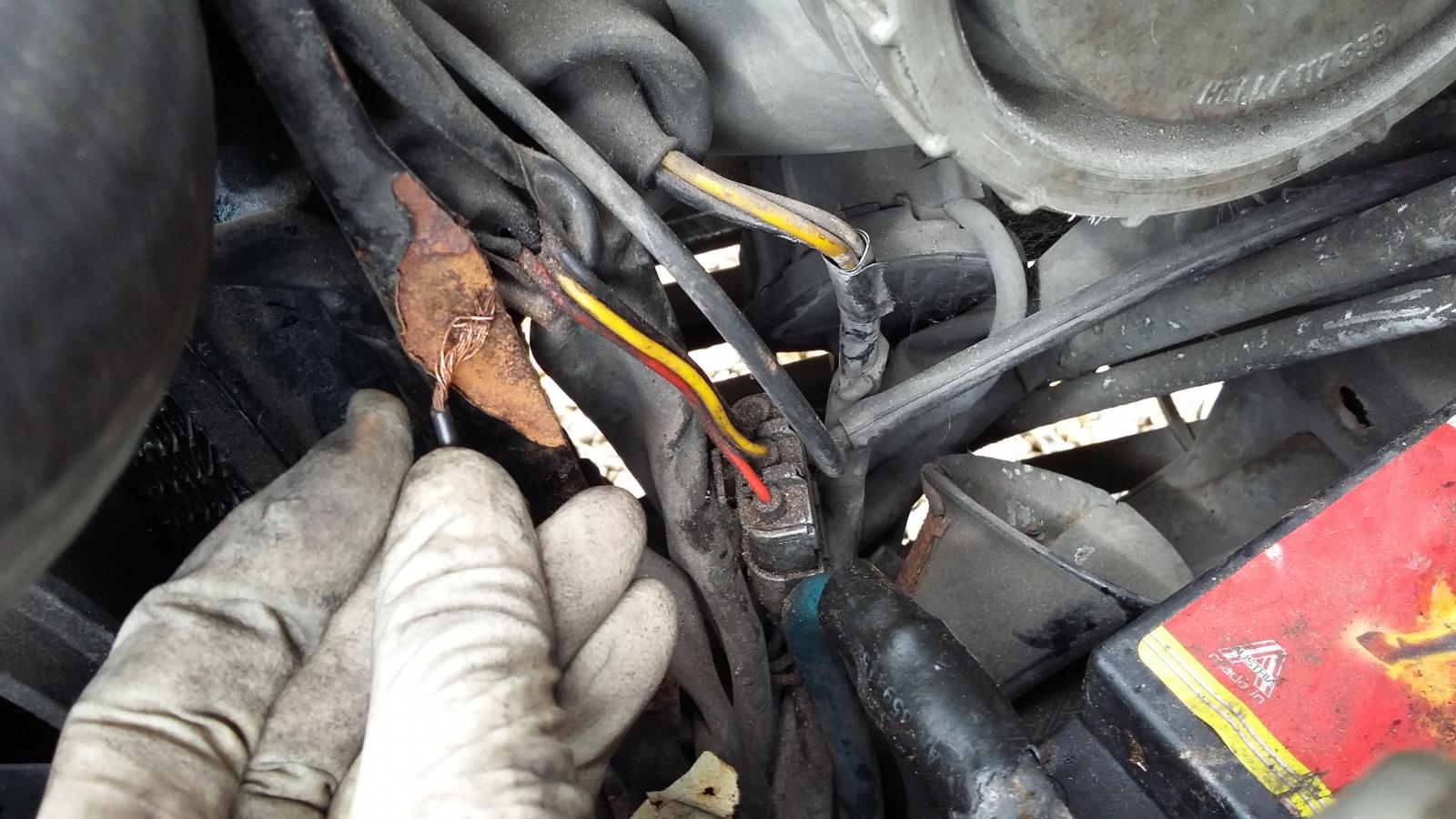

I have a feeling that it has come away from this piece of electrical ingenuity* (Or it's how it should be, I am terrible with electrics however melted choc block is a bit of a worry.  It is near the manifold though)
I stripped some fresh wire, crimped on a doodad and attached it into the Electrical-Totem-Pole-of-Firey-Death.  A bit of faffng around later and bridging the fan switch connections made the fan whirr into life.  Great news!  With that in mind, the last thing to do was to reconnect the switch and run it up to temperature. At running temperature, the thermostat opened, the system was bled and I could feel like progress was made.
Fan switch didn't kick in though so I think that it's worth getting a new one. Alternatively I will go with the earlier suggestion of running a manual switch through.
